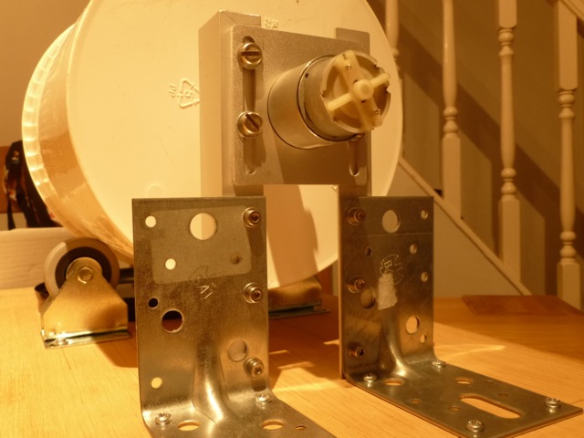

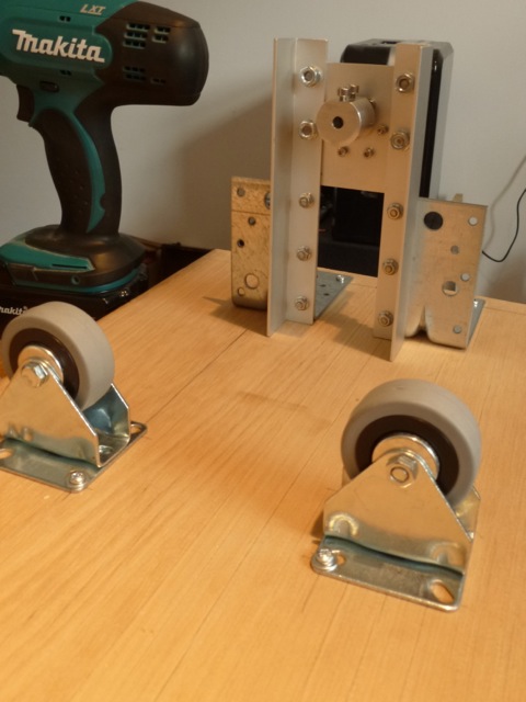

    Hello all,
    I'm currently building a small parts tumbler in which I intend to tumble aluminium parts amongst 3mm porcelain beads.
    Some pics below:
ID:	12364 Click image for larger version.
ID:	12363 Click image for larger version.
ID:	12362 Click image for larger version.
    Although the 12v 350mA 20RPM motor spins the tub reasonably well (provided that the static friction remains low) I'm thinking of adding an identical motor below it and connecting it via a nitrile o-ring belt so that it's 'helping out' the motor that's directly driving the tub, like so:

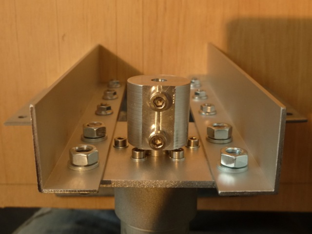

    Now, let's say that an O-ring with an inside diameter of 100mm fits perfectly (un-stretched) around the two couplers:
    I'm guessing that this wouldn't be ideal as there'd be very little traction or transfer of torque - so my question is: how much stretch percentage should I introduce to the o-ring for it to do its job as a conduit between the two motors? 10%? 20%?

    Why not just introduce a third pulley as an idler/tensioner and have a play? G.

    Geoffrey - agreed that experimenting is good, but rather than add a pulley I may just buy a selection of o-rings at varying inside ø's...
    Eddy - yep, I had a look at a driving roller and a second idling roller design, trouble is that the motors I have run at 20rpm - so the tub would rotate at about 2rpm in that config...
    I didn't want to get into bigger motor territory - 12v small and quiet(ish) was the aim!
    At 60p/o-ring I may just buy a handful and report back on what works, just thought there might be a 'rule of thumb' for these things.
    Wal.

    Use a flat belt with a spring loaded idling tension pulley between the two motors.
    Lives in East Lothian, United Kingdom. Last Activity: 46 Minutes Ago Forum Superstar, has done so much to help others, they deserve a medal. Has been a member for 9-10 years. Has a total post count of 2,910. Received thanks 360 times, giving thanks to others 8 times.
    Experimentation will be the key.
    I'd say try running the tumbler with just the 'helper' motor connected to see how much effect different o-rings have, as that way the motor/o-ring will get put under a good bit load, and let you know if it's going to work or not.
