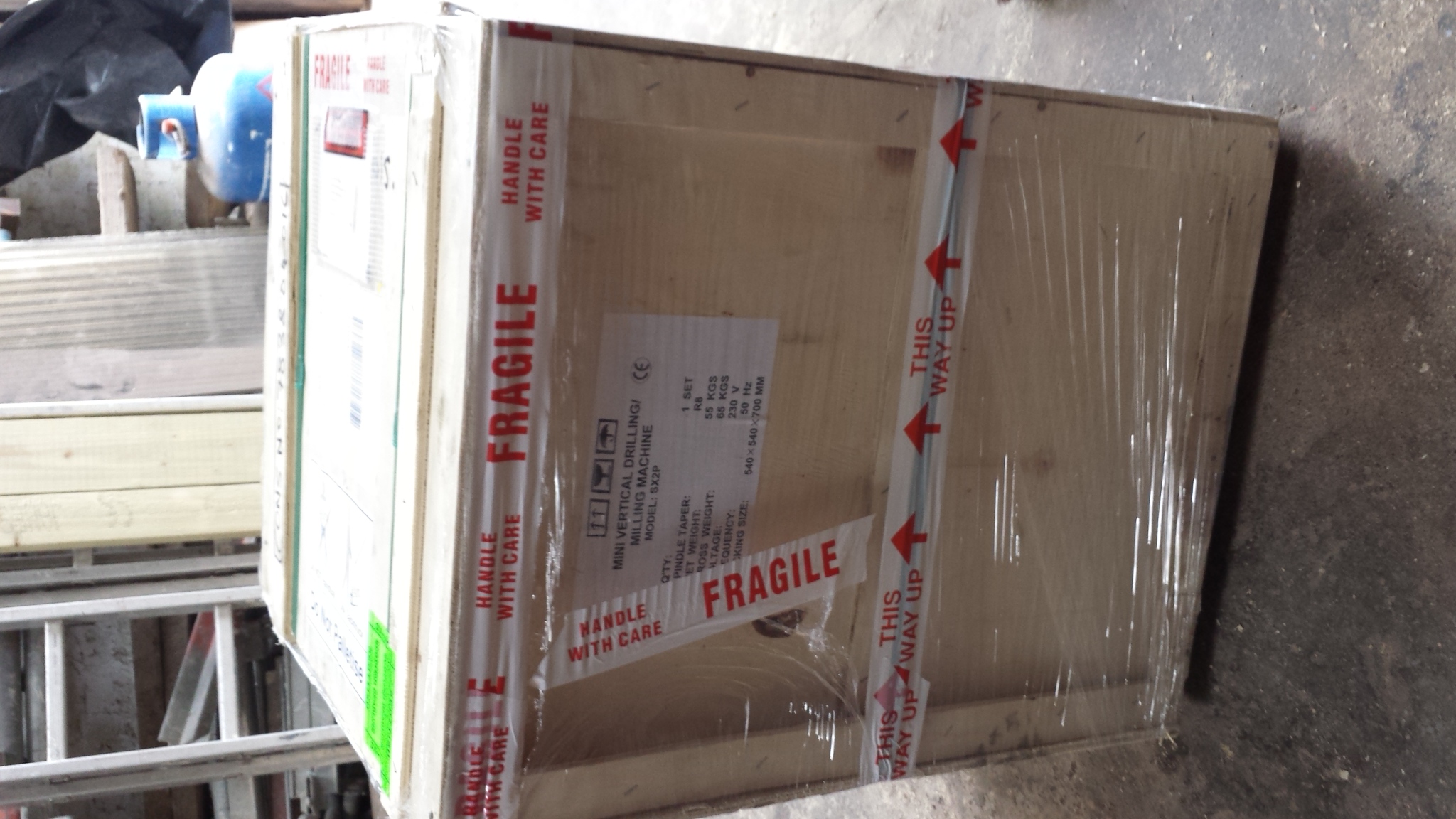

    The mill just arrived today and since this is not a very old and well commented on mill I though of starting a thread to try and answer any questions as well as ask a few.
    I ordered the mill on Arceurotrade to be delivered in Scotland. It was in stock so it only took three days to arrive from order.
    It was delivered by a TNT superman who lifted the ~70kg crate out of the van.

    I went for the R8 collet and metric graduations.
    The mill was in good condition with all accessories advertised and nothing was broken. Disassembling the crate was very easy, just a flat screwdriver was used. The manual that comes with is is much more comprehensive than anything I had found on arceuro's website.
