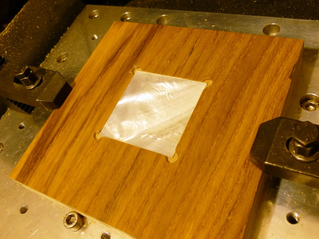

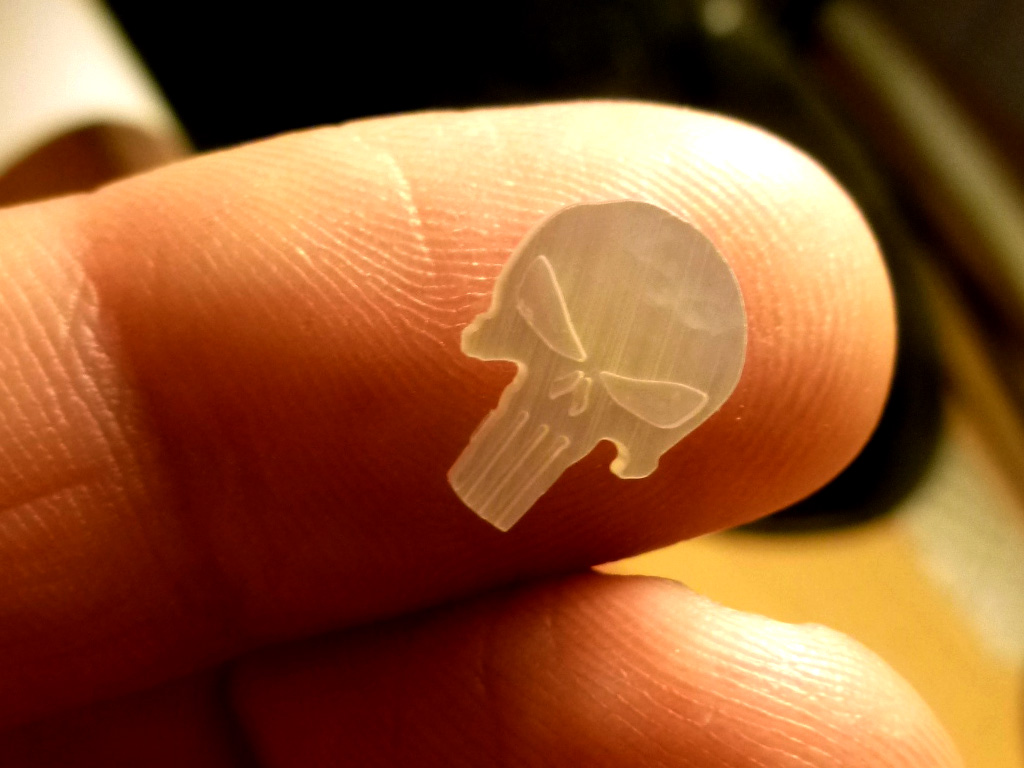

    I recently made a couple of custom logos in MoP. Based on earlier recommendations, here's how the (this time very successful) work-holding went:
    1. Machined a pocket in a flooring off-cut to hold the stock (very snug press-fit). Also used a bit of double sided tape and a couple of dabs of hot glue to help prevent the work lifting. Note the access points at the corners to aid in lifting out the work.
    2. Once cut, I shaved off the glue and then dabbed a few drops of meths through the shell and onto the double sided tape which let go straight away.
    I guess it's basic stuff, but if it helps someone out on a first job, then so much the better.
    Wal.

    Looks good Wal - well done and thanks for showing. G.

    We develop a thin film for hard works may be it can do the job better then your double sided tape, by the way what king of double sided tape do you use? please take a look at the movie. https://www.youtube.com/watch?v=PbCqkUomf5M
  10. #20
    Wal's Avatar
    Lives in Stockport, United Kingdom. Last Activity: 2 Weeks Ago Has been a member for 9-10 years. Has a total post count of 491. Received thanks 71 times, giving thanks to others 29 times.
    That is a strong piece of tape..! What's it like removing the work..?
    I use a generic double-sided tape, not a bargain-bin brand but not engineering grade either. It's pretty strong but to be honest, for the smaller pearls stuff I'm mostly just using hot glue around the edges of the stock nowadays.
    Less fiddly scraping off the tape..!
