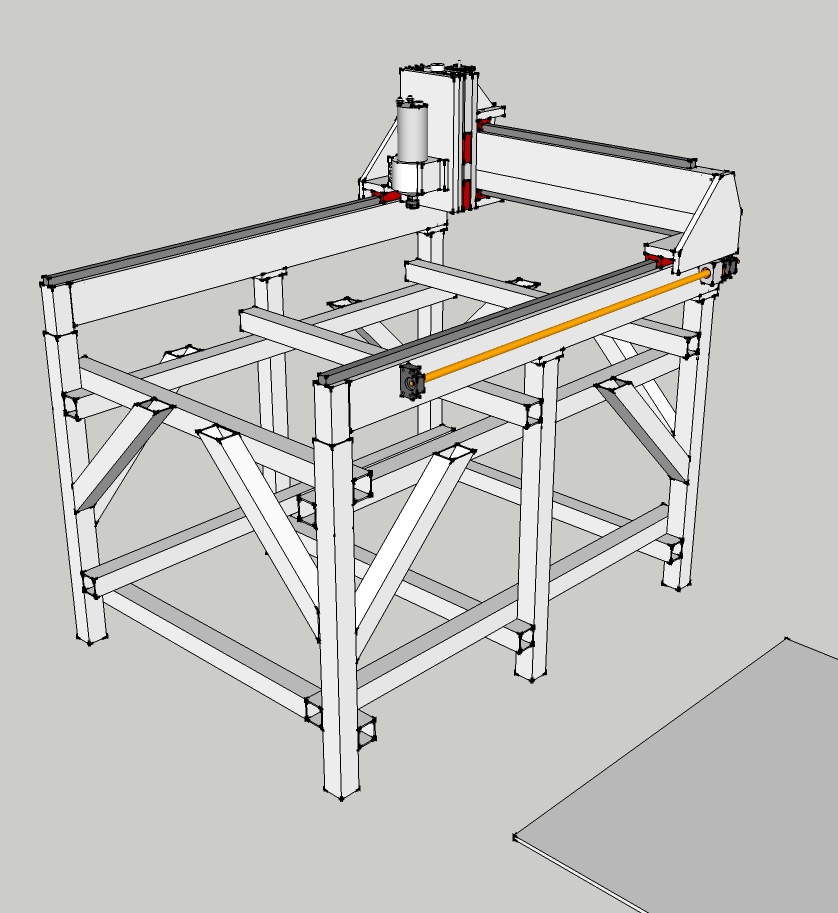

    Here goes, My 4th design with base, The base is made mainly with aluminium 2" x 2" 1/8th thickness with some 1 3/4 bar inserted at the bolting points (not added in yet) I will also have adjustable feet, do you think it will be strong enough or does it need beefing up.
    Also my redesigned gantry again! :-) there will be a 15mm plate across the back for the X stepper and pulleys to attach to but I thought I would post my plans before I start adding in all the details such as bolt holes etc.
    As before, feedback good or bad appreciated.
    Thinking more about the frame, I don't like it so maybe I will have to learn welding. My dad used to do it years ago and he's retired now so maybe I can get him onboard.
    Where is the best (read cheapest!) place to get cut to length steel including mitre cuts or would I be better ordering full lengths and investing in one of these:
    http://www.screwfix.com/p/evolution-...aw-240v/60839#
    Its £100 but says it will cut steel, ally, wood and whatever.

  6. #16
    Another question, Do all these plates need to be 20mm, If I make them 15mm will it affect the machining ability substantially? I'm on a cost/weight cutting exercise!

  7. #17
    Quote Originally Posted by CharlieRam View Post
    Well first I'd dump the gantry back plate as it adds nothing but weight with very little strength gain and unless perfectly machine and setup could cause you all sorts of trouble with bearings to binding up.!
    350mm rear plate and bearing plates etc could be 15mm but wouldn't change the front plate.
    Don't go chasing weight it will be your friend when cutting and if you need really high speeds with high velocity changes then put the correct motors on it and you won't have any trouble.
  8. #18
    Actually that back plate is connected to the ball nut so without it my Y axis will go no where!
  9. #19
    Also that Z axis design is bad news. Again check out threads and look at Z axis designs that put the rails on the front plate and bearings on rear. Your design is a constant length lever that won't even reach the bed surface and will give the same amount of flex whether it's at the bottom of top of it's travel. With the other design the lever length is variable dependent on material thickness or distance from tool.
    Hi Jazz, is that Z axis any weaker the way I had it? I am struggling for room and didn't want to compensate by reducing my cutting area, I have gone back to Idea 3 but raised the rails on X. I would still like to use the fourth axis along X and this would allow that, giving me an effective work area of 150mm diameter by whatever length travel I decide on.

  10. #20
    The normal convention for the Z axis is to have the rails on the front plate and the carriages/bearings on the back plate. This adds stiffness to the front plate which is where the axis most needs it. Also stick with 20mm plate if you can rather than 15mm. With regards to ballscrews two are way better than one, you undoubtedly would get racking with one central ballscrew at that width I would say.
