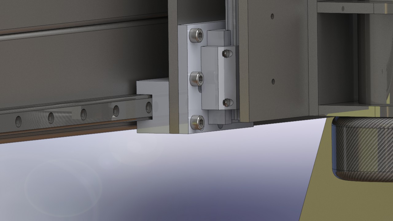

  4. #24
    wahoo
    my rails and servo kit has arrived
    but now to finalize the design to get building

  5. #25
    oops ..
    the problem now is how do i do the Z axis
    mount the rails so that they move ? or mount the bearings so that they move ?
    i realize that mounting the rails so that 'they' move is better as the forces on the rails are consistent and that the bearings are fixed ( as per the drawing) and .. that the bearings are maximized as they are directly bolted ontop of each other
    but ... the biggest problem is that the travel is now limited ....
    if i google z axis pictures, the majority is showing the rails fixed, and the bearings moving ... is it really worth the effort to do the visa versa ?

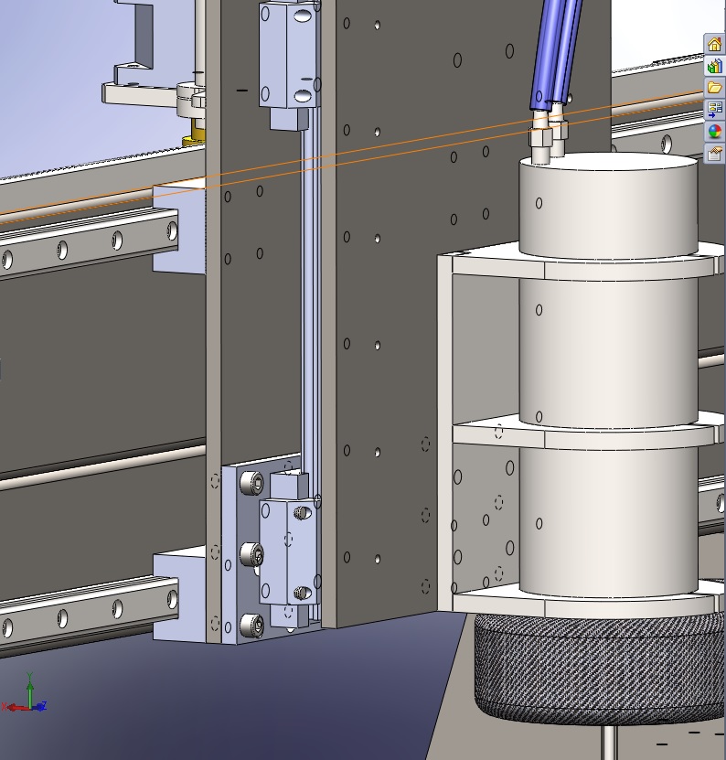

  6. #26
    i think this render explains it a little better
    the gantry bearings are directly onto the Z bearings which is great ... but i can only lift the Z rails until they are level with the bearings, which stops Z clearance .... sheesh i feel like im speaking Chinese now
  7. #27
    Clive S's Avatar
    Lives in Marple Stockport, United Kingdom. Last Activity: 13 Hours Ago Forum Superstar, has done so much to help others, they deserve a medal. Has been a member for 9-10 years. Has a total post count of 3,333. Received thanks 618 times, giving thanks to others 78 times. Made a monetary donation to the upkeep of the community. Is a beta tester for Machinists Network features.
    Quote Originally Posted by Blackrat View Post
    Why would you want to go higher than that you have shown, you can't go higher than the gantry so lower the bed. The Z rails (in my opinion) are better fixed on the plate that the spindle is fixed to as it helps to stiffen the plate etc. ..Clive
  8. #28
    to clear the work piece ... the bit will foul if it doesnt retract far enough
    dont really wanna lower the bed (or raise the gantry) as this will induce more flex , vibration , resonance and the list goes on
  9. #29
    Clive S's Avatar
    Well how about moving the z bearing blocks higher up the plate. ..Clive
  10. #30
    Its a part of my designs also to be able to move the spindle up to clear for a large work piece. But in real life that would mean realigning vertically the spindle, and its time consuming process. The only proper way to do this without fiddling is to make a custom mount and machine the spindle so they fit perfectly, as i make now on my machine now. But its expensive.
    having in mind at which stage are you and the prices of ball screws and rails for Z, if simply you made the error and bought them short, spend now 100 quid and buy new ball screw and rails, instead of compromising the whole investment. If don't have them, all the better. The Z should be made properly, not to speak that you want a high performance Z.
