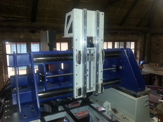

    Fitted and aligned the Y ball skrew and complete Z axis, so most of the mechanical parts are done now.

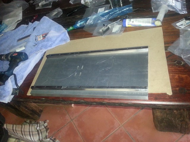

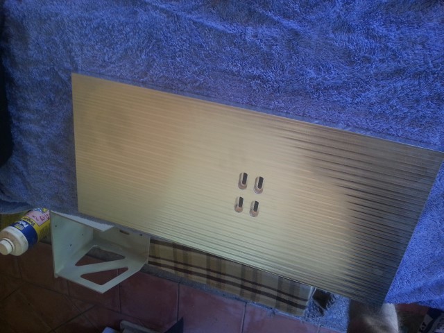

    z front plate before all the drilling and tapping
    Had to but join rails for my Z due to a change in plans. Was quite surprised as the carriages runs very smoothly over the joint with absolutely no click or resistance, so it seams feasible to join rails if one has to.

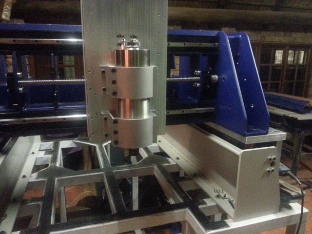

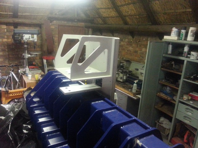

    z stepper mount
    100mm spindle fitted just to see if all the holes line up etc.
    Now time to start with the control box which is about where I run out of skill and creativety. Wish Eddy could pop over to my place to help a bit:-) I sort of know what needs to be connected but I cant figure out a good layout to do a neat job with routing all that wires etc.

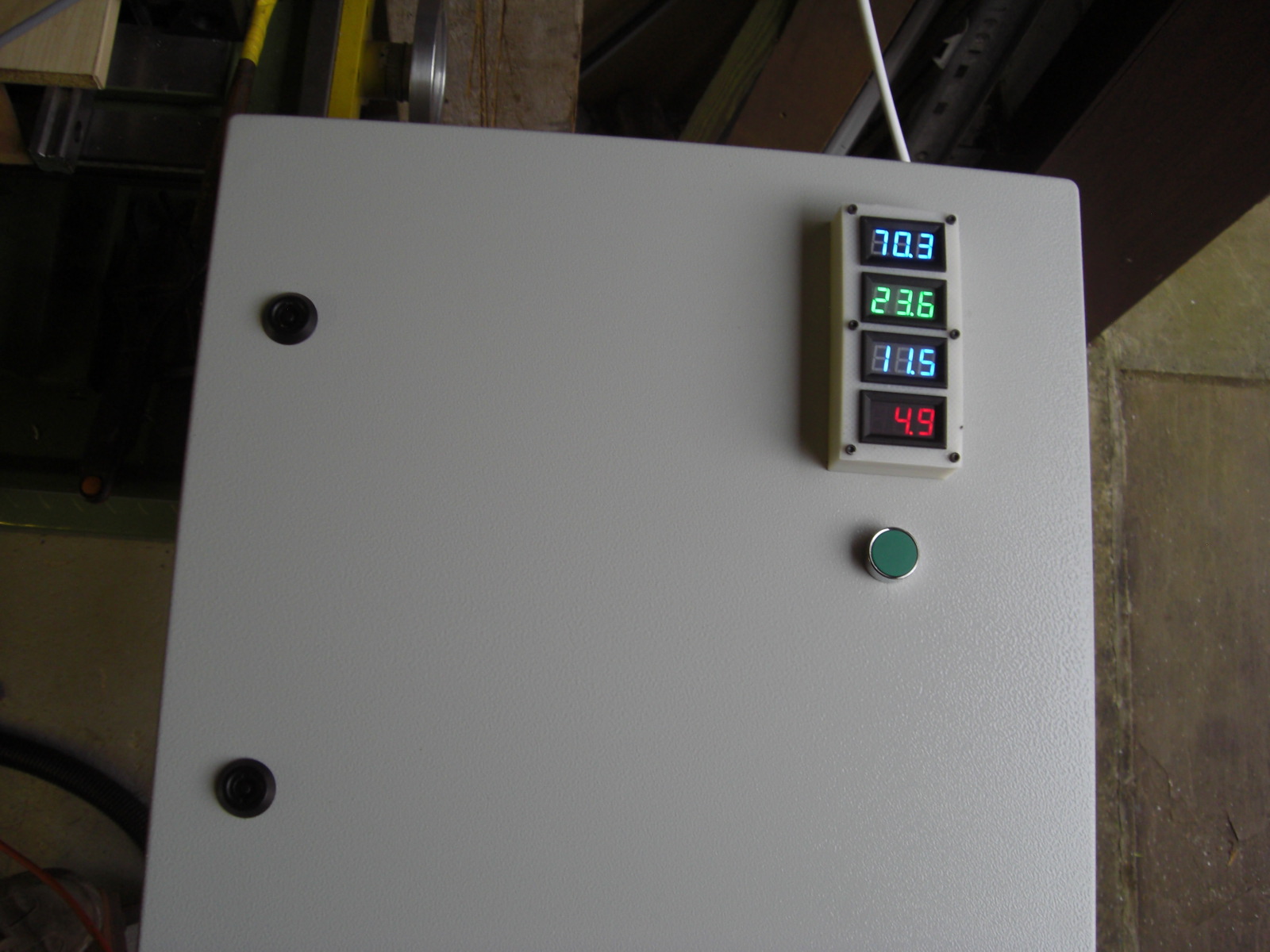

    Lives in Marple Stockport, United Kingdom. Last Activity: 23 Hours Ago Forum Superstar, has done so much to help others, they deserve a medal. Has been a member for 9-10 years. Has a total post count of 3,333. Received thanks 618 times, giving thanks to others 78 times. Made a monetary donation to the upkeep of the community. Is a beta tester for Machinists Network features.
    My other problem is that I don't have any tools to cut holes etc into a steel box so I have to factor that into the price.
    I see a pillar drill and hand electric drill in your shop. 600 x 600 x 300 should more than big enough, You don't need to put the VFD inside the control box. Just how big a box was you considering? ..Clive

    Clive, now that's a great looking box! Those LCD displays really got my imagination going... Can I extend the offer for free beer and sunshine to you :-) I'm a bit scared of butchering an expensive box with what tools I have. I have not done the layout yet as suggested by Eddy but I was guessing maybe 600x400x300 as a ballpark? Content would be 1x PC ATX Powersupply, BOB, VFD(vfd face outside the box) 4 x Drivers and few relays. The driver are quite big at something like 180x160x60 if I recall correctly and I would like some spare space for future expansion.
    Excuse my ignorance but what's those white square things in your box?

    I don't think you will get all that in that size box. I would think twice before putting the ATX inside the main control box as beside the board you would need a power supply, hard drive fan etc plus all the connecter to the monitor, keyboard mouse.
    The LCD displays were from China about £2 each, the housing for them was done with a 3D printer. The white square things are the 5V and 24V power supply's there also another converter to step up the 5V to 12V to power the motion control board. 24V for the E-stop and 5V for the BOB.
    I don't think many people on here put the VFD inside the control box. Remember most of these box housings have a bottom plate that you remove and make the holes for the connectors so if you f#%~k it up you just make a new plate.
