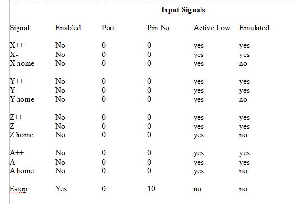

    Hi Neale, My working machining area is only about 450mm x 550mm with 150 on Z. I shall mainly be machining hardwoods and high quality close grain softwoods for my Guitar Building. Possibly some plastics. I decided on the Nema 23 2nm as they seemed the correct size for my requirements after reading many posts. Neither to big or too small. I knew that I would probably have problems with the combined board but could get better drives when I knew more.
    I have been looking in more detail at my config and feel I have some conflicts. I would be grateful if you (anyone..) could look them over and see any obvious problems..
    I have had to Type it out as I cant seem to get screen grab on my Mach3 XP Desktop..

    I hope these are readable, they look awfully small.
    I was turning enable on and off in Output Signals and noticed that on Enable1 (pin 12) did nothing if Enable 2,3 and 4 were off.
    If I turned on Enable 2 (pin 4) then the X axis works in jog.
    If I turned on Enable 3 (pin 13) Nothing moved..
    If I turned on Enable 4 (pin 5) then Axis 4 and Z work.. in jog..
    Hope that makes sense..
    This is before I get to Motor Tuning..
    It looks like you have pin 16 configured twice which won't help (you can only have one pin configured once only for each port).
    Are you using two motors on one axis if so have you configured slaving in Mach. ..Clive

    I intended to slave 2 motors together on the Y axis but on the board that channel appears Duff (to the best of my checking ability) so, No I haven't knowingly done any slaving.

    Quote Originally Posted by Marlin View Post
    Are you running Mach3?
    Well I am not sure what you are trying to achieve. i.e. try and get 3 motors working first x,y,z and do things logically, don't keep jumping around. You have not said if you have sorted pin 16 out.
    Yes I do run Mach3 and linuxcnc not sure why you want to know though.
    I suggest you ask one question at a time and stick to the point. Sorry if this is harsh but there is no point in writing a novel. ..Clive
