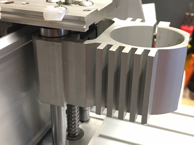

    I bought a 3040Z machine and am building it up, it's for hobby use and cutting parts for my model helicopters.
    I'm good with electronics and mechanical builds but while trying to establish if I can replace the Z axis carrier/spindle bracket (which will then allow me to attach different spindle brackets) I messed up with the ballscrew and it came apart. So I now have two challenges and would very much appreciate your advice.
    1. As you can see from the photo the spindle carrier and bracket has been manufactured from a single block. I would like to replace this with a carrier to allow me to fix a new bracket onto it. What options do I have?
    2. Do I now need to replace the ballscrew

    I have one of those too. Apart from the electronics needing seeing to( drivers, cables, switches, safety circuits, motion controller) it is a cute little engraver.
    When a ballscrew gets taken apart and all the balls fall out, as long as you have all the balls, not everything is lost.
    I cover the inside tracks in clear grease or vaseline and just stick the balls in one by one. this is not recommended on every ballscrew mind you, only on cheapo ones. There is a youtube video demonstrating this I think.
    Otherwise new ballscrew and nut I am afraid
    The spindle mount is an extrusion that you can remove and replace with a carrier plate and bearings housings.
    The bushings pushed into the extrusion can be removed without losing the ball bearings.

    I'm not entirely sure I have all the bearings. I see that the nuts can be purchased separately is that an option?
    Are there any places in the Coventry area where I could go (parts in hand) to sort this out?
    Thanks again!
    You cant really just select a nut as in many cases they are manufacturer specific and may cause issues. Not sure about coventry but I there are a number of places around that can custom machine you one if need be.
    Now here is another option: can you measure the diameter of the balls that fell out. I may be able to get some for you.

    I'll send you a picture of the supplied clamp that I'm having machined. I think the original is 52mm. I too am a noob at this but if there is a lesson for me to take away from this it's this issue with the clamp and the carrier.
    I personally got a bare bones type of thing and upgraded various bits like the spindle, motor etc etc. My spindle is 400W, I wanted a 1.5KW version but the cost of that and the power supply and the hassle of changing out the mount I just compromised.

    TBH modifying the carrier so it's possible to mount alternative spindles has been quite a problem and am in the process of having it done by a machine shop.
    The compromise I'm making is that I am settling for a 400W brushless motor (I don't like brushes LOL). I would have liked a more powerful alternative but the cost for that and a suitable controller means I'll have to wait a while. But when the bracketry has been modified it will be an easy upgrade..
    I will send a picture as soon as I get it back from the machine shop.
