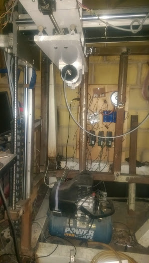

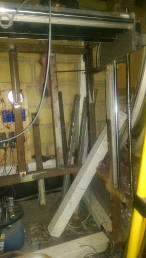

    Any chance of a picture of the whole machine?
    All I could see skimming the last few pages of that build thread was close-ups of random bits of it...

    If you read through the thread you'd see they weren't random closeups. I try and get a pic of the whole thing tonight.
    Afraid this is the best i can get for tonight as its tucked away in a corner
    Left side....
    Right side
    Looks like it dropped the pics. Take 2..
