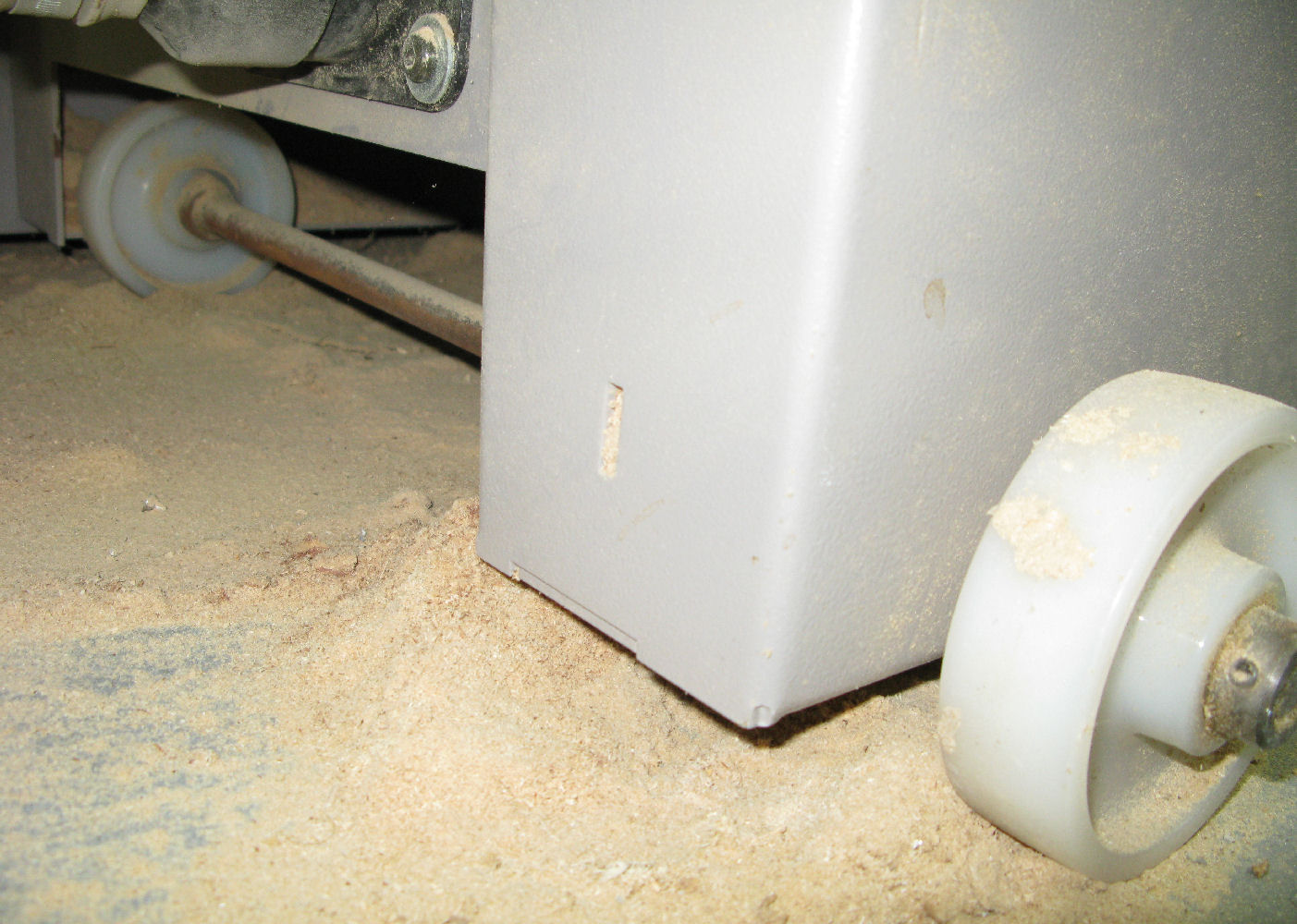

    Just going out now but will reply better later, however for the wheels design have a look at this video, at about 4:20 min. into the video it shows how to move it, I have one of those machines and the idea works great. It's two fixed wheels at the back and adjustable height feet at all other points.
    http://www.youtube.com/watch?v=J2ry1DxNFA0
    Thanks Eddy. It looks like a simple solution, but I would not want the machine sitting in wheels all the time for rigidity. I need a simple mechanism to raise and lower the legs or remove them. How do you remove the two rear wheels?
  2. #22
    Quote Originally Posted by Tinkerer View Post
    The wheels are solid nylon, they sit on a solid shaft across the back of the machine, there is no movement of any kind when it's sitting down. There are several feet at the front and side and the wheels are positioned such that the machine is level when it is sitting down on the feet, in this position the solid wheels also act as feet because they do not swivel or move sideways, it's rock solid.

    Thanks Eddy for going to the trouble to take photos. Now makes sense. I have already got some steel castor wheels (won't burn with plasma). Will look at Felder? design and also exploring a less complicated solution (than my original) I found on another welding forum where castor wheels were simply slightly raised above ground and then lowered via adjusting the legs, albeit this approach may be more tedious to get it mobile. Will dwell on both solutions!

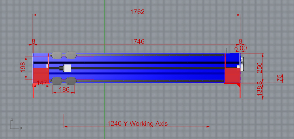

    Here is another attempt at the pictures. In uploading these, I advise that I have undertaken considerable re-design of a few items (after many days thought) and looking up physical sizes of required components. A summary of changes is given.
    1. Gantry
    I now have two designs:
    A. A design similar to yours (Silyavski) which utilises welded RHS and SHS (per pictures previously posted but not seen),
    this utlises 125 x 100 x 4mm RHS (top and bottom) and SHS 100 x 4mm (8mm at ends where I intended to bolt bearing supports but now moving towards bolting supports to Red Plates).
    Note Y Axis will now be moved to back of Gantry (see below).
    and
    B. A single bespoke RHS shape, made out of 5mm plate (using 8mm for sides) which utilises key slots and tabs (some refer to this as 'toy slots' resembling construction of early steel toys. Beam is reinforced by two internal welded plates in the structure.
    This later design appeals to me as the components fit together for greater accuracy and welds are more focussed. A draftsman friend of mine told me about the significant inaccuracies (twists, etc) inherent in extruded beams (apparently manufacture starts from a round shape which is then forced into a rectangular or square shape?). He works for a large American firm and they apparently fabricate most heavy industrial components (for heavy waste removal trucks etc) out of plate using this method.
    I would have to get components for this design laser cut (he says this is relatively inexpensive - he works for a corporate who pays the bills - will see whats this means to a private budget!). Meanwhile I perfected my technique of drawing Toy Slots.
    About to investigate the cost, but waiting feedback from my friend and others before doing so.
    1.1 Gantry Drive (Y Axis)
    Well the added weight has forced me to consider NEMA 34 motors. After looking at the increased footprint, I decided that I should mount the motor on the back of the Gantry like some other designs. This would marginally improve COG as well, but not a big issue.
    2. X Axis
    Larger motors and a more careful look caused me to make some minor modifications to brackets. Silyavski, I compared what you built on your first build, and I have headed towards a similar design.
    I also moved the motors to the back of the machine, away from the operator and closer to the control box.
    3. Z Axis
    More or less the same, but I have also included 'toy slots' to facilitate easier fabrication/more accurate assembly.
    This design is all steel and requires laser cutting/ machining. The front plate carrying the Rails has 2 of 20mm x 20mm support beams to provide rigidity with the balance of the face plate 10mm. The side plates are constructed of 20mm plate. All 'Toy slotted' and welded. Top plate 10mm thick.
    Using the Siffness calculator I believe this will give me a reasonable stiff structure with deflection below 20um in various directions cutting aluminum. I think! It certainly has added to the weight of a purchased actuator which is now a scrapped notion due to their weak structures.
    Happy to listen to any views how to do this differently.
    Perspective View of Machine
    Hopefully these pics are now viewable (I know I got close to the limit last time I posted them and perhaps why they did not appear?). Please let me know if problem persists!
    If anyone can consider these with questions posed in my post of #16, I would be very grateful.
    One additional question is to do with attachment of support bearings. As mentioned above, I am leaning towards bolting the supports to the plates at the end of the shafts, rather than to the side of the frame/gantry. My rationale is I can control spacing easier (or perhaps not), and that plates offer a flatter, 8mm surface to bolt to. What is the preference/others' experience?
    Pictures look good I'm told. Proof of competency will be the building of it!
    Richard
