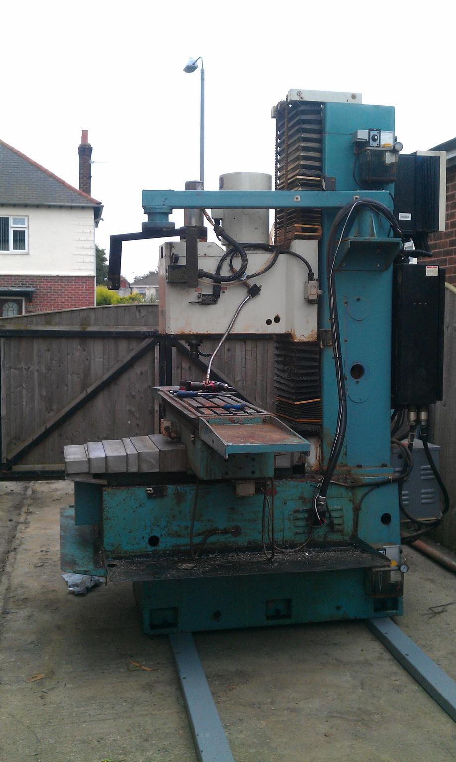

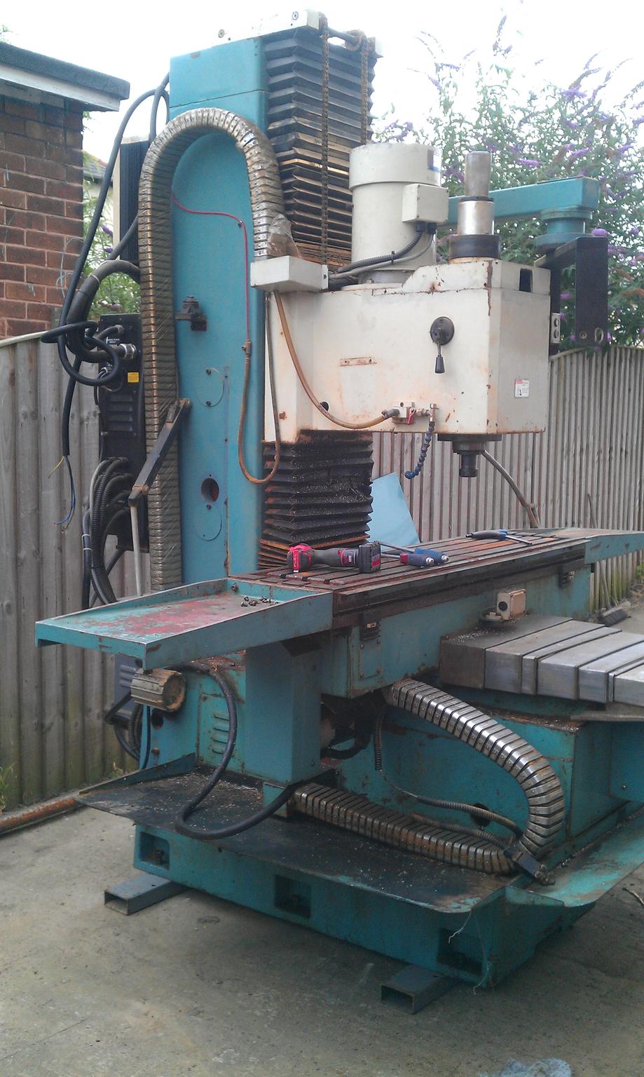

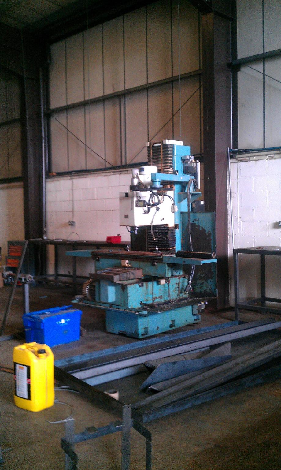

    Well Not often I post Build threads is it.!! . . . Monster Blu I'm calling this beast. Mostly because The air was blue while moving it around. Because like the pics show she's a Big Lass with plenty of meat on her bones and doesn't want to move willingly.

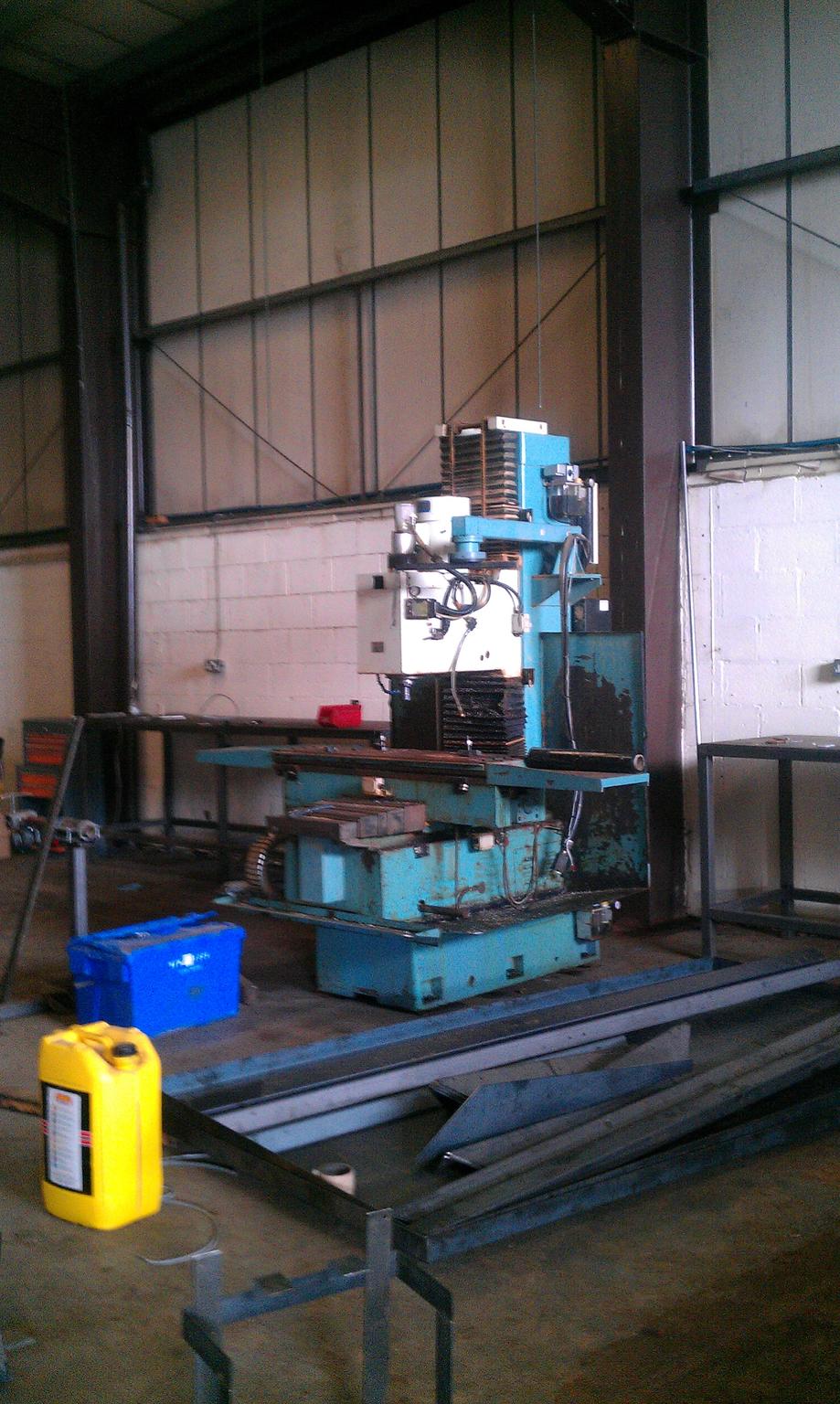

    It will be a Longgggggggg drawn out build thread so don't expect regular updates or it running within 3wks. I've had it 12mth and it's only made it half way up the yard. Still not made it into the shop yet so poor thing is stripped naked and undercover outside. Thou She is only 2.5 half Routers away from making it onto the shop then it's action stations.!!

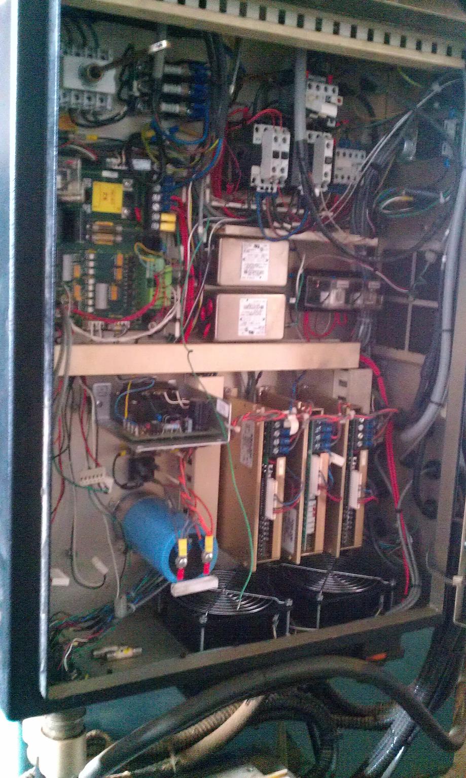

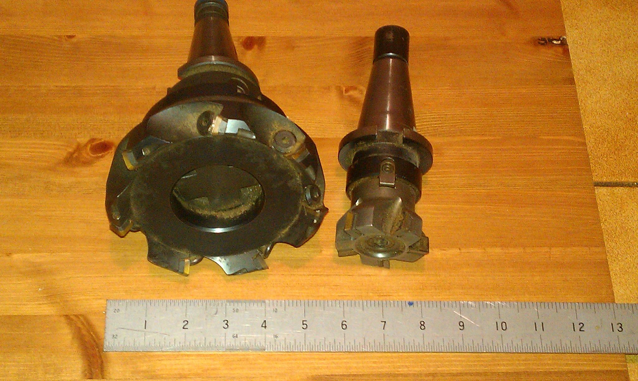

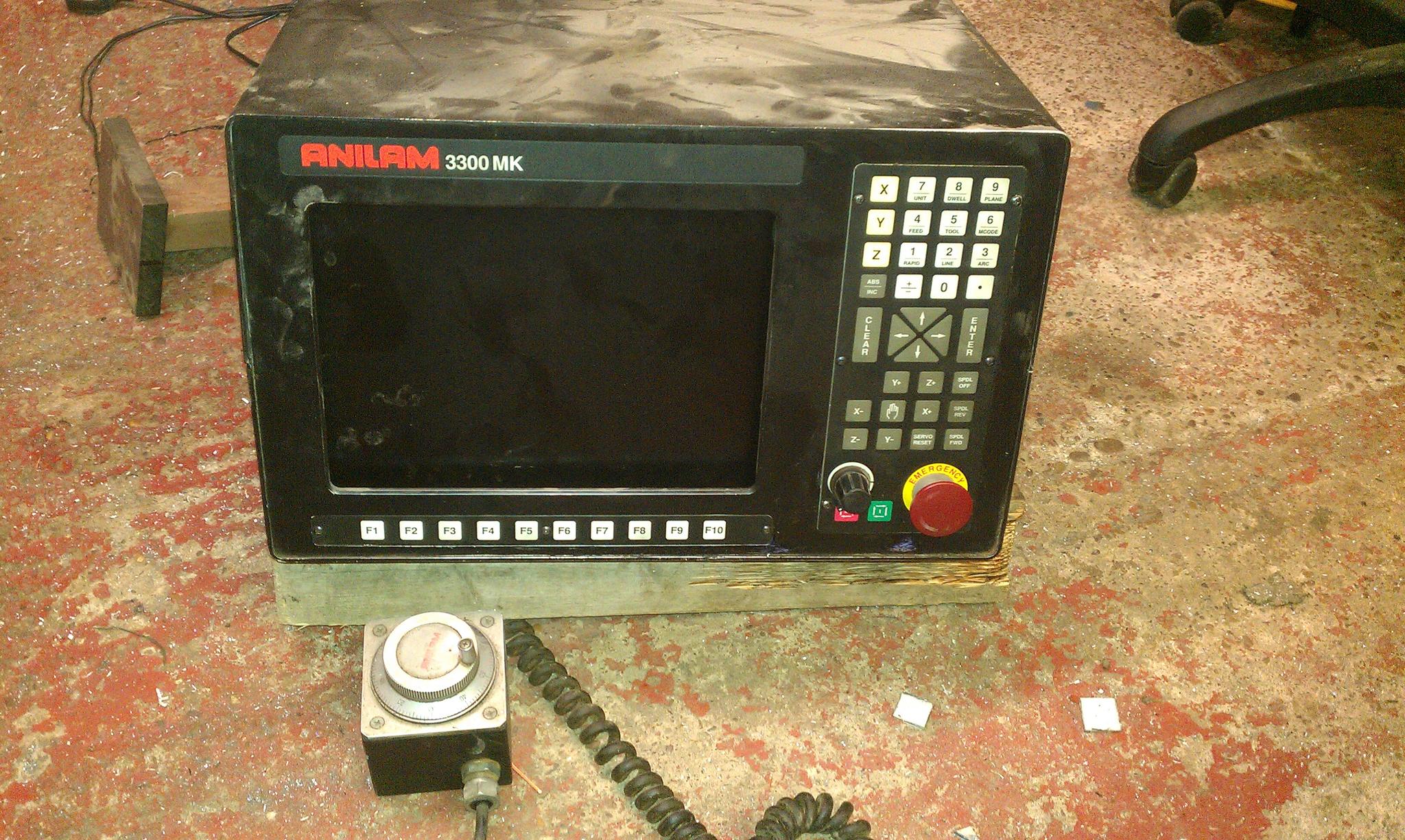

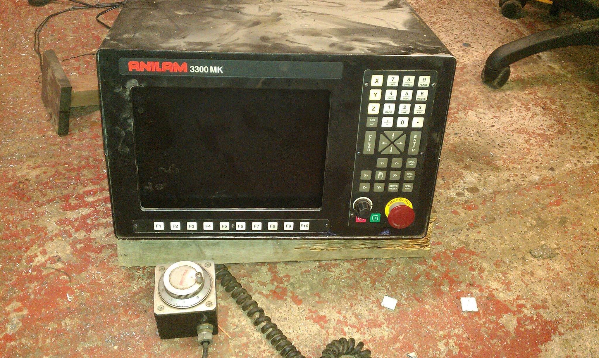

    Anyway The Machine is Circa 1995 SEMCO 1000 CNC Bed mill. It started life has CNC machine so not a Retro fitted Manual machine so is fully kitted out with Ground ballscrews etc and nice smooth Box linear ways.

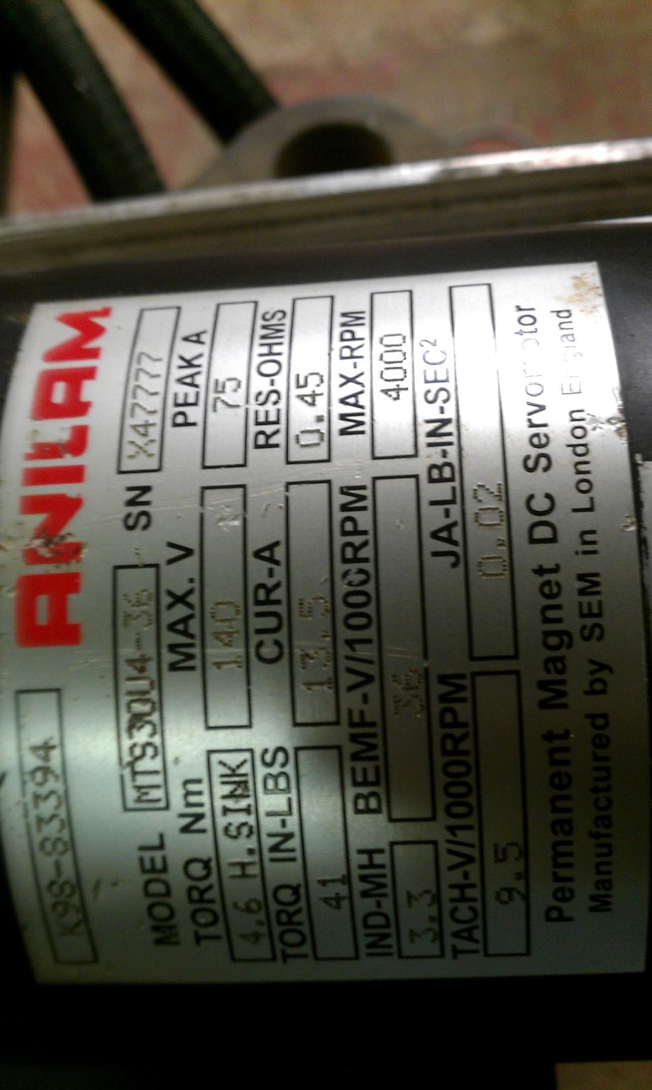

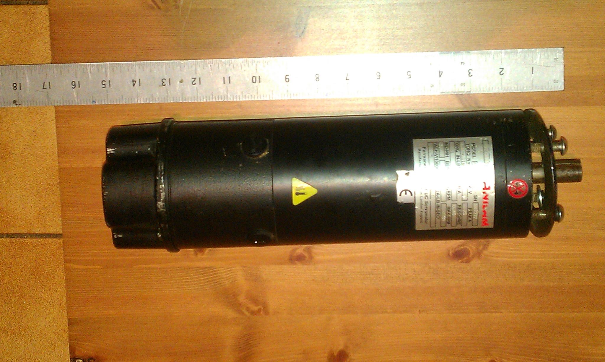

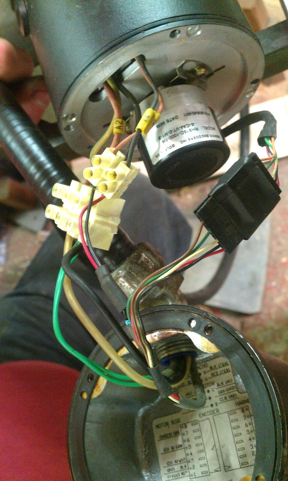

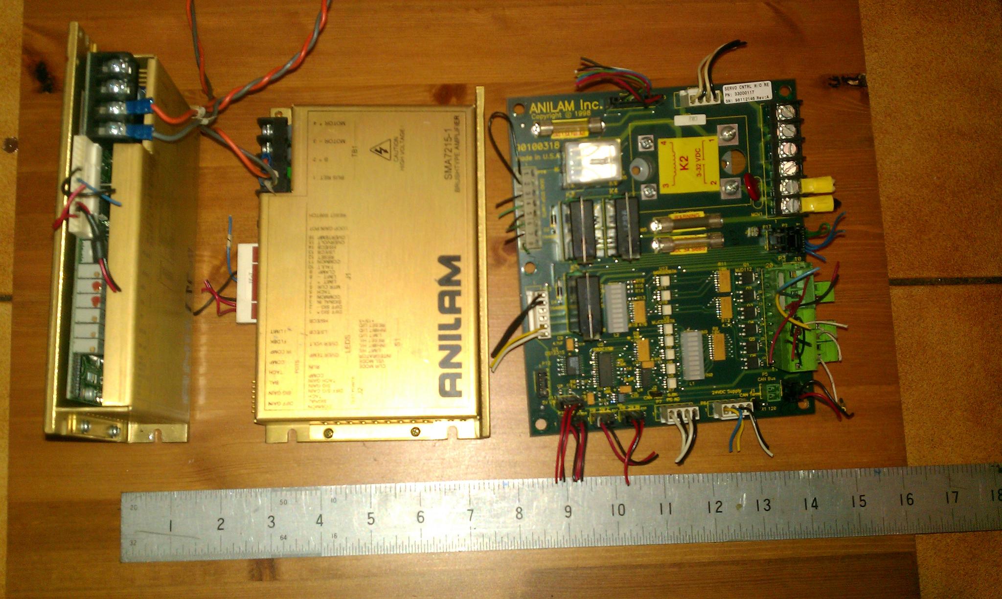

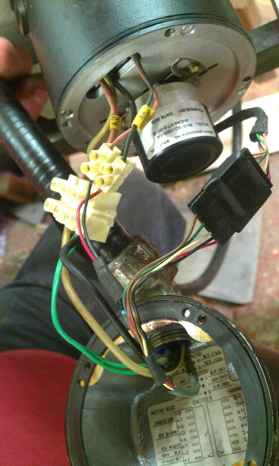

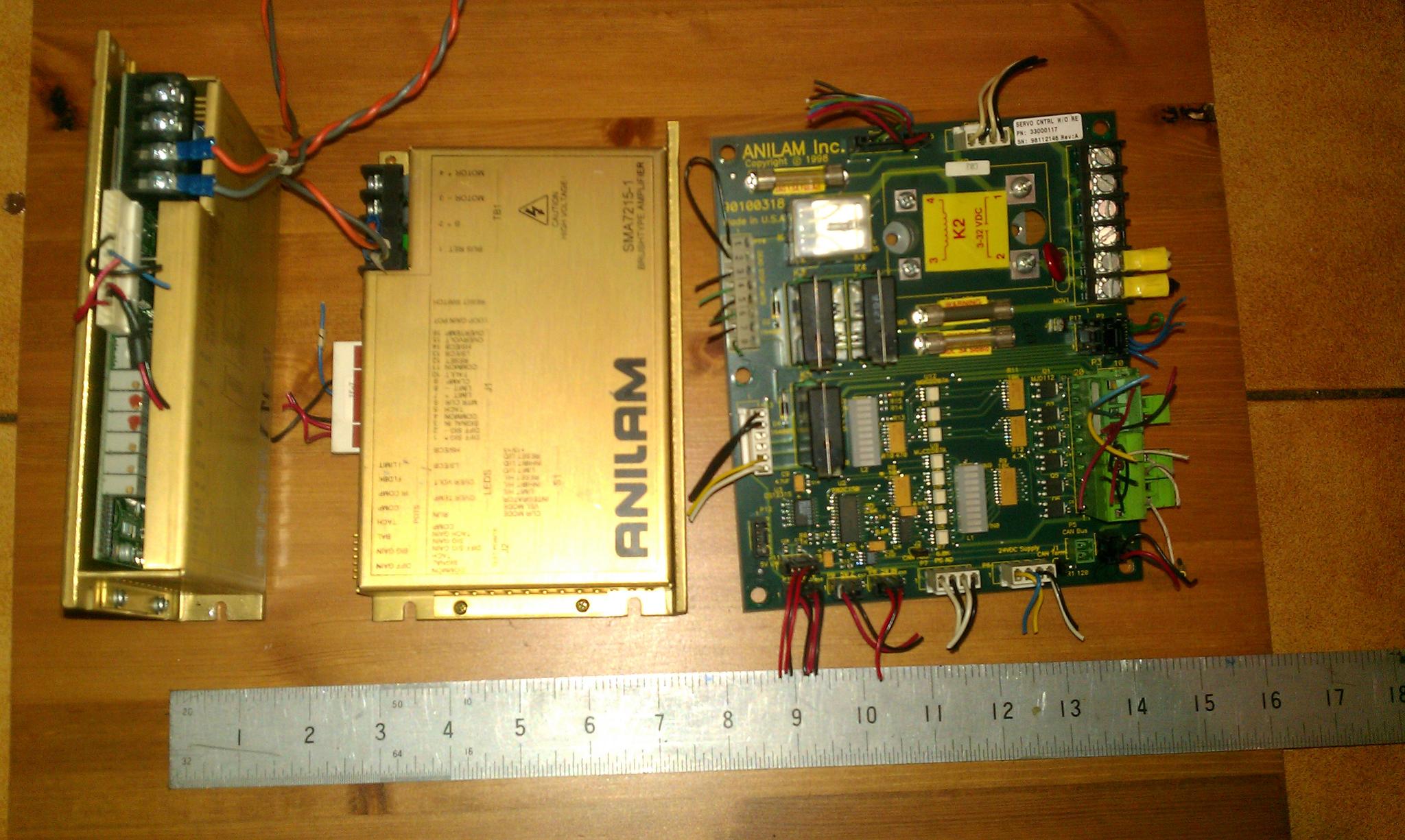

    It was running a Anilam Mk3300 Controller along with Anilam Analog DC drives connected to SEM DC Brushed servos.

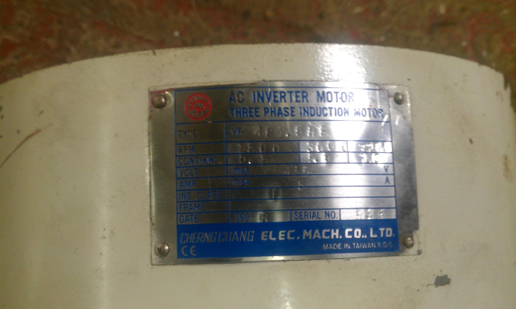

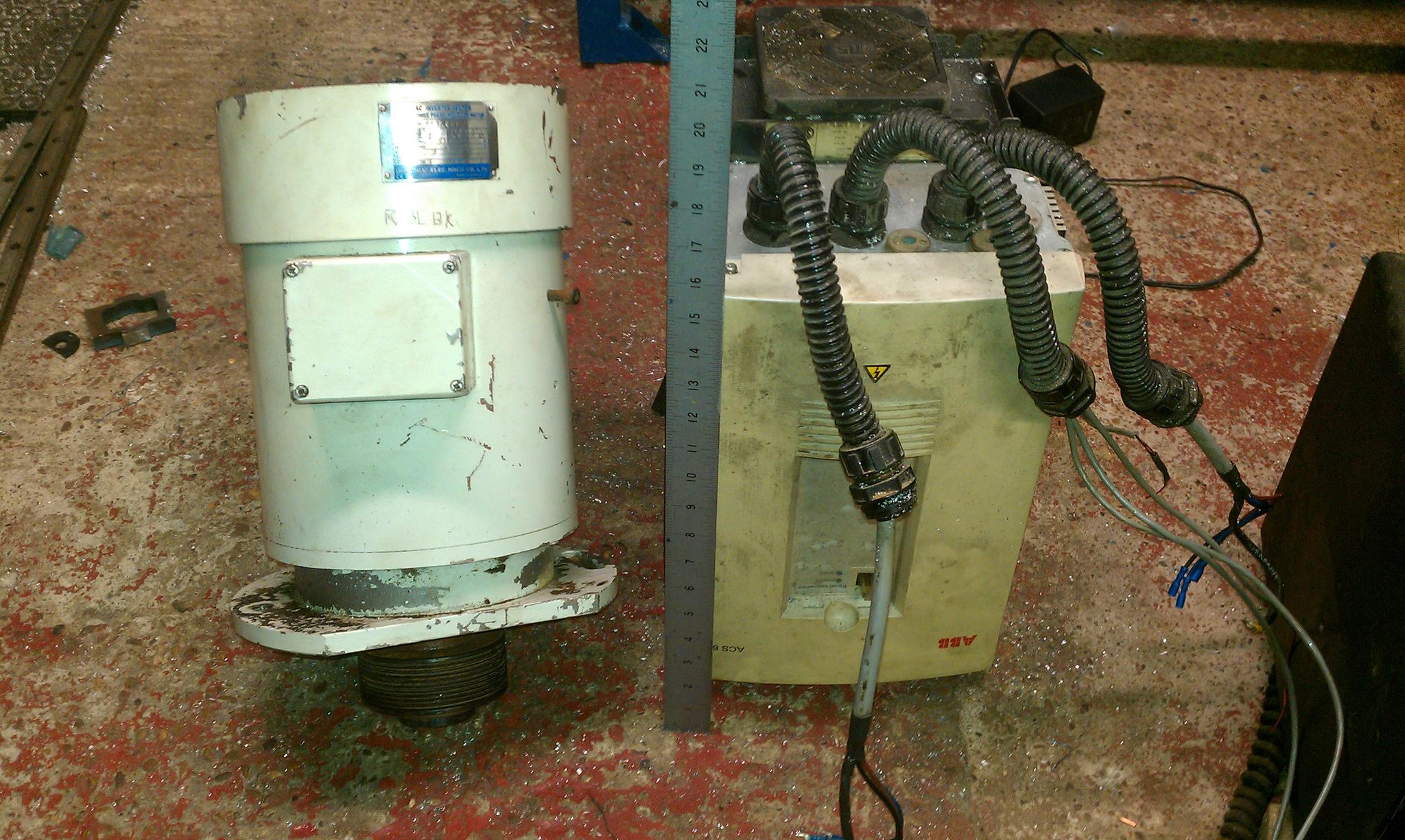

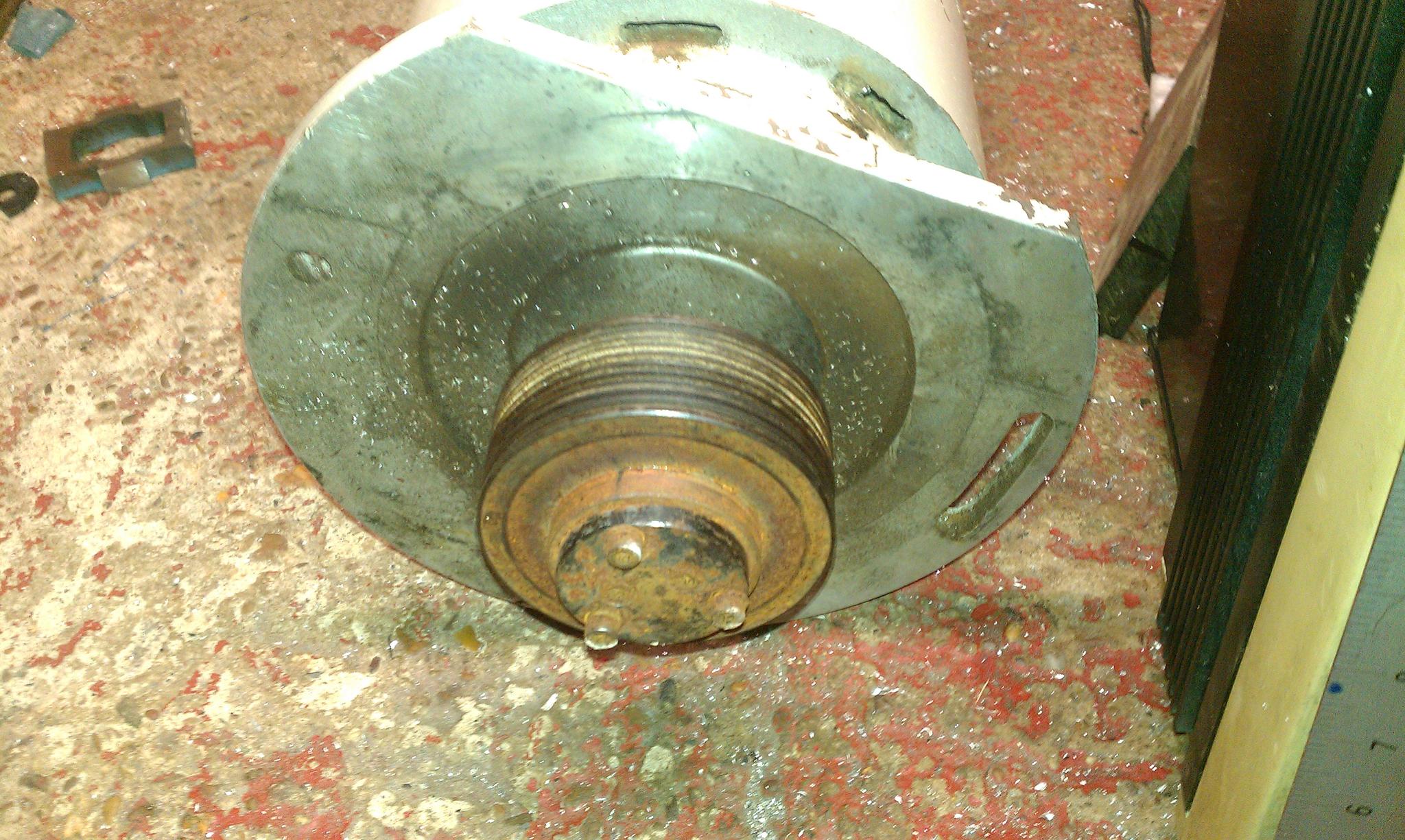

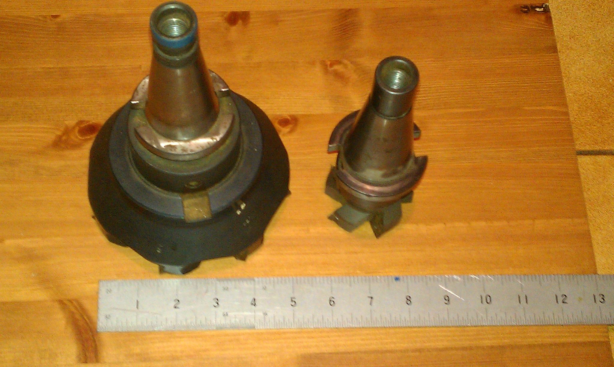

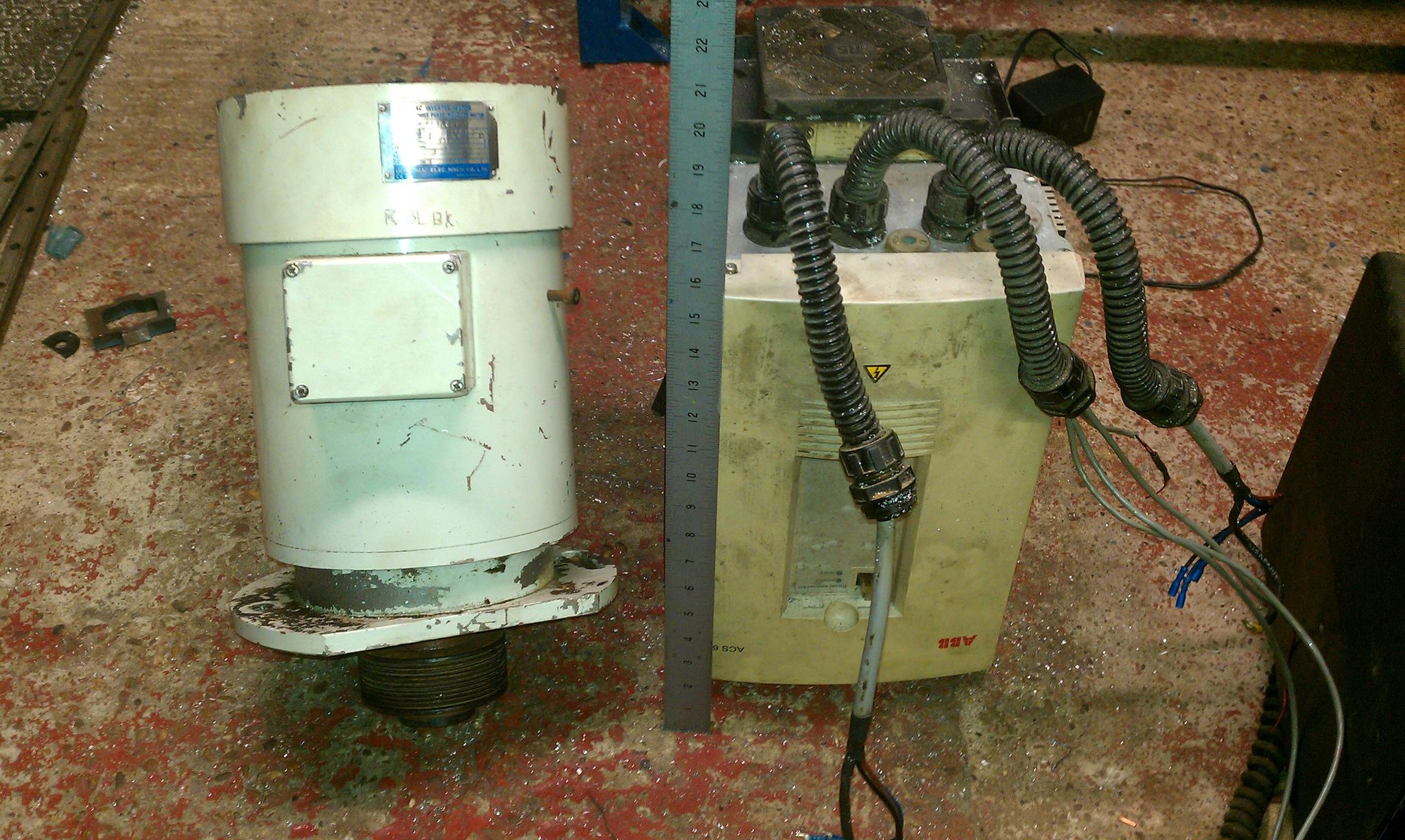

    Spindle is 7.5HP INT40 taper with Back gear and Air operated Draw bar. Motor is Max 7500rpm AC Inverter motor running off ABB AC600 VFD for speed control so not a geared head, Bloody thing is massive and All 3 Phase.
    Most of it was working when I bought it except the Control needed a PSU to get working again. Thou I briefly got it to come to life I never intended to use it this way and the plan all along was to upgrade with a Modern Controller and Mach3 so it was first thing removed.
    Now the original plan was to just replace the Control with a Analog controller and re-use the DC drives/Motors and see how they held up.
    If didn't like them or they played silly buggers, which Old Analog drives are known to do, then I'd look at replacing with AC servos.!! . . . Well.!! . . That was sooner than expected, much sooner when one of the Drives decided to depart this life just on the bench so the decision to go AC servo was made for me there and then.!!
    The next problem was funding this easy decision.!! . . The Old SEM Brushed DC motors where Big buggers with some grunt so wasn't talking 400watt servos here.! Quick bit number crunching showed 1.5Kw was smallest I could get away with 1.8Kw being better. I didn't want to de-rate the machine ideally so wouldn't go lower than 1.5Kw so went for 1.8Kw for little safety margin.
    So After looking around getting some quotes etc then after picking my self up off the floor I decided to Head East to my Chinese friends which you'll see the result of soon.
    So with my quick "Sling a controller on it" Plan Fubard it's turned into a full blown Gut and start again job and Hence why it's been sat in the yard 12mths. That and finding time is like finding rocking Horse shite.!
    The state of play at the minute is the machine is stripped of all it's external components and electrics being just a Chassis greased up under cover in the yard waiting for some TLC.
    New plan is to Start from scratch with full rebuild and paint Job. I'd like to have some kind of enclosure around it, or more than is on it now. So I'll look at what's involved to make this happen without getting silly.

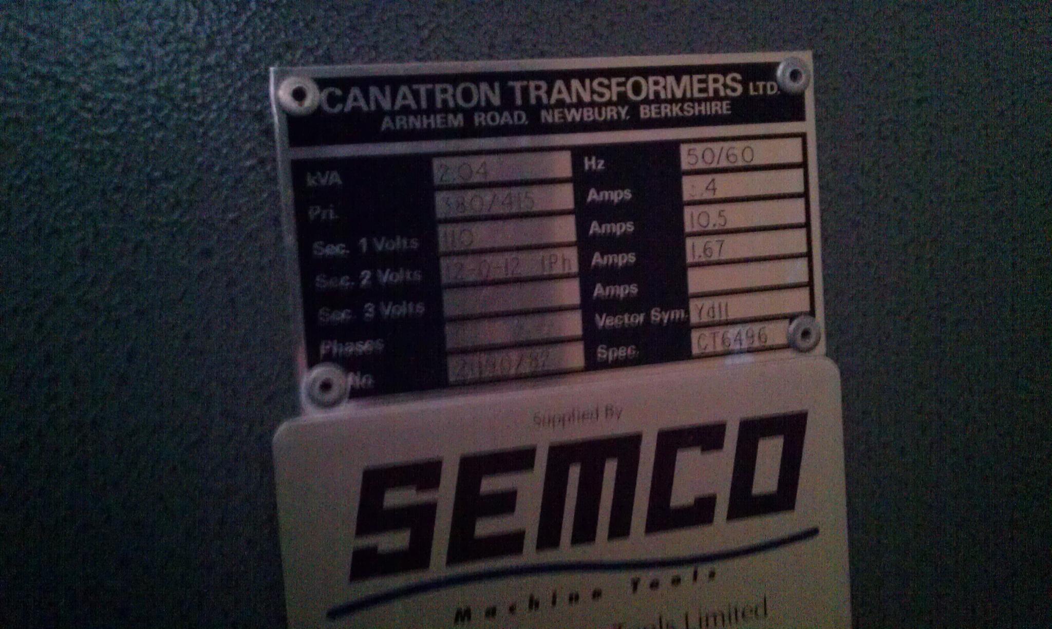

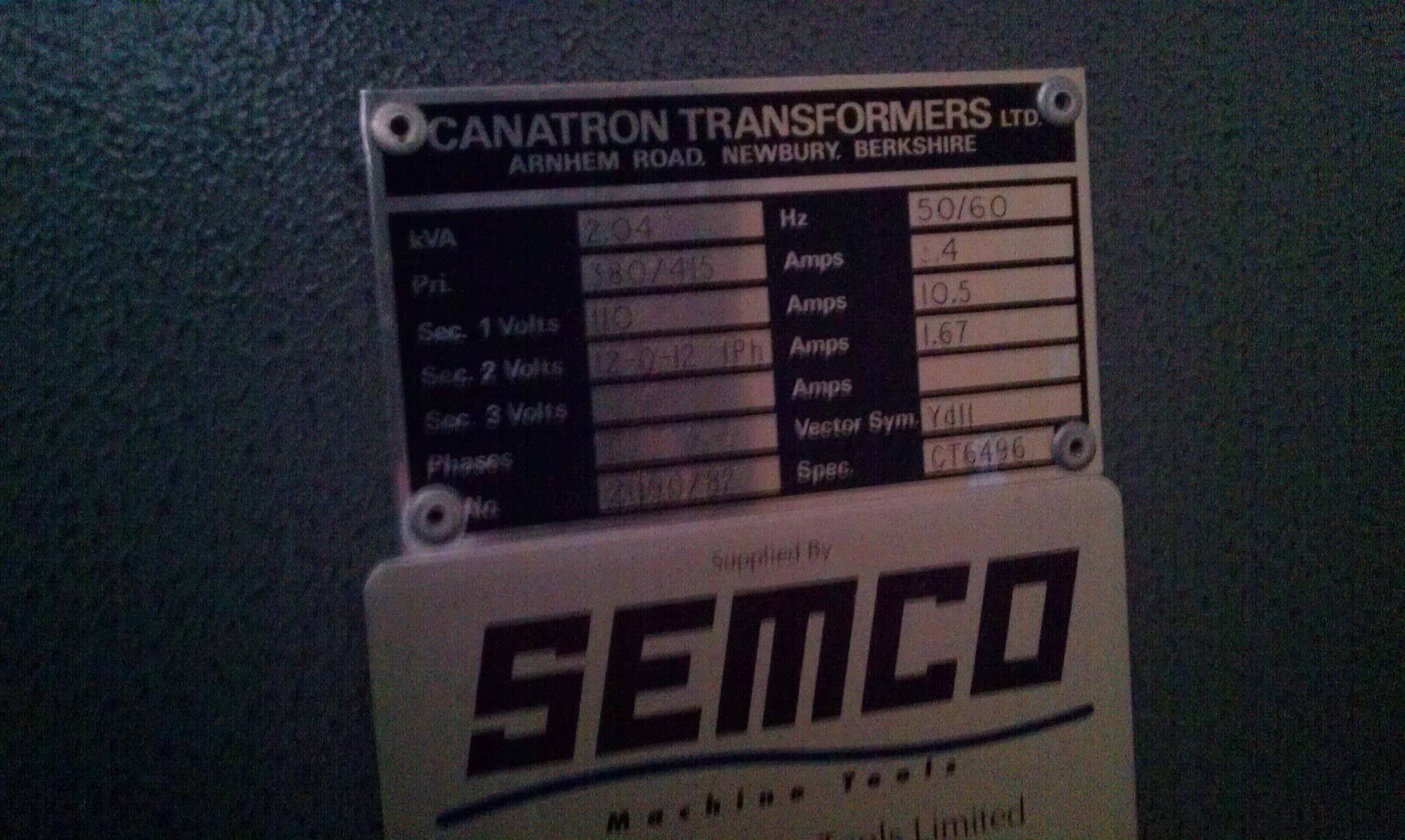

    Need to look at powering the Spindle/VFD has it's 415v 3phase which I don't have at home. I do at my work unit but this is Living at home. Several Options here None of them Cheap.!!

    I'll be interested to see how you drive a 7.5HP spindle off a domestic supply - that's going to dim the lights when you fire it up! But by the time you get there, I'm sure you'll have a solution...
    Probably with one of these Digi phase converters which are a more balanced type of Rotary converter that are suited better to sensitive electronics like in VFD or CNC machine. Not cheap thou to buy or Run.!
    http://www.digi-phase.co.uk/typef.htm
    Did consider a 240 to 415 VFD but not sure they will do the job and I've heard they are a little Dirty regards the feeding crap back into the grid which can't be having if running Servos. Neighbours or YEB i'm not too bothered about but servos taking off or giving grief I can't live with. . .Lol
    Any other suggestions greatly received.!

    I had a similar but smaller-scale problem recently, which is why I asked! I have a lathe with a 3HP/2.2KW motor, 415V/3ph, of course. Without major dismantling and rebuilding the motor, I couldn't do the old delta-star conversion trick. I ended up buying a 240V-415V VF inverter, which is fine up to a point, and that point comes when there is heavy load on the inverter. I run it at 50Hz as the lathe has its own variable-speed drive but although the lathe should go up to 2500RPM, above 2000 the load (not cutting, just idling so to speak) is sufficient to trip the inverter. The problem isn't load as such, but the fact that the input is single-phase rather than the three-phase that it was originally designed to use, compounded by the fact that there is a rather crude voltage doubler to go from 240 to a nominal 480 in front of the inverter. If I could find a big 240-415 transformer that would help. That lot runs off a dedicated 16A supply which is fine. I suspect that if you look into it, the cheapest option might be to go for a three-phase supply to the workshop. It might be cheaper than a massive inverter. Still, you've got plenty of time to save up the pennies! Like everyone else, I'll be watching this one with interest.
