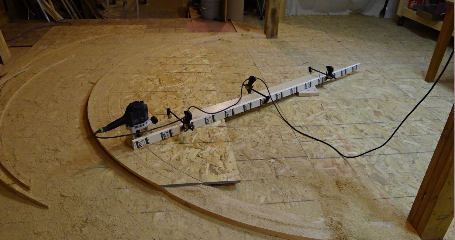

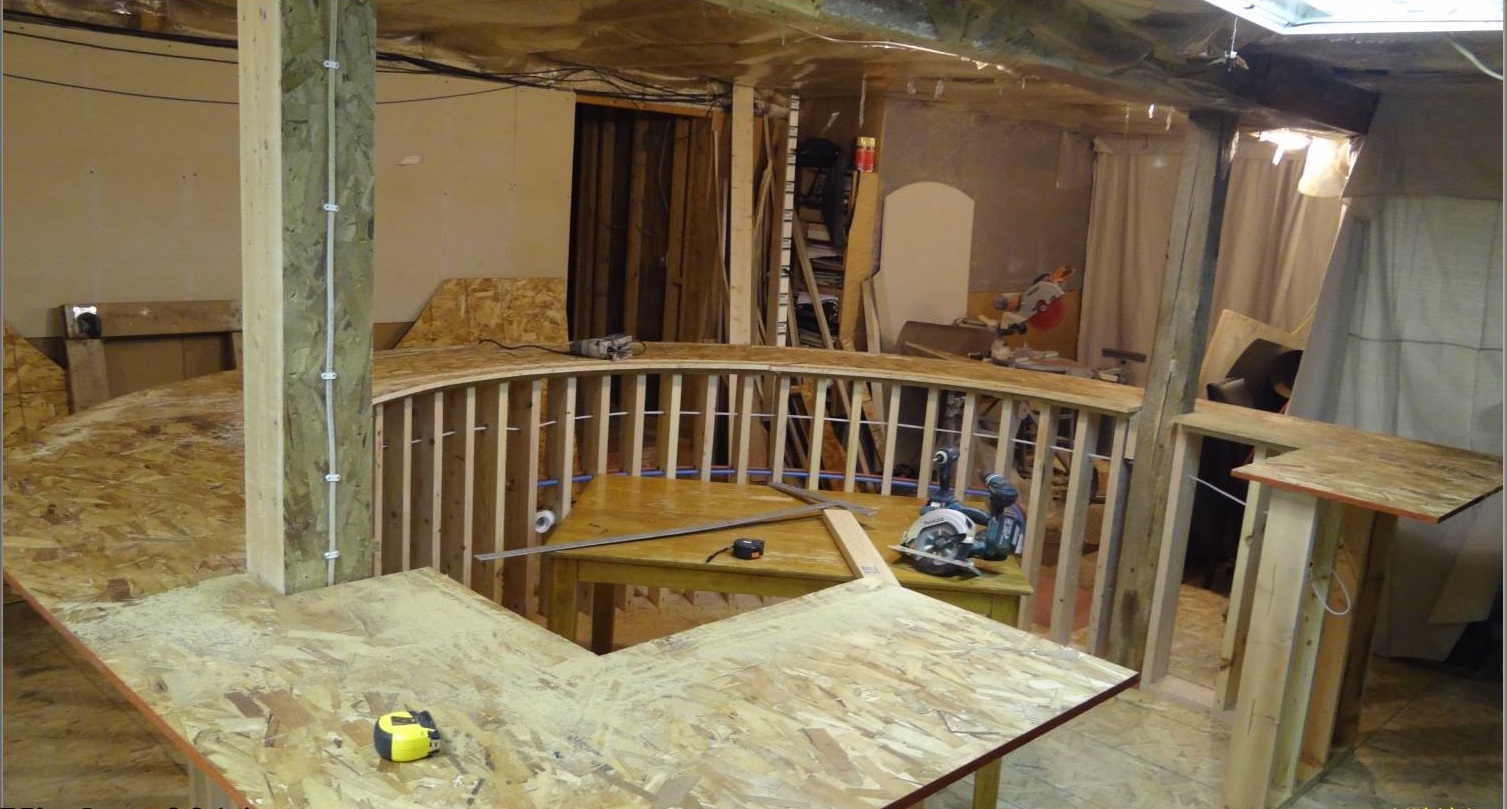

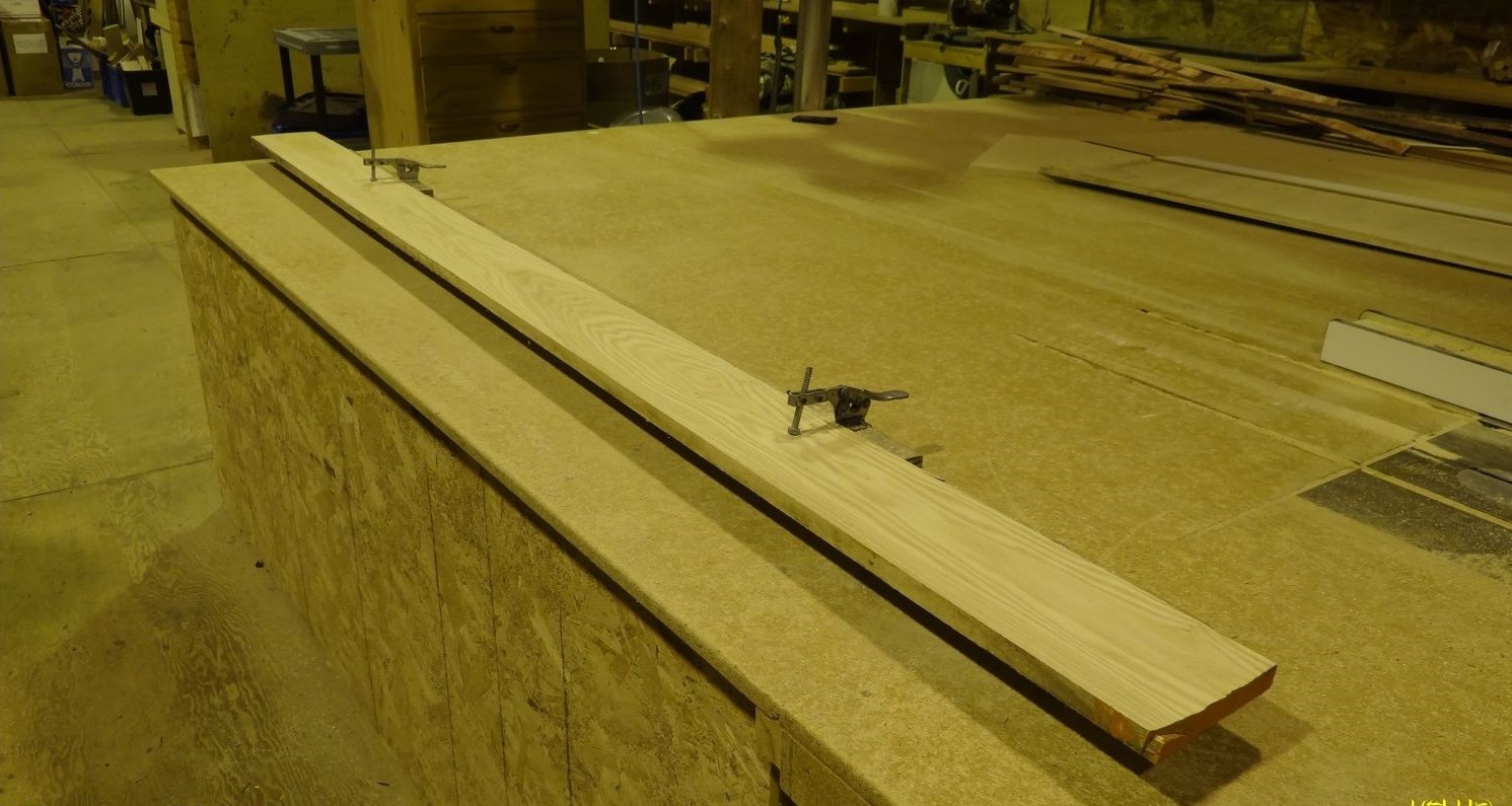

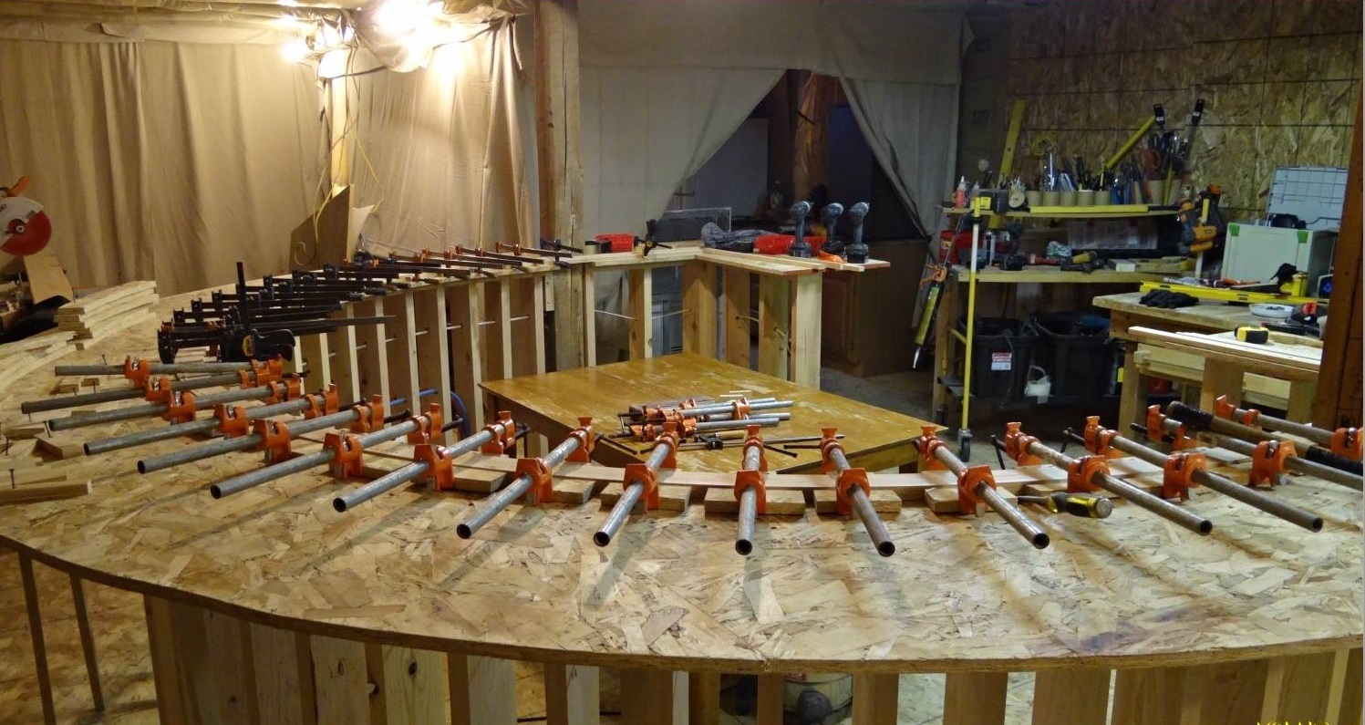

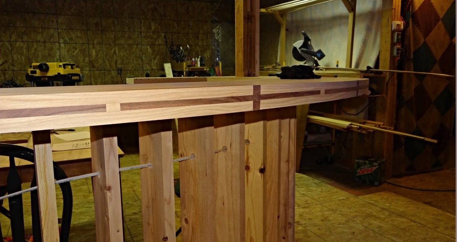

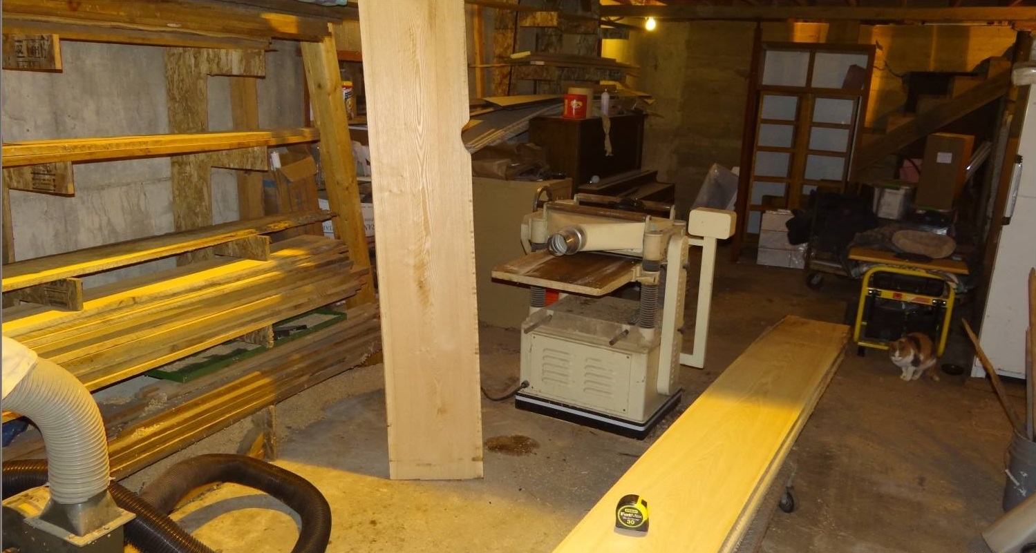

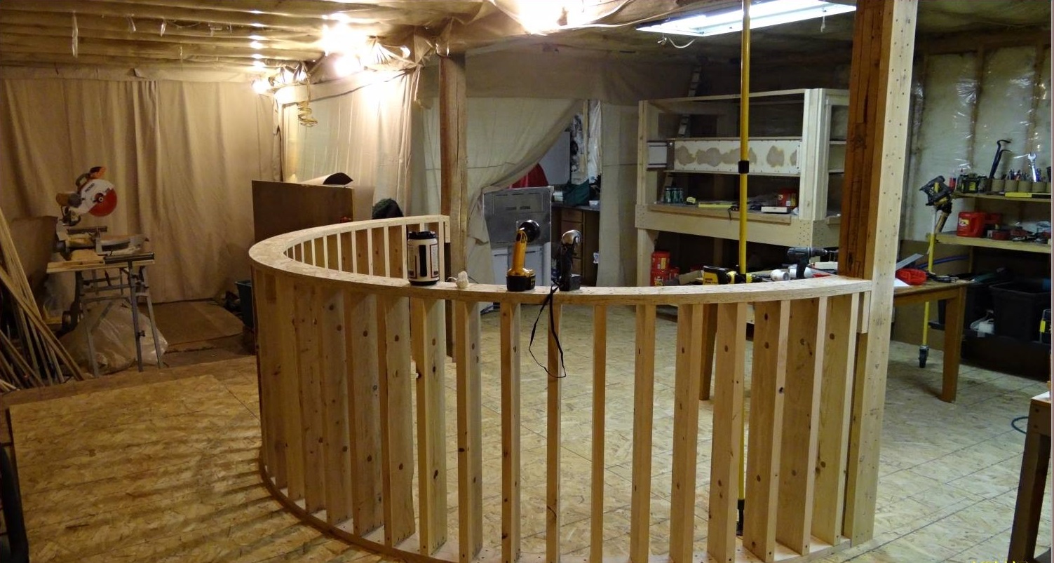

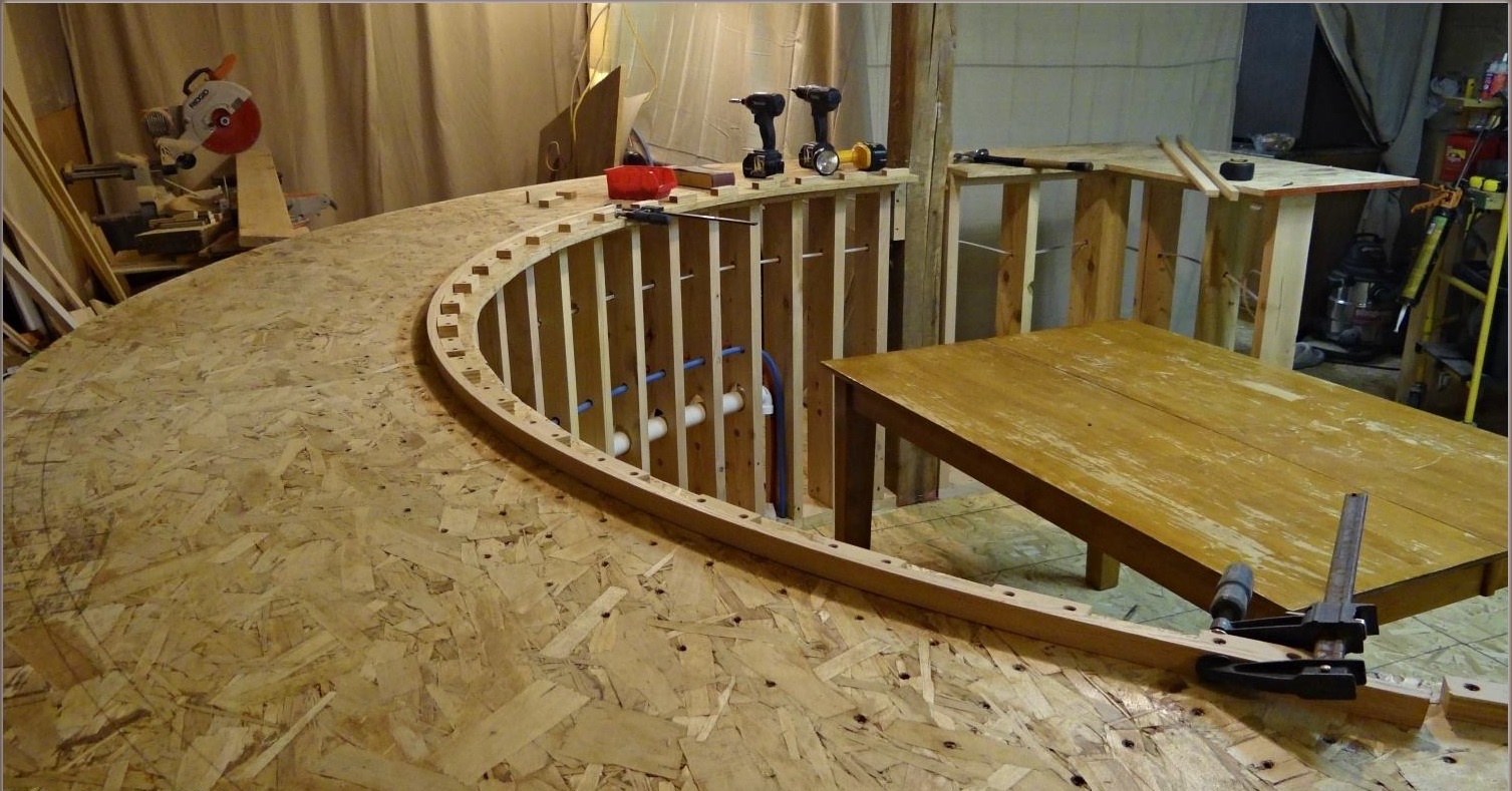

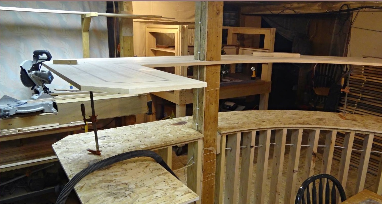

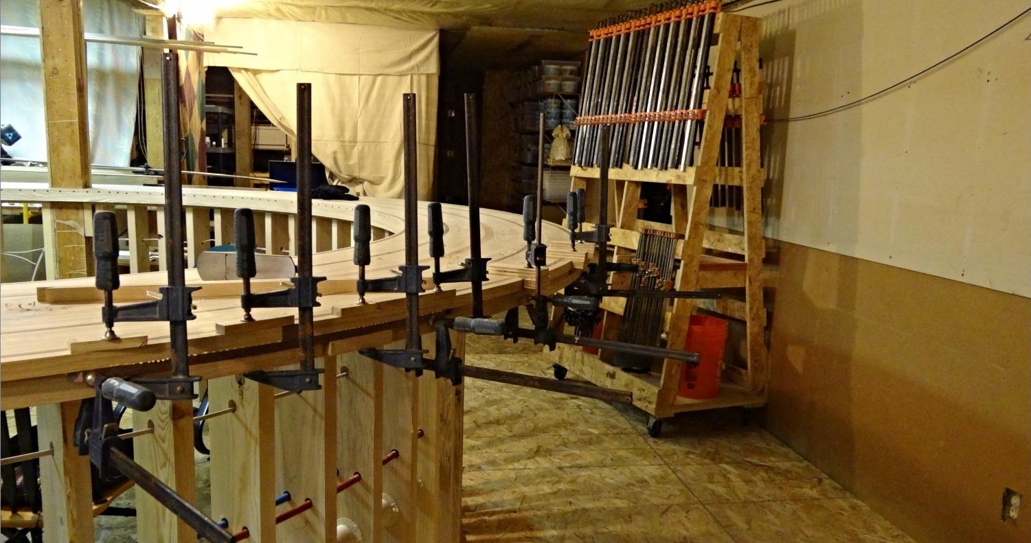

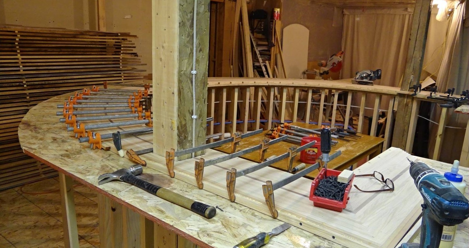

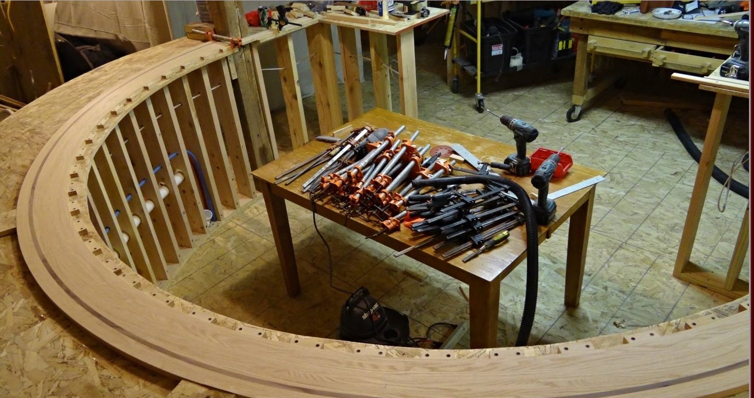

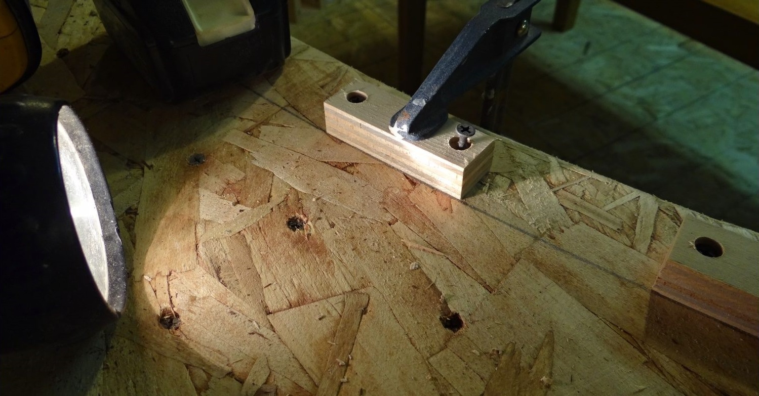

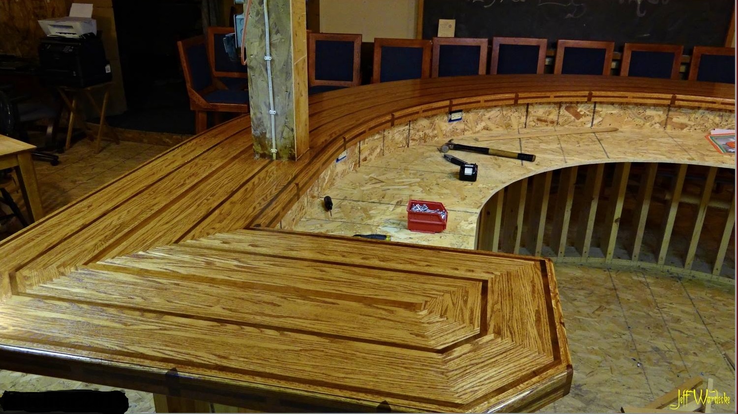

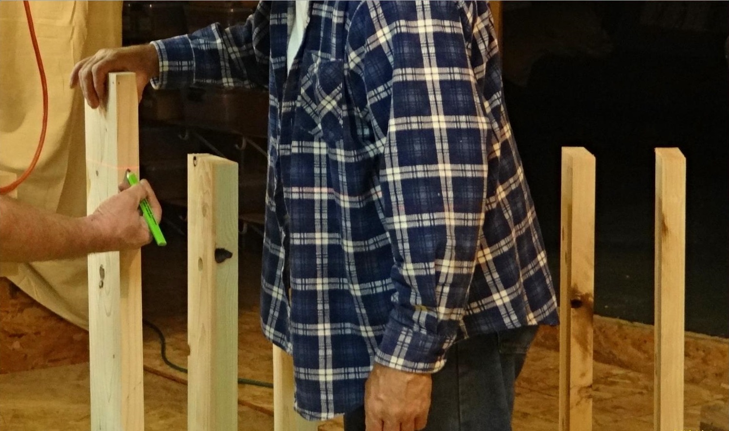

    Woodworking Project Showcase? Not sure about that!

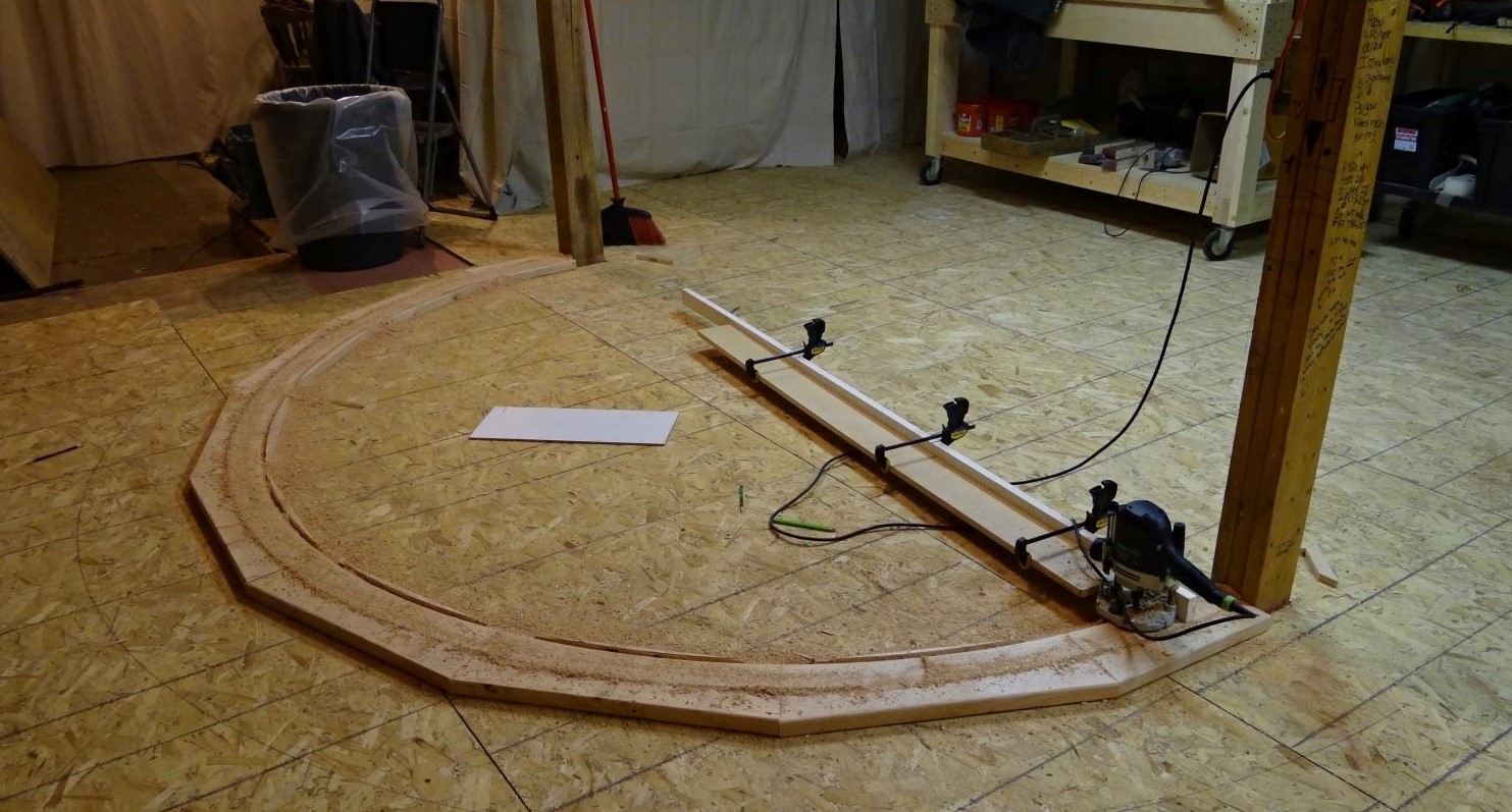

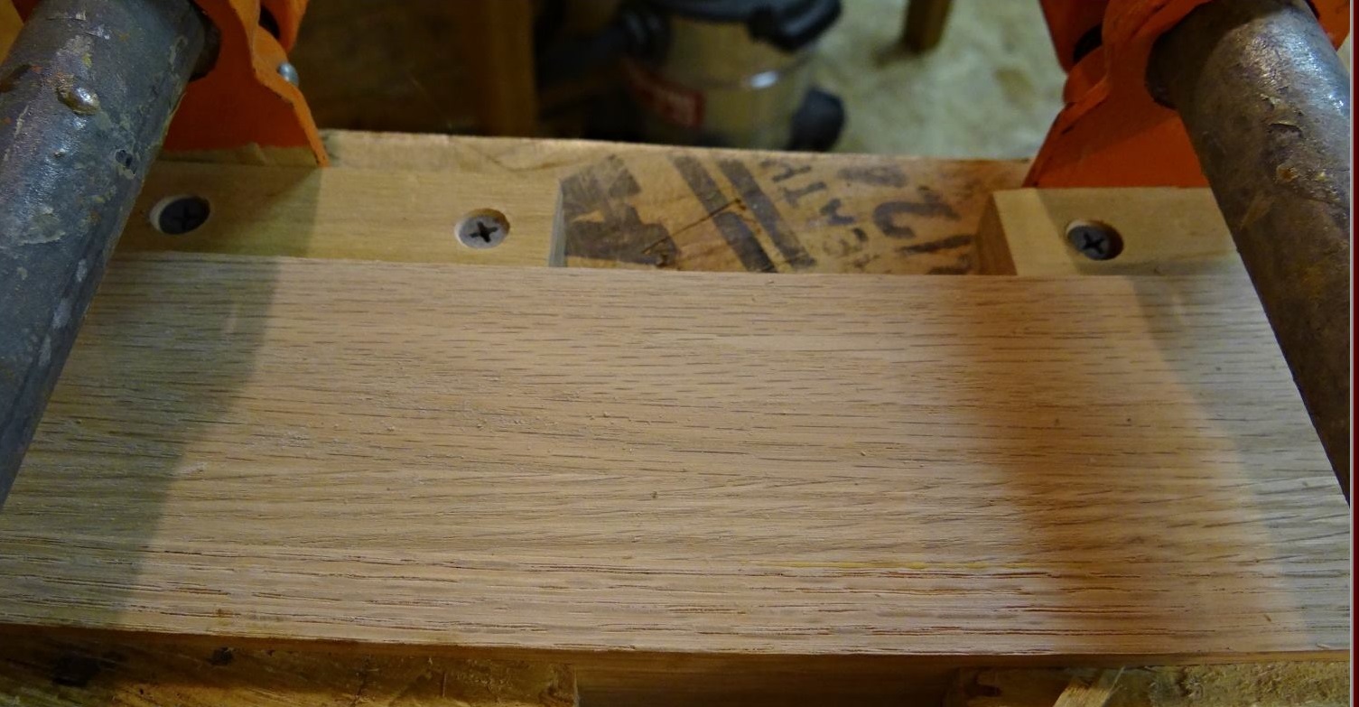

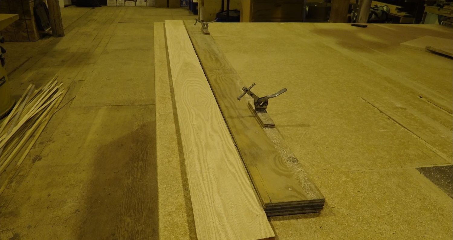

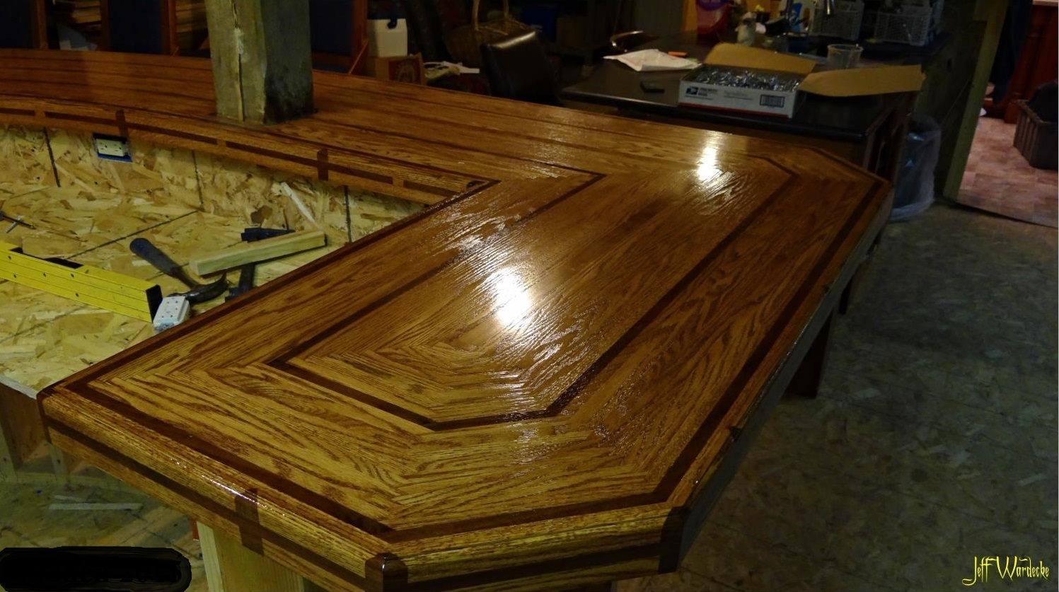

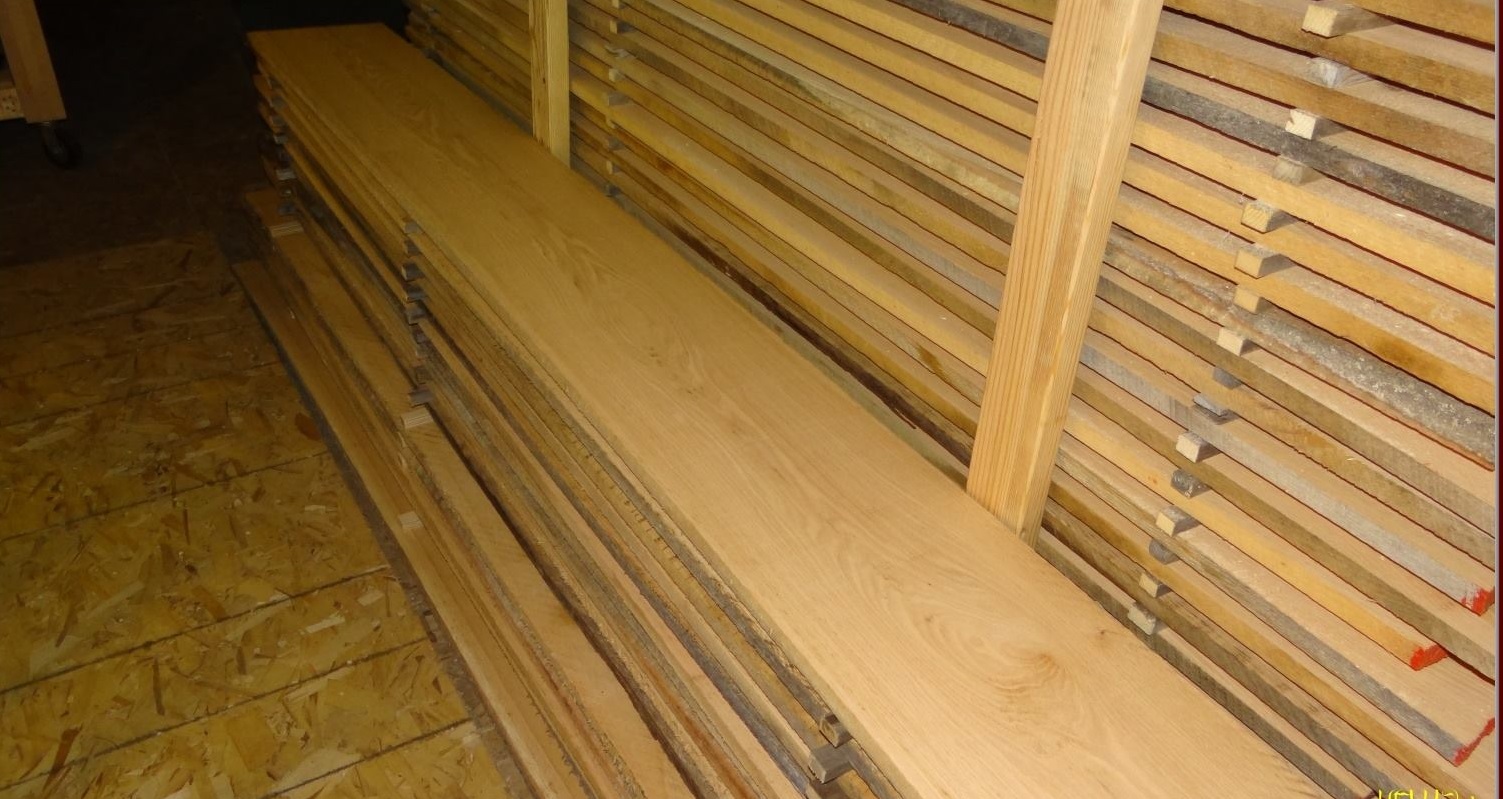

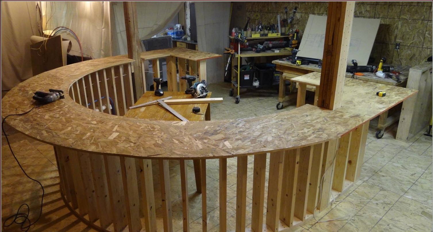

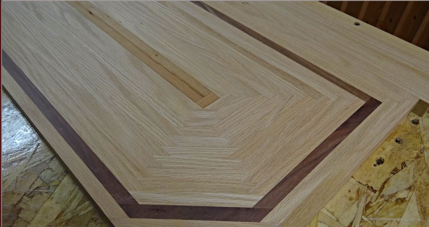

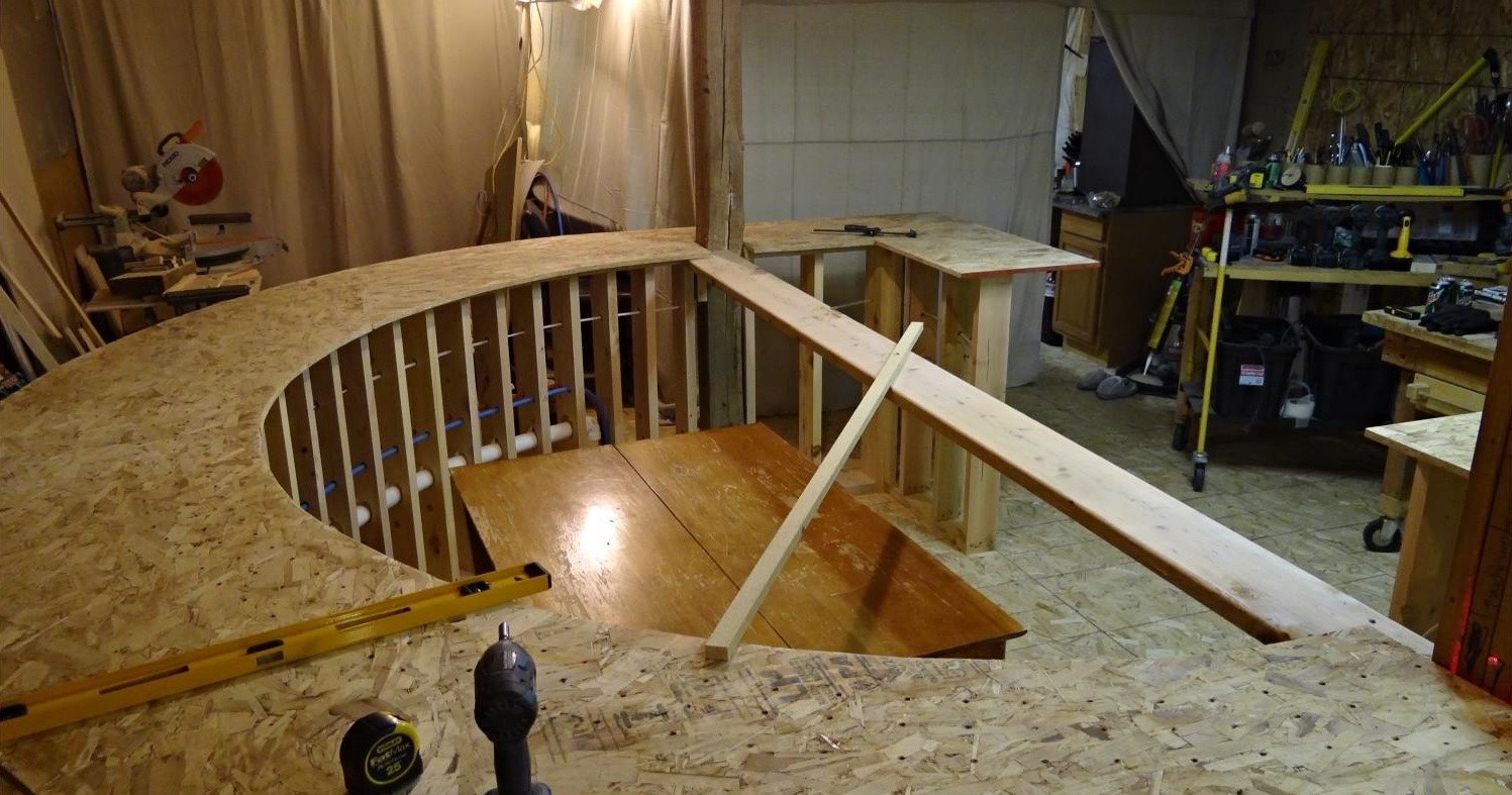

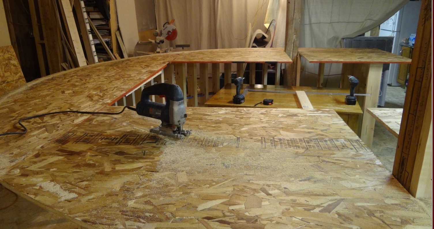

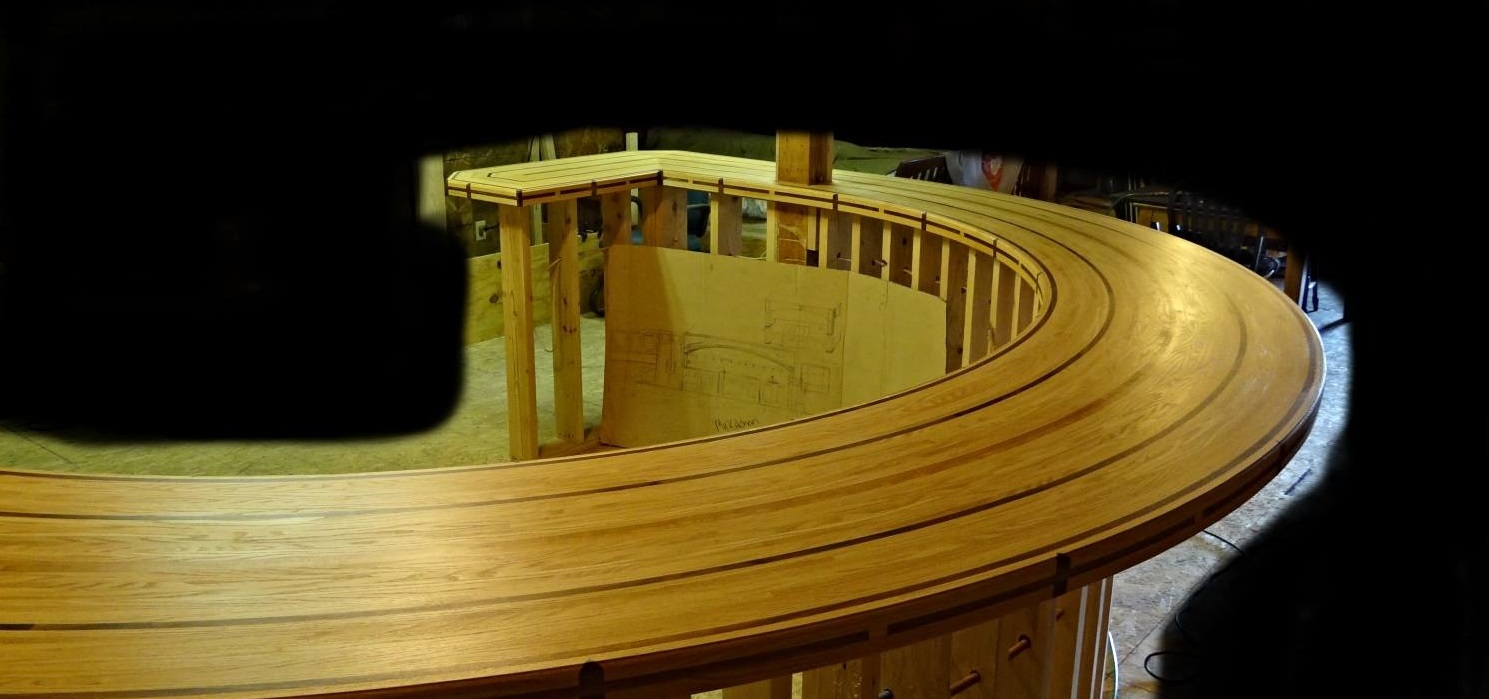

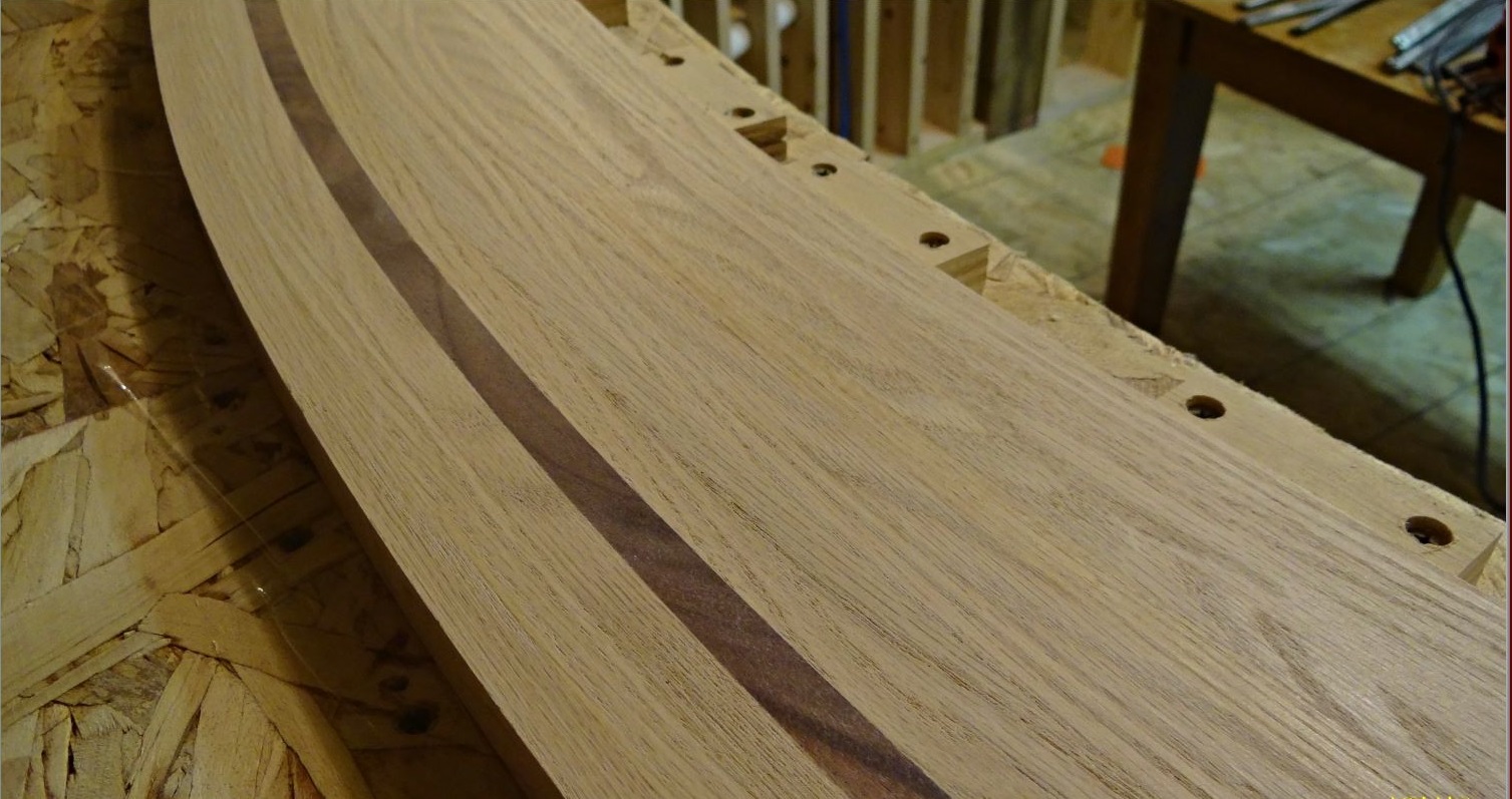

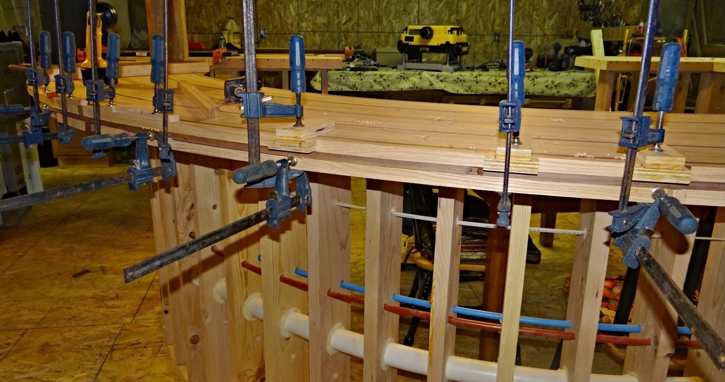

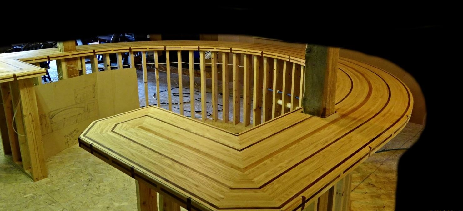

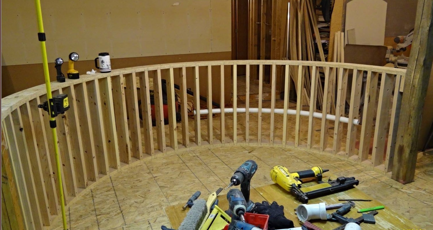

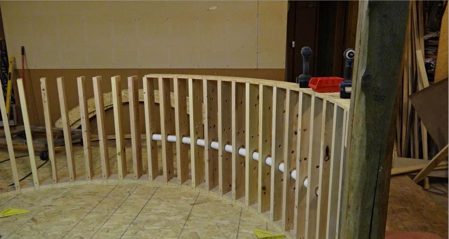

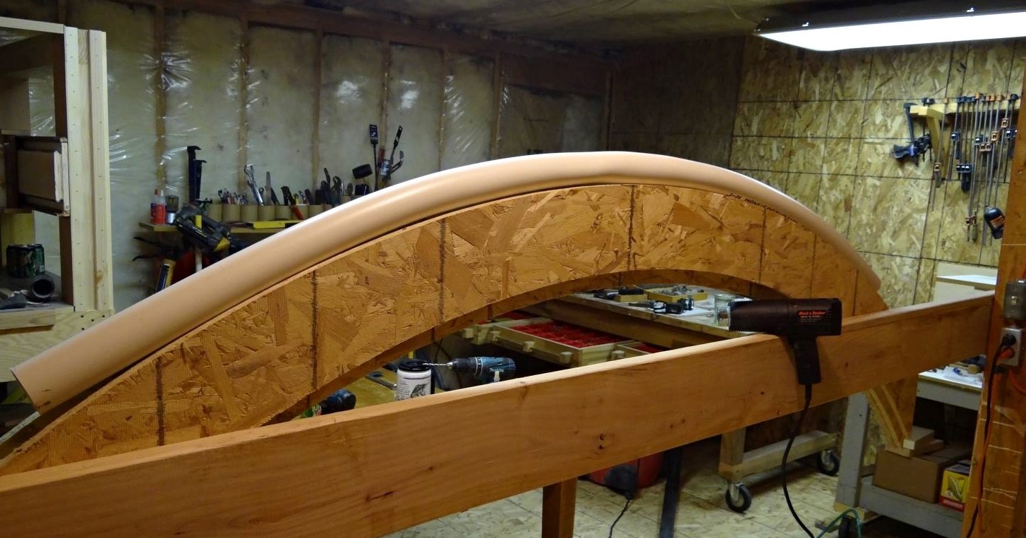

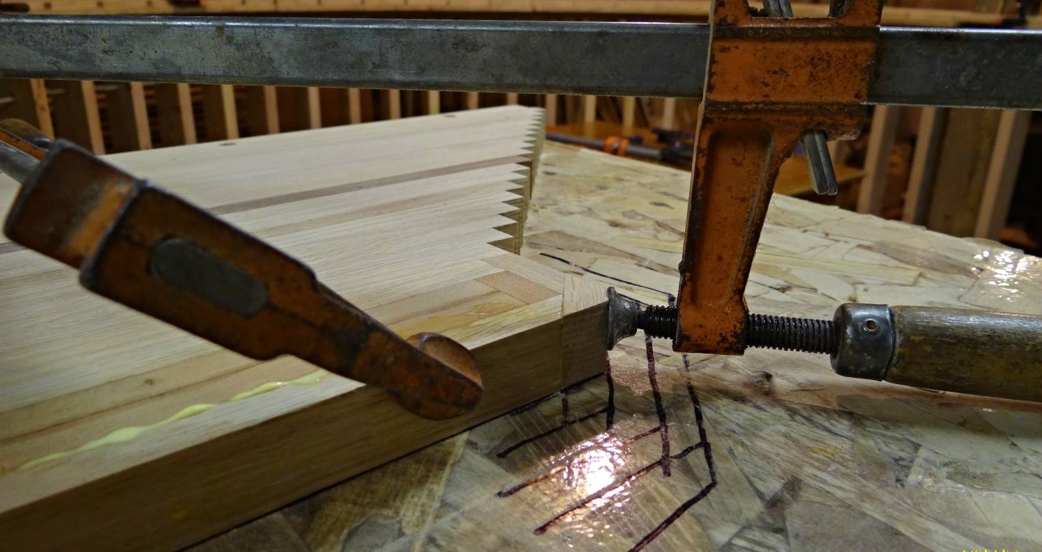

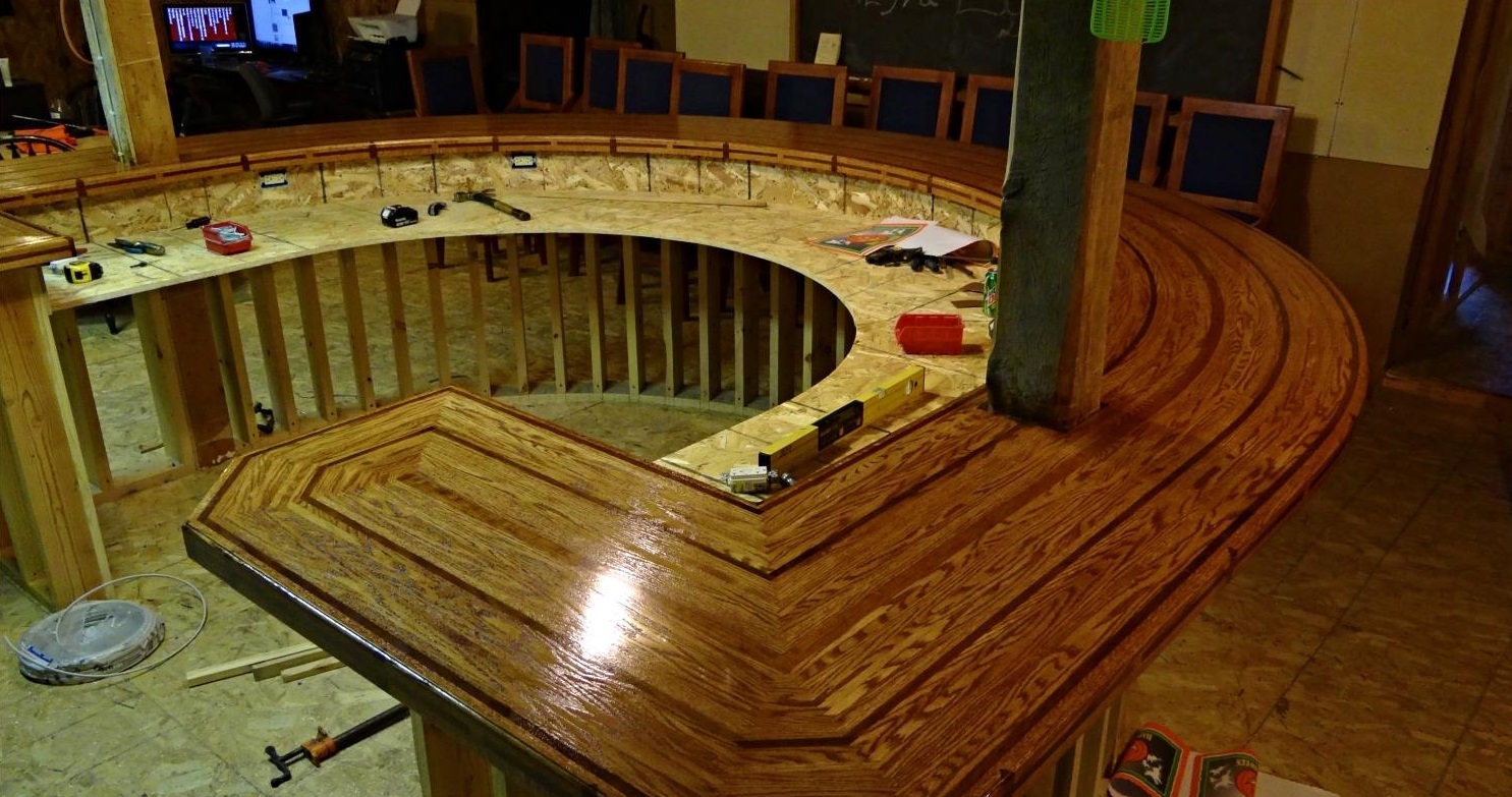

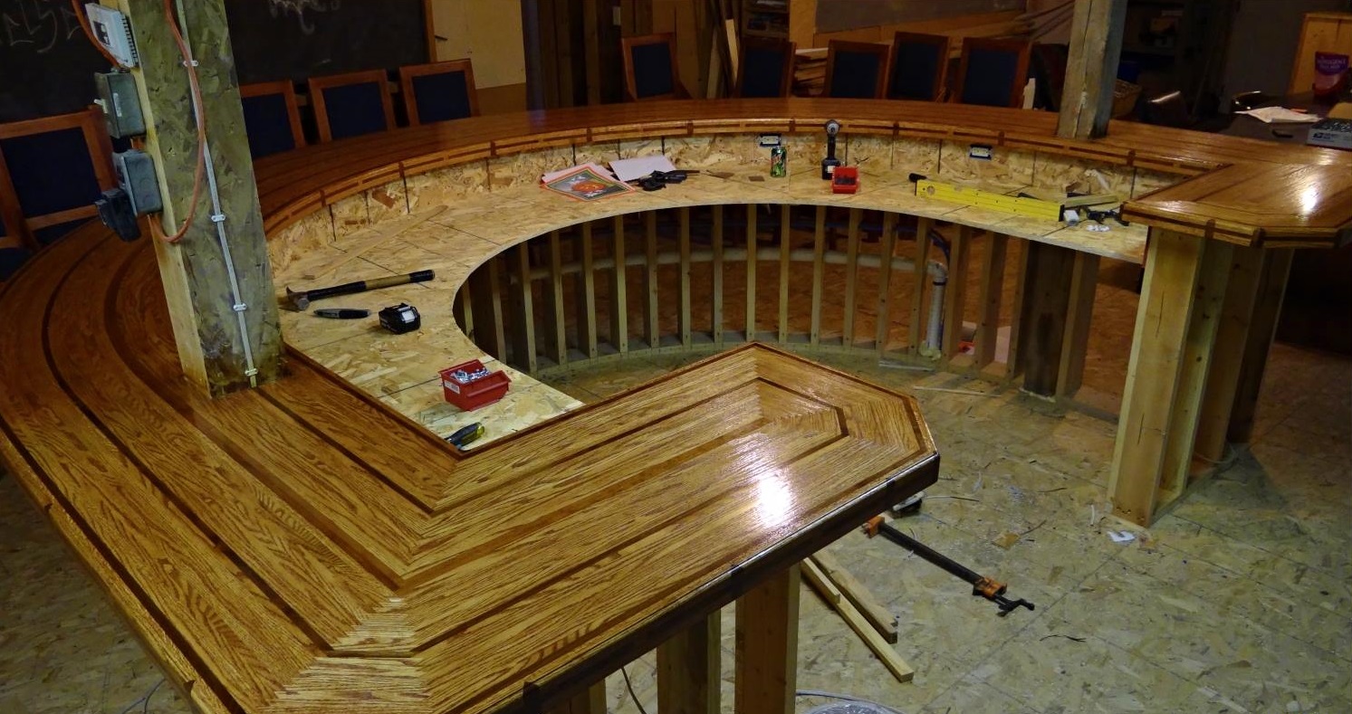

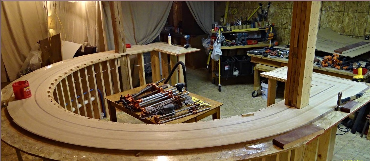

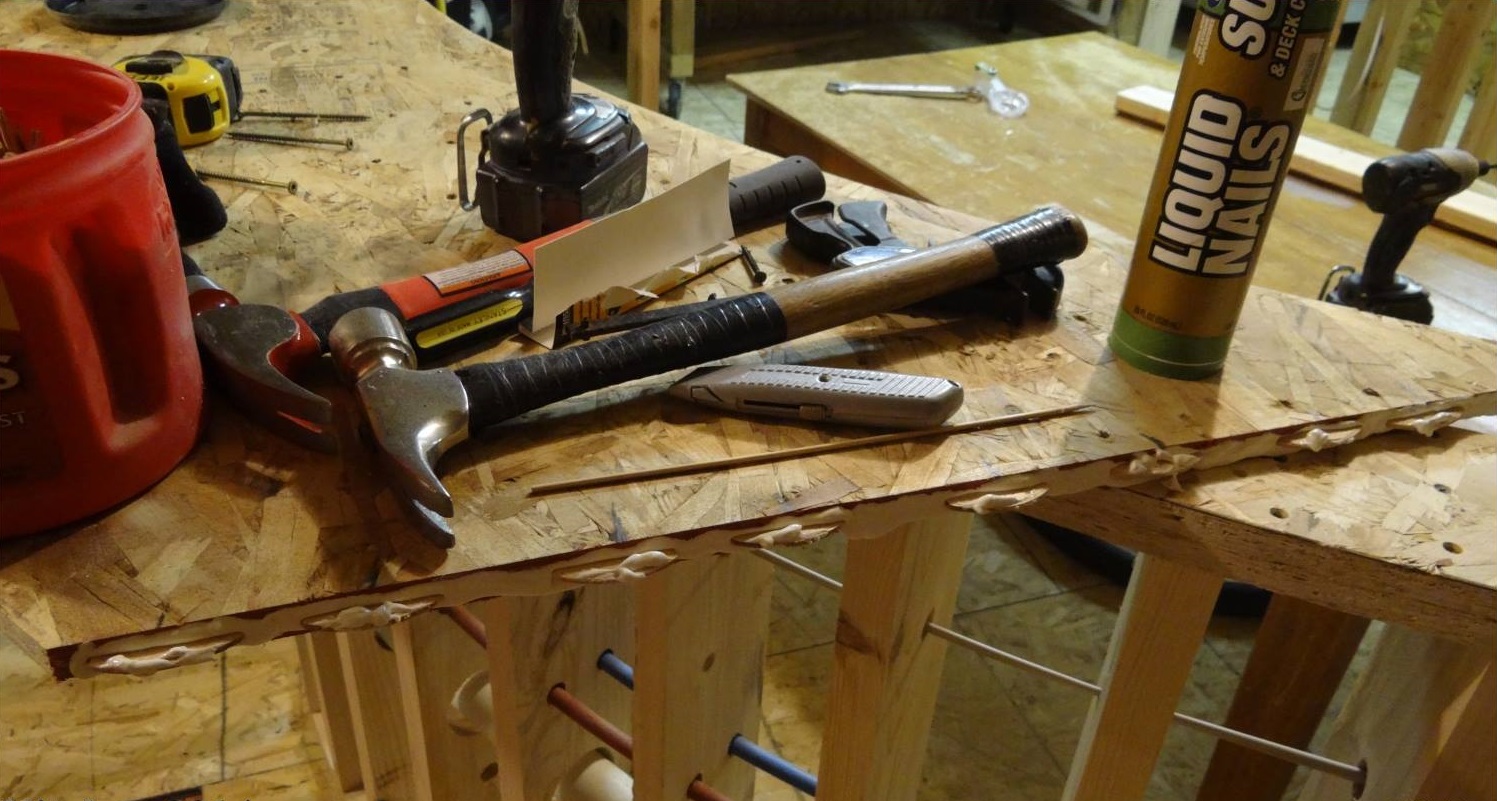

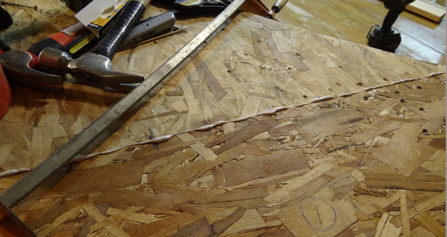

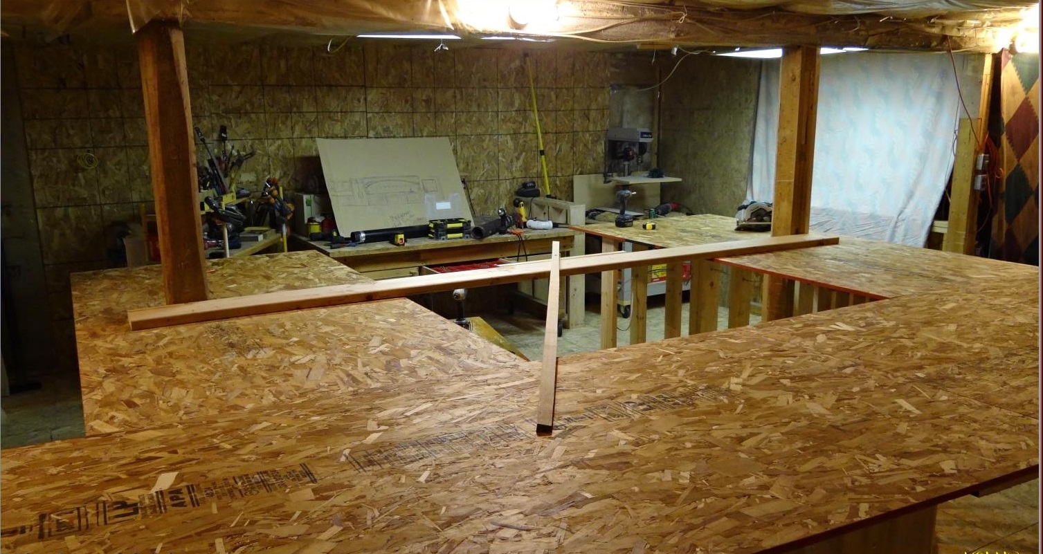

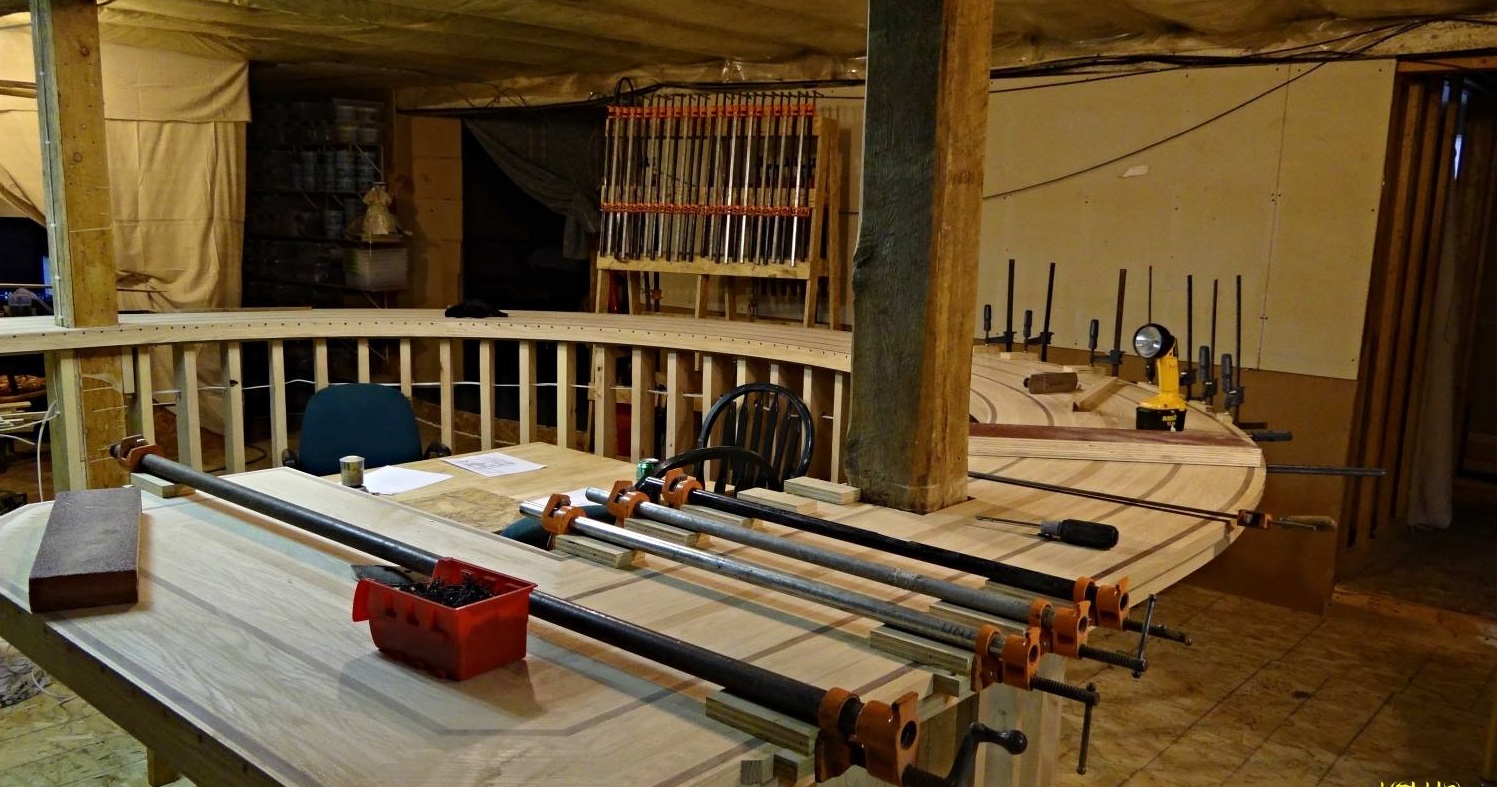

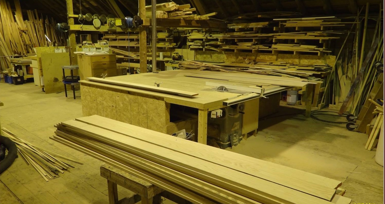

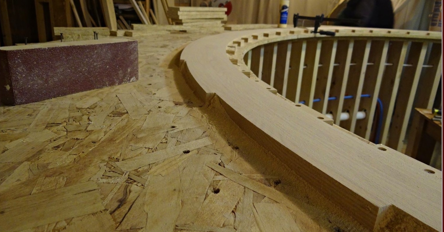

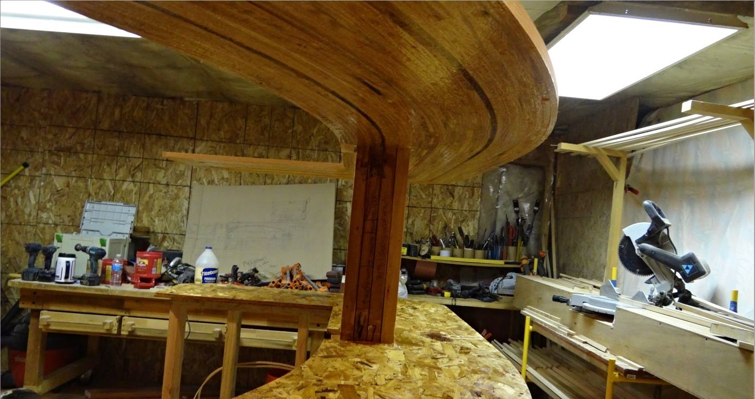

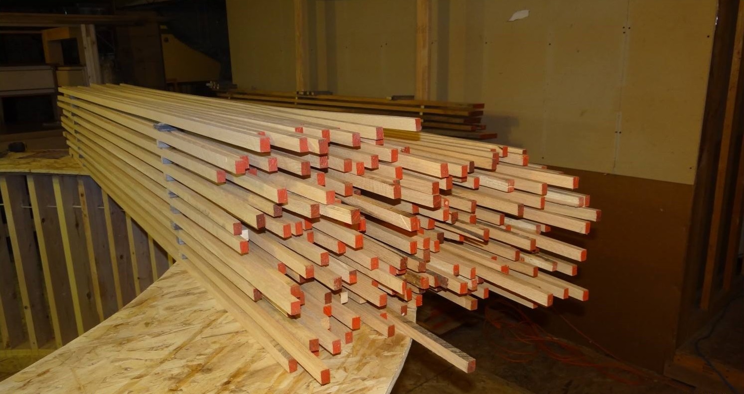

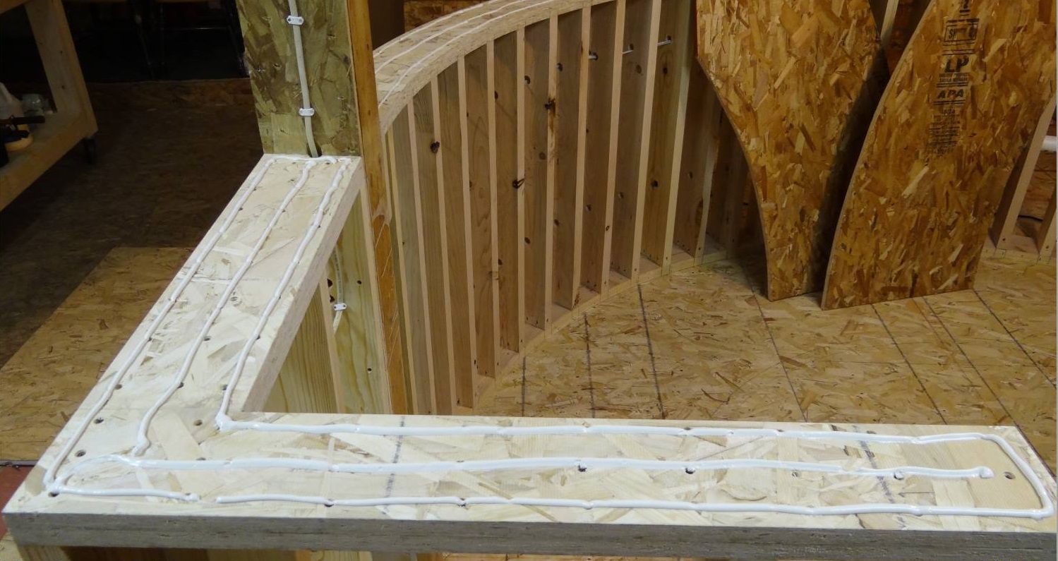

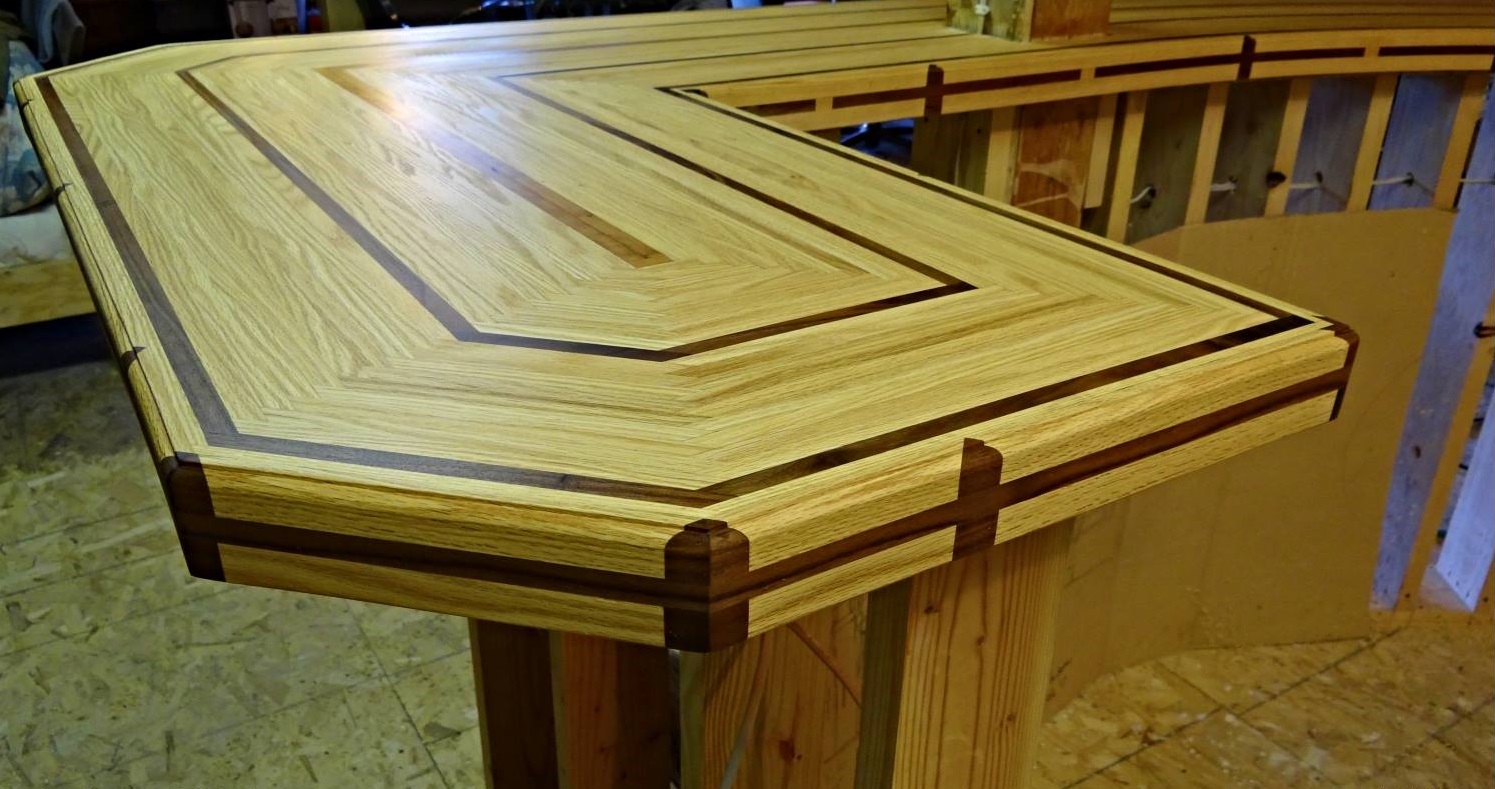

    At the very least you should find this interesting if not entertaining, 1000+ pieces glued and clamped one at a time, then each piece is hand sanded flat with a big sanding block before the next piece is glued into place.
    The half moon is 3.6 meters wide and each strip is 13mm x 21mm and the top is 61cm front to back.
    What one man can do; another man can do!!
    Enjoy! :-)

    You can never have enough clamps! lol
  3. The Following 2 Users Say Thank You to Bluebird For This Useful Post:
    lol i was just thinking the same re clamps, i guess the saying is true, nice work!
