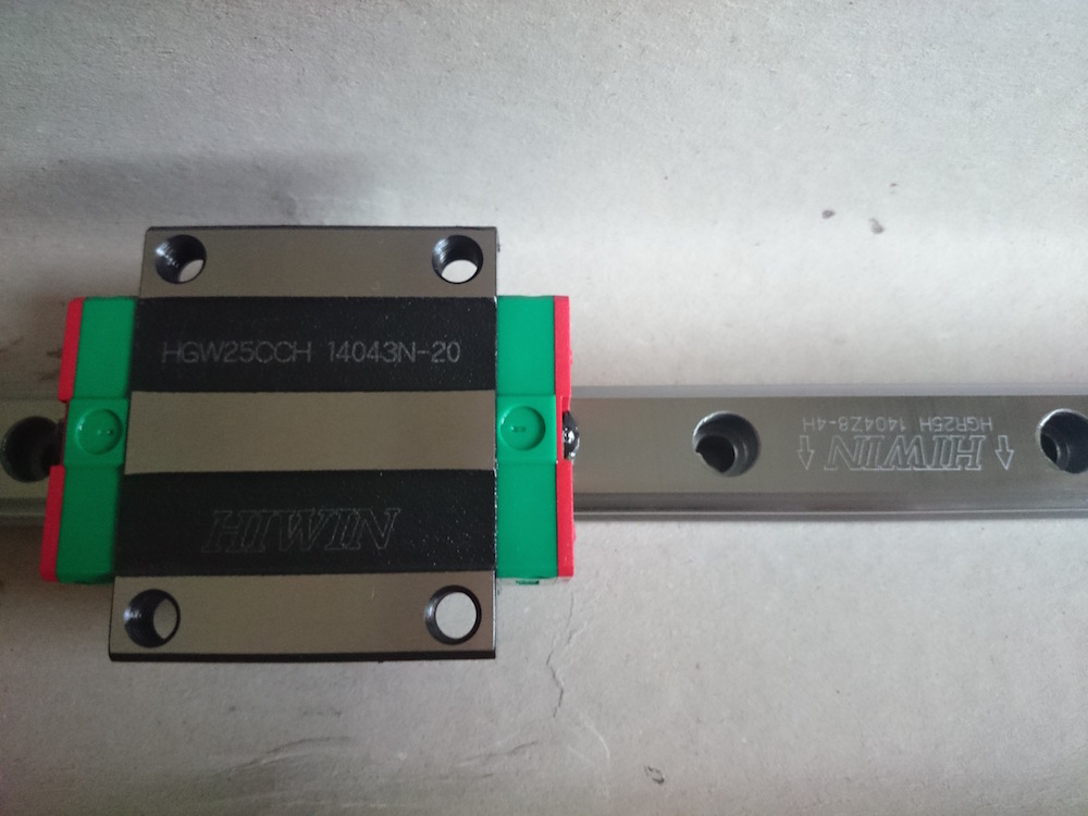

    Is this a good price for this stuff in the link I will be needing 4 blocks ,two rail maybe not as much as 500mm but there seems to be lots of Chinese listings for the stuff.
    I thought it was made else where like korea or...ta.
    http://www.ebay.co.uk/itm/HIWIN-EGW2...-/281227010633
    http://www.ebay.co.uk/itm/Original-H...item4170e36033
