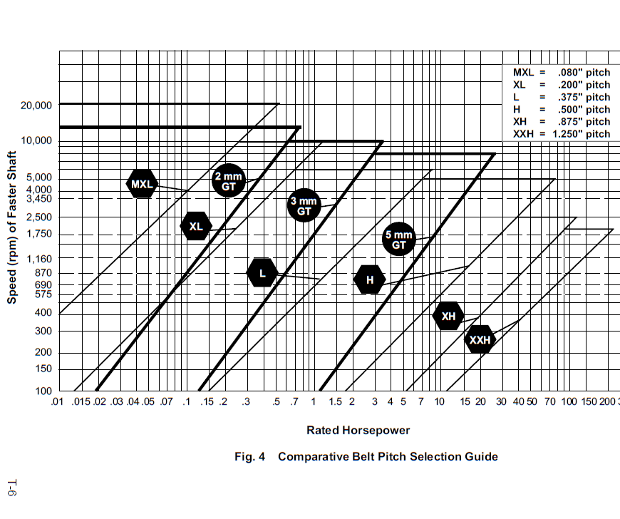

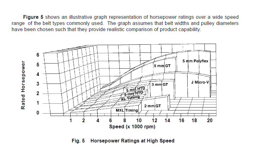

    Here is some belt info. If i read it correctly best would be HTD3- HTD5 belt or GT belt even better . Dont be put off by the lower life the figures show. After all one belt is 1-4 euro only. One thing to note is that wider than necessary is not a good idea.

    Here is the 3kw/3.2-4kw i believe also/ spindle with all sizes if you dont have it at hand.

    There are coated cutter for HSM in steel rated for 7-8k rpm. At this value the torque is about 1/3 of the top ( I will check the curve) so this gives an additional protection for the spindle.
