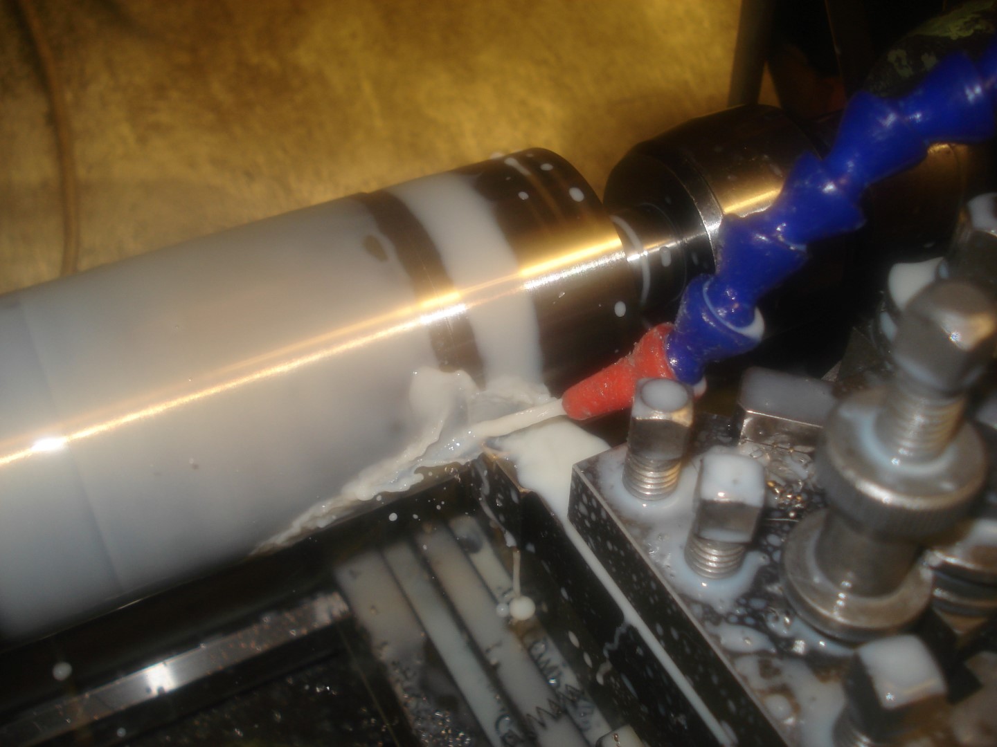

    The bike project is getting going again. One of the nice things is getting to machine some more interesting materials, e.g. a £300 piece of titanium bar for the motor shaft:

    I chose titanium purely for the 'easy' weight saving. We're getting the motor core length a little longer for more power, so the increase of weight from this will be offset a bit by lightening the shaft. My lathe seems to be coping OK so far. I first made sure the tailstock was properly aligned as the tolerances are pretty strict on this one and spent the rest of the weekend doing the roughing cuts.

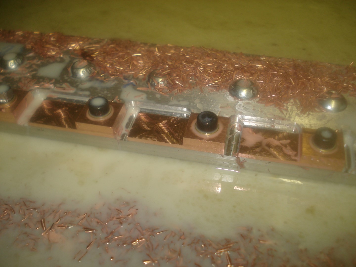

    More fun than millions of battery terminals:

    I programmed those using Octave (though just about any language would have done), parametrically so I just have to enter the dimensions and the rest is worked out. It seemed worth it to get an efficient toolpath - probably wasn't, but more interesting!

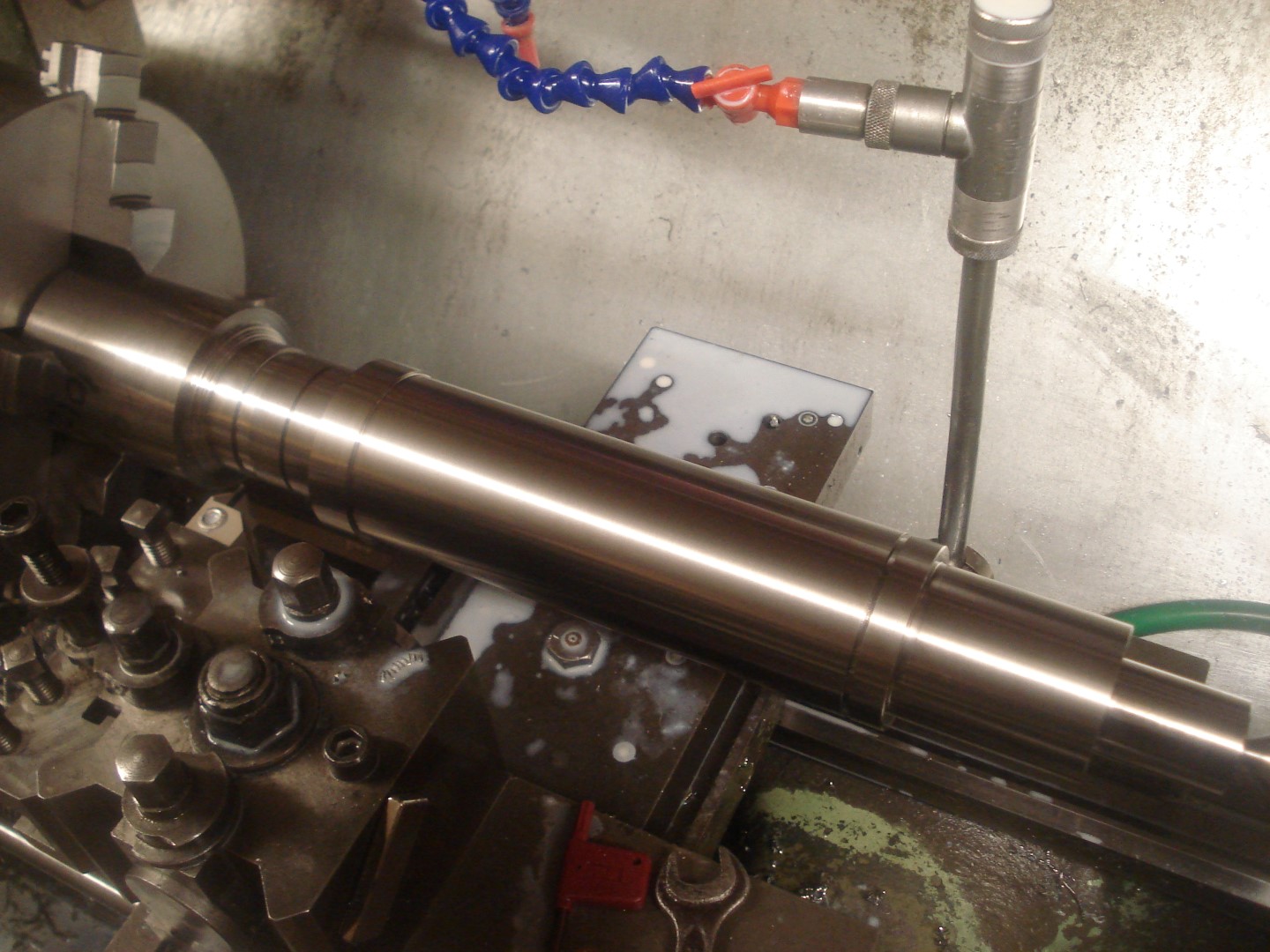

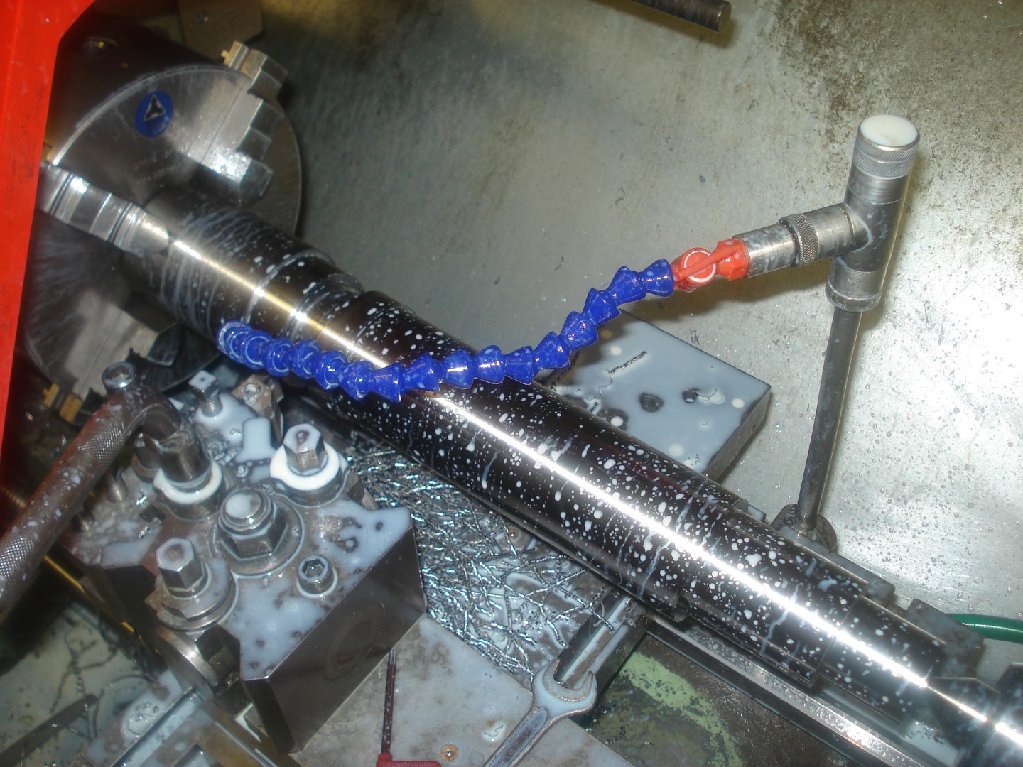

    Quick update, I made some progress with the titanium shaft this weekend. I almost finished the lathe work:

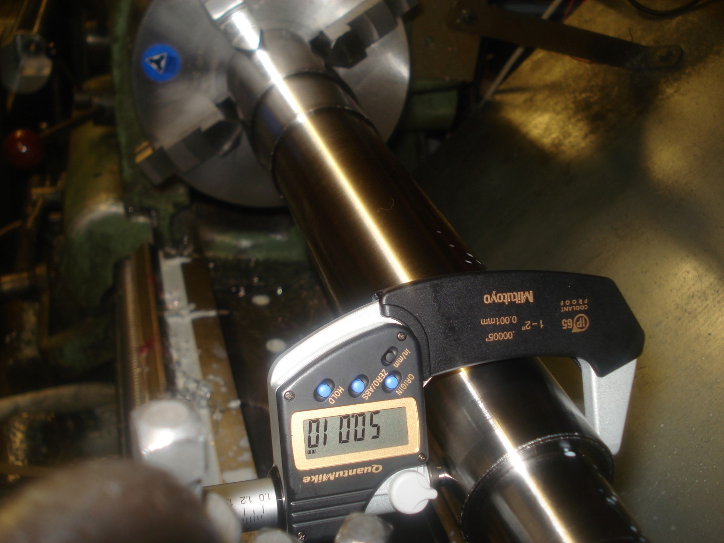

    I used a CBN tip for the finishing as it was able to take extremely light cuts, so no "hand finishing techniques" required. The tolerance on the part measured above was 50.003-50.015, so I made it to 50.010 as the young's modulus of this material is lower than the steel that fit was specified for, so making the interference slightly greater seemed the safe option (though it probably wont matter in reality).
    Next weekend I'll do the last bit of turning on the other end, then it needs a few slots miling and some holes drilling to mount the sprocket.

    I double checked all the diameters now it is off the lathe and it's well within tolerance - e.g. the longest diameter is 0.011mm different from end to end, but the drawing specified up 0.04mm here.
    Next step is to mill 3 keyways in it and drill some holes for the sproket.
