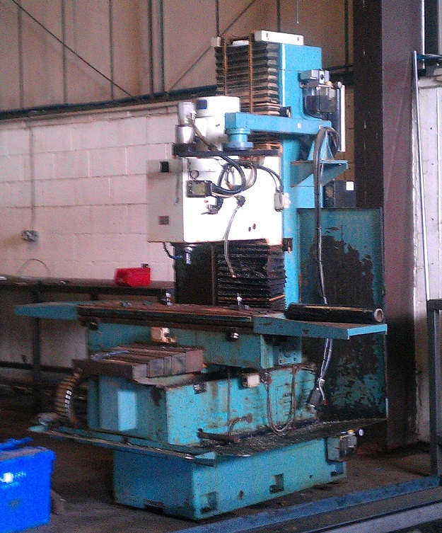

    What like my new little toy.! Click image for larger version.
    Nice Semco bedmill there Jazz, is it an 800 or 1000. I have 4 x 600's, great machines the first vmc's.
