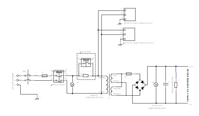

    I need a bit of advice as I’m getting slightly confused.
    As you can see from the sketch below I want to include a basic soft start circuit into my control panel, but I have the main toroidal transformer, a 24 volt power supply and a 5 volt power supply.
    If I ignore the 24v and 5v power supplies for now, I calculated the resistor required as HS50 33R. From the following:
    I = VA / V
    I = 750 / 230 = 3.26 amps
    With a limit of 200% of the power current = 6.52 amps
    R = V / I
    R = 230 / 6.52 = 35.28 ohms
    As I need both the 24 and 12 volt supplies, my questions are:
    • Should I connect them up as shown, after the soft start or after the safety relay?
    • Do I need to include the additional power supplies in the calc for a suitable resistor, and if so how?
    • The HS50 refers to watts, I have only used this as it has been suggested in an article I read. Is this correct?
    • I am hoping to find a suitable relay with a timer, can anyone point me in the right direction?

    I would connect the 24v and 5v supplies after the safety relay but before the soft start.
    Resistor value is not that critical, you might have to try a few values to get the best for your setup.
    That's the maximum wattage, and hence current at the rated voltage, the unit can supply so when it first powers up the load current will be less because the steppers will be drawing very little current.
    This seller has some good timers at great prices and keeps some in the UK, then you just need to select a relay with correct coil voltage and amps rating on the contacts. I didn't look through the list of timers but there may be one with suitable contacts already built in, you'll have to look.

    If the 5 and 24V supplies are only being used to power sensors/switches and no motion, I'd personally put them before the saftey relay, as you usually want to have inputs active before you power up the safety relay...
    Agree with M_C put the aux Psu's before so the BOB etc stays powered.
    It's true the safety relay needs power but from the attached drawing it wasn't clear how the relay coils were supplied, also I thought it a good idea to kill everything when the safety relay was tripped.

    Thanks for the advice. Now to start laying it out to see what size cabinet I need.
