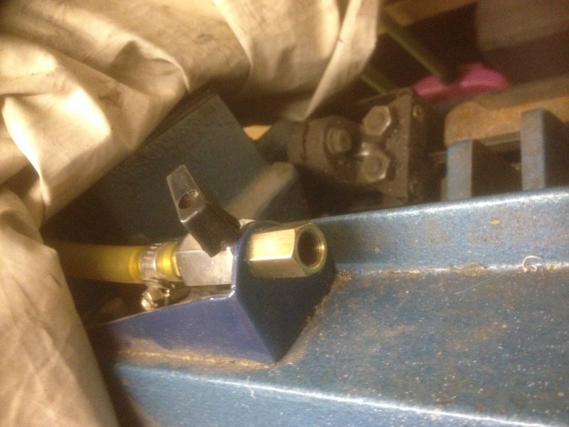

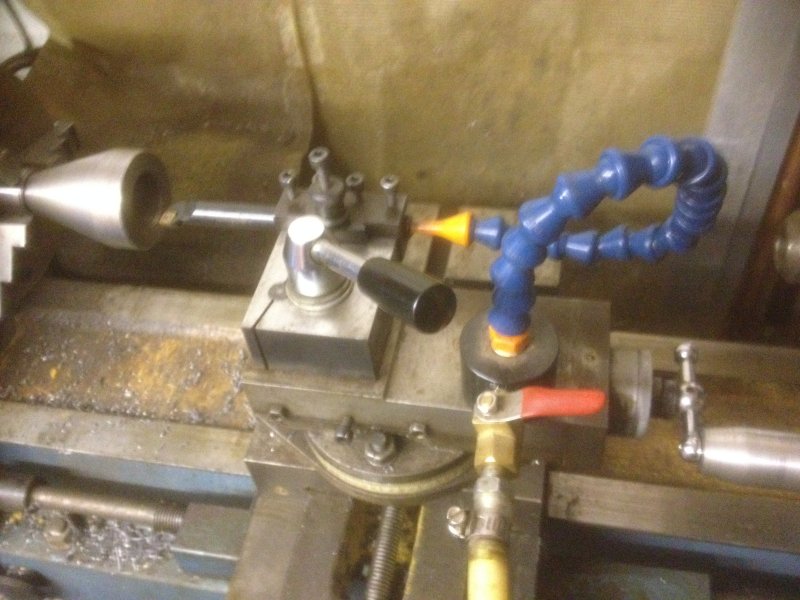

    aww cropwell those hoses look familiar
    2 purple ones, cant remember where i got em.
    2 blue ones , i think came from RDG tools
    1 locline, with spray bar end.
    purple one with the connector missing was on bandsaw
    but locline spray bar end doesn't fit on pipe and the brass fitting is NPT thread
    and the locline is BSPT, but i know they do BSPT and NPT connectors
    so im going to get correct connector for that.
    and for changing pipes from spray bar end to normal nozzle.
    as now i got an through coolant boring bar.
    i thought about making it quick change with air fittings.
    same as what i did with the coolant tanks between bandsaw,lathe and mill.
    i have taps and dies for 1/8" and 1/4" bsp.
    but not the NPT ones. but it will be easier and cheaper to just get the correct locline connector
