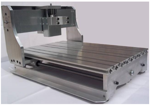

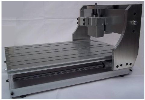

    Hi Forum Members,
    I am new to this forum and cnc world.
    I have bought 3040Z CNC frame from china.

    I would like to install my own stepper motors, Spindle and controller.
    Objective of machine will be to mill some soft alloys and wood acrylic etc. Priority will be aluminum copper etc.
    Please suggest the right motors and spindle.
    Motors: Nema23 3Nm
    Spindle: 2.2Kw Water Cooled
    Happy Shopping :).

    The Stepper motors are 1.5 kg each and the spindle is 5.5kg.
    Will the machine be rigid enough for these. And for the spindle which vfd will be good. Someone has suggested me sinamics V20 inverter.

    Hi Lee,
    What should be the rating for power supply for stepper motors.
    Wouldn't fit 2.2Kw to this machine has the Z axis is too weak to handle the weight and the machine can't handle the extra capacity the spindle allows Ie 12mm cutters. 1.5Kw spindle are better matched.
    For the motor/drives and PSU then you can use 2Nm motors and 50V drives running motors around 44Vdc. BUT if you want spare capacity for future upgrades etc then use 3Nm motors on 70-80~Vdc drives running at 65Vdc. Slightly over the top for these machines but better being over spec'd than under.
