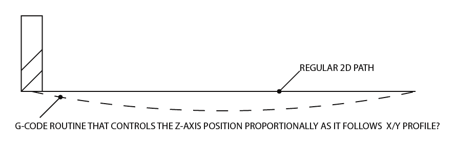

    Vectric's Cut 2D does an admirable job of generating 2D tool-paths, but I'm wondering if there's a bit of G-code that's available to add in which will plunge the cutter to a specified Z depth as it travels to it's halfway point along the 2D path and then retracts the cutter as it travels along the second half of the path. I imagine many of the programs that carve letter-forms into wood use this technique, but is the Z-depth explicitly specified in each line as the G-Code is generated, or is it controlled by a clever bit of programming at machine level?

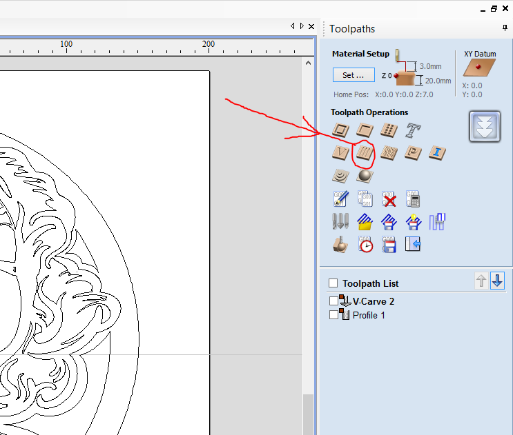

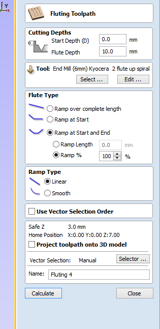

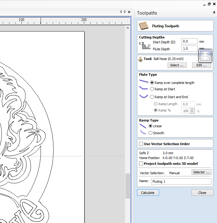

    Vcarve Pro and Aspire have it.

    Indeed they do, but I'm not using either of 'em... I was after a manual tweak that I could make to my standard profile code. Any chance you could output me some G-code for a fluted straight and a fluted curved line to see how it's being done? (If you could do examples of a linear and a smooth ramp that would be cool!)
    Cheers!

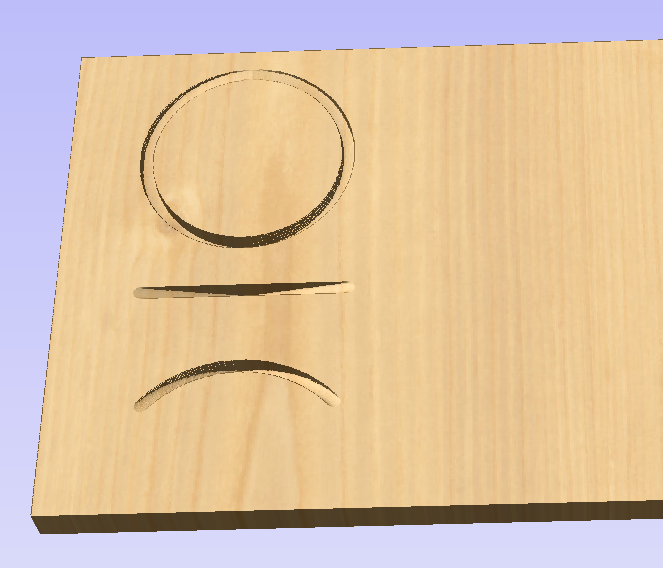

    flute toolpaths.txt 100 mm OD circle, 100mm line and 100mm/10mm arc
    Hope that will help
