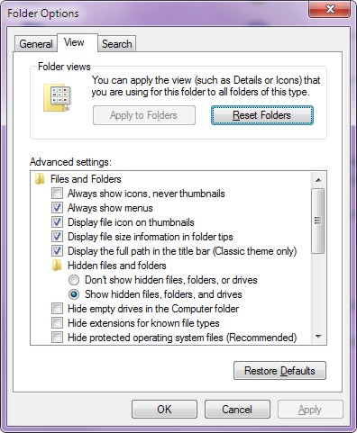

    No idea, I steer clear of Win8, but in Win7 it is Control Panel/Folder options under the view tab.
  2. #22
    I don't seem to be able to find anything that works in control panel....i mean to load files i don't see?

    I meant that you should make sure that no files are hidden by the system.
    From what I have seen of Win8, it is going away from the system engineers dream of something that is understandable, and can be patched if it don't do what you want.
    When I was a programmer in the 60's, I could patch programs by stopping them, altering bytes in memory and then setting it running again. Up until Win98 I could do much the same. I started to lose interest with XP and now with Win7 I don't give a flying f**k. My attitude to Win8 is another step in the same direction.
