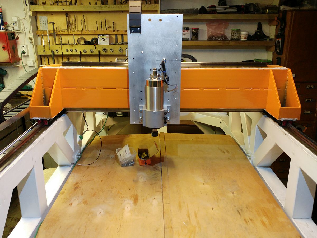

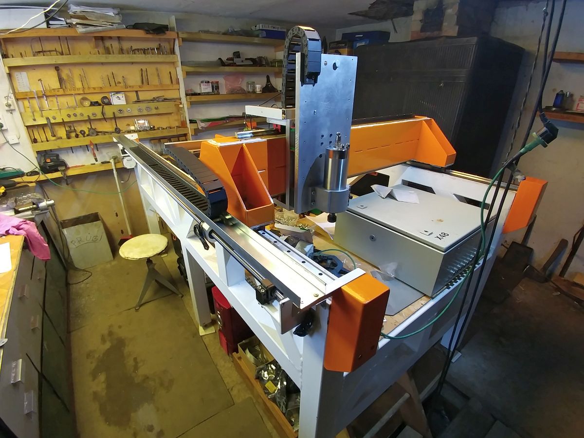

    My router made its first moves on 1st 2017.
    There are some issues that need solving:
    1. The guy who bored my pulleys obviously did not know what he was doing - terrible runout on some of them.
    2. VFD is causing my PC video card some troubles. While spindle is on my screen goes black for 1-2 seconds with an interval of 10 seconds. All cable shields are grounded and no other anomaly occur.
    3. Spindle watercooling
    4. Final bed design with side-covers
    5. Dust extraction
    6. Probe
    7. 4th axis
    I put on some temporary bed and made some chips :D
    It is the coolest project ever! Thanks guys!
