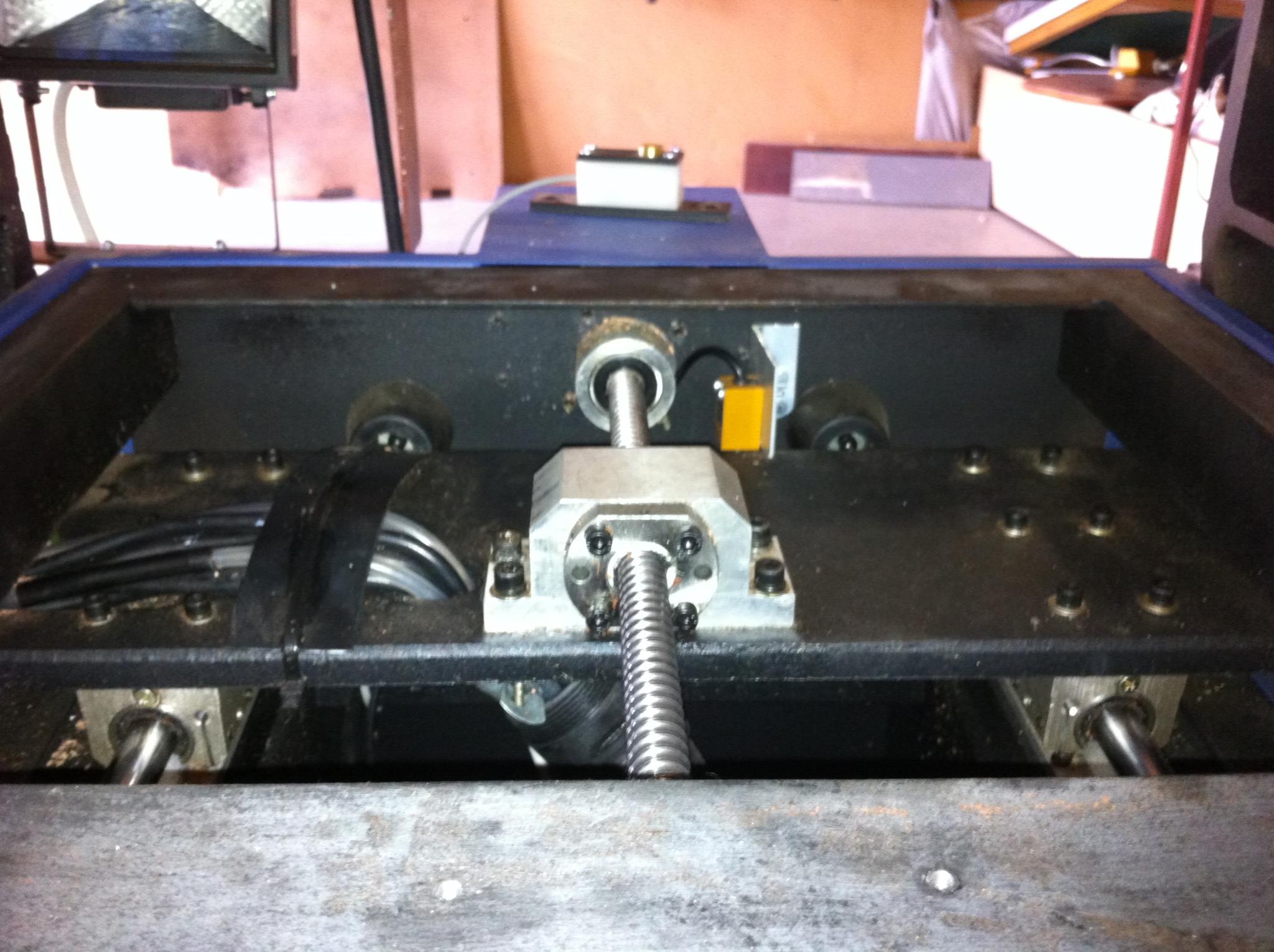

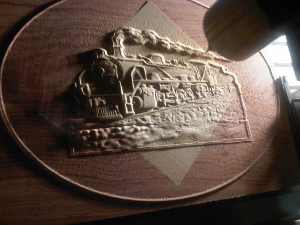

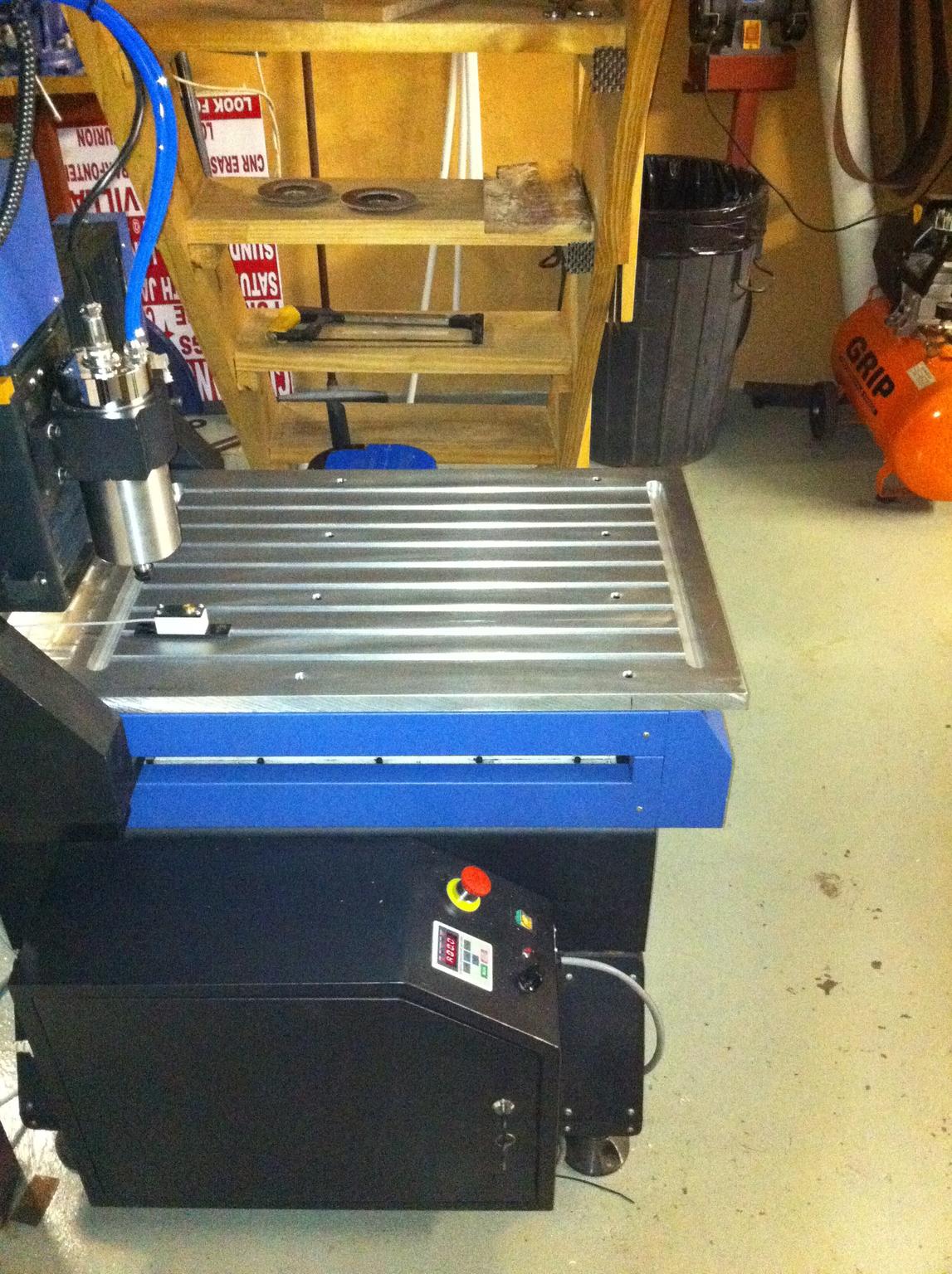

    here are some pictures of my mill during happier times.
