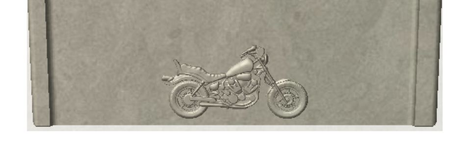

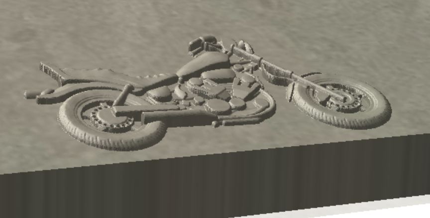

    phill05's Avatar
    Lives in Derbyshire  UK, United Kingdom. Last Activity: 22 Hours Ago Has been a member for 9-10 years. Has a total post count of 295. Received thanks 28 times, giving thanks to others 13 times.
    This bike is worked through Aspire and cut into a stone memorial.
