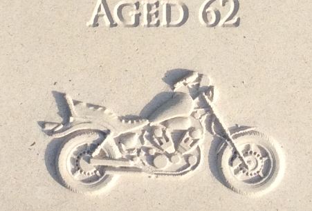

    Yes it's cut into a Portland stone memorial and you can see the detail you can get but you need to work at it.
    This is an STL file and if you set up to turn your blank over to cut both sides you would have a 3d model in full, or cut two seperate sides and attach together.
