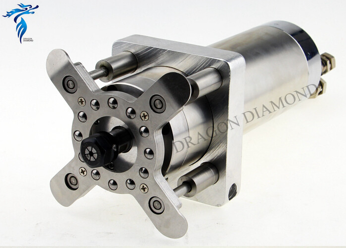

    Have you seen that? Its some new contraption. What are your thoughts?
    I have seen similar but actuated by air and bigger, have seen rollers. I wonder how to suck the chips so the bearing balls could roll. May be blow away constantly the dust. I see a possibility that this could be very useful if the dust is evacuated somehow.

    Looks very similar to a very old design for keeping constant torch height for plasma cutting/marking thin plate when the machine did not have thc.
    Agree. I was thinking more of a usfull for engraving big sheets of thin material, where the material is fixed at extremities but no vacuum table

    I'm thinking it could probably have uses on thin material where a vacuum bed is not available.
    Exactly, I have more or less thought about the same thing/design in my head for working with thin wood sheets, 4, 6, 9mm ply and so on, this design isnt a bad one, for mine i considered bigger balls though and just LM type bearing units with round rail - manual adjustment.

    The most useful i have seen till now are 2 gantry wide rollers that pneumatically actuate and roll in front and at back of spindle. A bit of overkill for home use though. Otherwise would have implemented them already in my OTT build

    These are the units I was thinking about, didn't get as far as size just "head thoughts" to date but it's not complex design...

    if they are big enough and spring included somehow.
    these were the ones in my mind

    Well for spring I thought about just putting some on the linear rail that supports those units, adjust the spring as needed...job done
