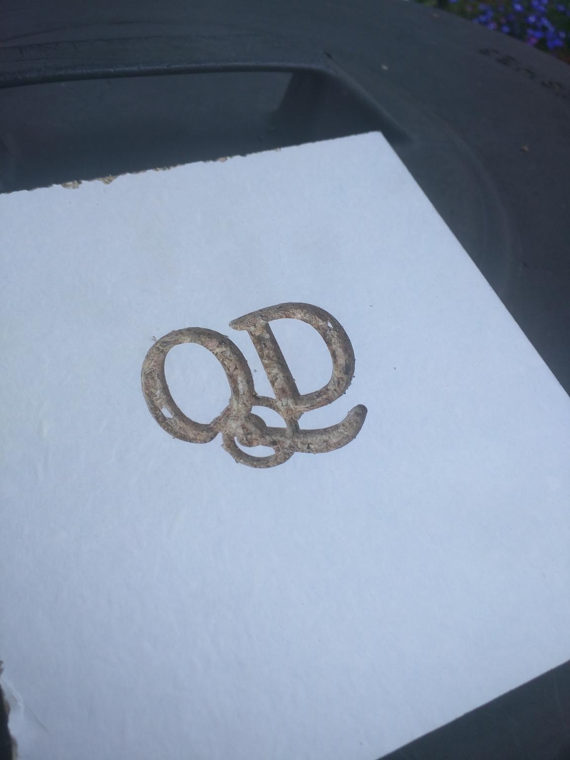

  6. #166
    Chaz's Avatar
    Lives in Ickenham, West London, United Kingdom. Last Activity: 4 Weeks Ago Has a total post count of 1,657. Received thanks 115 times, giving thanks to others 71 times.
    And we have life, although the motor output is being set manually at the moment and still need to sort my machine runs X Y positive when controller resets.
