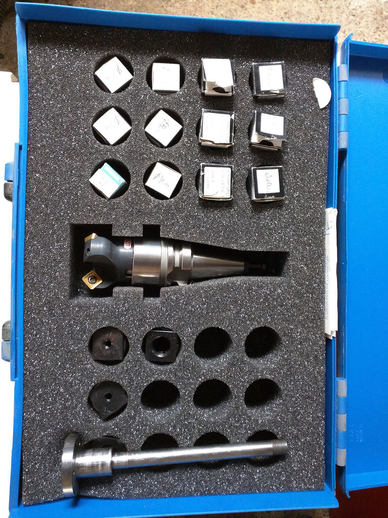

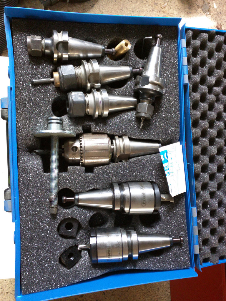

    The machine has come with more tools than expected and also a semi decent looking vice. I suspect if I add up the tools and few extras, some value already.

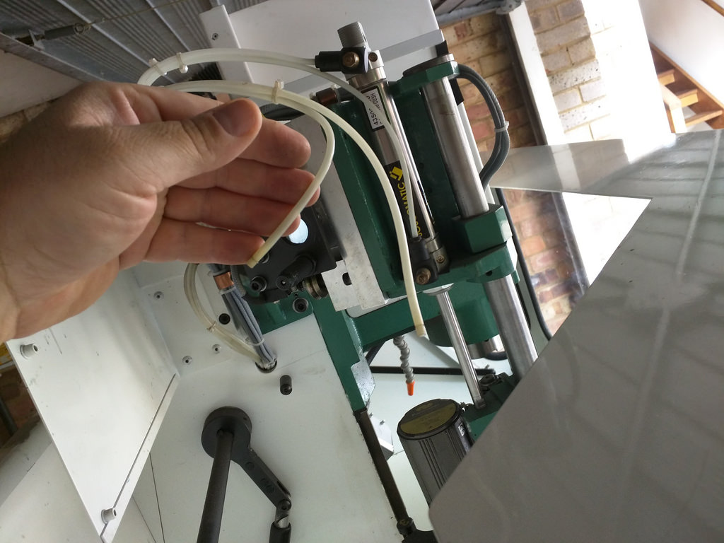

    OK, so first pics. There is something missing in the top left of the cabinet ...... and then on the top right of the ATC. Any idea what this could be? The wiring diagram doesn't seem to show what this is (shows as empty in the commissioning data). Will have to trace the wires to see where it goes. The rest look like pneumatic tubes or similar.

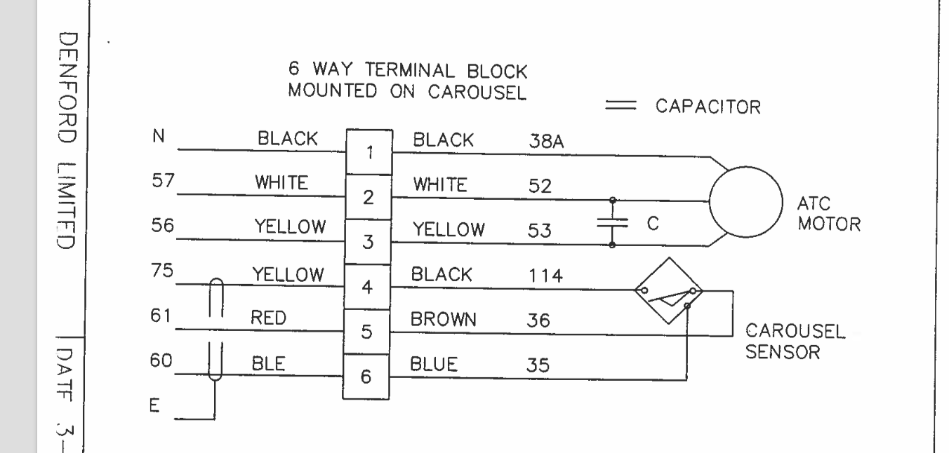

    OK, this is the ATC wiring diagram. I am assuming that its a servo on the basis that there is some encoder wiring. Would this be correct? The panasonic unit seems to be some form of geared motor.
    For the missing bits, the cover of the ATC is off but I dont think anything goes into the cover, not sure, will check when I get home.

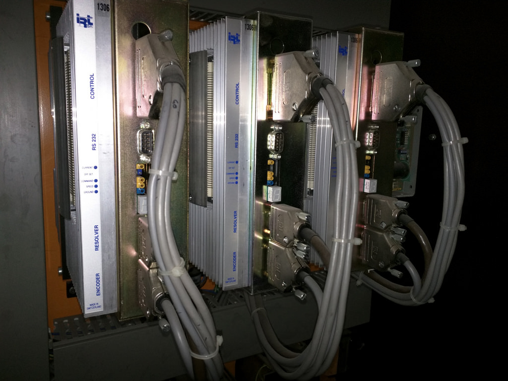

    These look to be the XYZ drivers. Assuming that they are in working order, are they usable / decent?
    http://www.irtsa.com/IMG/pdf/me1300re.pdf
