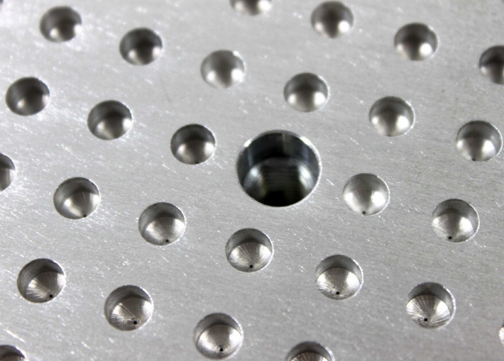

    Depends how fine is the sucking hole. Not the vacuum hole you see on pictures 3-6mm, but the real sucking hole in the vacuum hole center, it could be 0.5-1mm . Its a good idea the vacuum table to be made from 2-3 pieces and that could be dismantled for cleaning or repair.
    The vacuum table from the first link was ok and they have mats. any mat from superstore 2-5eur per meter will do the job, some experimenting is needed. cause they sell ridiculously expensive the mats.

    been trying to do a vacuum table setup but an failing badly.
    I purchased this -
    http://www.ebay.co.uk/itm/CNC-Vacuum...item487aa50799
    and today I got the uni-jet 75
    http://www.cattaniesam.co.uk/suction...ry/uni-jet-75/
    the guy from ebay recommends 3cfm, if I worked it out correctly the uni-jet does 1250L/min which is 44cfm. so in theory plenty of suck.
    got a 32mm pipe coming out of the vacuum pump, then just before the table reduced down to 10mm as that's what you need to plug into the vacuum table. length of pipe maybe 2 metres
    when on and you try to move the work piece with your hand, you can but its bloody hard, its stuck down pretty dam well. you have to really really force it to get it to move with your hand. but when trying to machine it, it seems to move so easily.
    I'm using a 6mm cutter, with a z depth of -0.5mm with a feed rate of 300mm/min
    anyone got any advice?

    Max. vacuum level: 140mbar (continuous service)
    Are you sure you have got the right pump?
    you need ~25
    Inches Hg which is around 850mbar vacuum
    My air compressor at home pulls on the inlet 0.94 bar =~ 940 mbar =705.05993009406 mmHg
    Your pump is way off, it seems.
    Who told you to look for CFM? you dont have 4x8 machine where you need 20HP pump with CFM rating.
    Unscrew your air compressor/ what ever size, 1-2hp is ok/ inlet filter and connect the vacuum table and check what i am talking about. Dont worry about the continuous use, nothing will burn. In fact it runs cooler. Temperature rises from compression, not suction. If your compressor is newish it will make damned good vacuum.
