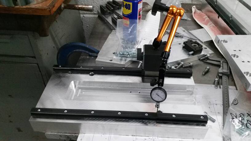

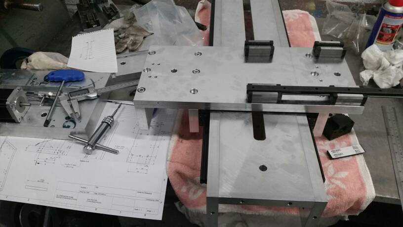

    I've got 15mm on my Y & Z and if I was doing it again I'd buy 20mm all round. The Z axis I've got round by using a 40mm thick plate and recessing it for the ballscrew and mounts so I could put the bearing carriages flat on the back plate...

    Neil...
    Build log...here
  9. #8
    That pic explains the problem very well. ..Clive

    There are many ways to do the same thing but your way is adding expense and weight to an area where you want to limit the moving mass. The larger rails don't really add much strength but they are considerably more heavy.
    Maching slots for clearence while trouble some if not kitted up to mill the slots does give the advantage of reducing weight without sacrificing too much strength. The lighter and shallower 20mm setup gives a very strong and low profile setup making for a nice balanced Z axis.
    Either way would work.! Thou IMO the 20mm rails with lighter plate setup gives better balance of strength and acceleration/speed with nema23 motors.
