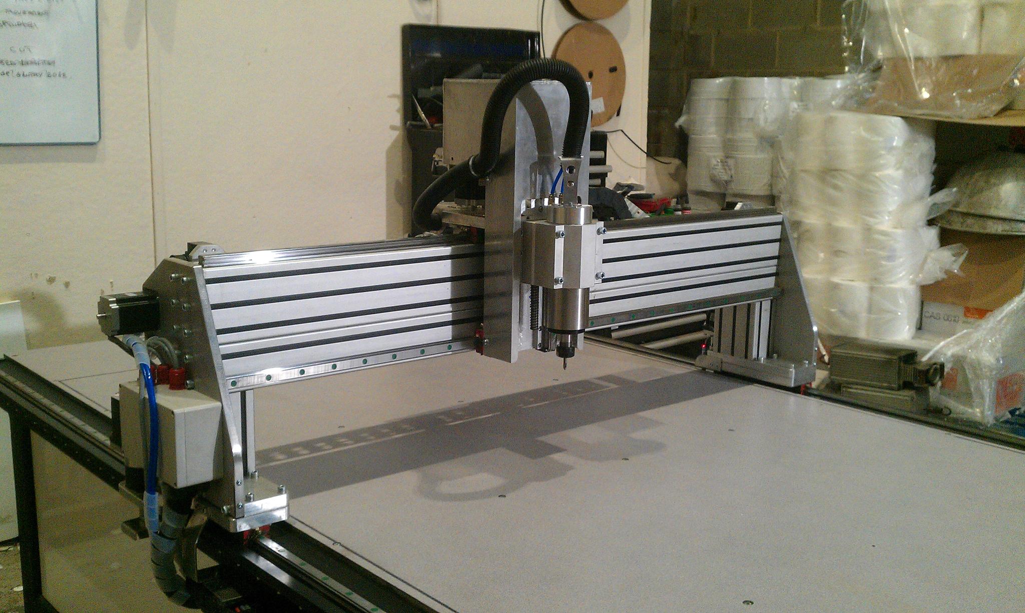

    Okey fellows! Haven't decided what size for my aluminiumextrusion gantry. Been thinking about 160x80 but glancing towards the L-style way. Ran across this: http://www.motedis.co.uk/shop/Slot-p...999993754.html what do you say about this?
  7. #26
    Not really suitable being only 80mm tall. However depending on size of machine 160mm will be touch on tall side. This gantry on 8x4 machine is made using 120x80mm and believe me it's more than strong enough for any router.

  8. #27
    Nice looking machine ;)
    My gantry will span 100cm.. so 160 may be overkill?
