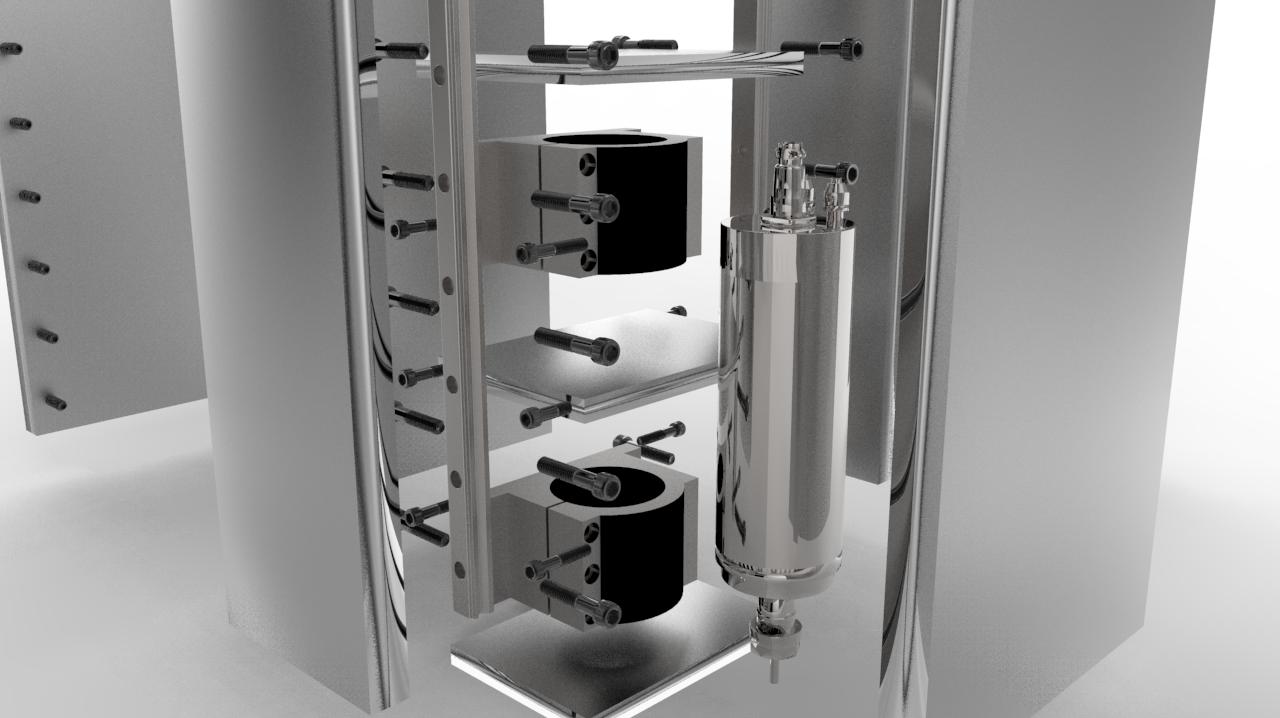

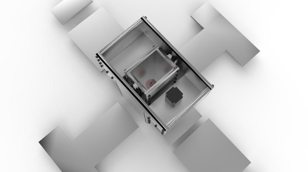

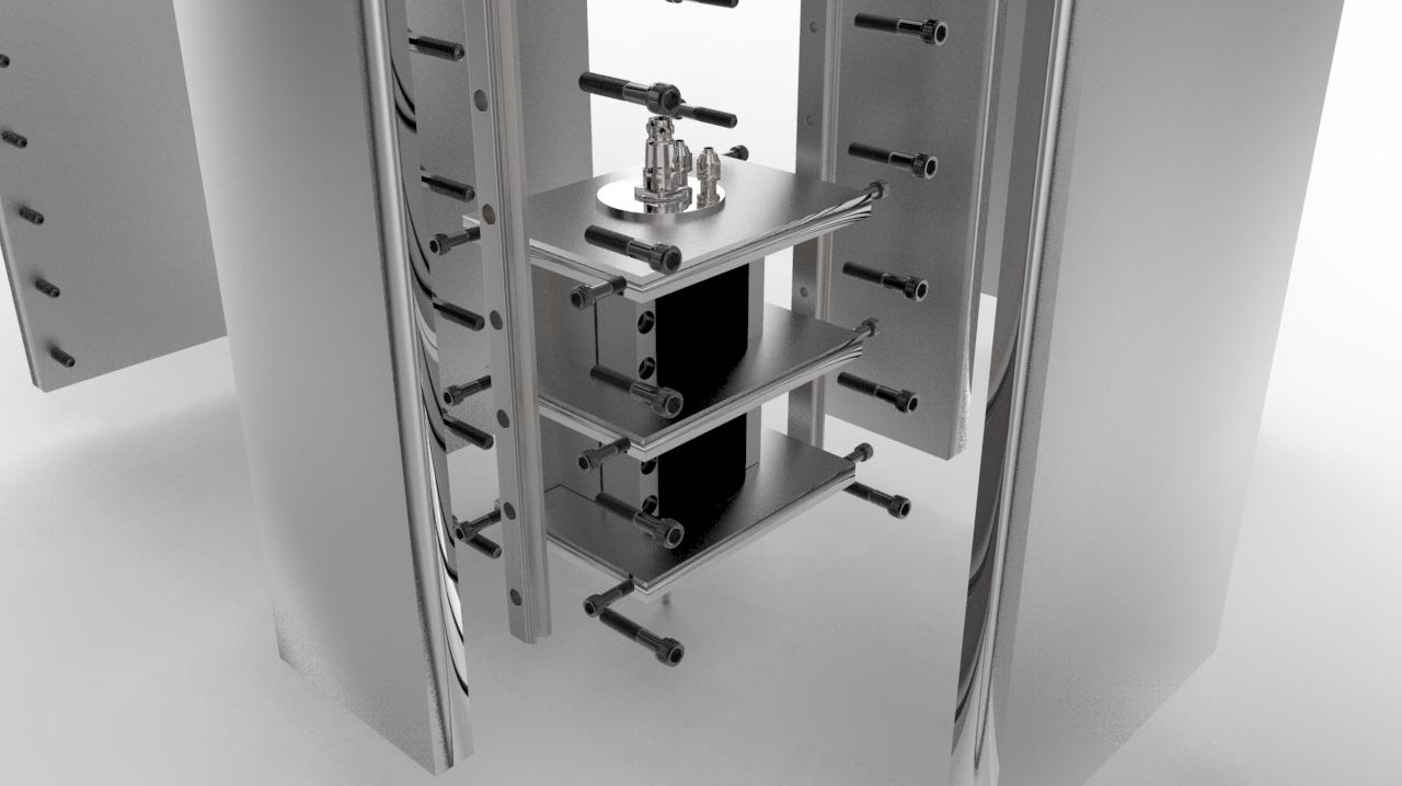

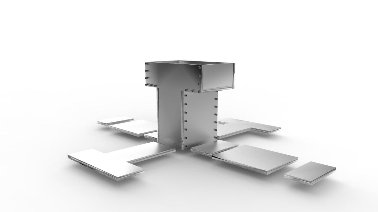

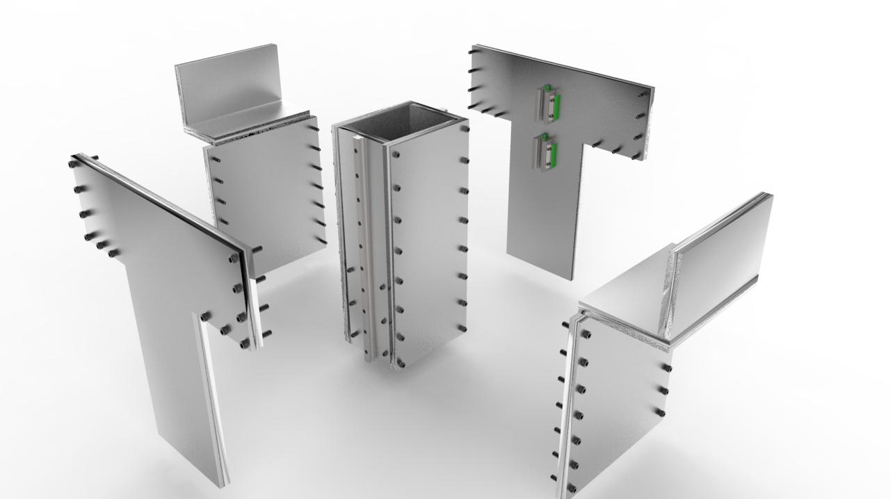

    thanks again guy's, the shape of the z axis plates are quite plain and simple its just the holes that need cutting out for the spindles and all the m10 and m8 bolts, the plates are 25mm thick and the 3 plates that the spindle sits in are 15mm.
    cheers
    Ash

    Do you not think that this is OTT I think you will have difficulty in finding someone to drill into the ends of plates to the accuracy that will be needed to put this together. Then you have to think about maintenance .
    Please don't take offence it's just my two pence worth.
    no offence taken im here for advice and most important for my benefit "criticism" :) ill go back to the drawing board then to figure an easier way to bolt this together.
    cheers
    Ash
    i think maybe if i just got all the plates cut to size and all face sides drilled and tapped by experienced people then when it comes to the edge of the plates i can align all the plates together and mark out the holes from the plates and then just clamp and drill my self using a decent pillar drill. the plates are 25mm thick so plenty of space for 10mm bolts.
    unless anyone has a better idea :)
    cheers
    Ash
    As Clive said getting the tapped holes in the edge of the plate will be a mare.
    It needs to be set up on a mill,clocked in and drilled using digital readout then a couple of dowels after its all squared up. so your back to a machine shop or one of the nice guys on the forum.
    Mike
    Or alternately get a nice member on here (or make yourself) one like Wal had made for drilling and tapping into the end/side of the plates....http://www.mycncuk.com/threads/6164-...-Jig-Finished!
    Neil...
    Build log...here
