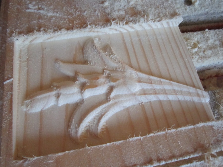

    Problem solved. :) Thank you for all your help.
    The PC LPT port generate strange pulses .... from 4000 ns to 300 000 ns.... ( based on linuxcnc tests .. )
    Why I not saw the problem ..
    I tested all the electronics with my another PC ... ( also with the same problem .... but a little bit better !!! ), I used another PC with CNC machine for manu years, but just for some small cuts .. with perfect shape ... )
    So, I suppose my first PC is OK .... with both PC s .. the problem exists .... so the problem is in the electronics ....
    But when I tested it with NE555 generator .. motors are fine !!! So ... I became almost with no idea what to do ..
    I grounded all, used 74HCT245 ... 6N137 ... to change the logic voltage levels .... and finally on the last started the linuxcnc
    for N-th time and saw strange situation ....
    After start i have 4000 ns step period ... and after a while ... 1 second ... it increased to 300 000 ns.....
    after reset statistics button .... the same situation ...
    Mach3 doesn't see the wrong signals .... message is "System excellent" !!! :(
    I didn't investigate to check signals by scope in time period ... I have no time for that ...

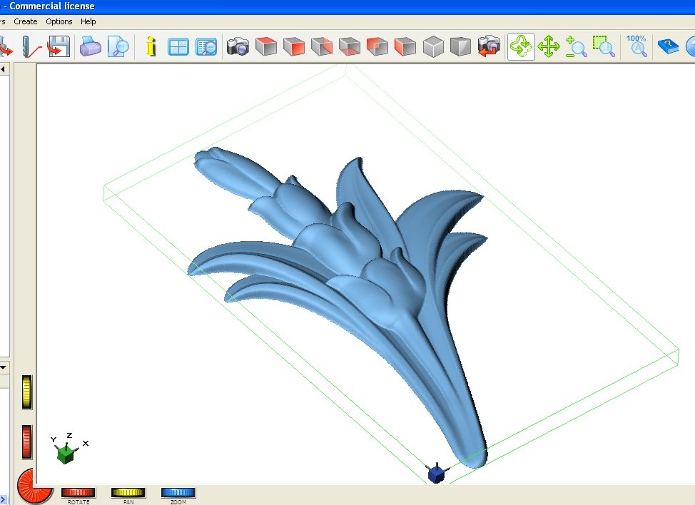

    So, please fine attached first cut picture - 4 mm carbide tool in wood ..... Sorry I am not woodmaker ... it is just a test
