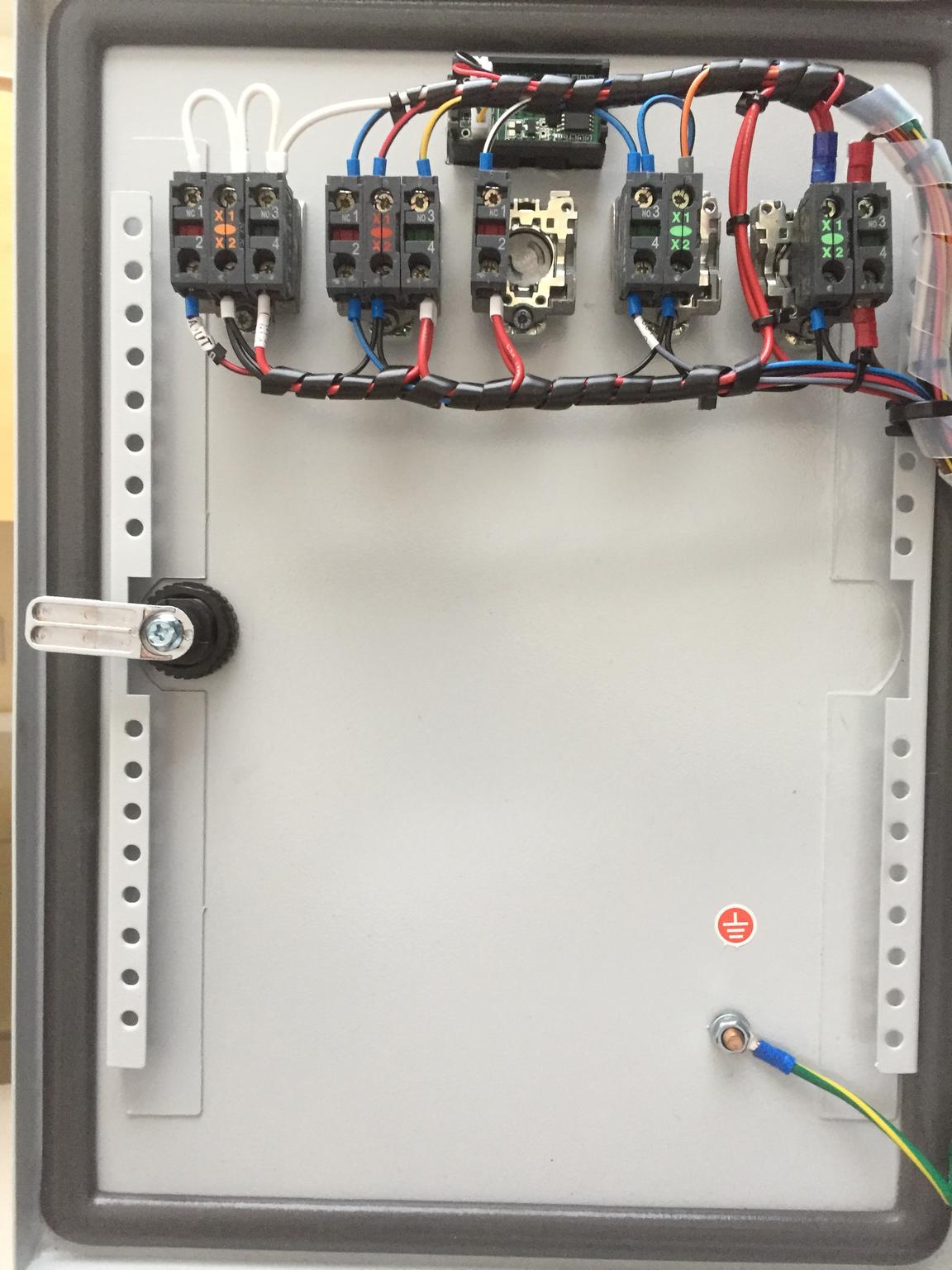

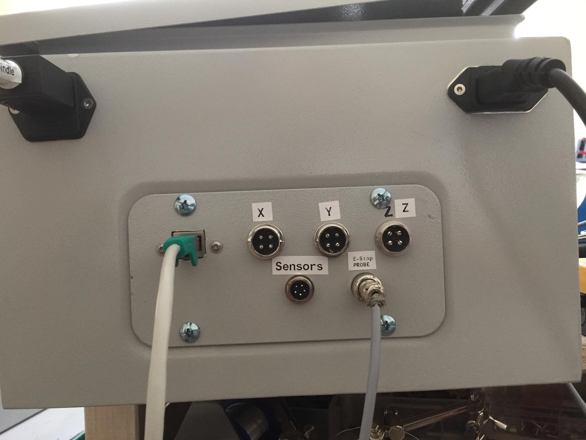

    And our control boxes aren't a million miles apart either:

    I have made some slight changes since I took the pictures - driver feeds to axes are via a row of XLR connectors on the LH side of the cab. I found that I was fitting and removing the cab fairly often when setting up the machine and the hard-wired connections were a pain in the neck. Literally, given their position...
