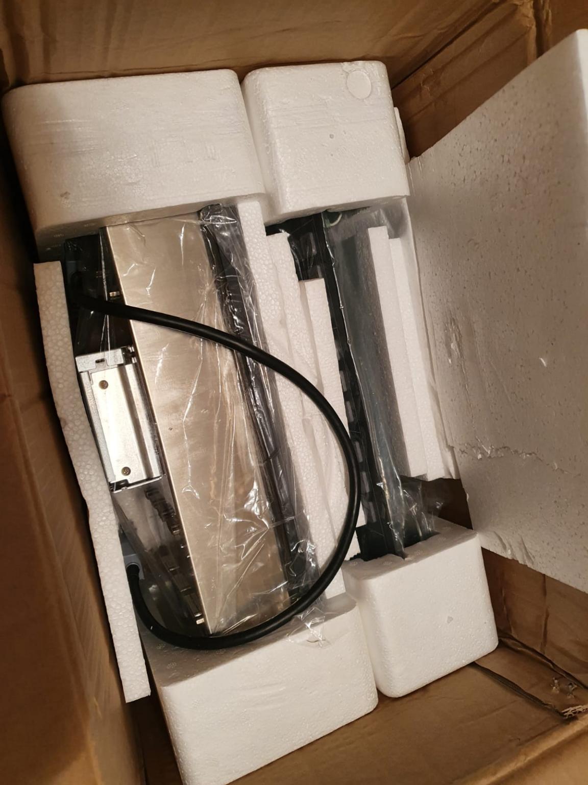

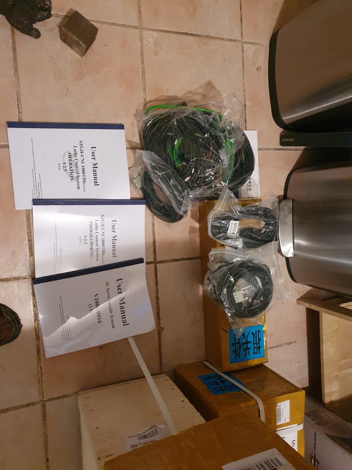

    So I bought the Hardinge (and Herbert) lathes that Gary was selling a few months ago.
    Fast forward and I have selected a controller, replacement AC Spindle (Im not going to fuss with the DC system) and AC Servos for the X and Y Axis from SZGH, inspired partially from JazzCNC's experience of them (and my own) as well as others such as Hood and other 'known' hobby folk.
    So, stuff arrived today, I think I am fortunate, I'm hearing of other people stuff from China being cancelled due to C19, so I think I was lucky.

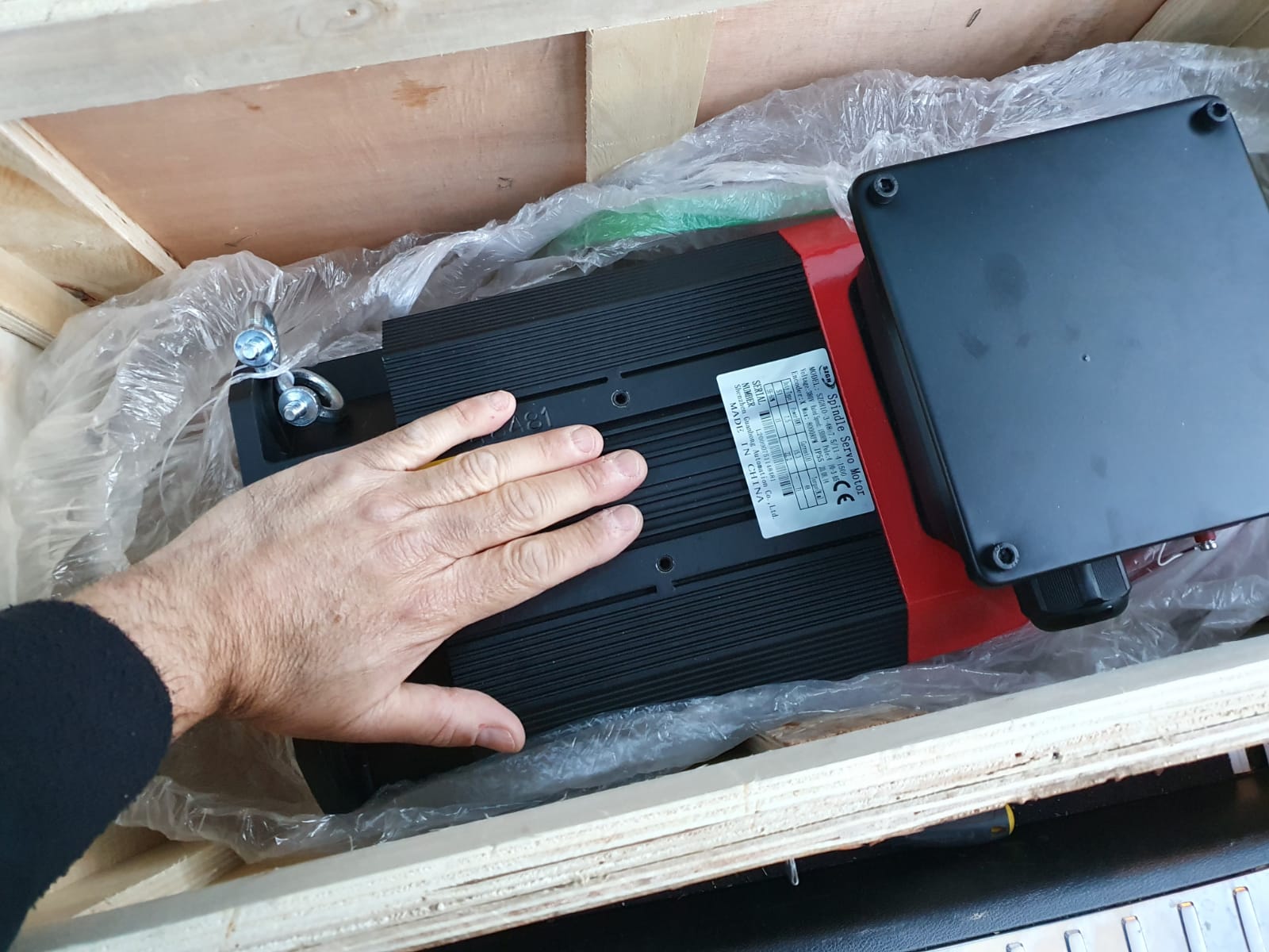

    The replacement items is the 2 axis control system with their 'C' Panel, 2 x 750W Servo motors and a 7.5 KW Servo for the spindle. The spindle is 'down' on the DC motor's torque figures however not by much. Going any larger would have needed major physical work on the mounting whereas here, I should get away with a simple adaptor plate.
    The spindle motor on its own weighs over 60 kg, a beast of a thing. I dont have 3 phase yet, they have told me it will run off single phase (reduced performance) however that is enough to get the machine running and working. 3 Phase will be sorted at a point.

    When they say reduced performance on single phase, it shouldn't be by much. The main difference is that the input current is shared between 4 rectifier diodes rather than 6. The dc voltage ripple inside is slightly higher but of no concern. It should work identically, with a slight (10-20%) reduction in S1 continuous power rating. I'd be interested to hear what derating they recommend.
    I'd be surprised if you got anywhere near 7.5kW continuous shaft power on a machine like this. I'm guessing you bought this for low speed torque as much as anything, at which operating point the input power will be a fair bit less than 7.5kW. Personally I wouldn't bother with the expense of installing 3 phase when you could spend that money on more machine tools....
    Thanks Muzzer.
    Ive been quoted around £4500 for 3 phase. I am limited at this type of machine at current levels but it remains an option.
    Yep, I was willing to take a chance on this setup and running it on Single Phase. It will certainly use all the current available to it but yes, 7.5 KW of actual cutting load is a lot. If the machine is sold to someone else, at least they know its capable if connected to a suitable power supply but for my needs, I doubt Ill ever need that.
    The hardinge has a belt / pulley setup so I Can mess with ratios to get what I need but yes, generally low torque for materials that are hard or like thread cutting where you might be using slow RPM but need the torque.

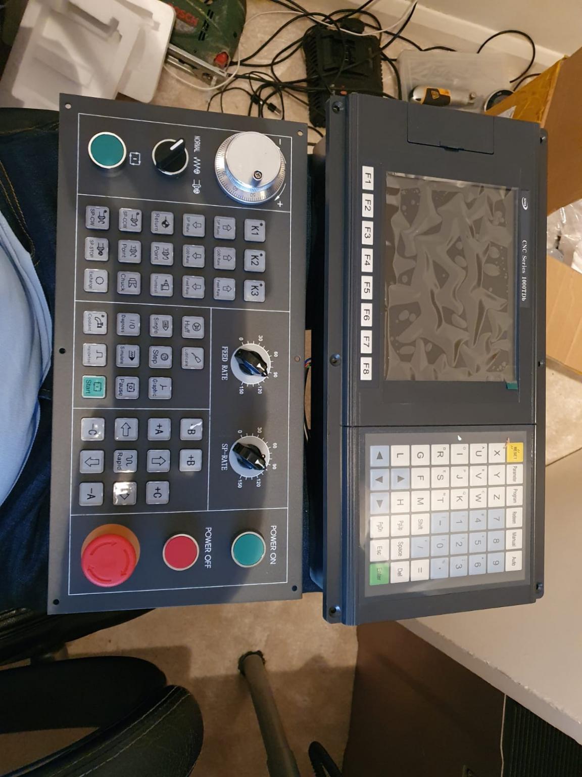

    So, first impression of the kit is good. I agree with JazzCNC, the cabling is good quality and nice to see that its all included. There is also a dedicated turret input for an 'up to 8 way' location which is helpful.
    I wasnt aware of the IO board, pity, would have ordered one but will manage without or get one at a stage.
    I managed to get one of the motors connected and running. Was getting errors but didnt have a manual for the servo driver but was sent this over the weekend and it looks like it might just have been a connection issue to the encoder.
    On the turret side, they will help write the macro once I explain the tool change logic. On the Hardinge theres a few solenoids but nothing odd as such. Fortunately Centroid have published a retrofit document for their kit which is useful and can be modified for use for this implementation.
