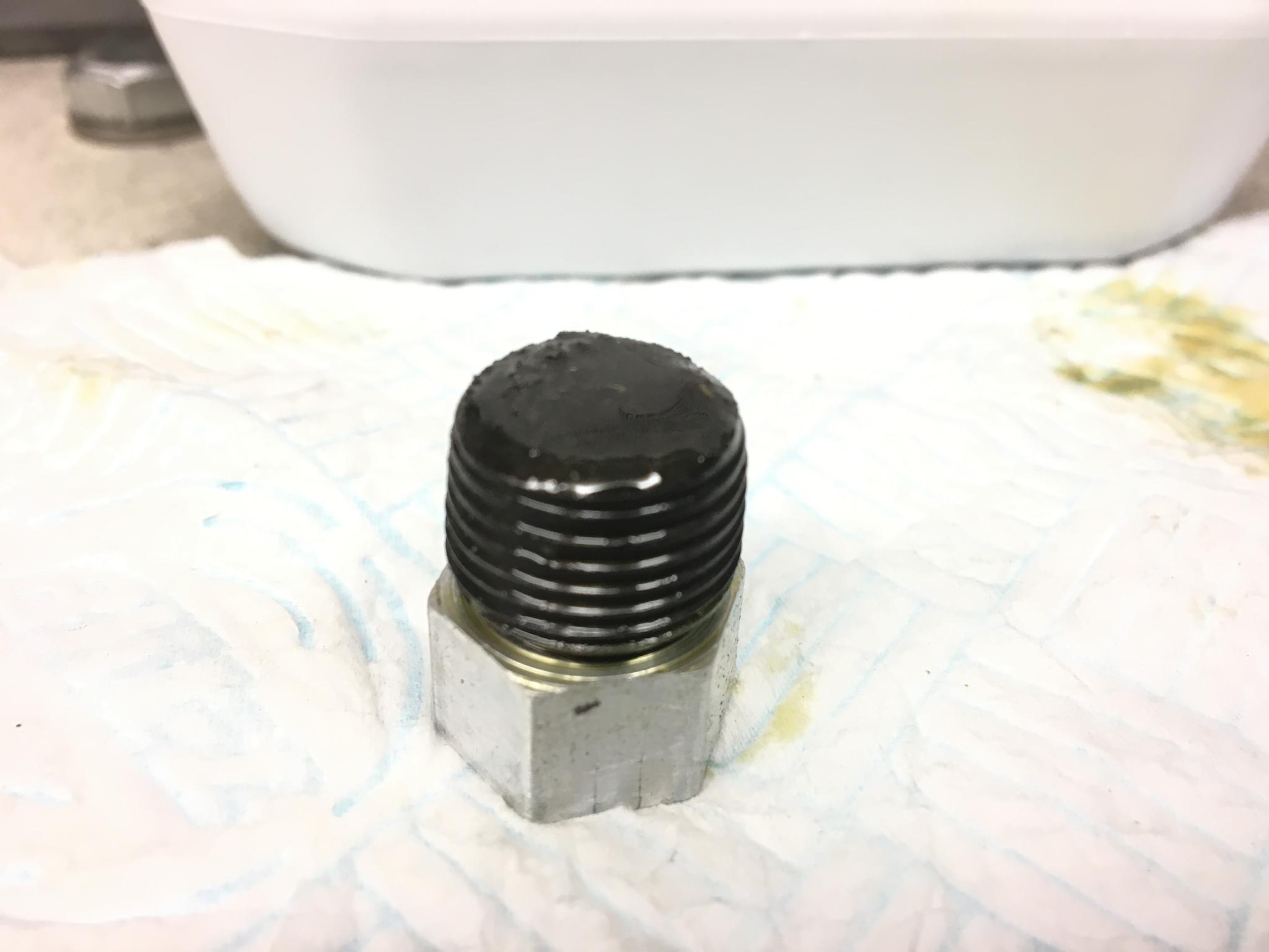

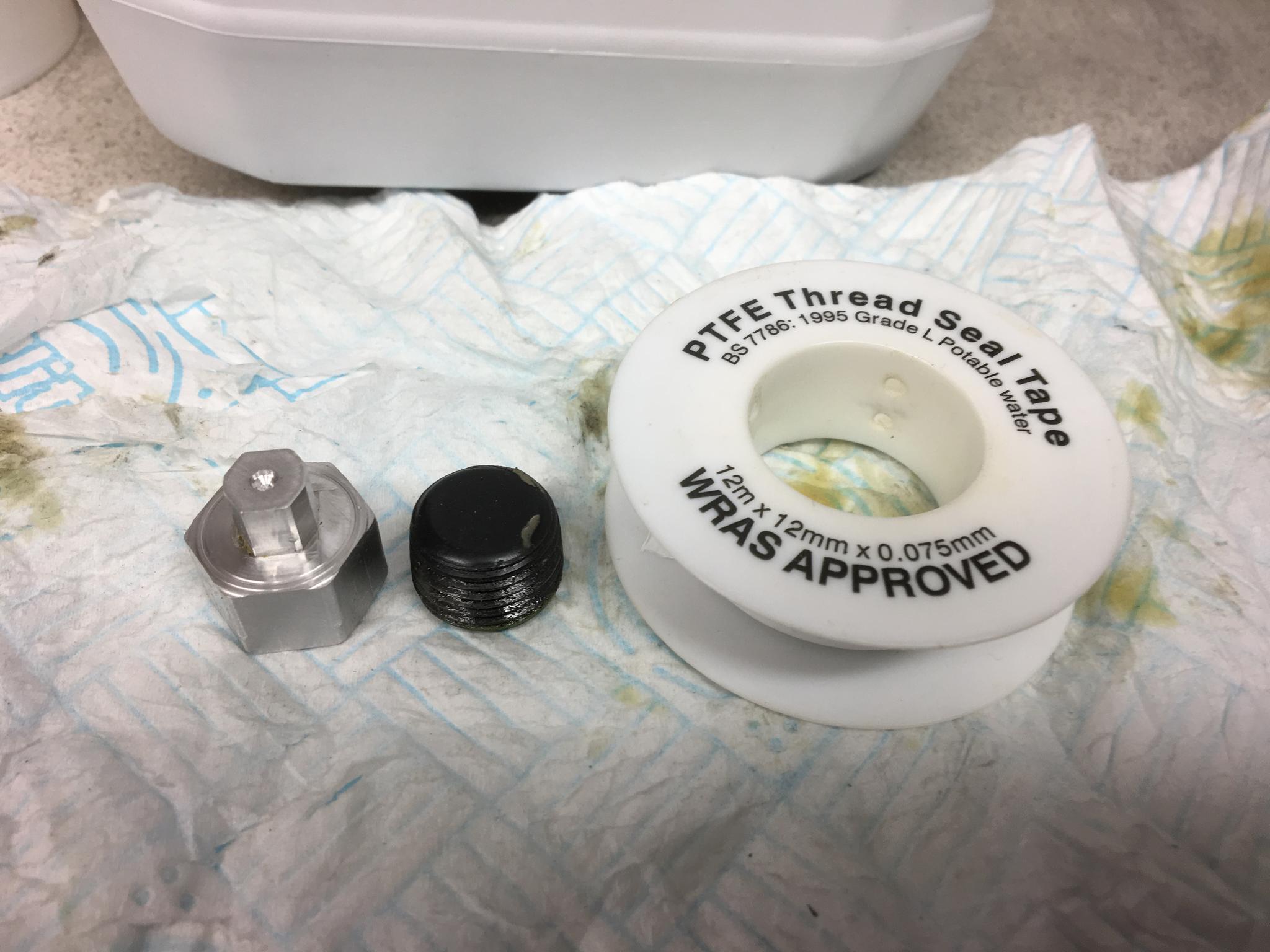

    Only thing bothering me on the lathe is that the carriage has a very slow oil leak. After a year of ownership it stopped dripping about 2 months ago, and the oil sight glass showed it was empty. I bought some more oil at a recent show and have finally got around to trying to fix it.
    First problem was that access to the oil plug was quite tight - not enough space for a hex key. Thought about grinding one down, then decided to make a tool. I had a round aluminium bar with a hex shape on it (from another job) and machined a small hex on the top:

    Cleaned it up, put around 5 rounds of PTFE tape on and tightened it up.
    Filled up with fresh oil and . . . . .
    . . . it still drips (slowly)!
    I might not get on this again until next week end but anyone else had this problem? More PTFE or am I missing something?

    I would normally expect to see a head with a machined seating which bears on a matching machined flat on the bottom of the carriage, plus fibre washer. Clearly here they seem to expect the threads to seal. If PTFE does not do the job, then it might be worth trying Loctite 55. I've had a lot of success with that on household plumbing - typically the screwed fittings that go into the bottom of radiators that also rely on the threads sealing. I've had first-time success with every one of those, where using PTFE has been less reliable. Might be my technique, but I'm sold on the stuff. Can't see that it says anywhere that it's good for oil - just potable water and LPG - but I would probably give it a go.
    Out of curiosity, what oil are you using?

    The oil is coming out where shafts run from inside to outside, not at the plug ;-)
  10. #40
    I was curious about this drain plug, I couldn't find it on the parts diagram, so I went and had a look at my 290 and it has not got one, but the shafts are oily as Nick suggested. I am not concerned, the sight glass is half way, and soon my shot glass will be full again
