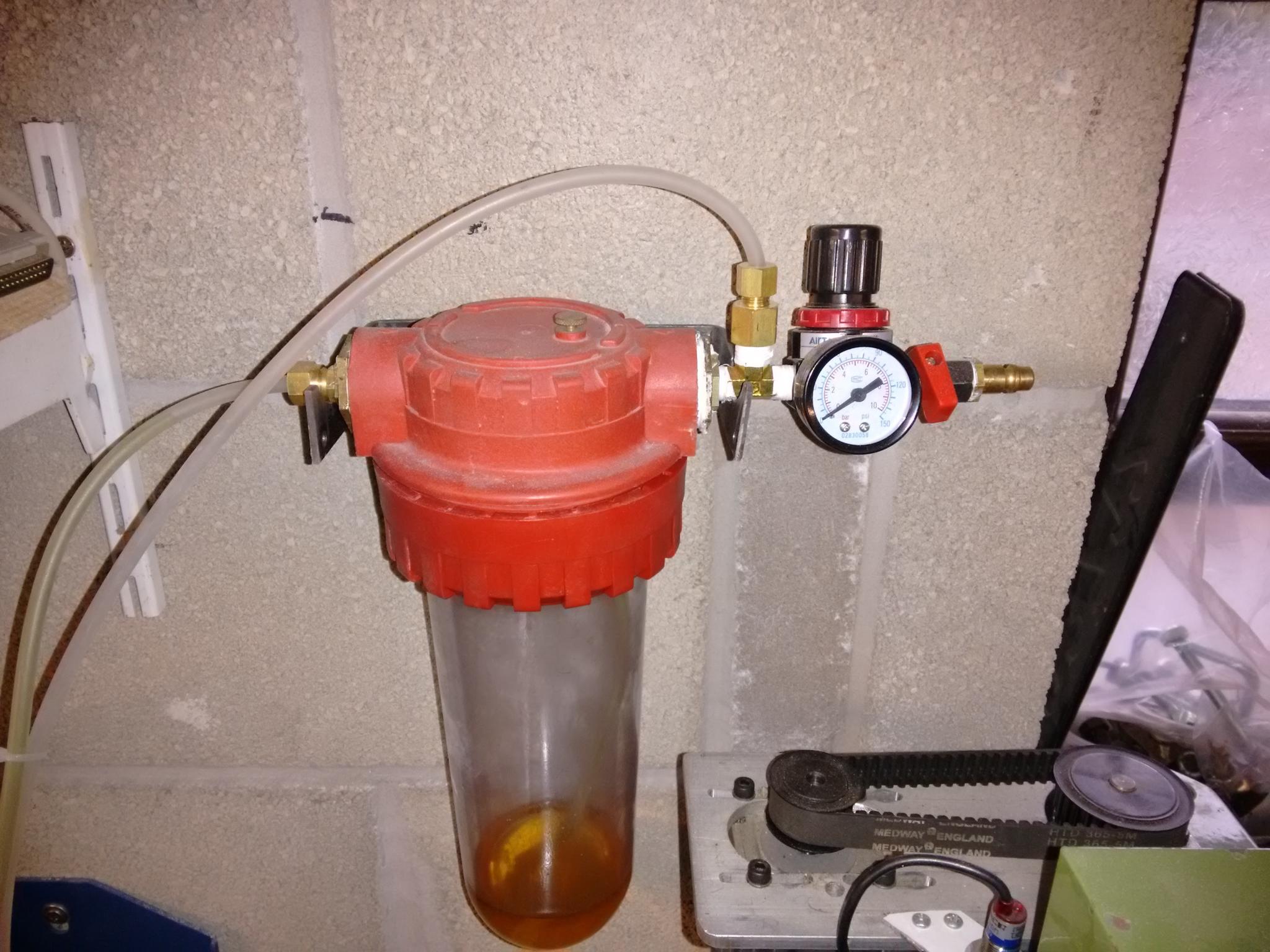

    I bought one of those misting nozzle kits, not impressed with it - its a mister and creates a cloud, I am going to build a fogless coolant system instead.

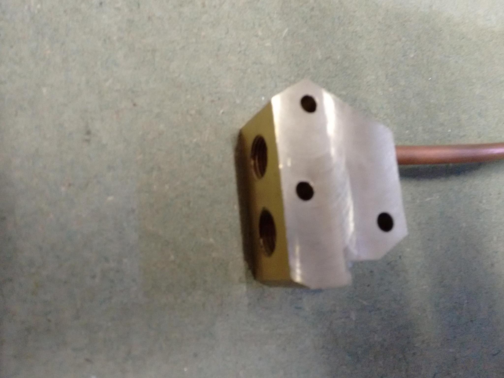

    Dave I built a few of these just my version of a copy from a well proven design that put droplets in the air stream.
    The manifold was made from a hex piece of brass bar.Click image for larger version.

    Lance fogger Hex Bar.dxf
