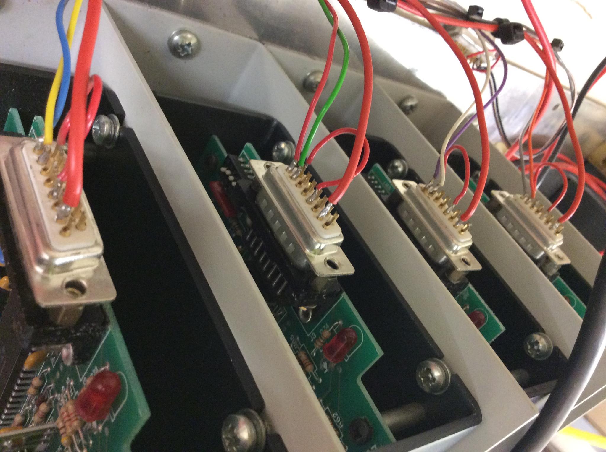

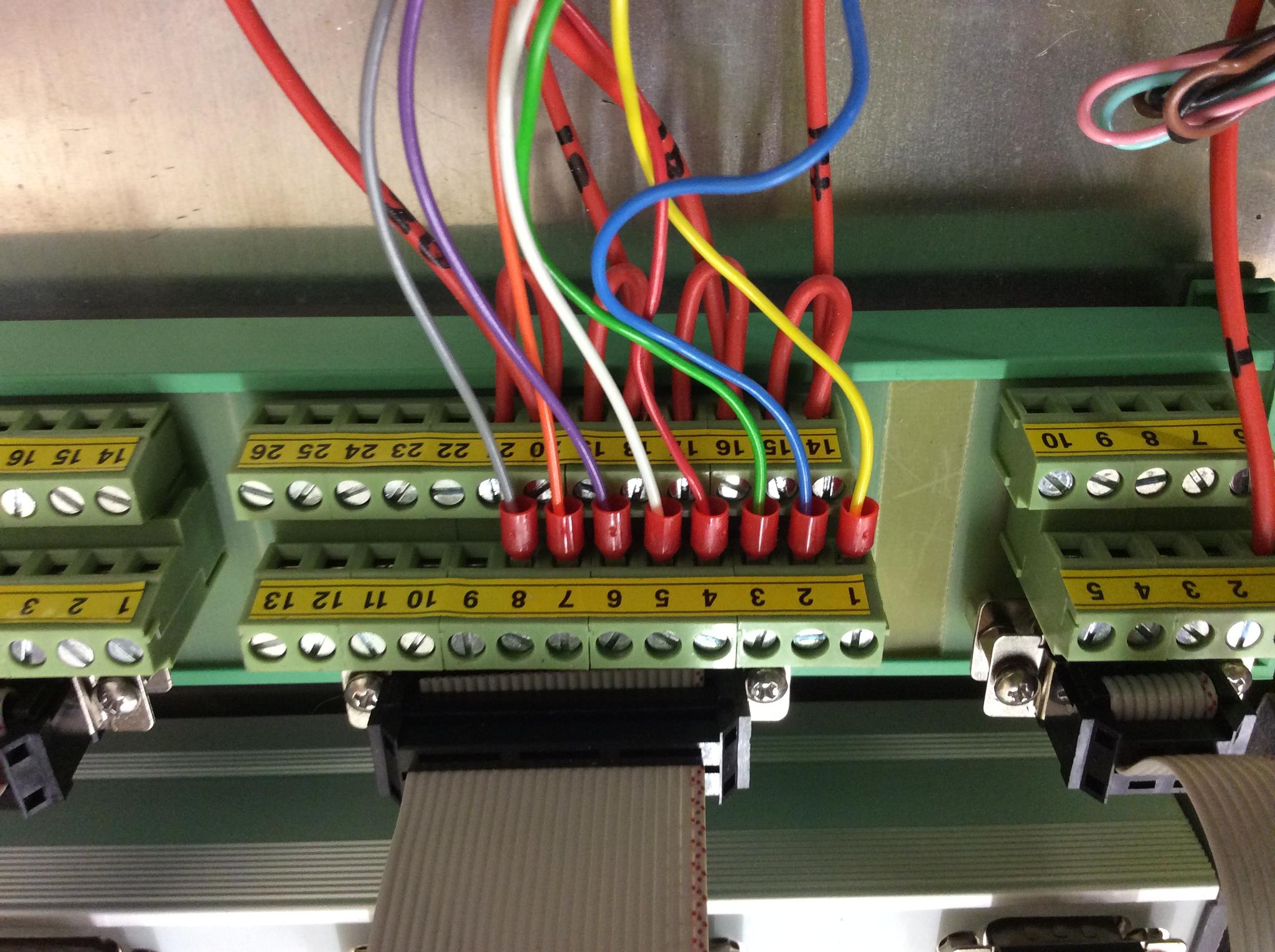

    i will take you some pics of the wiring, I cut the wires and connected them into where he told me, the machines axes were smooth and quiet at 5000 mm/min Rapids we then set out to rewire the spindle as when we powered the machine up the spindle was always running at about 100rpm with no command, and even when we command m5 still it run,
    but since then I have no contact with the chap so the reason that I so stuck.

    Ok from the existing wiring on the drives you can see where they have been connected to the CS labs and you can also see the "extra" wire I have soldered onto the connector,
    that hot wire you mentioned earlier goes to the large contactor (enable activated) which has a 240v wire to one of the contacts, so I am now in a position that I have no reverse (m4) but I have control of m3 but the spindle still runs slowly at power on I have got hold of the collet chuck in the spindle and it's not driven with any power,
