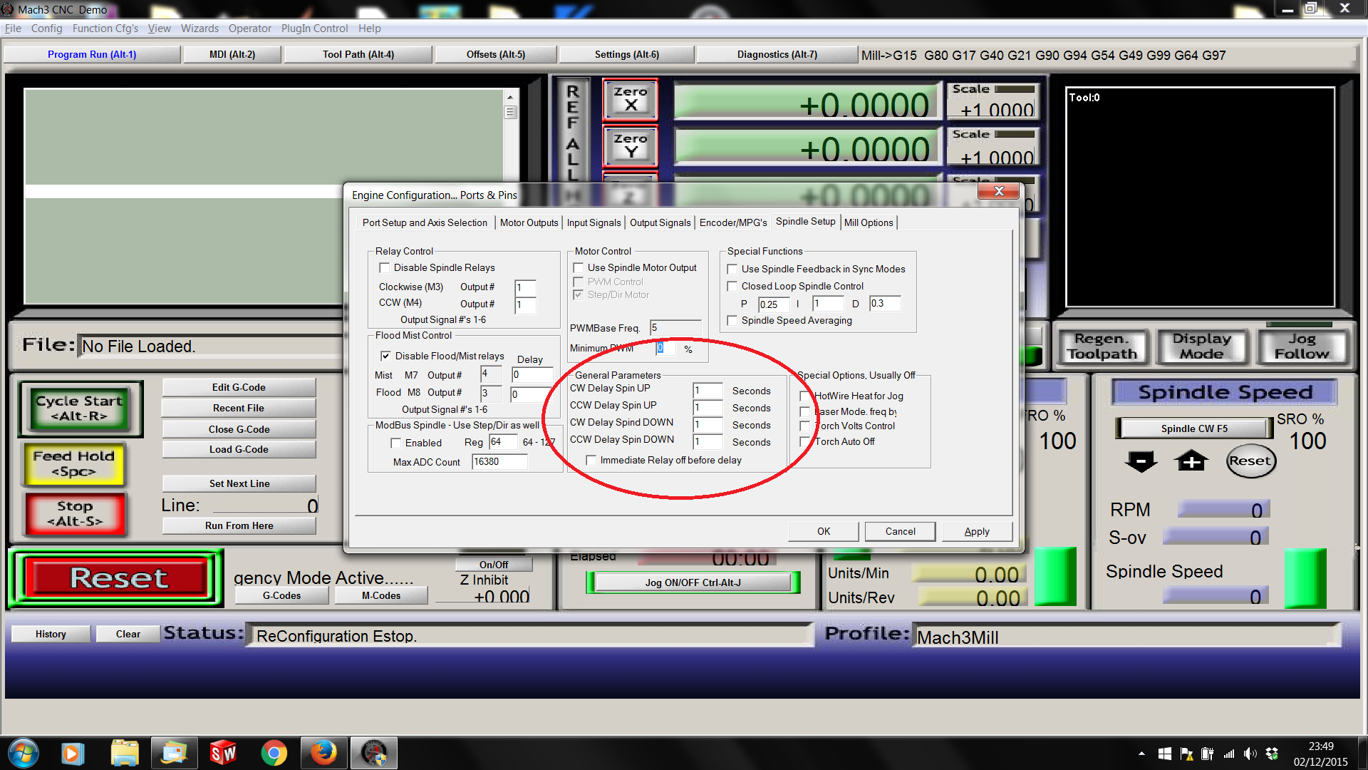

    would it be deemed unprofessional to wire the spindle forward relay only and strip out the reverse wiring?
    dont get me wrong I would like full functionality out of the machine but for the amount of time it will take me to work out how to wire the reverse without damaging the CS labs unit versus the amount of times I will use m4
    is quite an easy desicion but if it really isn't that difficult I do enjoy learning.
    No it's not unprofessional and we are DIY so what's it matter.! But that said it's not difficult to do anyway so really no reason why not to have it.
    The main thing is that the Spindle comes to a Complete stop before the Reverse Command executes. Mach3 provides a way for this using CW & CCW Spindle Delay before turning on the relavant output. It's just a case doing a bit of experimenting with timings to how long it takes for spindle to come to complete stop. . . .See pic:

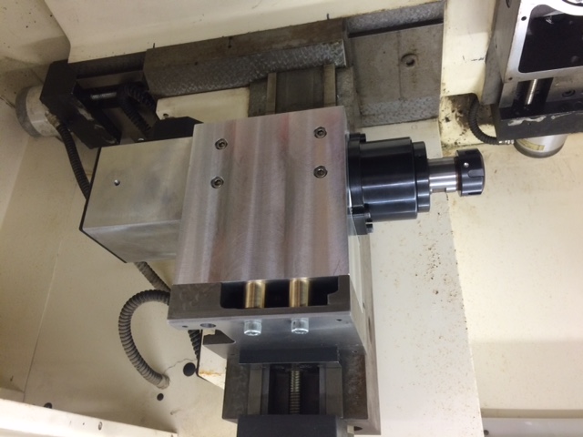

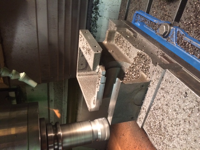

    Hello men, I have been busy altering the spindle and the y axis casting!!!!
    i know the machine isn't original but it will be fit for purpose for me it's a 18,000 rpm teknomotor with an er 25 collet, running on a vfd, I want to be able to take advantage of speeds and feeds for brass parts and leaving the machine electrics "stuck" in the 1990s without proper diagrams for trouble shooting is a problem for me.
    jazz thanks for the pm I am thankful for the offer of help,
    i am stripping the system out and starting again, fitting limit/ homing switches touch probe for tool length setting,
    uli what is the prox switch for on the a axis?? The switch is present but nothing connected to it on the other side of the terminal block,
    i have lost about 25mm in z axis but it's ok to work in centre of table with a chuck and I will make an off centre tombstone for any bigger jobs.
    here is a pic from the new motor fitted,
    I will put the odd picture on of the alteration, some proper "you've done it now" and "oh shit no going back now" moments, and until it's up and running there will always be an element of "have I done the right thing"
    but it's done now and I am suited with the result so far,
    I did this part on a vertical at work at night,
