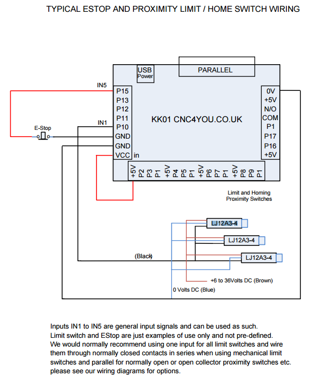

    Sorry to be dumb guys but im getting lost within the techno on your answers to my question, I am no electronics engineer!
    I found this wiring diagram for my KK01 specifically for prox sensors..
    There are also some words underneath which say..
    "We would normally recommend using one input for all limit switches and wirethem through normally closed contacts in series when using mechanical limitswitches and parallel for normally open or open collector proximity switches etc. "
    Can I just copy this wiring diagram for the sensors and put my 24v in where it says 6-36v?
    Any problems with this ? They suggest these prox switches : LJ12A3-4
    Martin
  9. #88
    Martin The ones I linked to will be fine and yes the drawing is OK If you are going to just use one input.

  12. #90
    Quote Originally Posted by mturneruk View Post
    Like Clive says yes you can wire just like that.
    Also you use the E-stop portion the same but instead of running thru the E-stop button like they show run it thru the Relay Contacts of the E-stop system I did for you. Then power the Relay coils like I show using the E-stop button.
