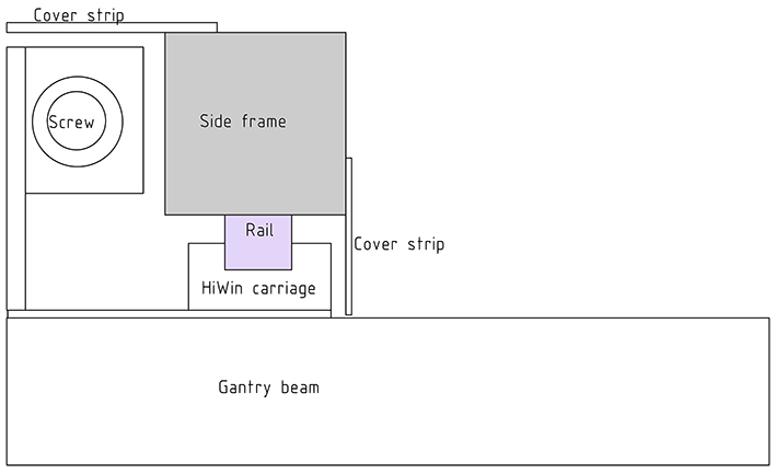

    Just done a rough sketch of what I was thinking.
    If you wanted to add support to the side rail, you could use a wider box section, and either move the rail nearer the edge and have the legs/supports mounted on the opposite edge, or use a double box section, with the rail on one and legs/support on the other.
    Dust could be mostly eliminated by adding a couple brush strips, or suitable strips of metal with minimal gap either side of the rail to further reduce the ability of dust to settle onto rails.
    And having just looked at my sketch and thought about how to protect the screw from dust, mounting it at the side of the rail so you only have one 'area' you need to minimise dust ingress might be an option.

    Lives in East Lothian, United Kingdom. Last Activity: 21 Hours Ago Forum Superstar, has done so much to help others, they deserve a medal. Has been a member for 9-10 years. Has a total post count of 2,908. Received thanks 360 times, giving thanks to others 8 times.
    Regarding the R&P v Ballscrew, both have their pros and cons.
    As Lee mentions, a plasma doesn't really need the accuracy of ballscrews, but the biggest drawback is coming up with a design to keep dust out, as I'm sure you're well aware, plasma dust is pretty abrasive and will quickly kill ballscrews.
    However R&P on the other hand, provided it's designed well enough, will be relatively unaffected by dust, but you lose accuracy, and have the issue of dealing with wear, especially uneven wear which will be challenging to adjust out to minimise backlash while avoiding binding. Off course the solution to this could be simply changing the racks when worn, building in some form of spring loading of the R&P, or using anti-backlash pinions.
    Both options have pros and cons, both will work, and both can be designed to have long service lifes. As with most things, it comes down to implementation.
    Hmm, thanks, I have doubts now, not good;)
    I wanted accuracy for small part cutting in thinner materials, so high speed without wiggle on the torch.
    Putting the screw and rail under the beam is ok but is filling the gap I wanted left clear for large sheet entry, likely only a few inches clearance left and the covers will be at risk of taking a battering from sheets.
    I see machines like PlasmaCam (which I think have a good name?) running simple plate/skate runners but they do use servo drive, they seem to work ok. Other production builds like Torchmate and PrecisionPlasma use various other simple systems ranging from belt to R&P. All mostly with not much regard paid to keeping the muck off of transport parts.
    But there again, none of them using ballscrew either!
    I'm not sure where this project is going now, back to stage 1.
    Compromise.
    Or just make a water table so you don't have to worry about dust :-)
    If you do go for ballscrews, then you are going to have to ensure they're well protected, whereas R&P doesn't have to be. Yes you'll get backlash using R&P, but you need to remember that Plasma is not that accurate a method, so even 0.5mm of play isn't going to have much effect on most items.
    Personally, I'd be designing the table so it sits above the side rails, that way the only thing in the way during loading would be the gantry. You then only have to handle dust from above, instead of spray back/dust coming up the way as well. You will still get some dust coming up the way, but hopefully a lot less.
