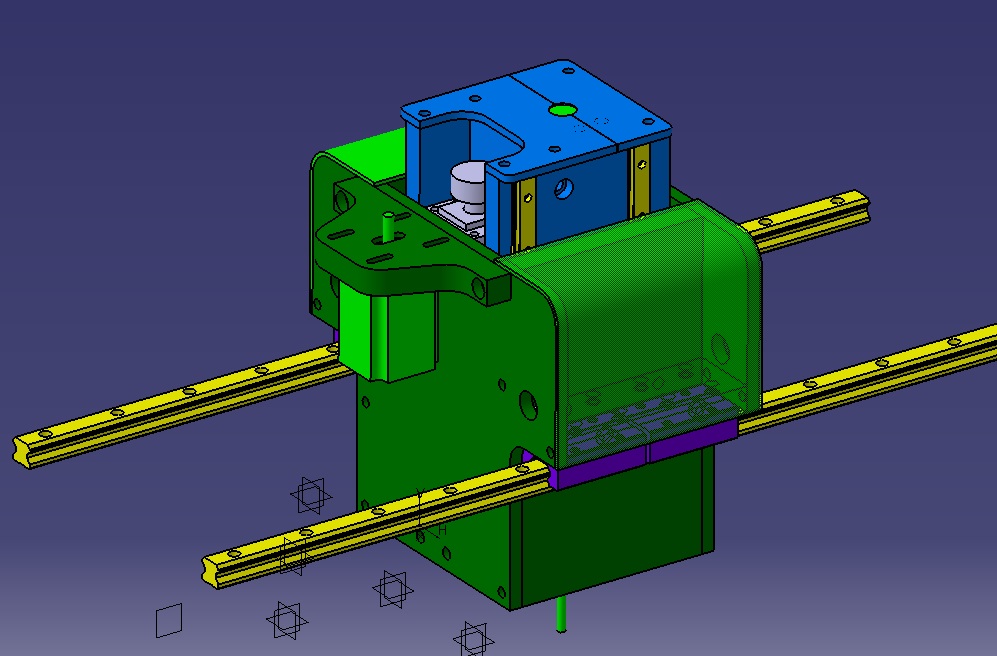

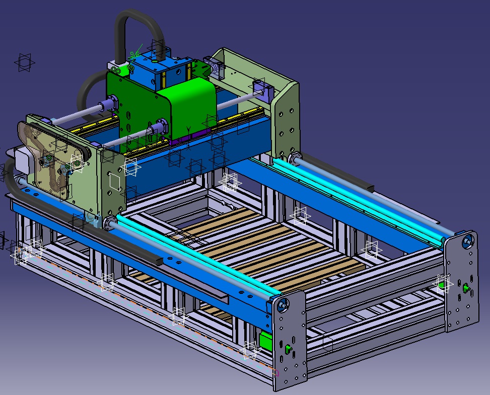

    I've also been working on a new design over the past few weeks based on the DMG Mori - here is my attempt so far:
    Iso metric:

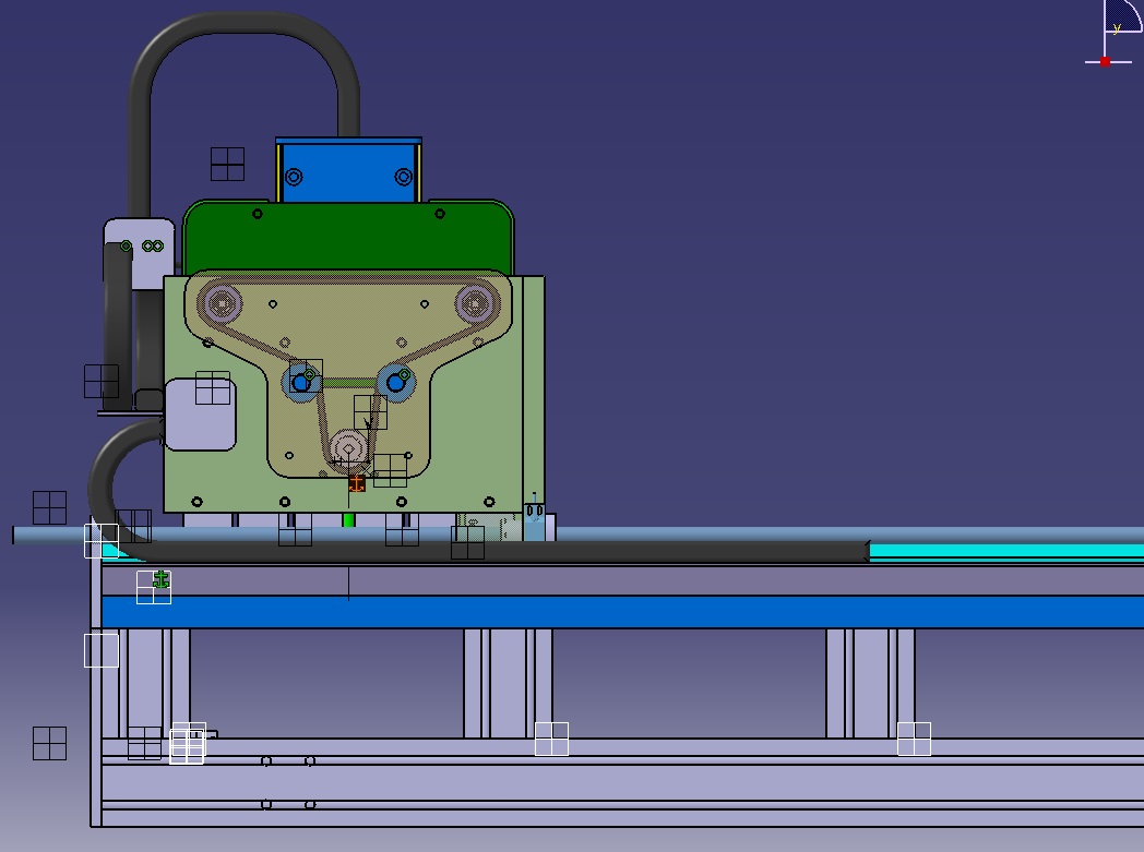

    Side:

    Y axis:

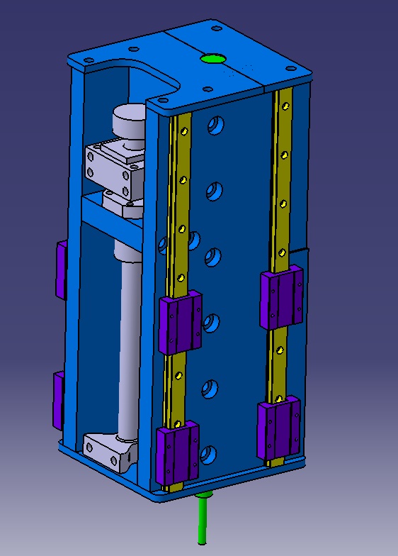

    Box Z axis:

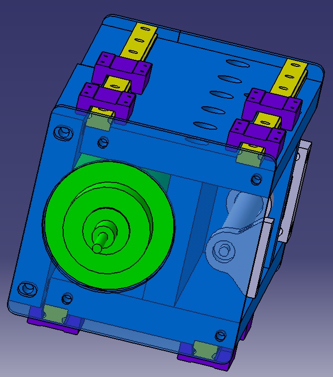

    Underside of Z axis showing spindle clamped by front plate:
    Yes, forget it. How big should the machine be?
    That dubious concept isn't as easy as it looks. I think they have a gantry Axe on Y (if the normal X-Y is correct) only, because Hermle have a patent for a centralised Spindle. Gantry have no advantage against 1 spindle in the middle, except in a really large machine.
    And your control must handle 3 of it. Can it do this.
    The same for X and Z. This construction is ok, if you have a spindle with a ton or more. If not its much too complicated.
    And the Z axe don't work, you have 4 guiding carriage (I hope the word is correct, the slider on the linear guide) 4 or eventually 3 is correct, but not in these layout.
    You need 2 sliders per linear guide. And if you want 4 side by side each must
    parallel within a rather tight tolerance.
    If its for yourself and you don't want to sell it, then you can make it with a central spindle.
    A gantry spindle brings no advantage, but much more effort, each Motor and driver must bought double.
    The concept with the u-shaped bed is good, but all other too complicated. Unfortunately I don't know, how I can add a pdf-file.

    Chaz,
    You seem to have money to spend on this which is why I am keen to see what you come up with. My suggestion on the spindle arrangement is to make the box section adjustable so that you use two of the rails as data to bring the other two in to take up the tolerances.
    Getting two carriages per rail should go without saying, but you may get away with two per rail on the back and one per rail on the front.
