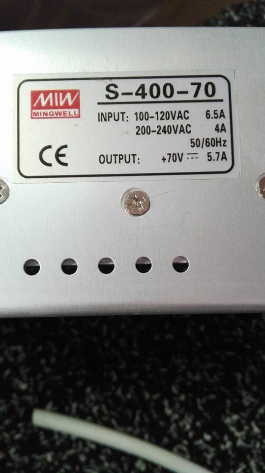

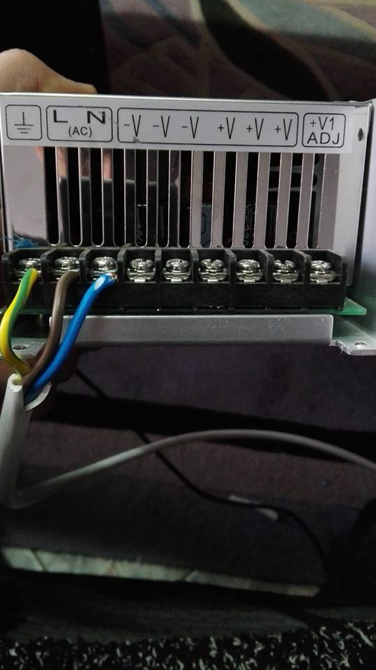

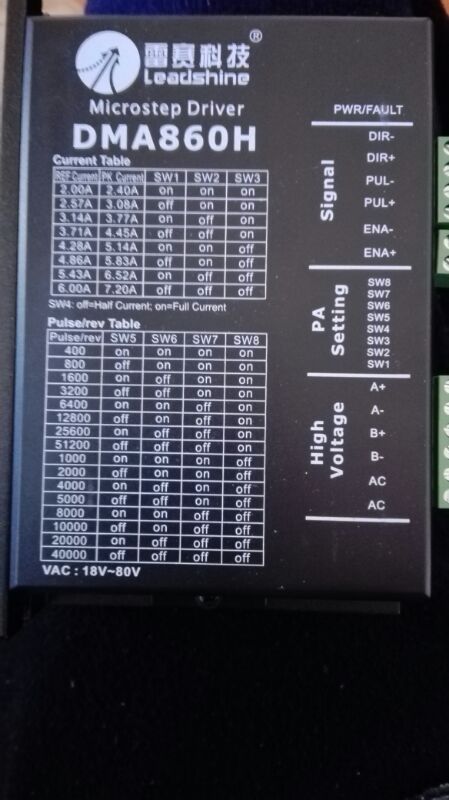

    Hi, i got my driver DMA60H which says it need High Voltage AC connection. My power supply PS-400-70 is a AC-DC transformer. Does it mean the driver can not work with this power supply.Click image for larger version.

    The way I see it is that drive shows 80v AC max and your power supply is DC so you will need just a transformer with an output of about 70V AC. Some drives will accept either AC or DC input.
    No Can't use that power supply because it's output is DC and those drives require AC input.
    Edit: Opp's Clive beat me too it.

    As u can see, its not marked which one is + and - on the driver, so if i try to connect it and mess the + output from power supply to - driver input, can i burn sth out ? :)
    Quote Originally Posted by masinecc View Post
    AC doesn't have + & -, well it does but they swap at 50hz ;-)
    AC doesn't have (+) or (-) that's why no markings. AC power supply doesn't (+) or (-) it has live and neutral so you shouldn't have those markings to mix up.!
    Because it's AC You won't damage the drives which ever way you put Live and Neutral on the drives.
    Look what i found :
    FeaturesExtremely cost-effectiveGood high speed performanceSupply voltage up to 80VAC or 80VDCOutput current up to 7.2ASelf-adjustment technologyPure-sinusoidal current control technologyPulse input frequency up to 300 KHzTTL compatible and optically isolated inputAutomatic idle-current reduction16 selectable resolutions in decimal and binary, up to 51,200 steps/revSuitable for 2-phase and 4-phase motorsSupport PUL/DIR and CW/CCW modesShort-voltage, over-voltage, over-current and short-cicuit protection
