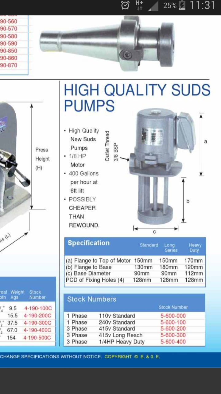

    I recently purchased and fitted one of the 1/8 ph coolant pumps off ebay to my triac, very pleased with it and the power.
    Chaz's Avatar
    Lives in Ickenham, West London, United Kingdom. Last Activity: 15 Hours Ago Has been a member for 5-6 years. Has a total post count of 1,095. Received thanks 77 times, giving thanks to others 51 times.
    Quote Originally Posted by andy_con View Post
    Link please? How does it compared to the standard Triac pump?
    Chaz's Avatar
    These?
    http://www.ebay.co.uk/sch/i.html?_fr...+pump&_sacat=0
    I found them on Rotagrip's site .... they have lots of nice stuff.
    Those are the ones, I can do you a vid over the weekend if you want.
    Can't remember what size but they do one thats a perfect fit length wise.
    As for power it's plenty of power for me, removes chips out the way nicely
