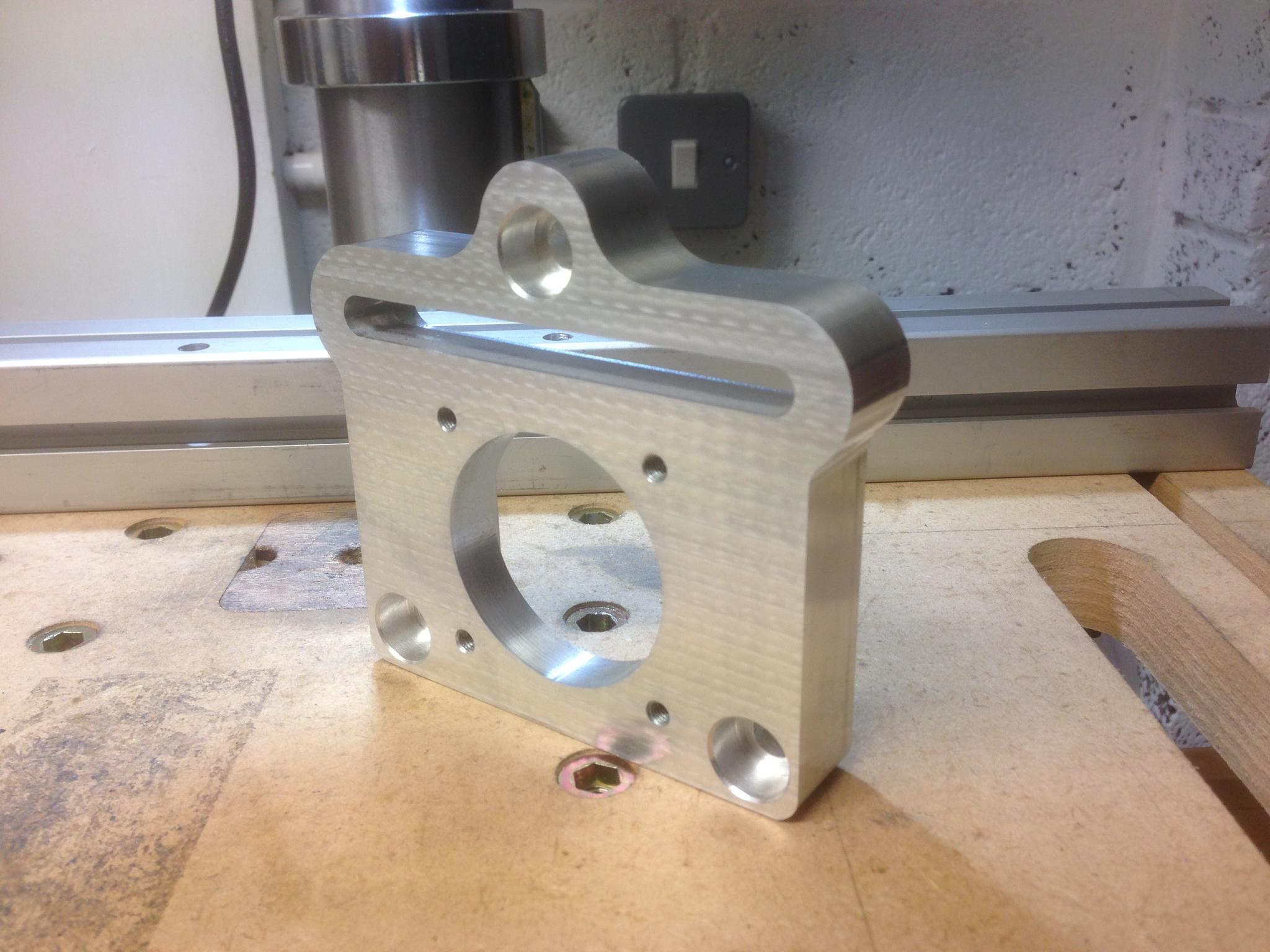

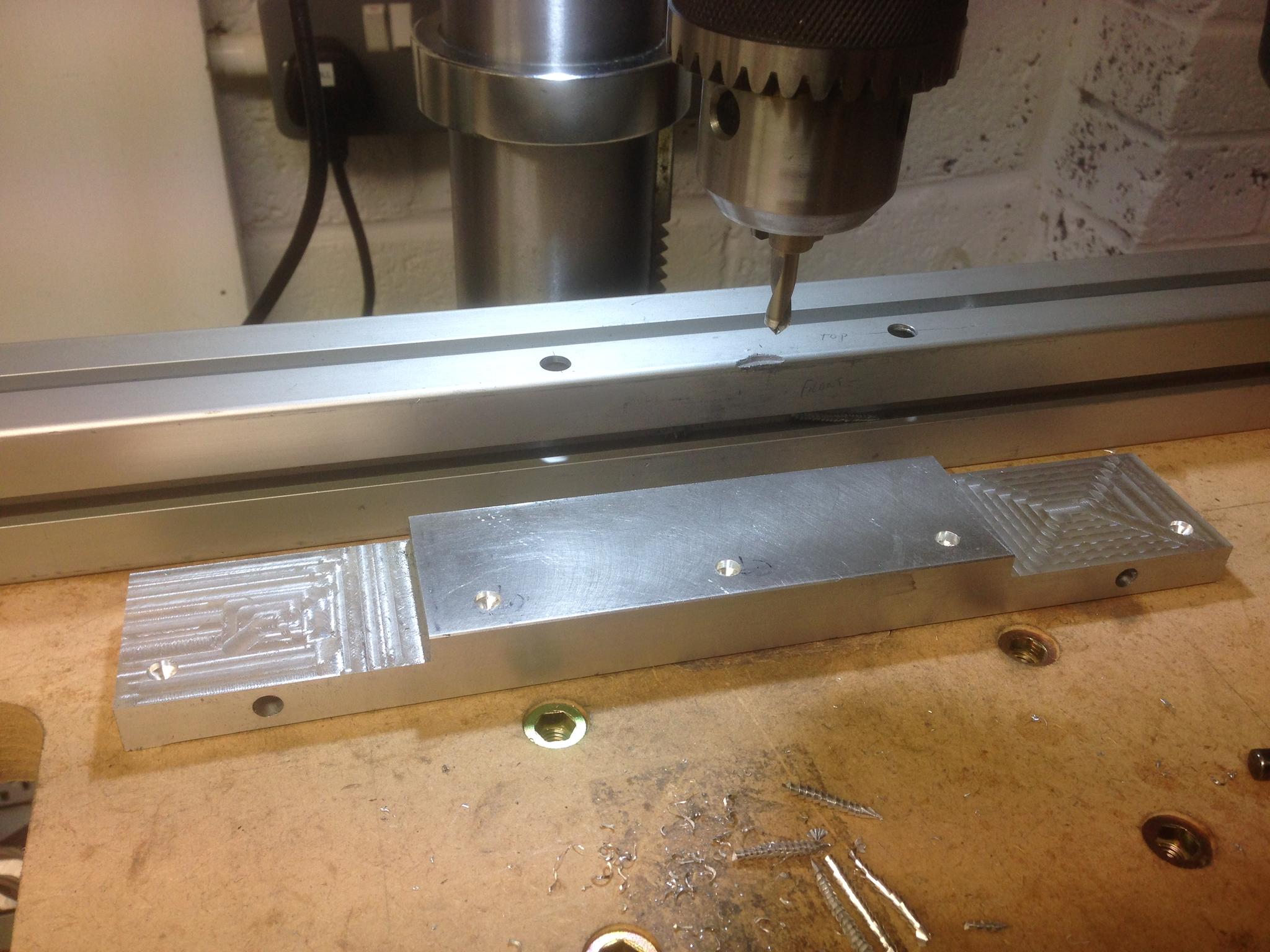

    Tiny bit of progress. X axis motor mount / belt tensioner plate finished.

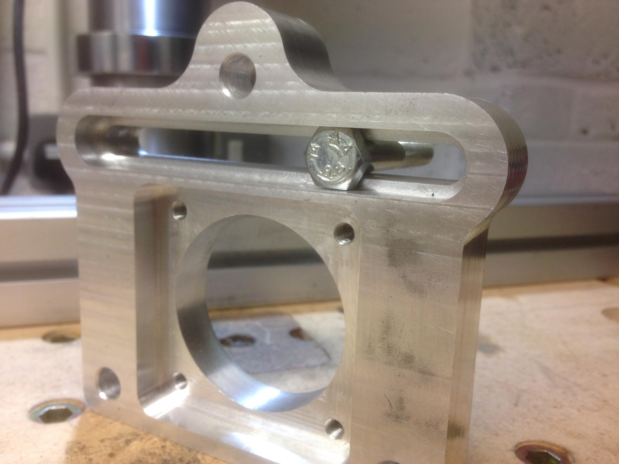

    Here is a trial fit of an M8 bolt head in the slot (final part will use an M8 nut):

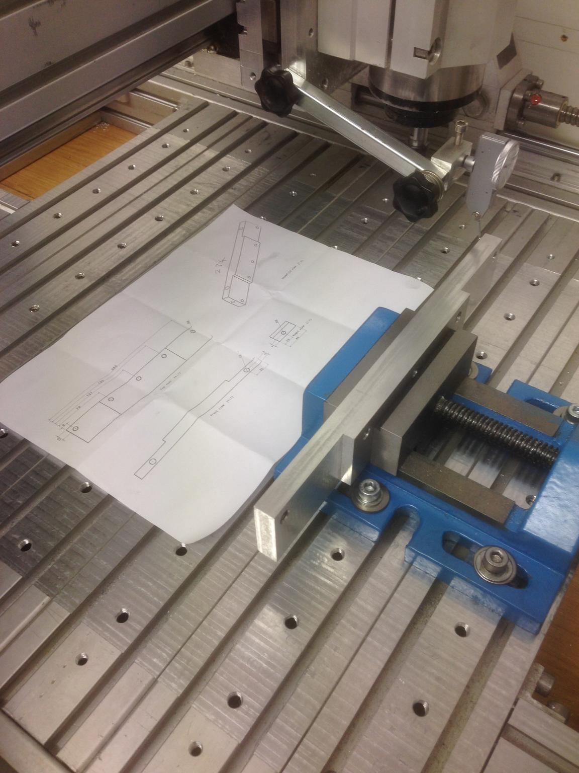

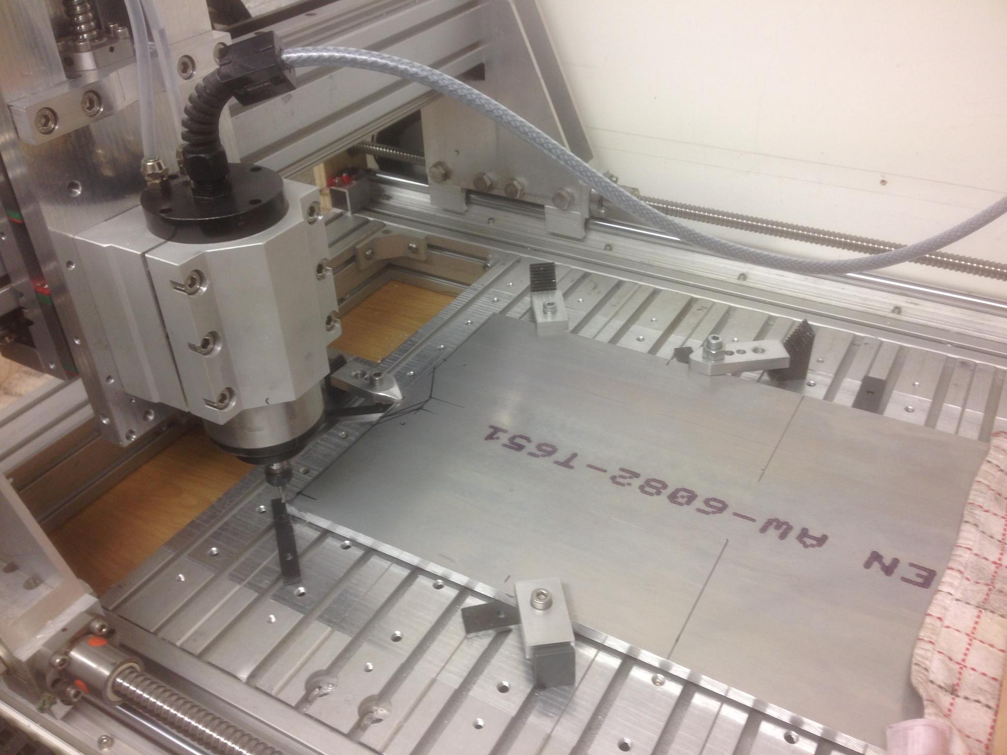

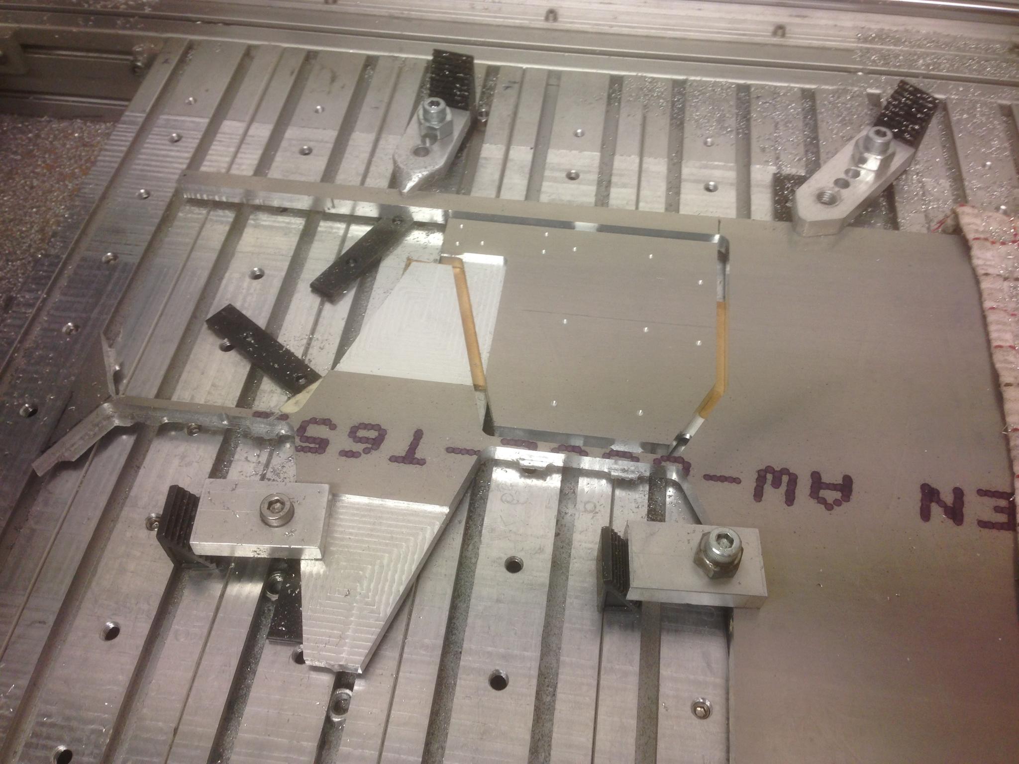

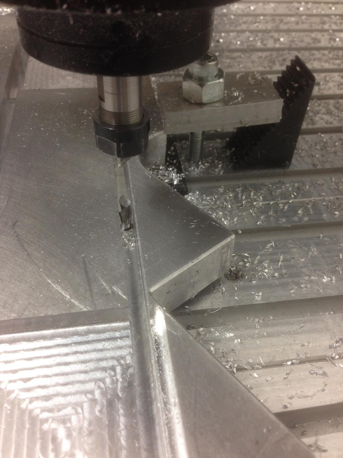

    Also started making one of the bits on the gantry. I snapped a cutter on final the 20mm pass ! Always the worst bit right at the bottom of a deep slot when the chips can't get out. It welded up and I didn't stop it in time.
    Luckily I had a spare so finished the cut. Setting up for the holes in the edges.

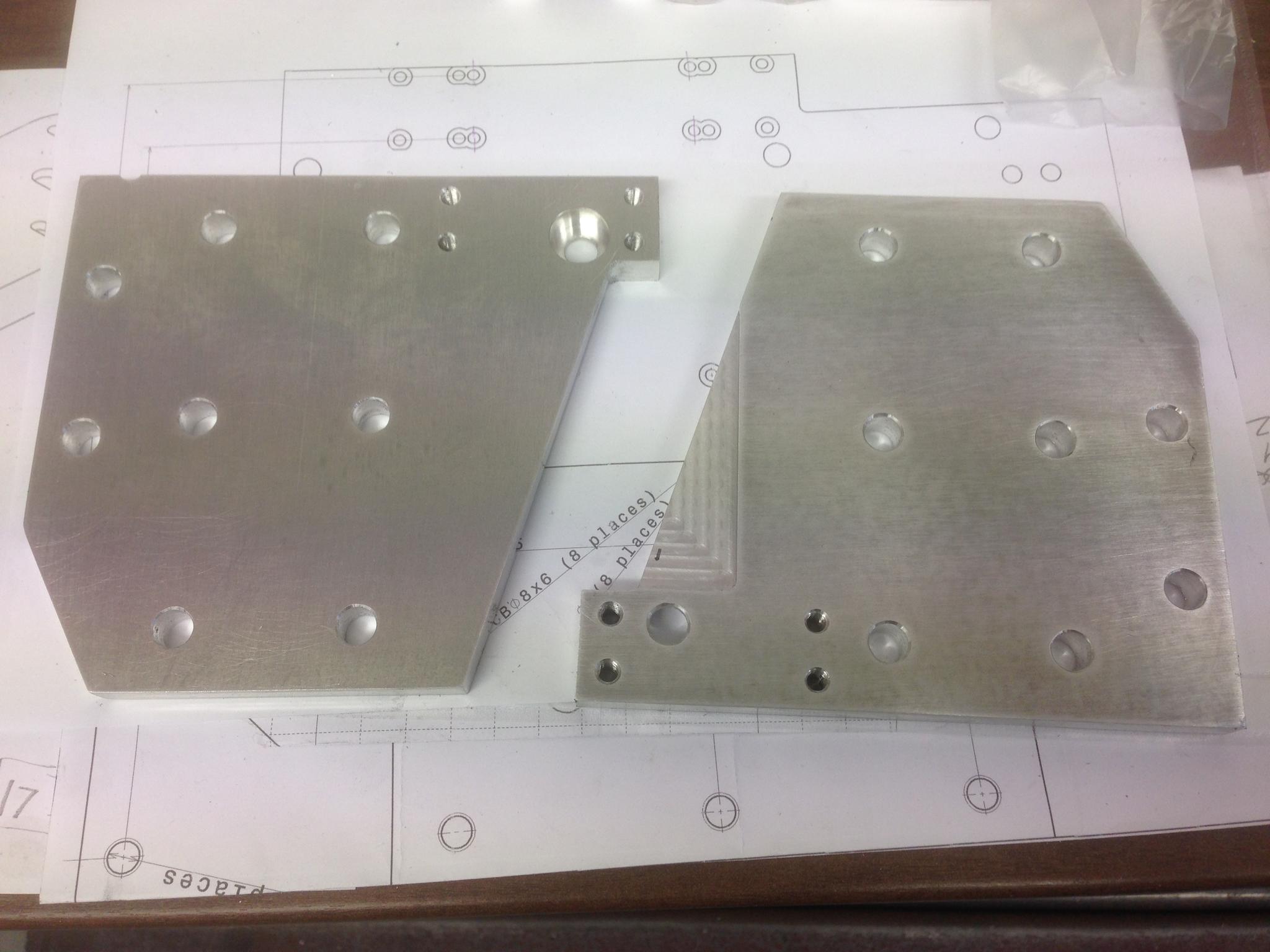

    It's been a while since I last posted and I'll explain why in a moment. I've made a matching pair to the last part, with a bit of finishing off to do:

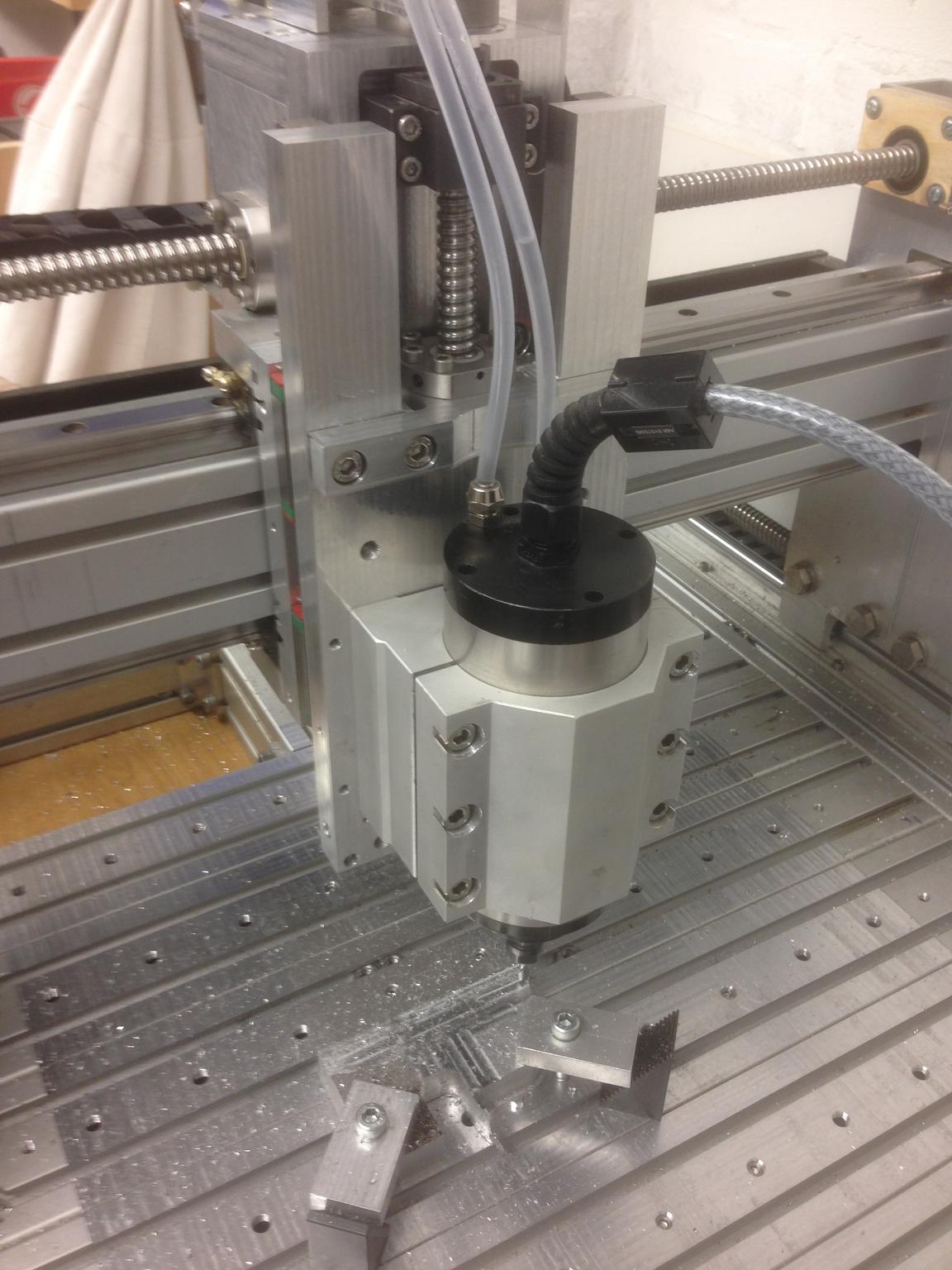

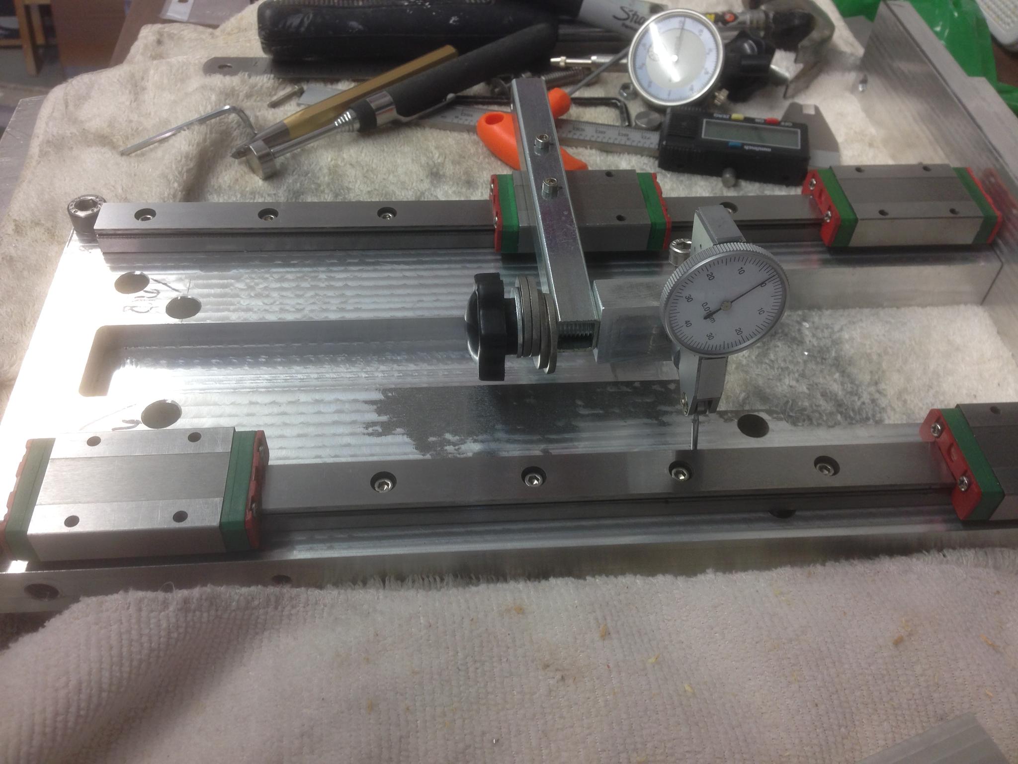

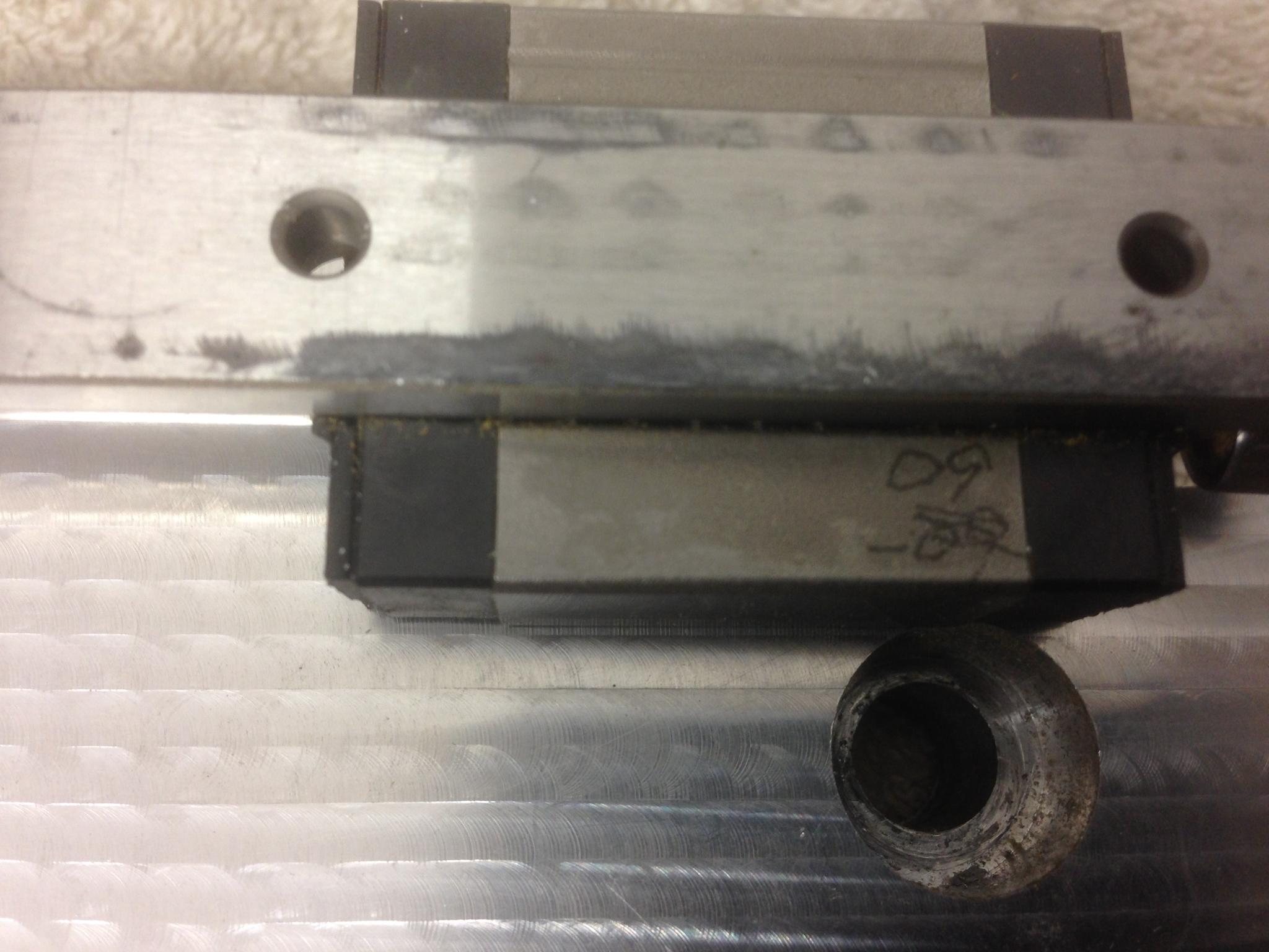

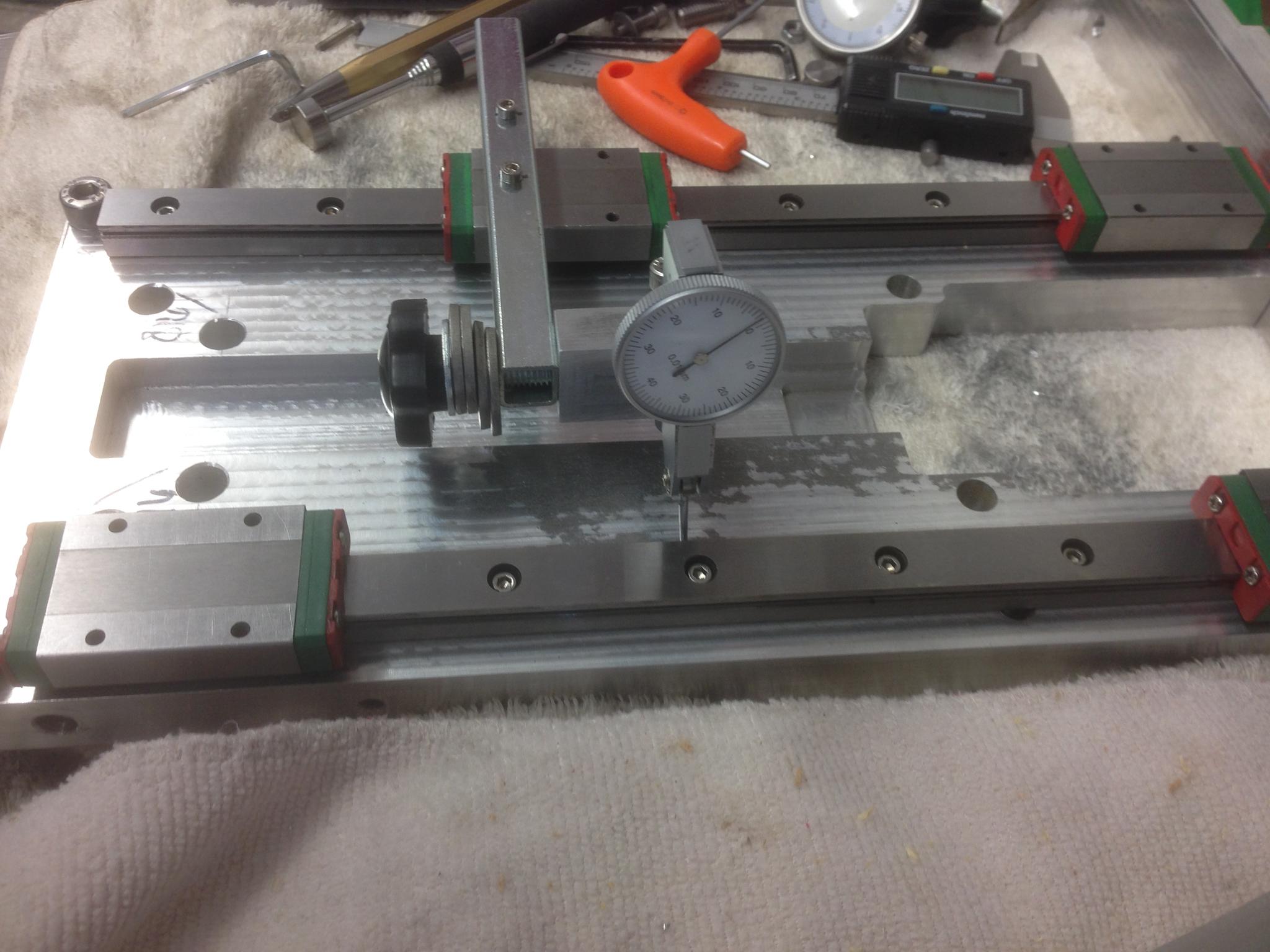

    Reason for the delay is that I've noticed for some time now that even mild cuts are often generating lots of chatter. I think it has been getting slowly worse, and feeling the Z axis around the rails and bearings there is some relative vibration between rail and bearing, especially at the top left bearing, when the chatter occurs.
    Problem is that the chatter can quickly lead to welding, and with so many parts to make for the new machine it was time to check things out. For info I have been running these 15mm linear profile rails (classed as 15mm minature) for about 5 years on 3 successive machines, and that they were bought as used from 'fa-systems'.
    I stripped the Z axis down and found significant fretting on the rail, especially around the top left bearing:

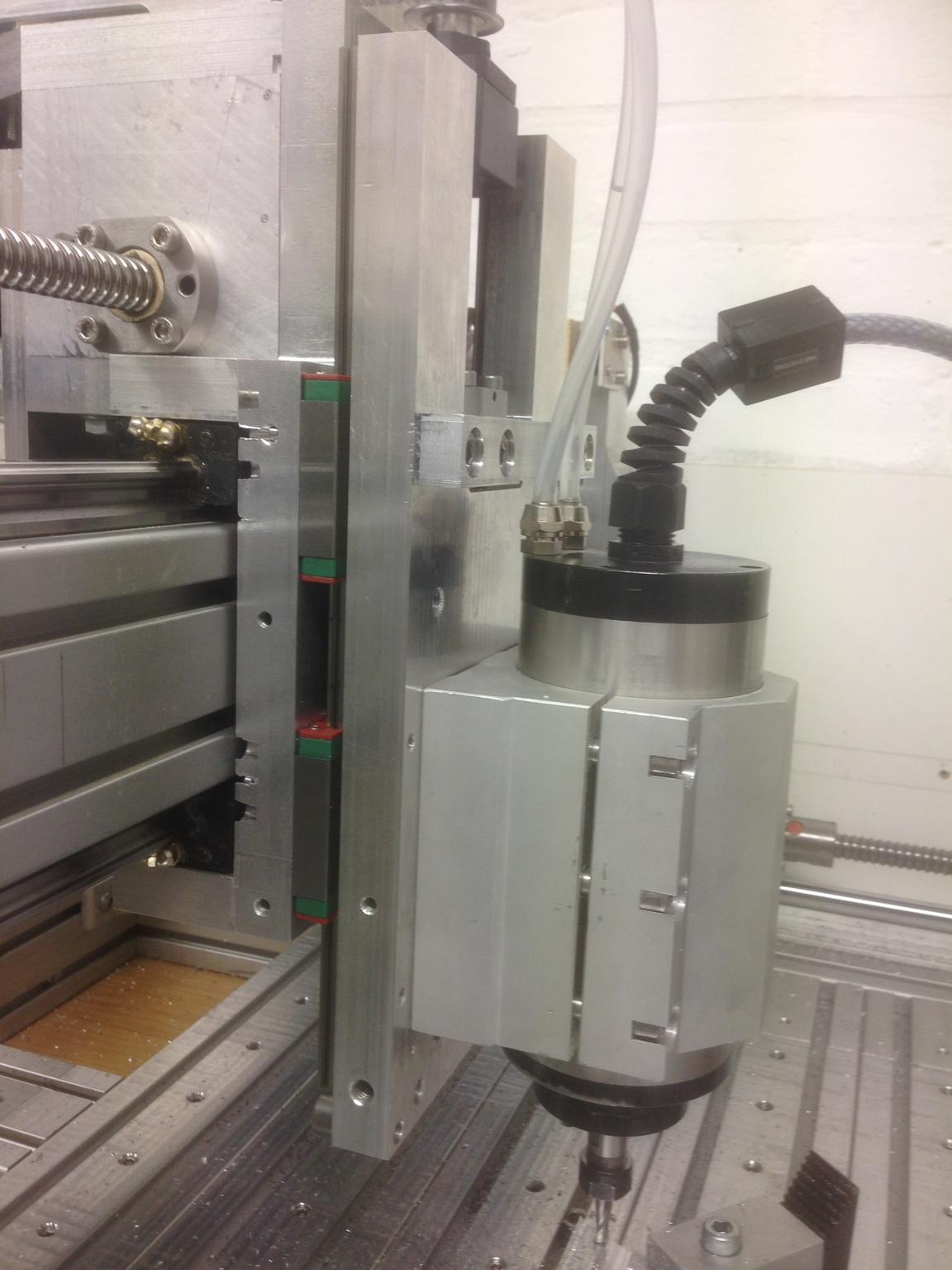

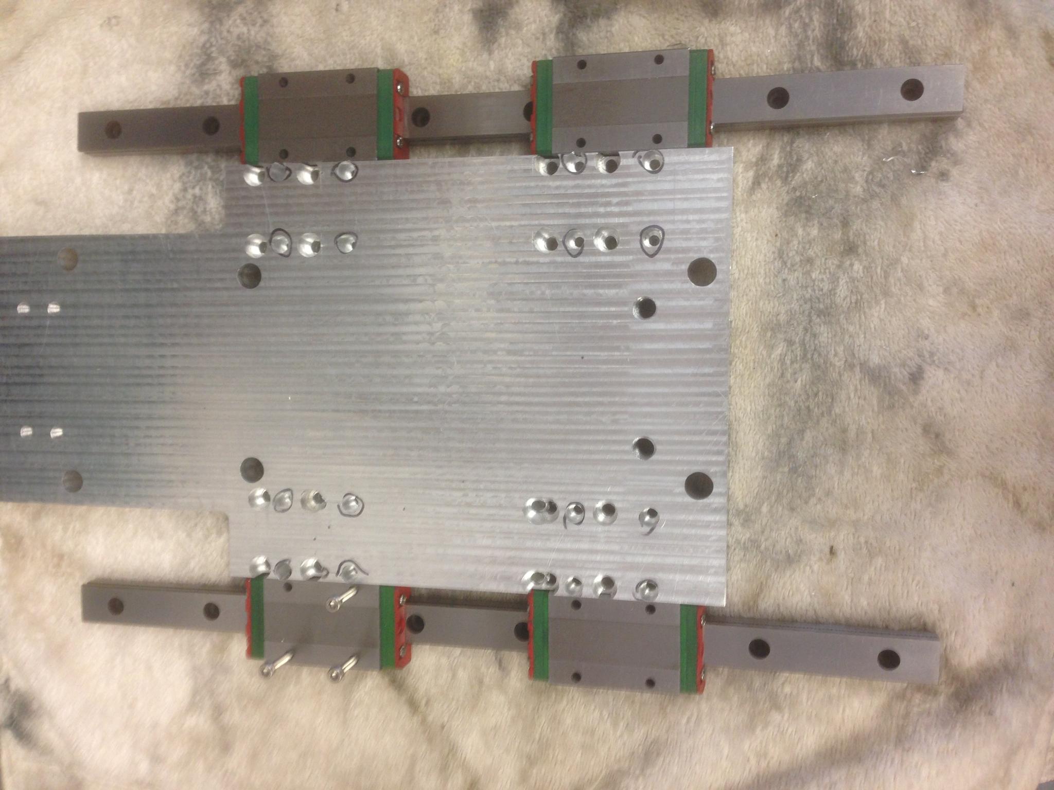

    Luckily I had a second set of 15mm rails (new) that I'd ordered for the Z axis on the new mk4 machine. However, the hole spacing was 5mm further apart on the bearing carriages. I ended up drilling another set of 4 holes rather than 2 extra holes because the holes would have been too close to the existing ones:

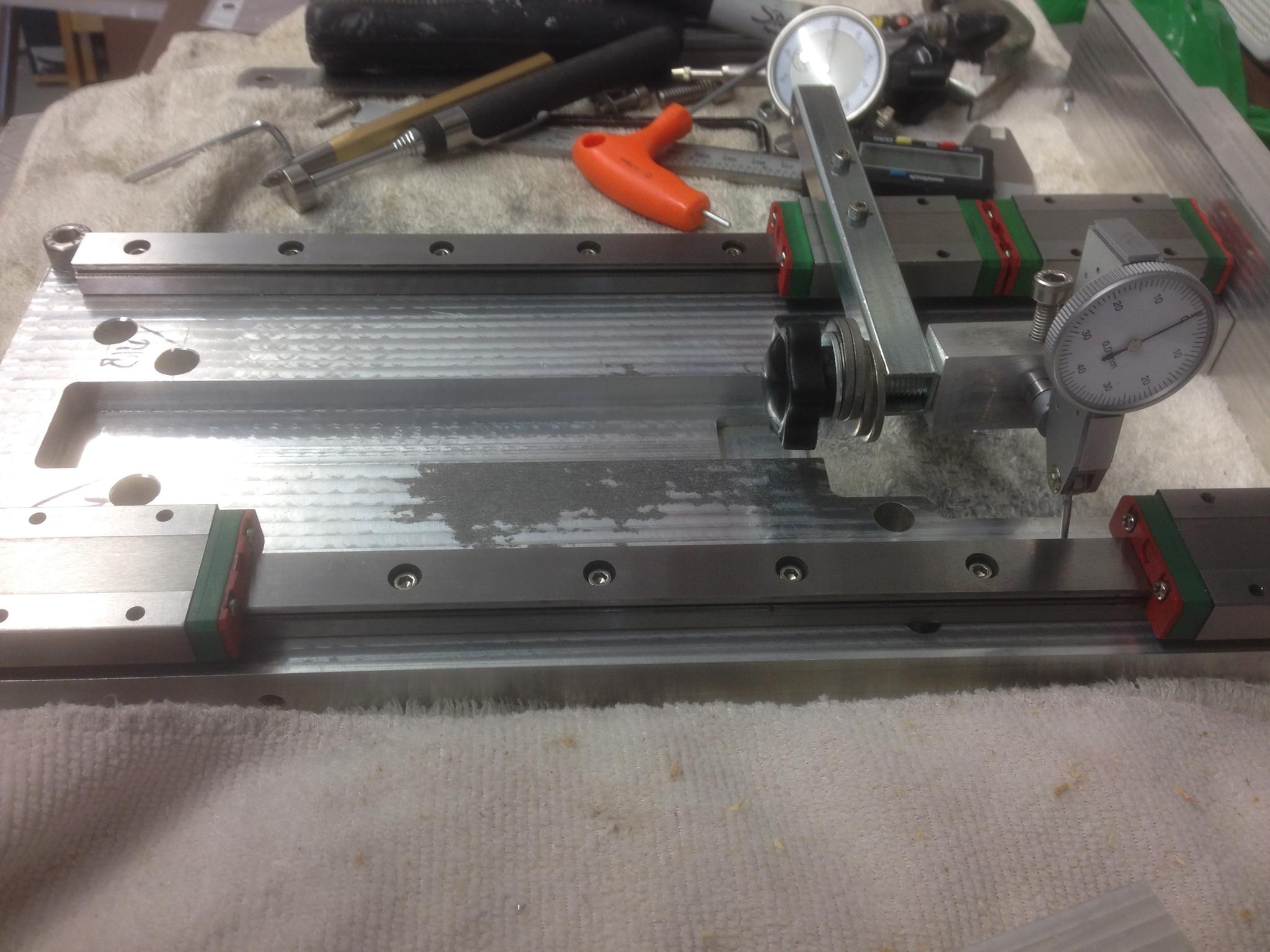

    I took the opportunity to drill some access holes in the outer plate so I could assemble the Z axis as a unit, and then bolt it on to the Y axis. It's easier to get everything lined up off the machine rather than trying to assemble it bit by bit on the machine:

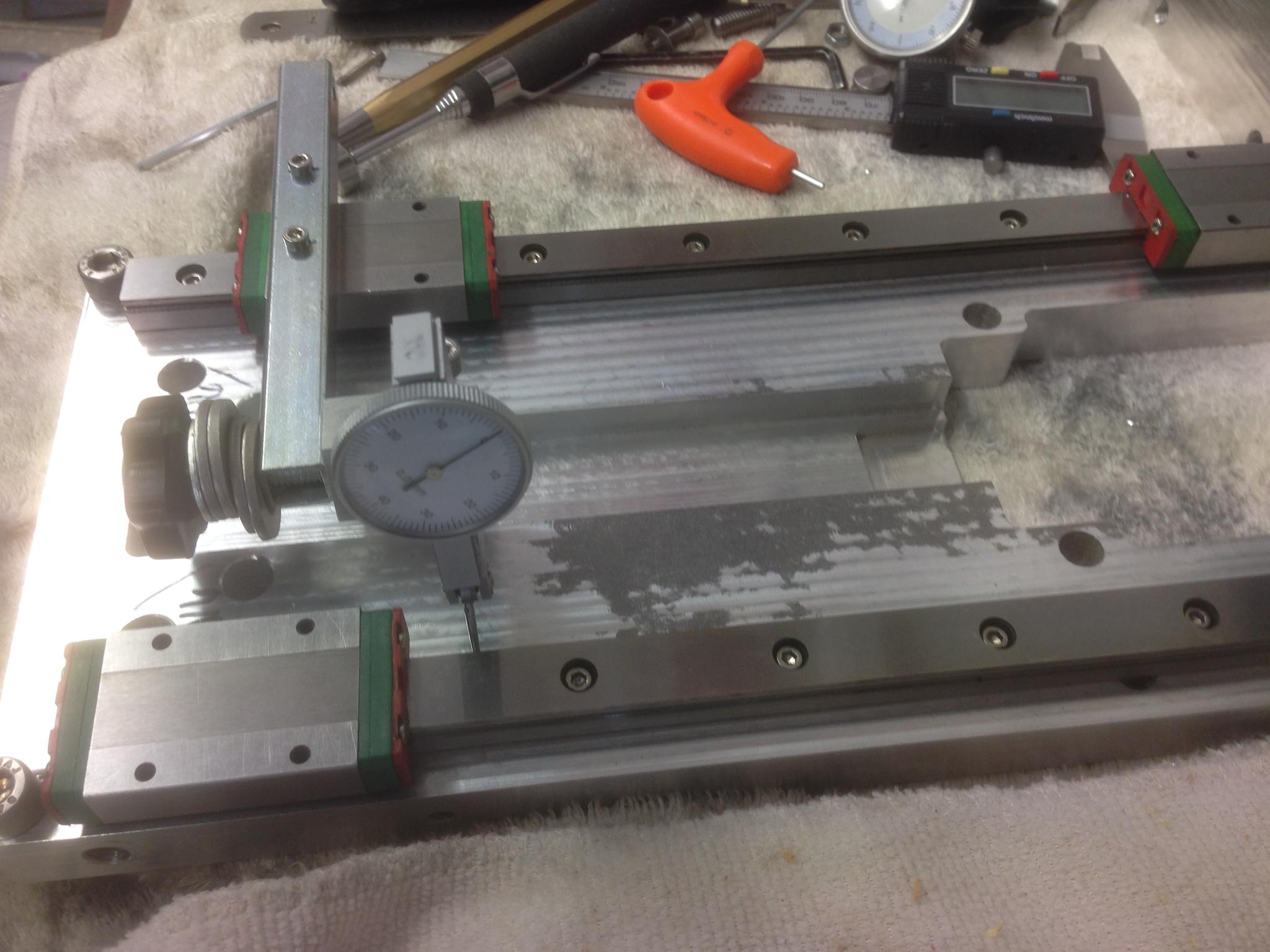

    I then set the first rail off a side datum, and then clocked in the other rail:
ID:	17919Click image for larger version.
ID:	17920Click image for larger version.
ID:	17921Click image for larger version.
    Then assembled the Z axis onto the machine:
    I trial cut revealed a much improved machine. A 1mm DOC at 900mm/min 12,000rpm 6mm 2f carbide was fine with no chatter.
    So is there a moral to this story? Well my rails were used when I bought them so it's had to be sure but for the occasional poster on here who asks about rail size then I will always recommend 20mm over 15mm.
    Back to the new machine. As originally drawn it had 4off 15mm rails around a box Z. Although these are used as 2 pairs loaded against each other I did not feel confident in continuing with 15mm rails all round. Luckily I had left space in the Y axis to upgrade rails or spindle size. So it was a simple matter to add pockets and fit in 20mm rails. I've ordered 20mm rails from Fred, and will use the new 15mm rails just as auxiliaries away from the spindle where the loads are lower.

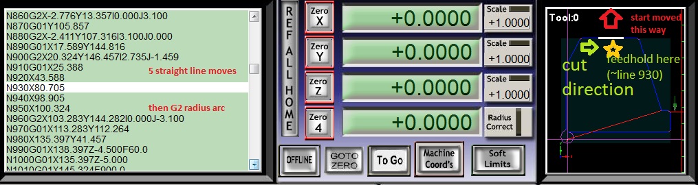

  9. #28
    OK, looking at the gcode where I had the 2 crashes (when 'starting' after a 'feedhold') and I can see there are several straight line moves (must be geometry nodes all along in a straight line from when I was creating and changing the CAD), followed by a G2 radius arc in both cases.
    #1
    I've read about problems with feedhold in arcs so always feedhold on a straight edge. But I was definitely on the straight bit about half way along the top edge when I pressed feedhold. About line 930. It was some way off getting to the G2 ARC at the corner. When I hit start the machine went up in +Y and snapped the tool clean off.
    I've loaded the file onto my house PC (hence the DROs are all zero!) Here is the first one:
    #2
    This time, on the same part, I was cutting along a straight edge at the bottom, -X direction, when I hit feedhold. It had just done line 1060. This time cycle start moved the machine in +Y. I hit e-stop straight away this time and recovered it. However, there was a gouge in the work piece (!). It's cosmetic but annoying none-the-less.
    Looking at the gcode shows another set of linear moves, followed by a G2 arc radius at the corner:

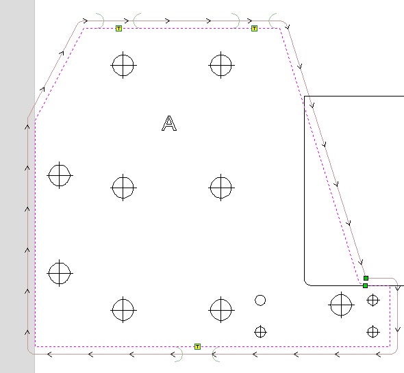

    I'll go back to the CAD and see if there are repeat nodes in the geometry as a start, but I'm confused by this as I've used feedhold for years and not had this problem. Now twice on the same part!
    I went to Mach3 website in case there was a later version - but it's still R3.0.43.066 I which is what I am running now.
    EDIT:
    OK, the reason for the repeat straight moves is that there are tabs on those sides. Vectric obviously adds those moves in on every pass, but only adds the Z up and over move when the required depth is met. However, I was nowhere near the depth to create the tabs (they are only 2mm high) so that might be a coincidence. So, still confused about what is going on . . .

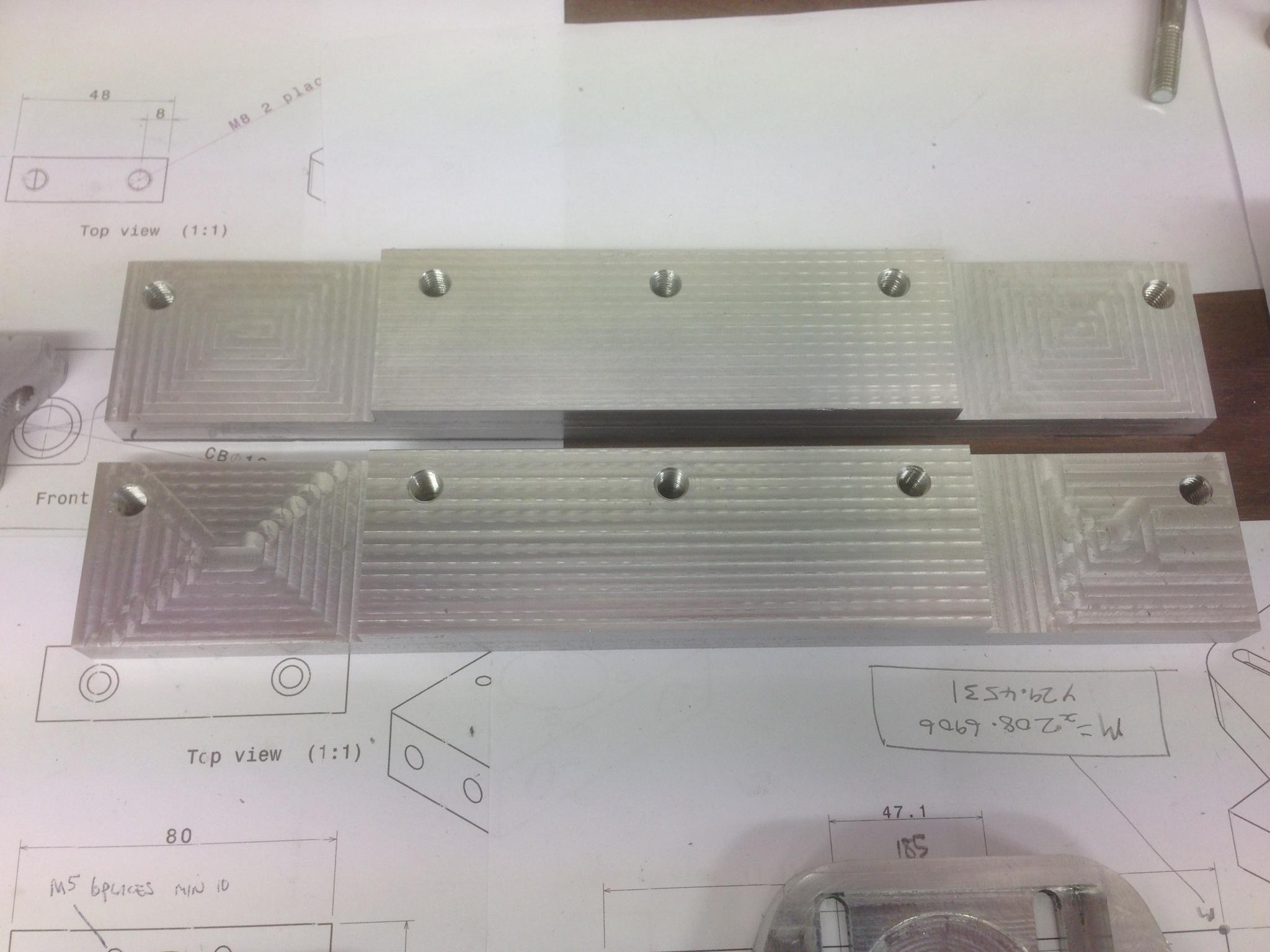

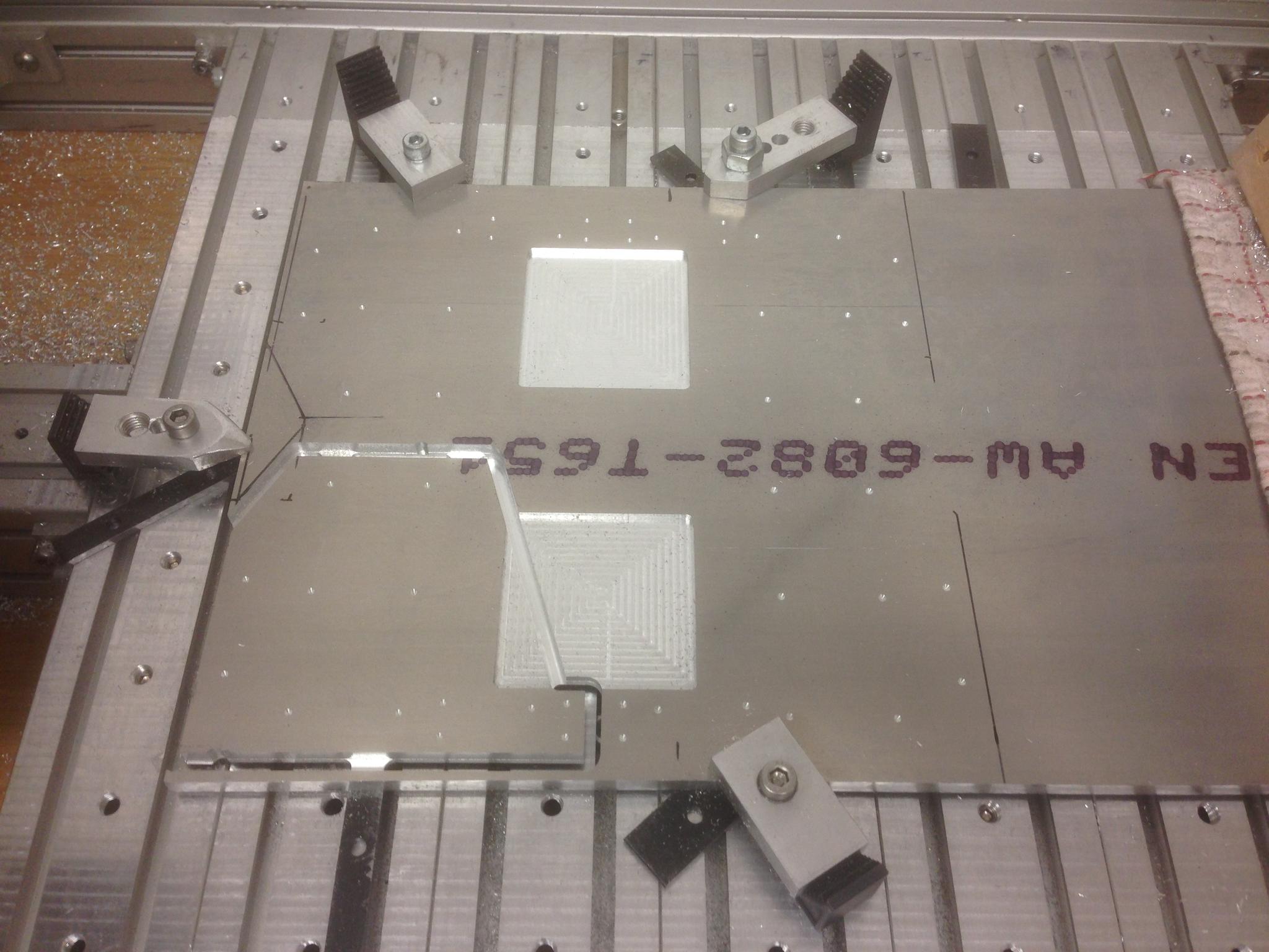

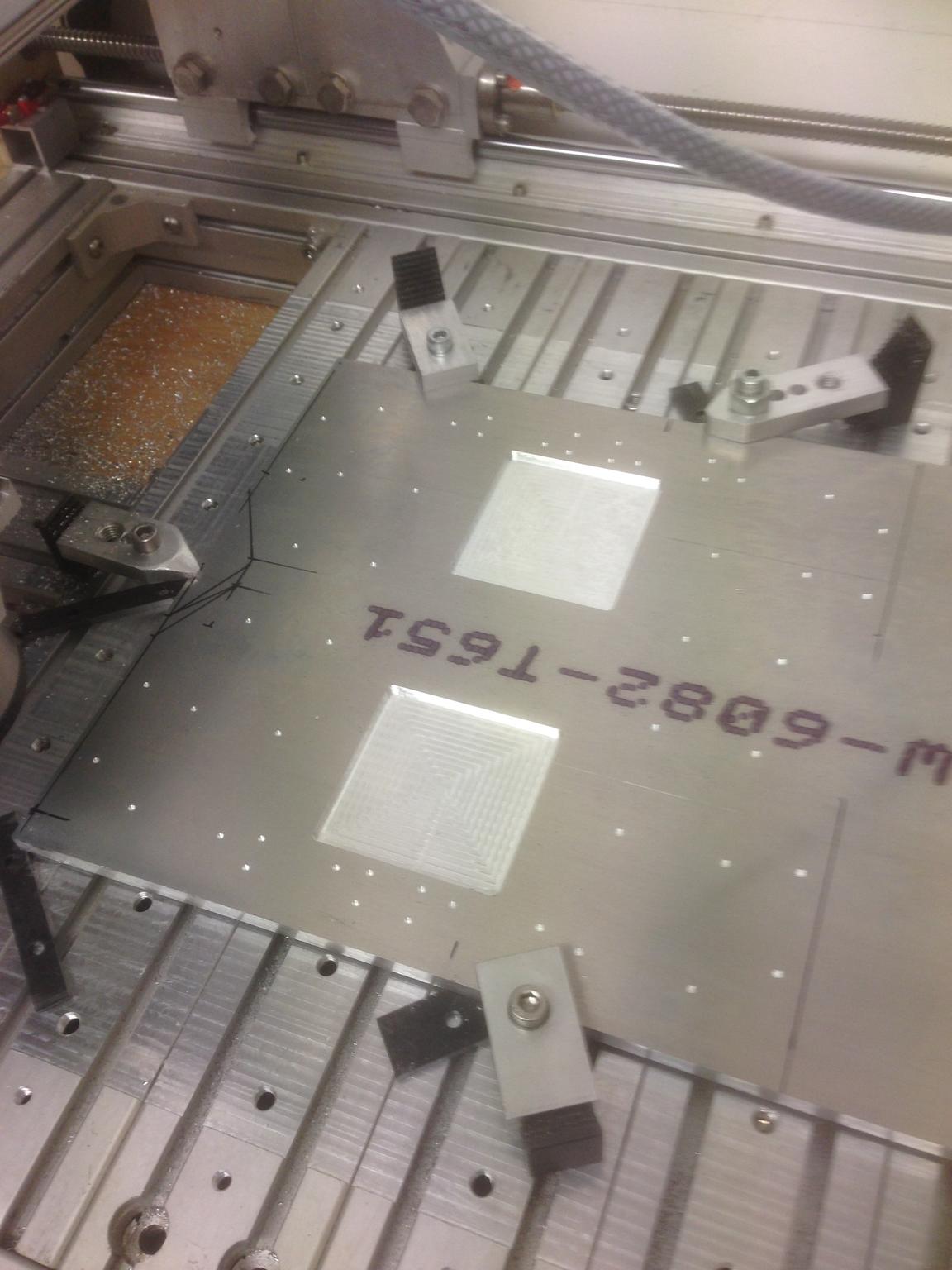

    Some pictures of the matching 2nd upper end part - cleaned, drilled tapped and finished:
    Then onto the next set of parts. Bed cleaned down and a new 10mm plate ready to cut out 4off bracket plates:

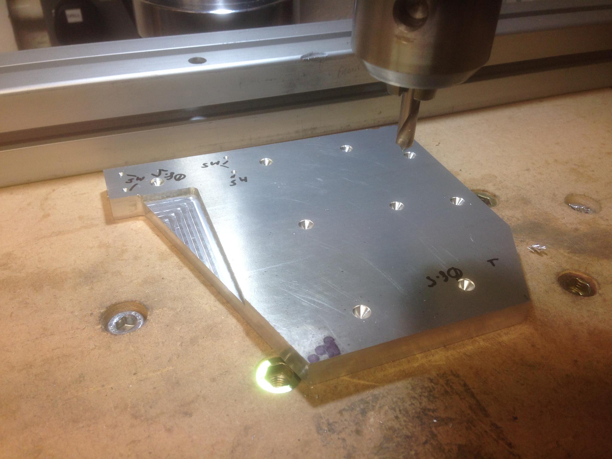

    Small pockets cut and holes spotted in all 4 parts:
    First one cut out:
    Last one cut out:
    Opening up the light cnc spots with the same 6mm spot drill:
    First pair of them cleaned up, drilled out, counterbored:

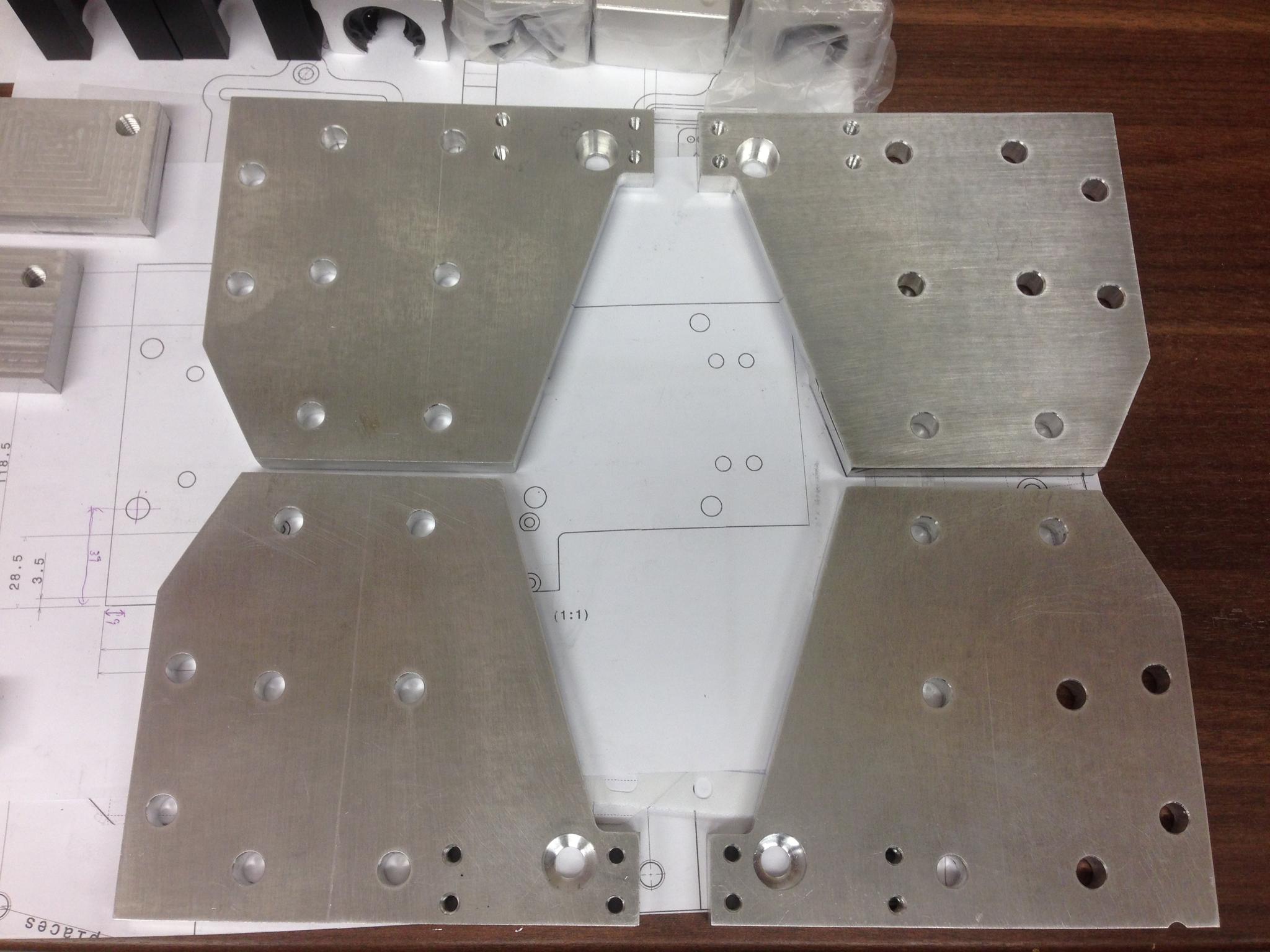

    The counterbore in each part was a bit nerve racking as it is to take an M8 cap head slightly under flush. This means a depth of 8.1mm in a 10mm part, which leaves just 1.9mm left. Although I had my DRO set on the drill press you still drill them blind and need to trust in the gauge not to go all the way through! I guess I could have used the depth stop nuts as a backup.
    Second pair straight off the machine ready for drilling:

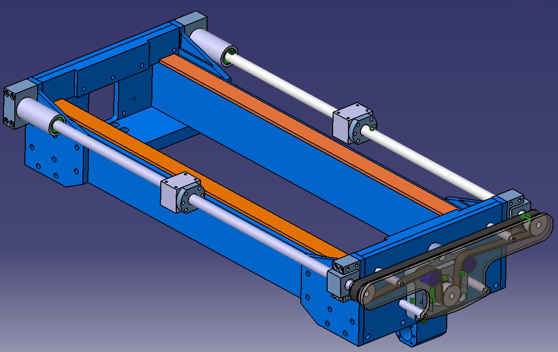

    These are the corner pieces on the gantry-

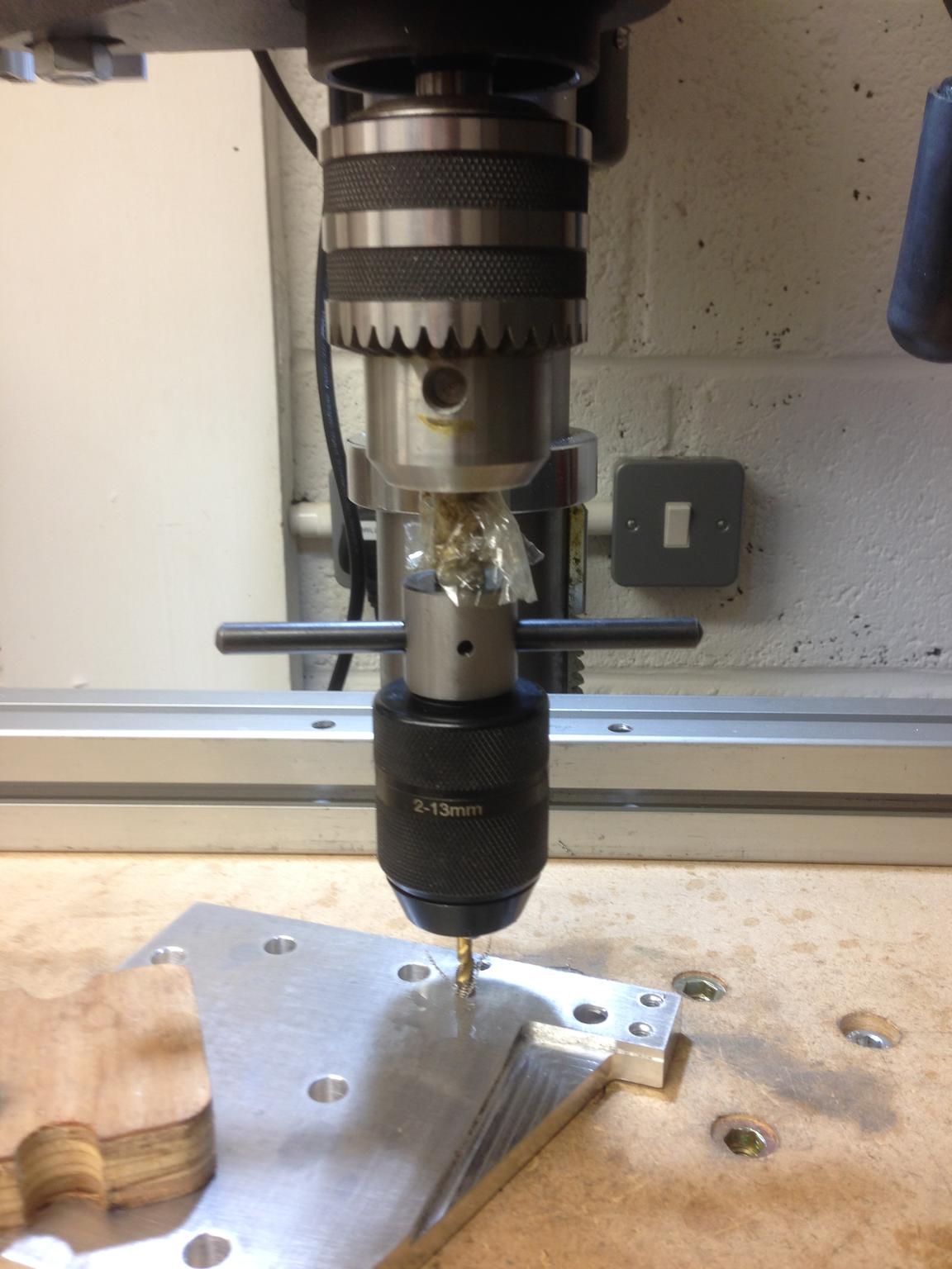

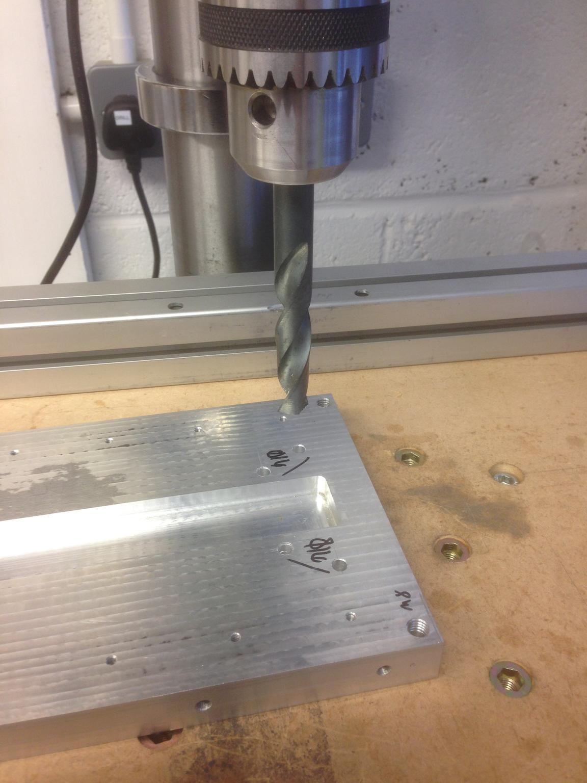

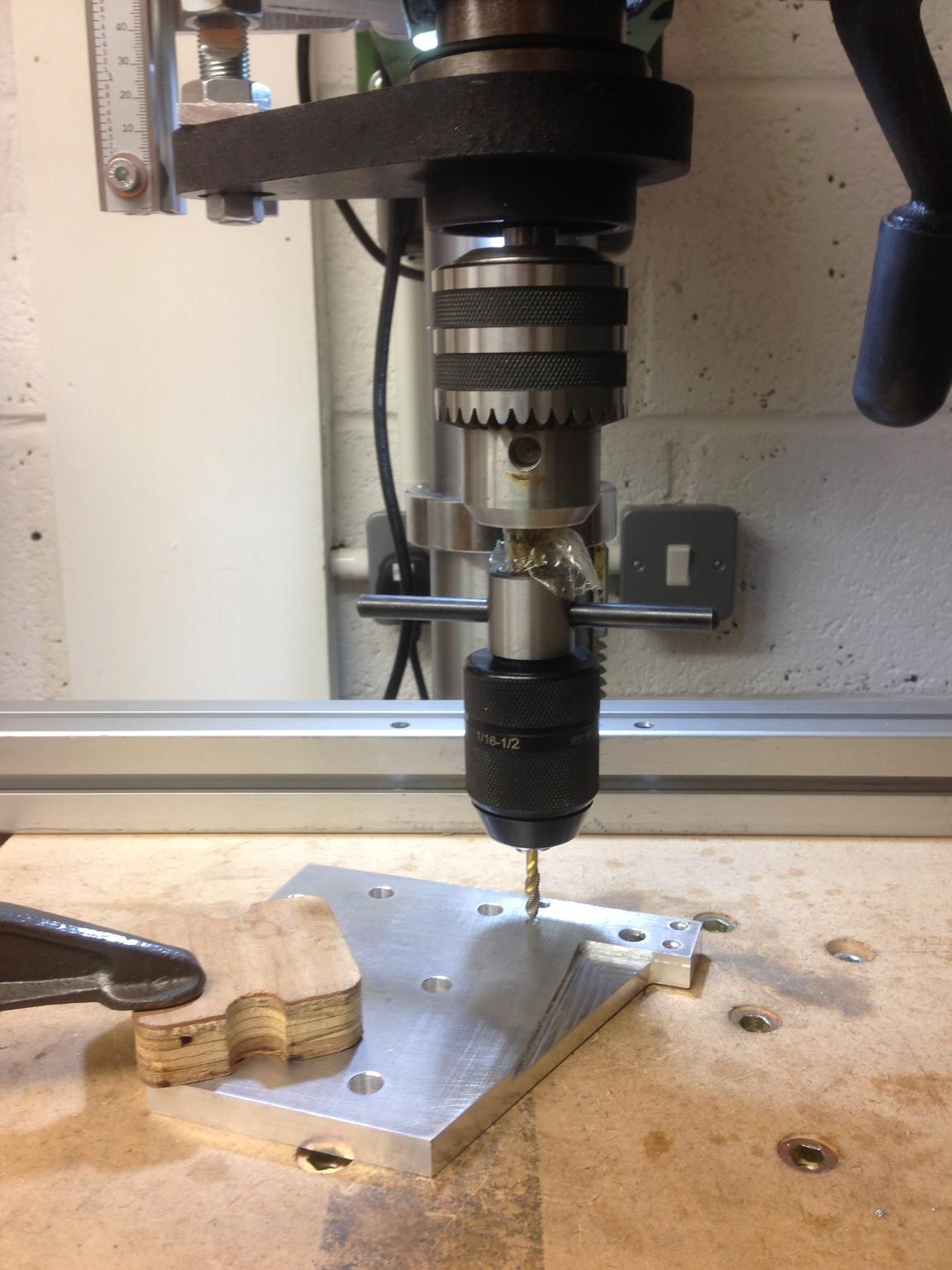

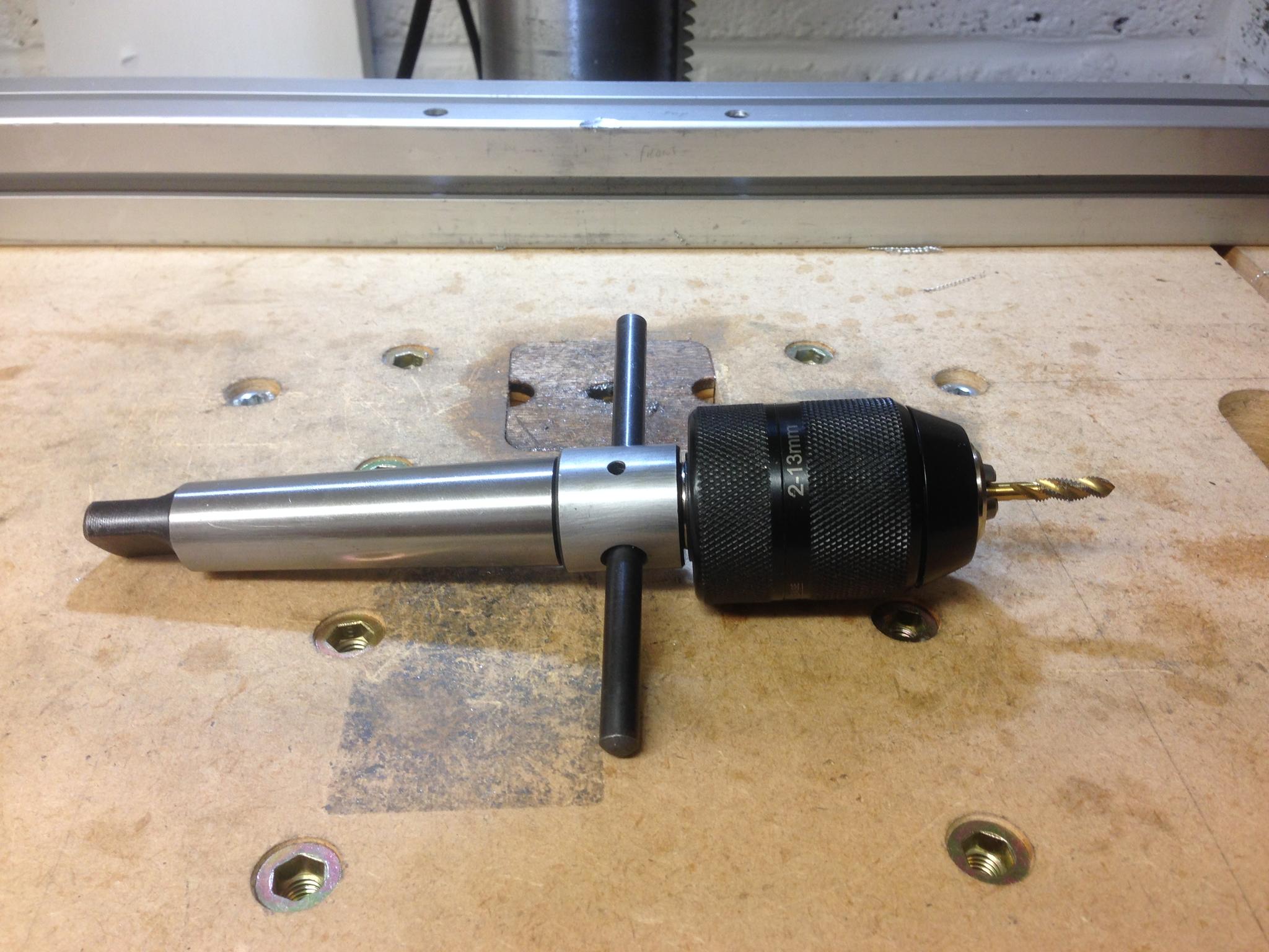

    Not that exciting so I thought I'd also post another way I just tried out of tapping the threads in those parts (well starting them at least) which is much quicker. I started with one of these tapping chucks from RDG tools - designed to either replace the drill press chuck or for use in the tailstock of a lathe. It has a tommy bar and the chuck is free to rotate and slide inside the morse taper housing:

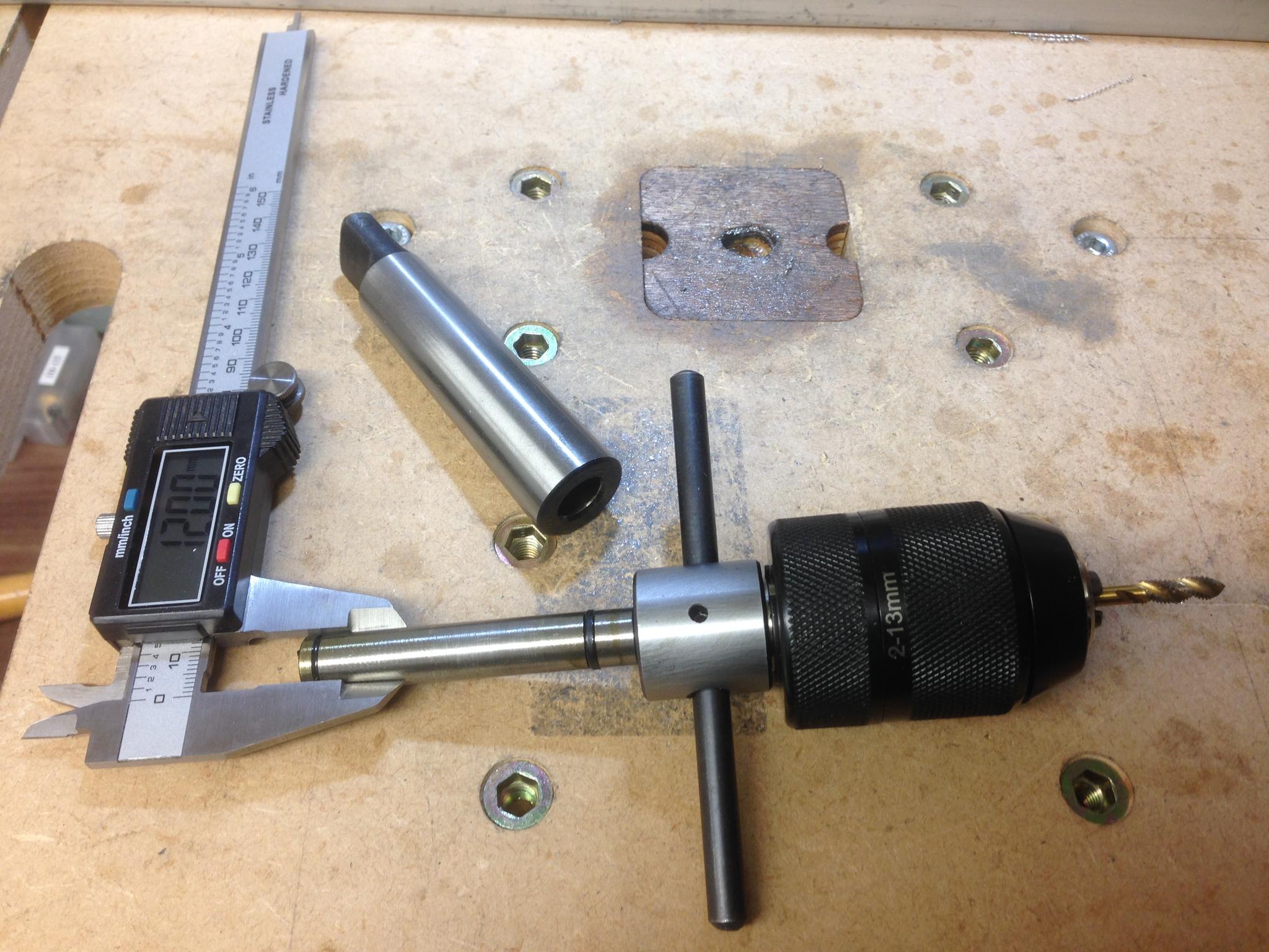

    Link below (they are also on e-bay)
    http://www.rdgtools.co.uk/acatalog/2...ent-88025.html
    Although you are supposed to tap out the existing chuck and replace it with this one I didn't want to keep swapping them over. I'd looked these over at a show so knew that the MT3 taper comes off the chuck leaving a 12mm straight rod - perfect :
    Because the 12mm rod was greased I put it inside a plastic bag (to stop the grease going onto the chuck jaws) and then put in lightly in the chuck - just enough to hold it but still allow it to rotate and slide up and down:
    Here it is well into tapping the M5 thread:
    This takes seconds to do and you can feel the bite / back off and reduce the risk of breaking the tap.
    Note that the drill press is NOT powered - I'm using the tommy bar to rotate it manually.
    This worked really well, was very quick, and created threads which were perpendicular to the face. I finished them off by putting the parts in a vice and using a cordless drill.
    I think the plastic will not last long, it started has started to tear already, so one option is to make a metal adapter tube which is clamped in the drill press chuck at the top, and contains a long bored out 12.05mm dia or so hole in the bottom to hold the greased rod on the end of the tapping chuck. If the bore is a good fit and there is grease in there it should stop the chuck falling out when you raise the drill press.
    To have something set up permanently I might even modify a cheap drill press/stand (the ones where you put a mains drill in) to house a long rod attached to the drill chuck - a bit like the Arc Euro ones but their's only goes to about 6mm or so tap size whereas this goes to 13mm.
