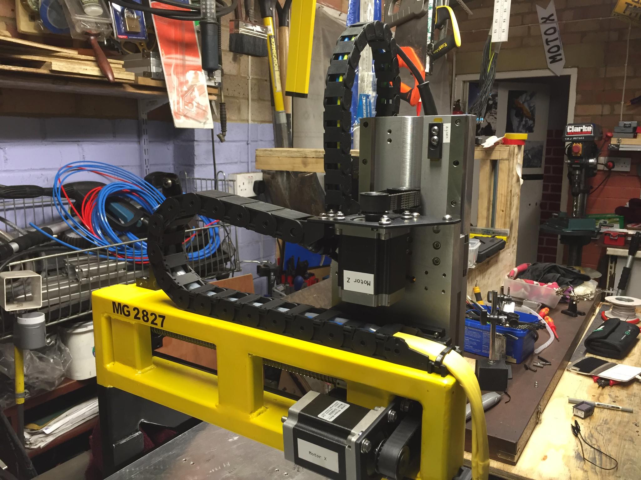

    Its quite hard to determine what actually happens, as there is no light either on switch or input light on module when trip occures.
    My sensor is close to the motor Z - even closer after upgrading them for bigger 8 cables one.
    [ATTACH=CONFIG]21360[/ATTACH

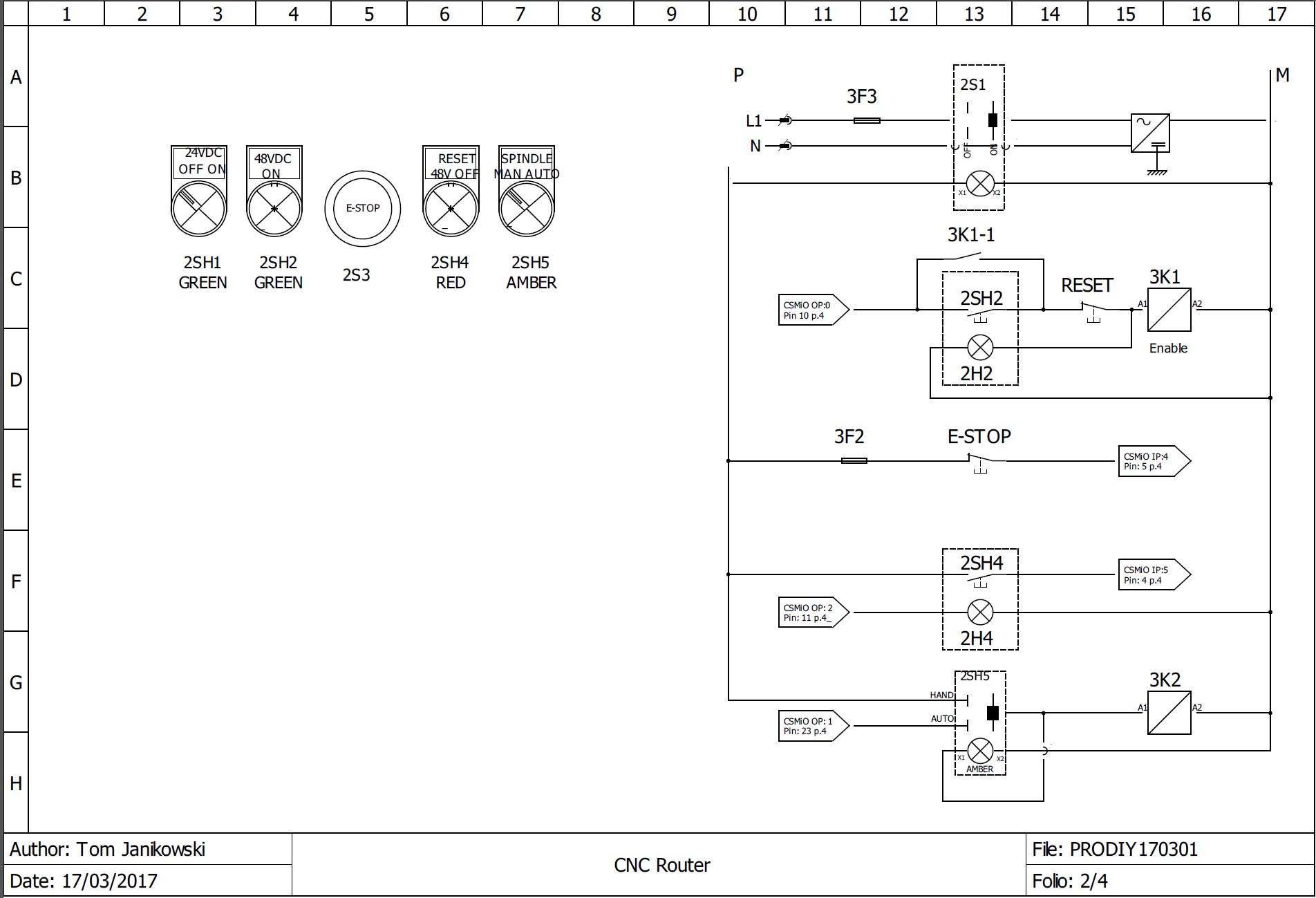

    Dean's feedback open my mind to one thing. I use HV enable with manual start push button, so after reset nothing happens till I press the button and send current the motors.

ID:	21362 - (drawing not complete yet)
    There must be poor screen on signals cable from switch - will moved input to different axis to see if this will send the same fault - think it will.
    I run all cables in one chain - no so much room left 30% maybe, it is last time when I us such a small control box - much harder to work with - small machine small box:)
