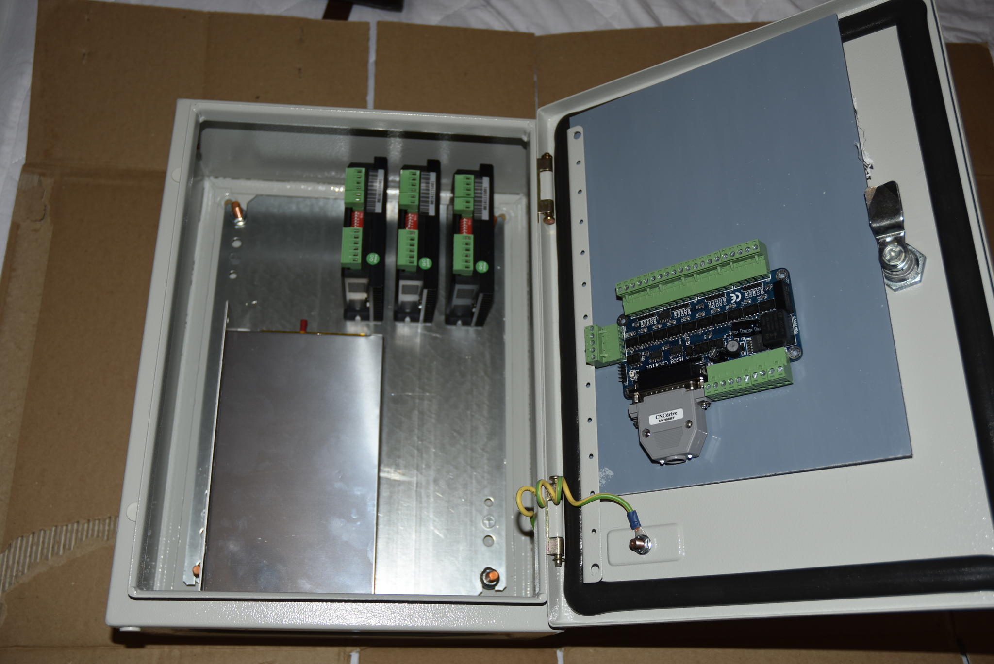

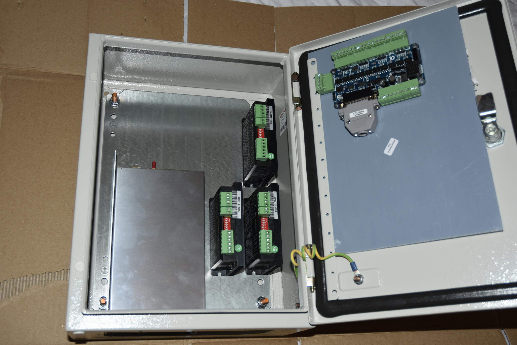

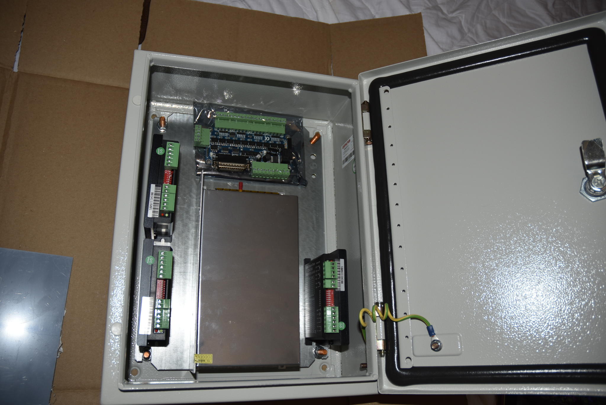

    Any advice would be greatly appreciated. I have just purchased a little cnc router for PCB work.
    I have been trying different layout options while I wait for cables and connectors to turn up
    There are three options that I can see and wondered if there are any issues with these, like electrical interference, heat concerns/ventilation or anything I may have missed.
    Options 1 and 3 involved mounting the BOB onto acrylic and attaching this to the door panel.
    The external case dimensions are 400mm x 300mm x 150mm but the removable steal base panel is 350 x 250 which is what I want to keep all the electrics on for ease of removal. All the connetors wil be mounted on the access panel on the side
    Option 1 - and preferred option for me

    Option 2

    Option 3

    My preference would be to have all parts in the case and not mounted to the door - Is there enough room to mount the powers supply on its side? Might give more room/options?

    Hi Jim,
    Thanks for the quick reply.
    I did look at mounting the power supply veritally but the lock on the door hits the top of the PSU on one side and on the other there is a bar which sticks proud of the door panel visible in the second picture next to the gounding wire, which also hits the top of the PSU meaning I have to move the PSU more to the centre of the case.
    Besides, being lazy I wanted it flat so I can easily access the screw terinals
    Dave

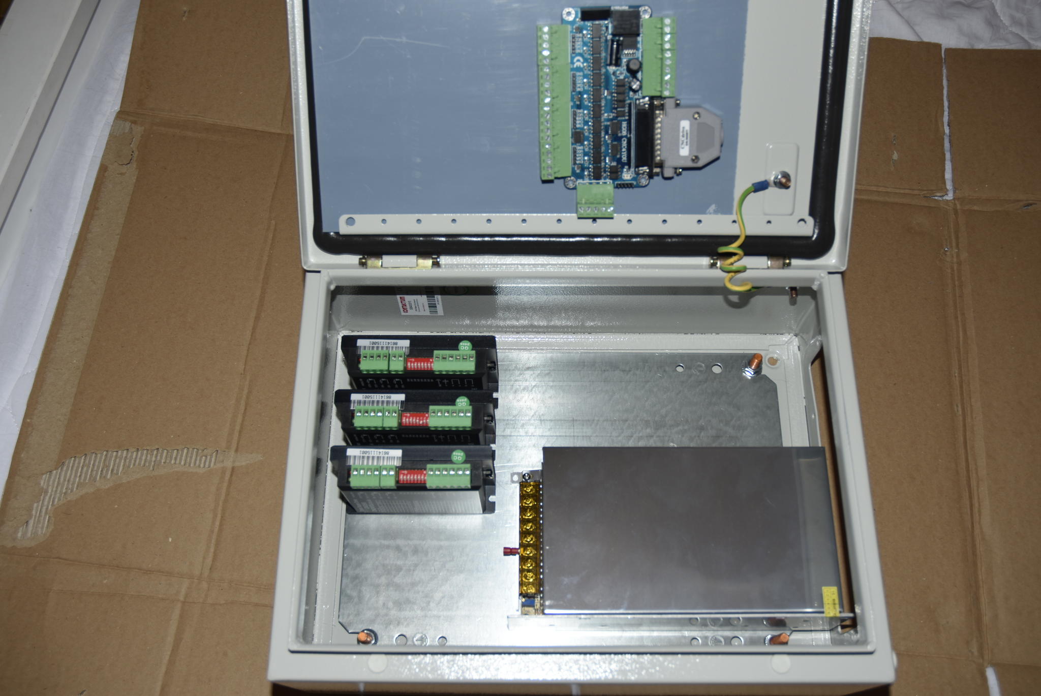

    Thanks Jim,
    I just remeasured and the lip on the door clears the PSU by 1mm.
    Looks like your suggestion is the better one and it does give me a lot more space. I origanlly wanted to keep the PSU flat for ease of access to the screw terminal but I can live with it this way, how many times should I need to access these anyway, famous last words.

    Hi Dave, looks good. I'm sure the extra space will soon get eaten up with wiring and other goodies like clive mentioned.
    I would maybe swap the drives and the bob though and to try and keep the "clean" signal cables away from the "dirty" mains/drive power cables as much as possible?
    I think most people would consider safety relays a step too far for smaller machines. They have features monitoring to detect if the contacts have welded shut but many don't worry about it. Really depend on your personal view of safety :)

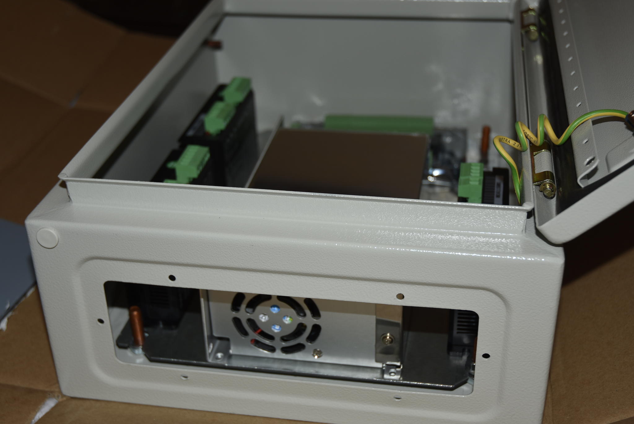

    The parts, they produce most heat should be top. On the bottom side your box is open, you should close it with a dustfilter, similiar to the parts used in aquariums. And the heat must can flow out of the box, so you need another hole on the top or upper side of your box.
