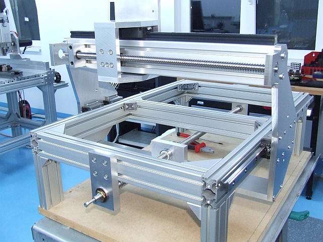

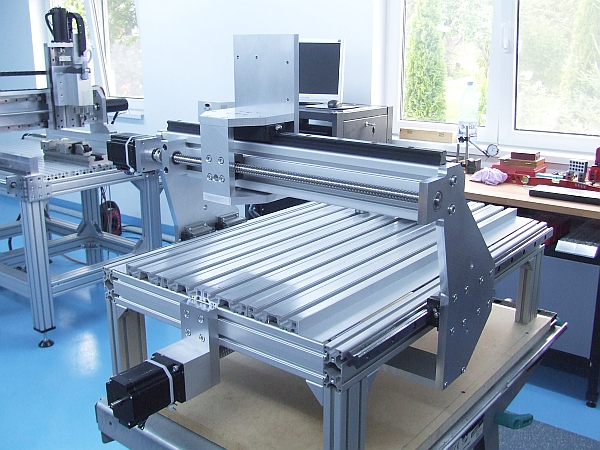

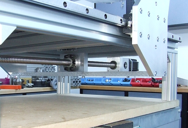

    My aim is to build a machine with this working area: x1500 y1000 and z20 or 30. Not really sure about the Z. As I am now in a early designing stage all the advices are really apreciated. Main frame is going to be from 80/40 and 40/40 aluminium profiles. It will be used for wood cutting, plastic, mdf sheets and similar materials. Thinking about chinese 1605 ballscrews which I see are quite widely used, rails and blocks will be 15mm hiwin. Spindle is going to be water cooled 1.5kW or 2.2kW . Steppers nema 23.
    My big question for now is from which width should be used two ballscrews on the longest axis instead of one ballscrew in the middle? I am worried about it can start to wiggle a bit, which off course will affect accuracy. All the sizes of ballscrews, rails steppers and spindle are still considered, it is not my final decision. I found on internet a cnc with the same structure as I am thinking to build, so now you have rough vision what I am speaking about :) Thank you very much!!

    for the size of machine you're looking to build then twin ballscrews are a must, at 1000mm wide cutting (at least 1300mm wide gantry) you'll get racking when cutting off centre with just one central ballscrew. For a 1500mm cutting area you'll need to look at the size of ballscrew you need to use as at this length you're right on the edge of ballscrew whip when cutting fast with 1610 ballscrews (what most people use as they give you the speed you need for plastics and wood) so will probably need to go up to 2010 (20mm diameter) ballscrews which will most probably need Nema34 steppers to overcome the inertia of the ballscrew.
    Have a look through the build logs in this section of the forum and inwardly digest all the information that's there, knock up a design and we'll all comment on it and help you

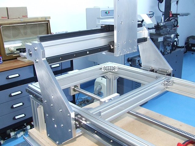

    Something to point out is that in post #1 the last picture (5-8.jpg) shows a better machine in the top corner with double ballscrew drive. This will cut wood and plastic well, but you can go a step further than this and remove the gantry sides (weak point) and raise the X axis rails up to meet the gantry cross beam. Use a series of legs to support the raised X axis connected back down to the bed and for not much extra effort you will have a much better machine.

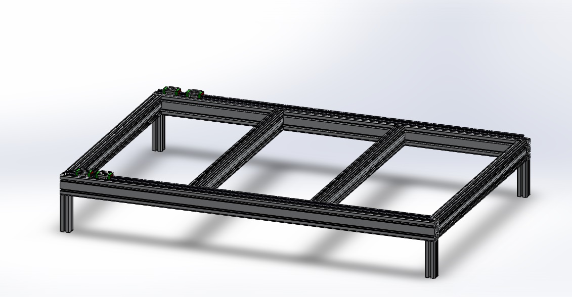

    Here is the picture how it looks at the moment.
Name:	Base frame.jpg
    All the corners i am going to join with 90 degree L shape brackets. Do i Need the legs? If yes, then probably it would be nice idea to have a pair of legs in the middle yes?

    Hi, sorry didn't see this thread pop up again! You'll definitely need legs in the middle and you'll need cross bracing. Depending on what your bed is going to be made of you'll probably need more cross bed supports...

    The machine design you are thinking to build is very similair to routers I build. I can tell you without doubt that you will need stronger than 80x45 to give the cutting area want at this length. 120 x 80 is what i'd use or at minimum 80 x 80.
    With correct profile you won't need middle leg and infact you can't have middle legs with this design because of the cross brace between gantry.
    The base will need at least one more support. Cross bracing isn't strictly required because the bed base forms part of the structure but it wouldn't hurt having some just to hold resonably square.
