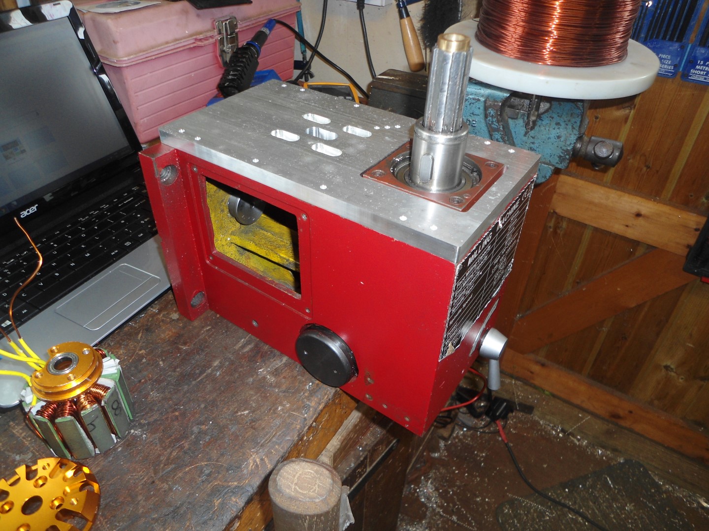

    It's rated by the retailer for 6.5kW, but that's not a realistic rating - it's more like 4-5kW. That power rating is excessive, but the correspondingly high torque rating does mean I can get away without needing to change the belt. I've started rewinding it to control it with my servo motor driver using vector control - so things requiring position control of the spindle will be possible, in addition to getting a large speed range (using field weakening). That'll also allow me to test the idea of linking feed-rate to torque feedback, since the driver will know the torque at all times.

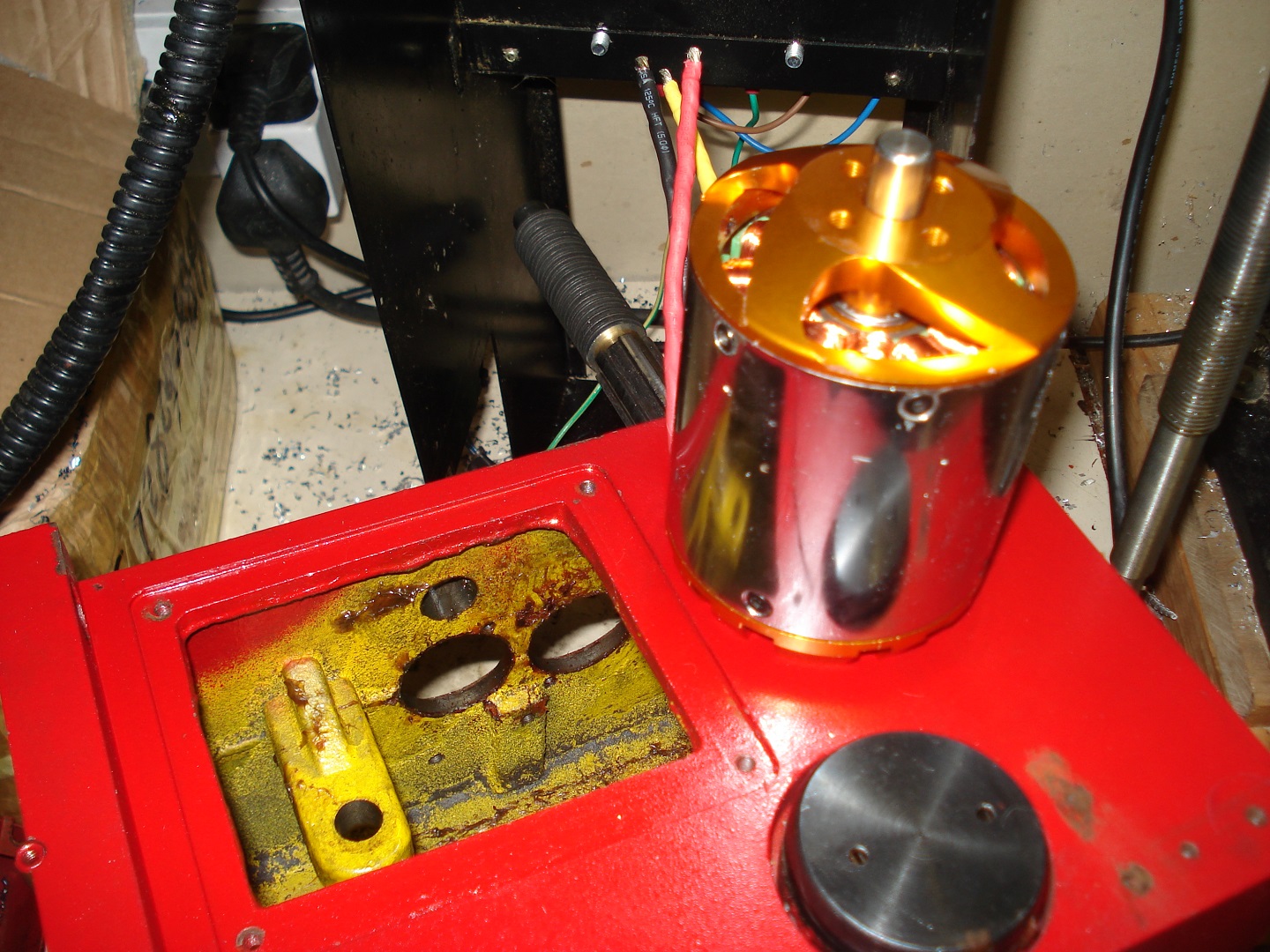

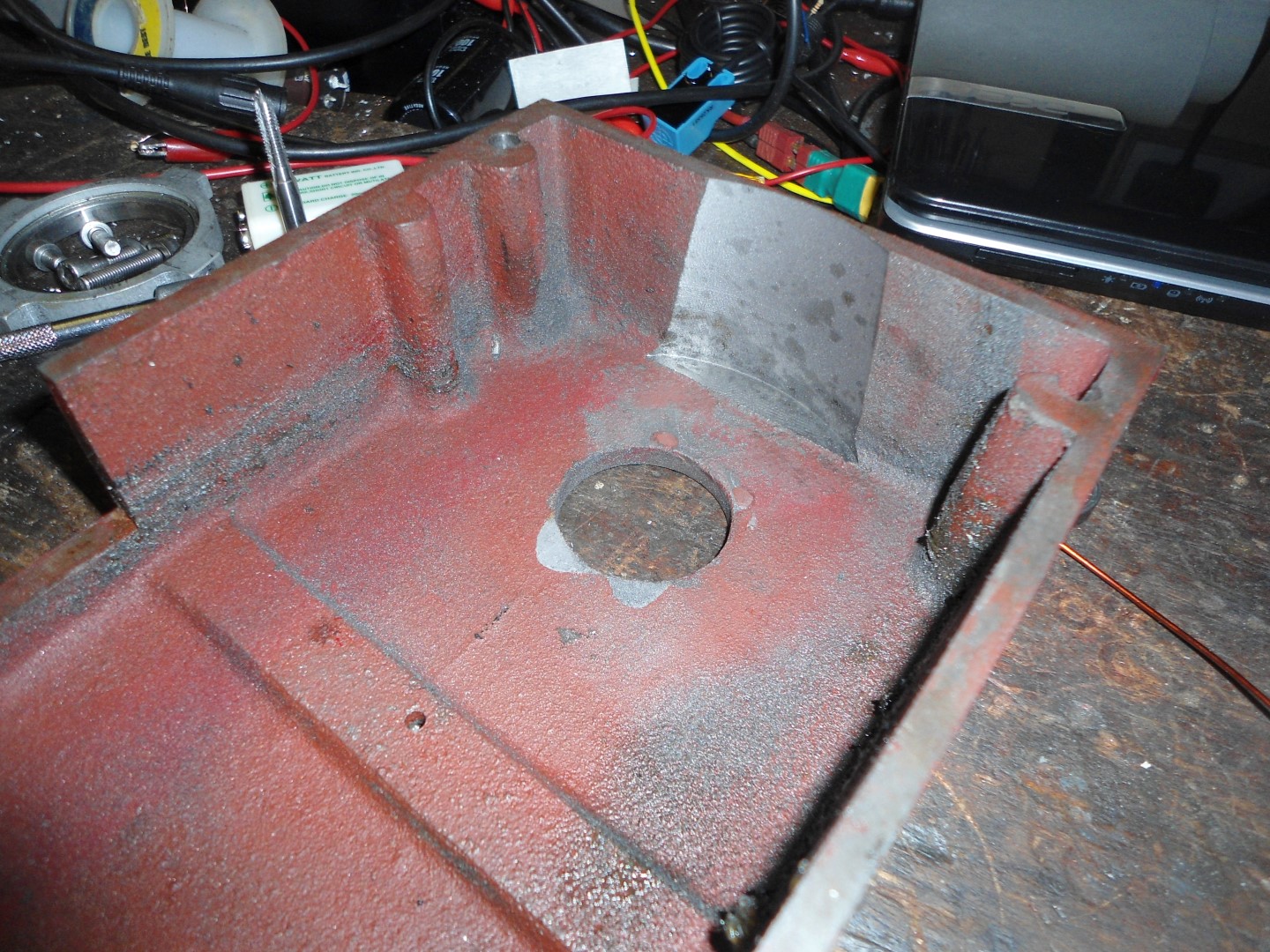

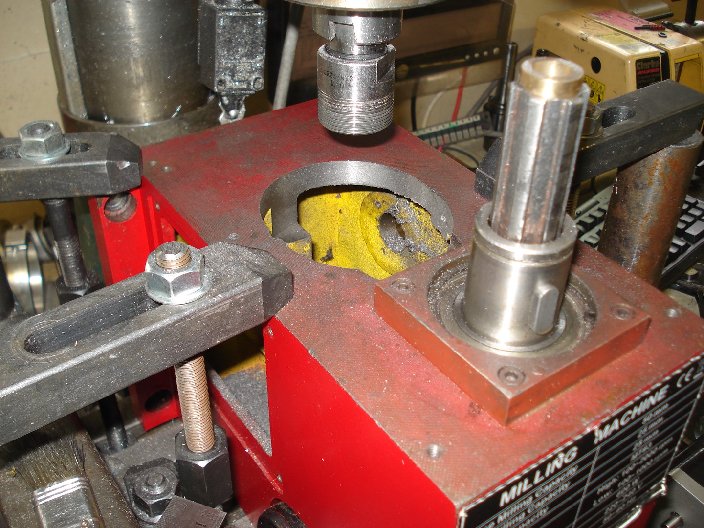

    The motor clearly doesn't fit through the cutout in the side of the mill head, so I milled a hole in the top, then cut the annoying protrusion inside off with a slitting saw:

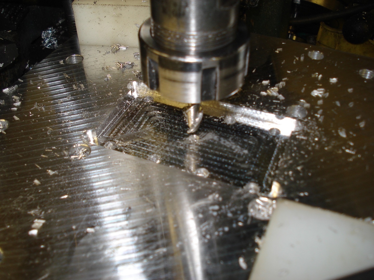

    I'll machine an aluminium plate the size of the head to both support the motor and heatsink it. I've calculated that a 5M, 25mm wide HTD belt will be adequate (just about) to couple the motor to the spindle so I've ordered that and some pulleys.

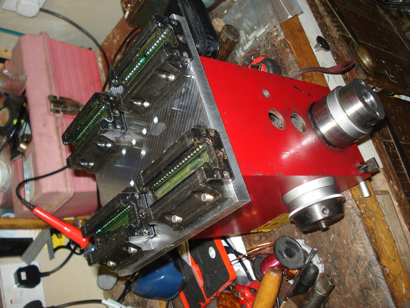

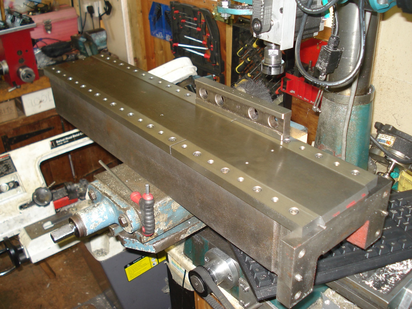

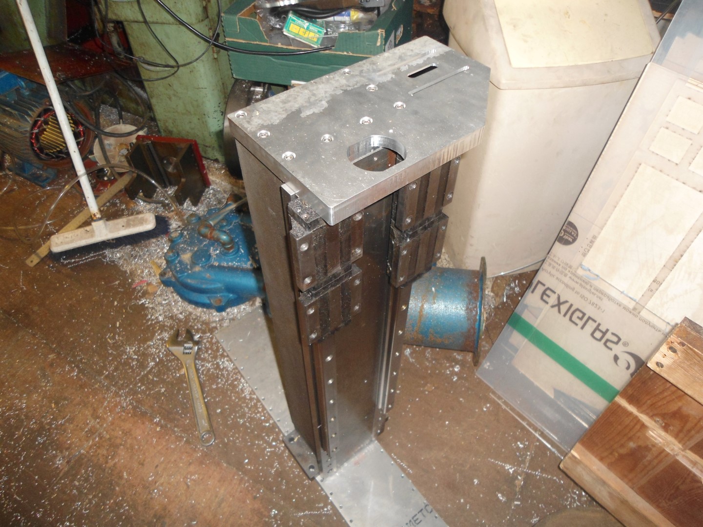

    I decided to put linear guides on the column to remove the various (potential) problems with the dovetail slides. To do that I've milled a small amount off the dovetail on one side of the column, then drilled and tapped lots of holes to fit some ground strip upon which the rails the rails will be mounted.

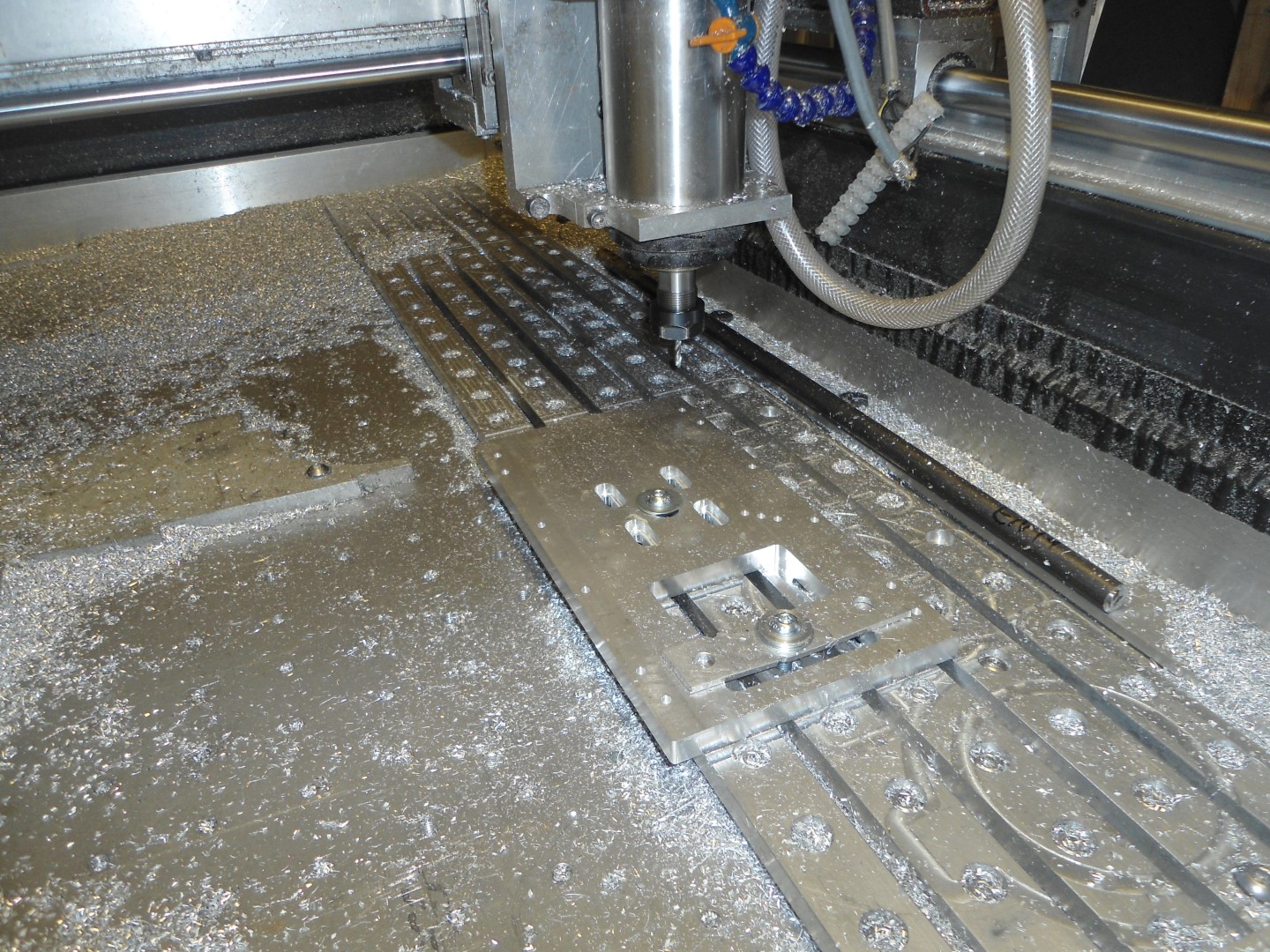

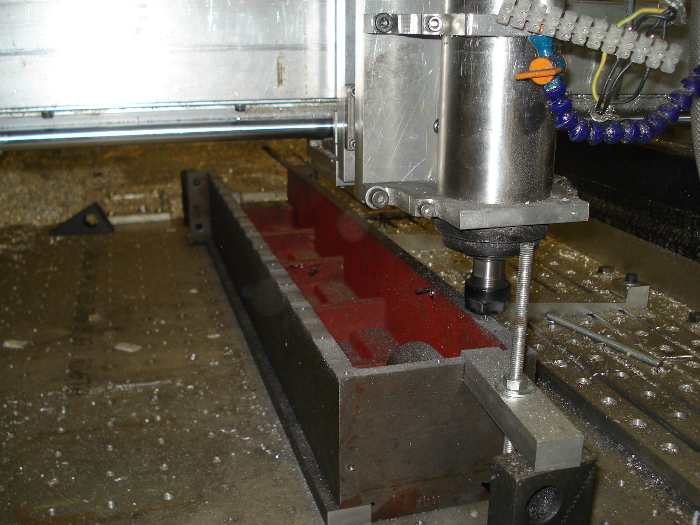

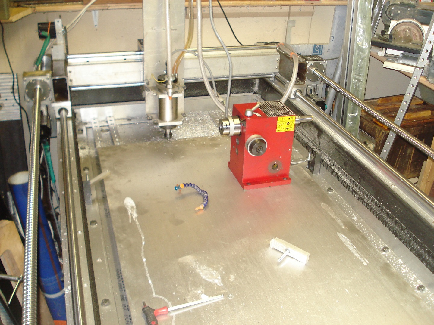

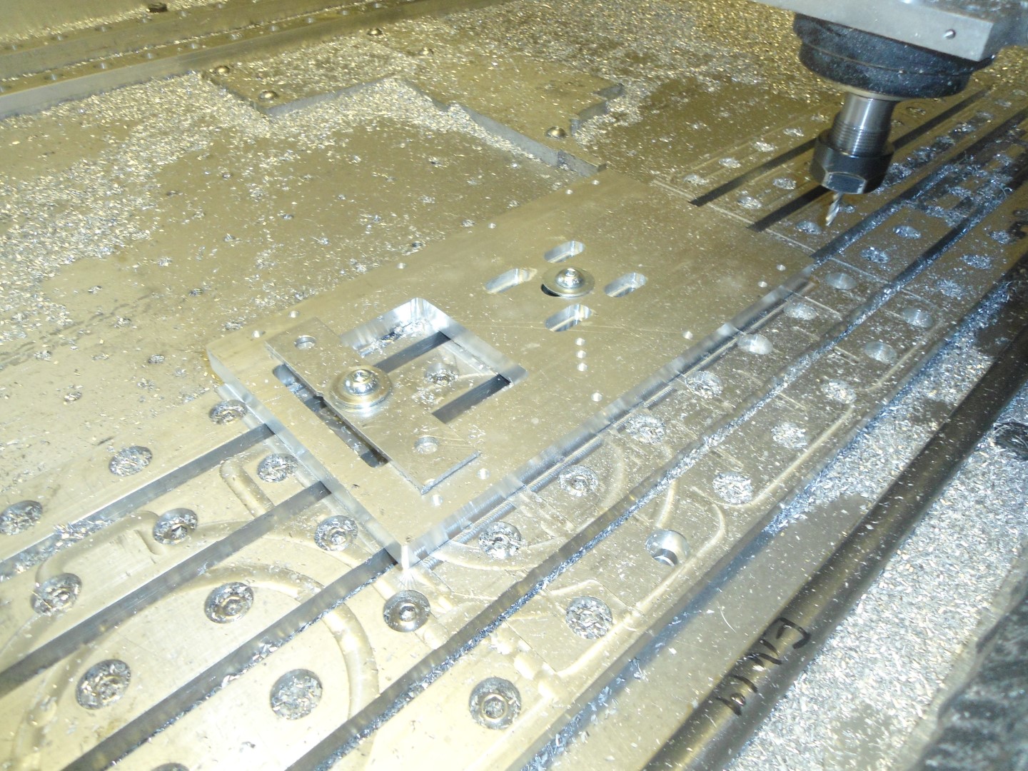

    As I found a long time ago when converting the other mill, cast iron cuts well on my CNC router, so I used that to do the necessary milling and drilling:

    Drilled array of holes in the back of the column so that I can mount a piece of 20mm thick aluminium to the back of it to improve the torsional stiffness. The ballscrew will be on the front between the rails, so no need to have the column open. I can also conveniently mount the motor drivers inside the column and use the aluminium plate as the heatsink.

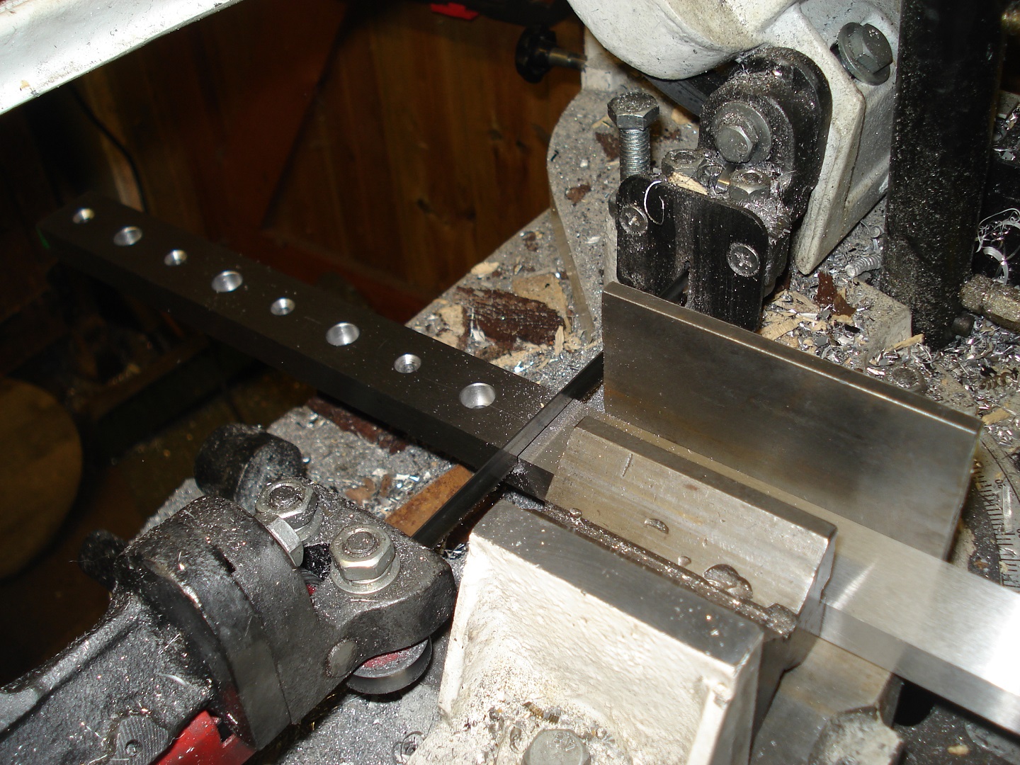

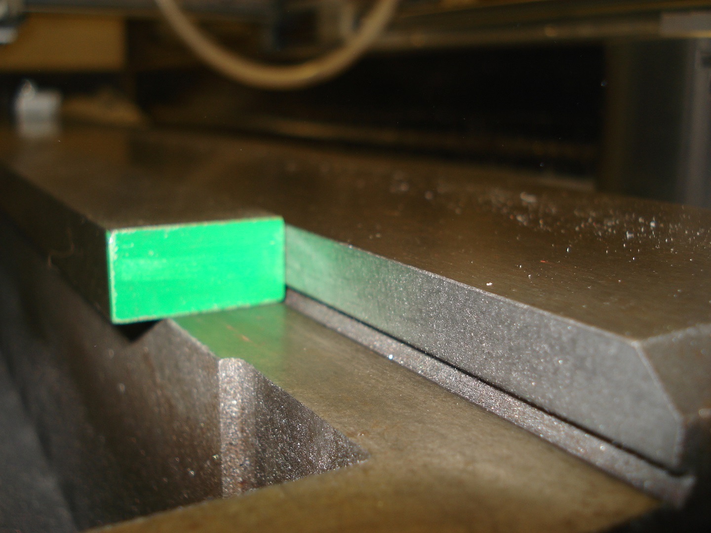

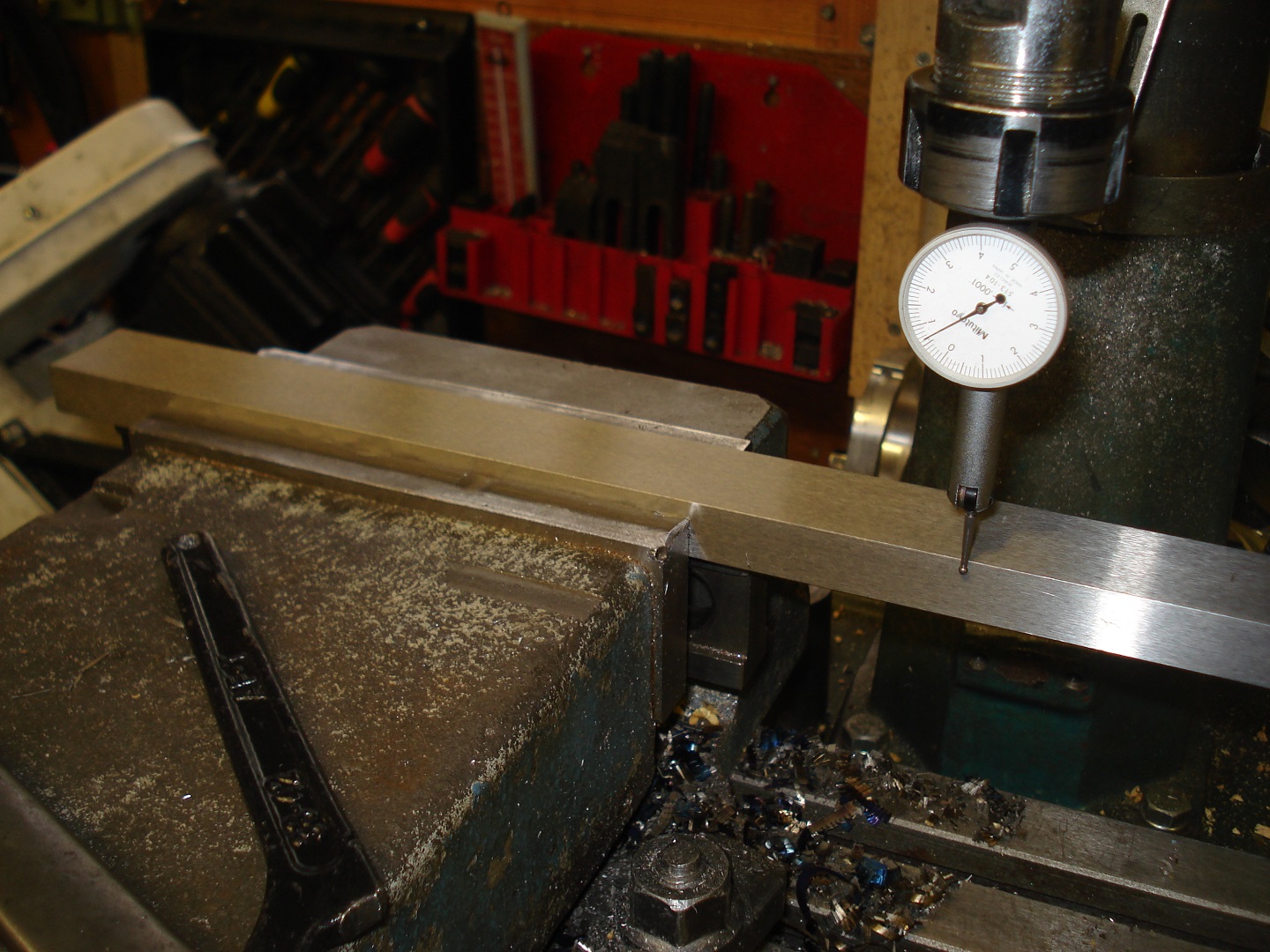

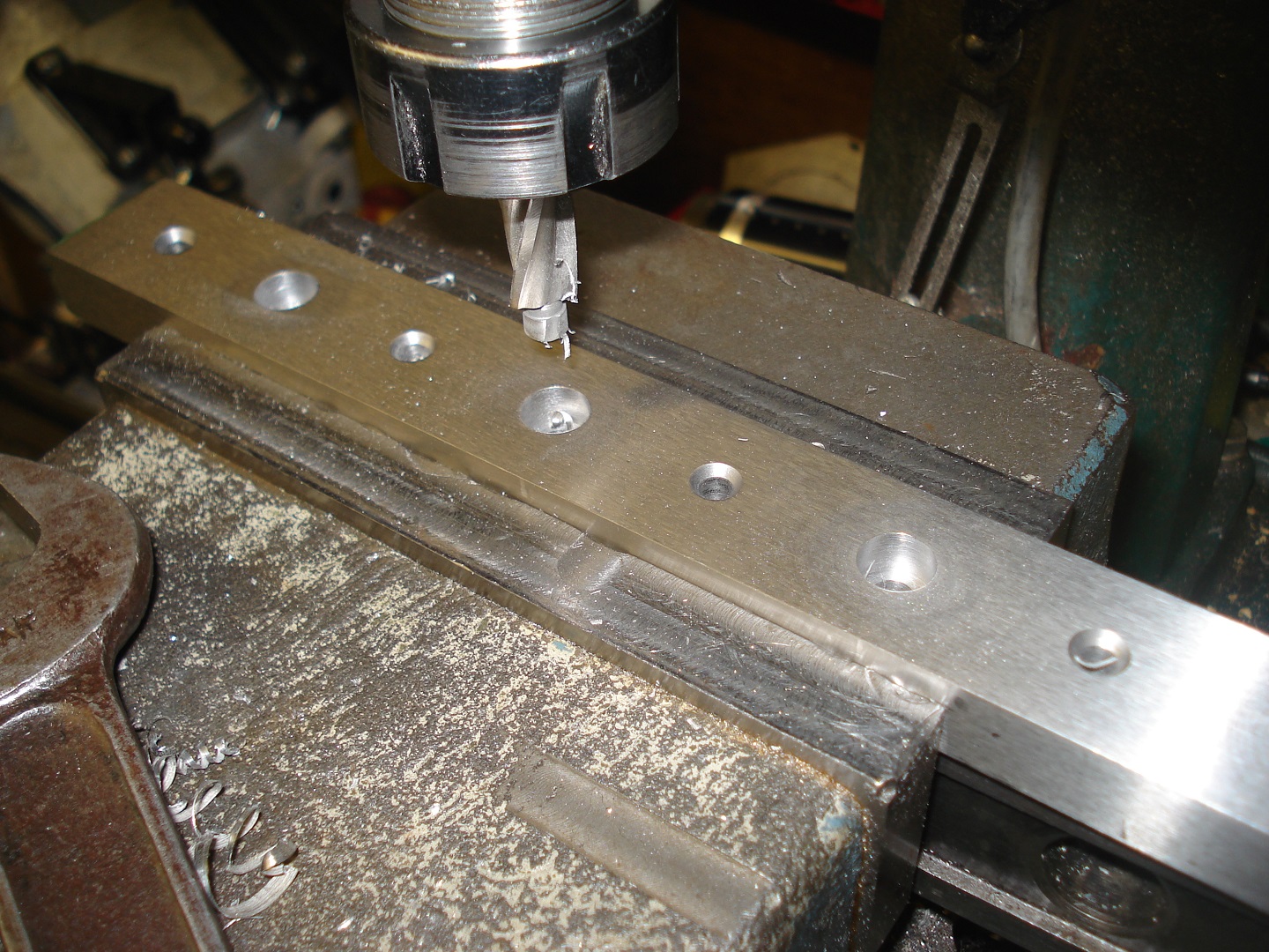

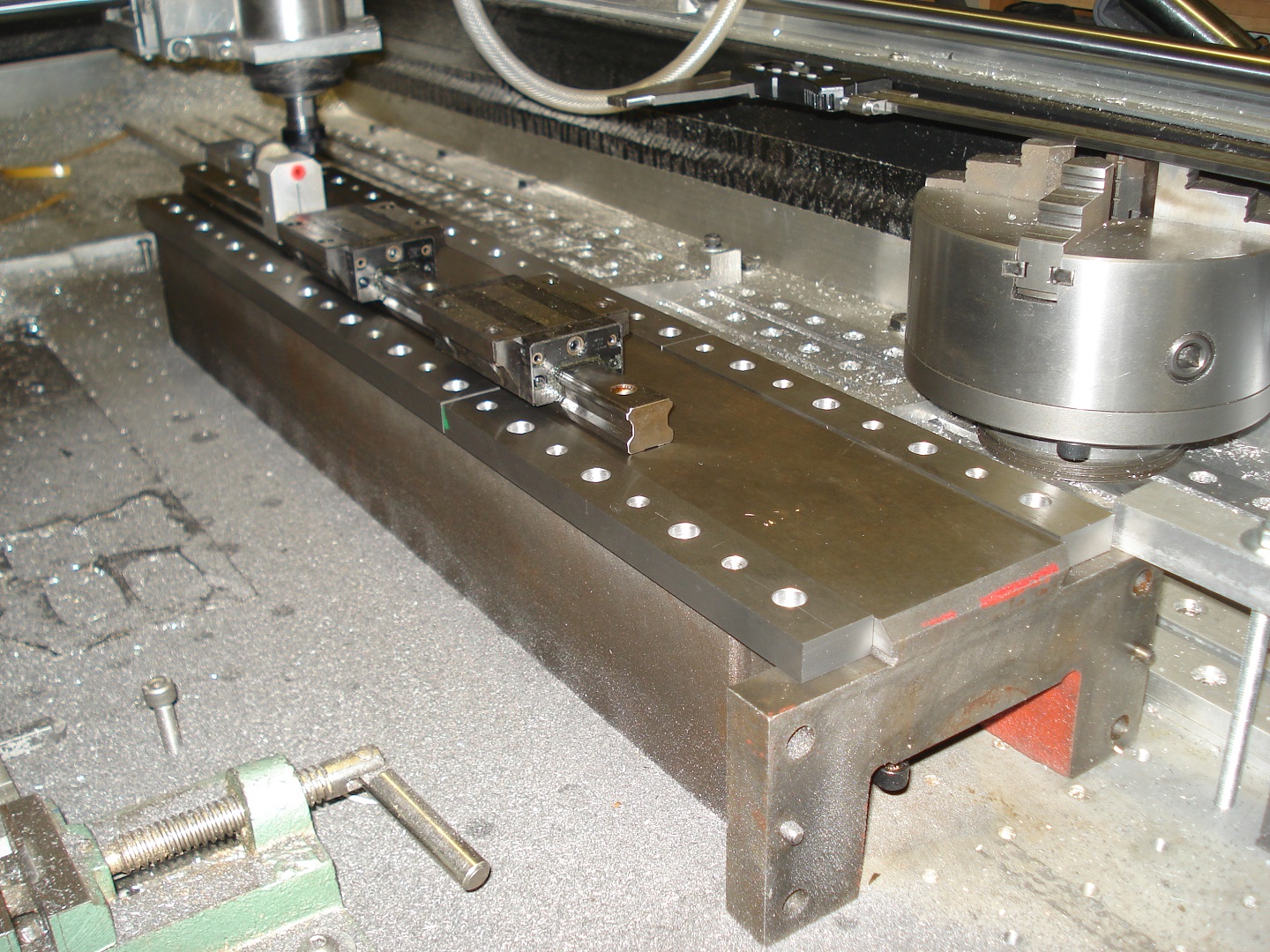

    Now to drill the rail strips - align the vice then drill, pretty simple:
ID:	12619Click image for larger version.
    For some reason people seem to like taking pictures of sawing things...so why not:
    Ready to mount rails - just need to check the join on surface plate, but it seems OK.

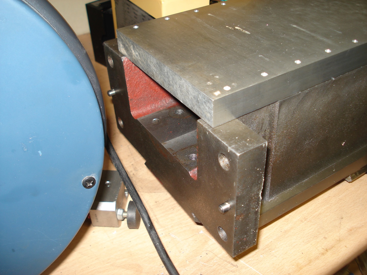

    Simple aluminium plate machined to connect bearings to head:
ID:	12616Click image for larger version.

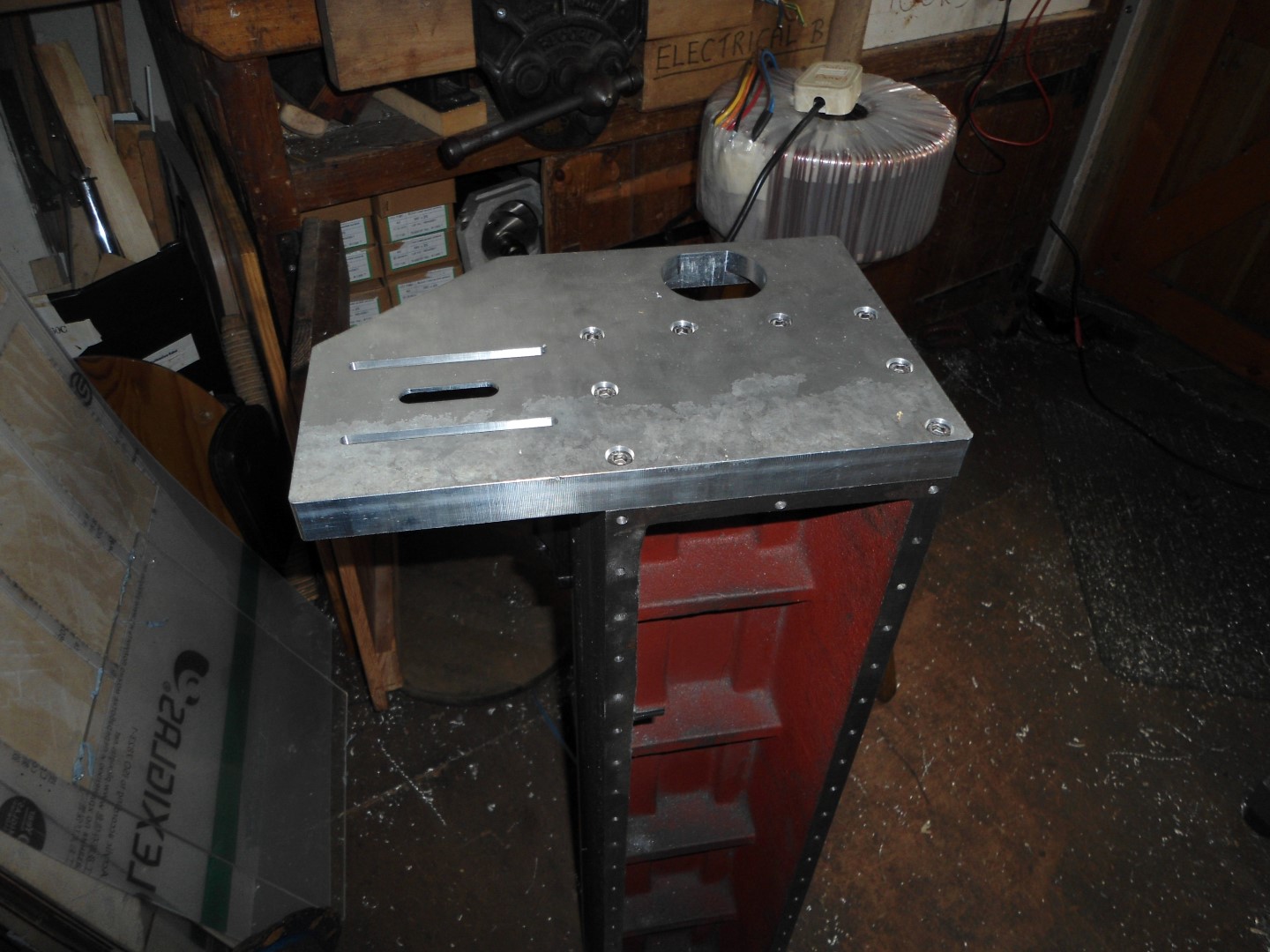

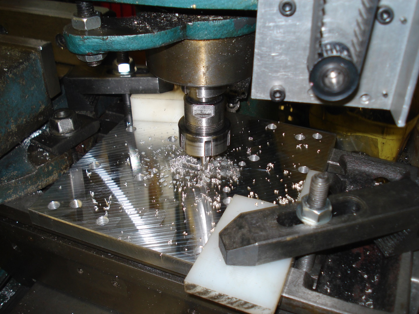

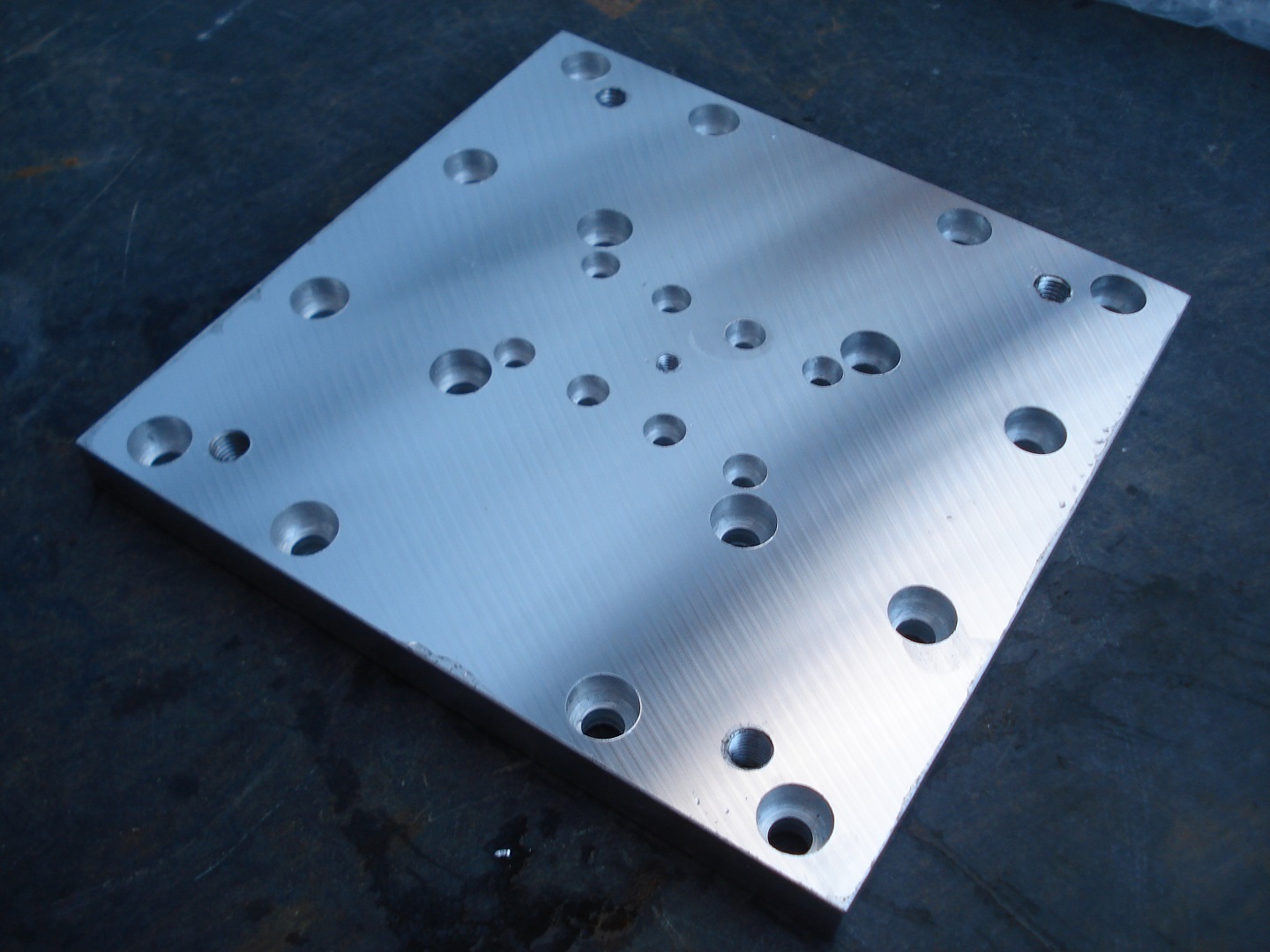

    I cut out the back plate for column, will leave the tapping for a rainy day:
ID:	12631Click image for larger version.
ID:	12627Click image for larger version.

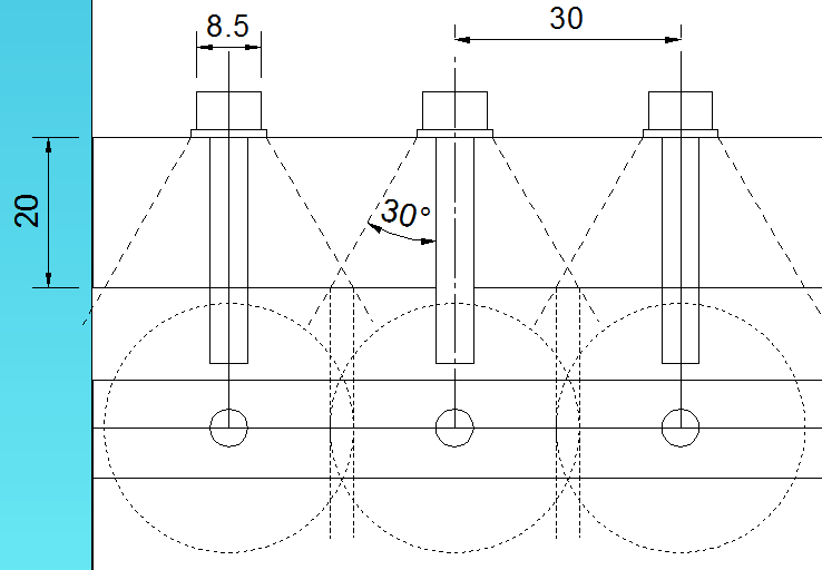

    The spacing of the bolts is loosely based on the theory here - namely make the stress cones under the bolts intersect to get maximum stiffness. This diagram illustrates that:

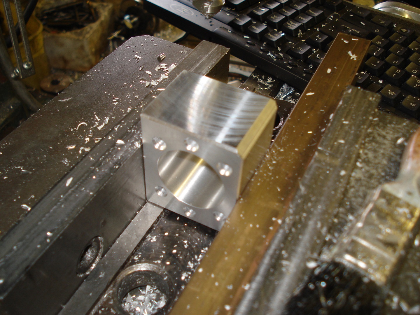

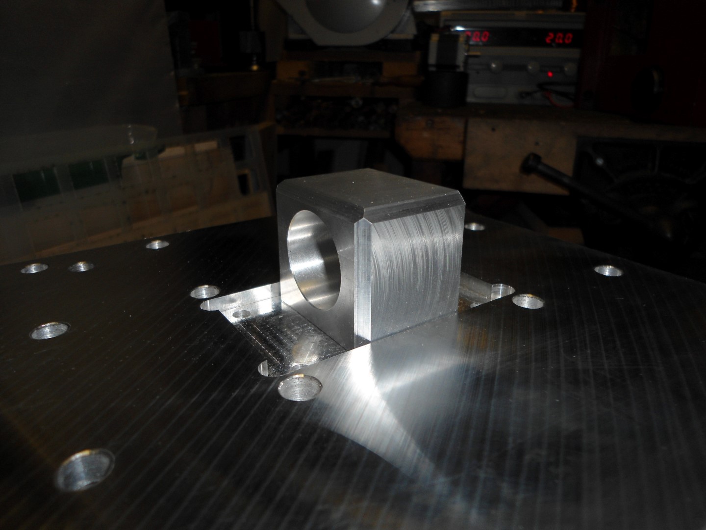

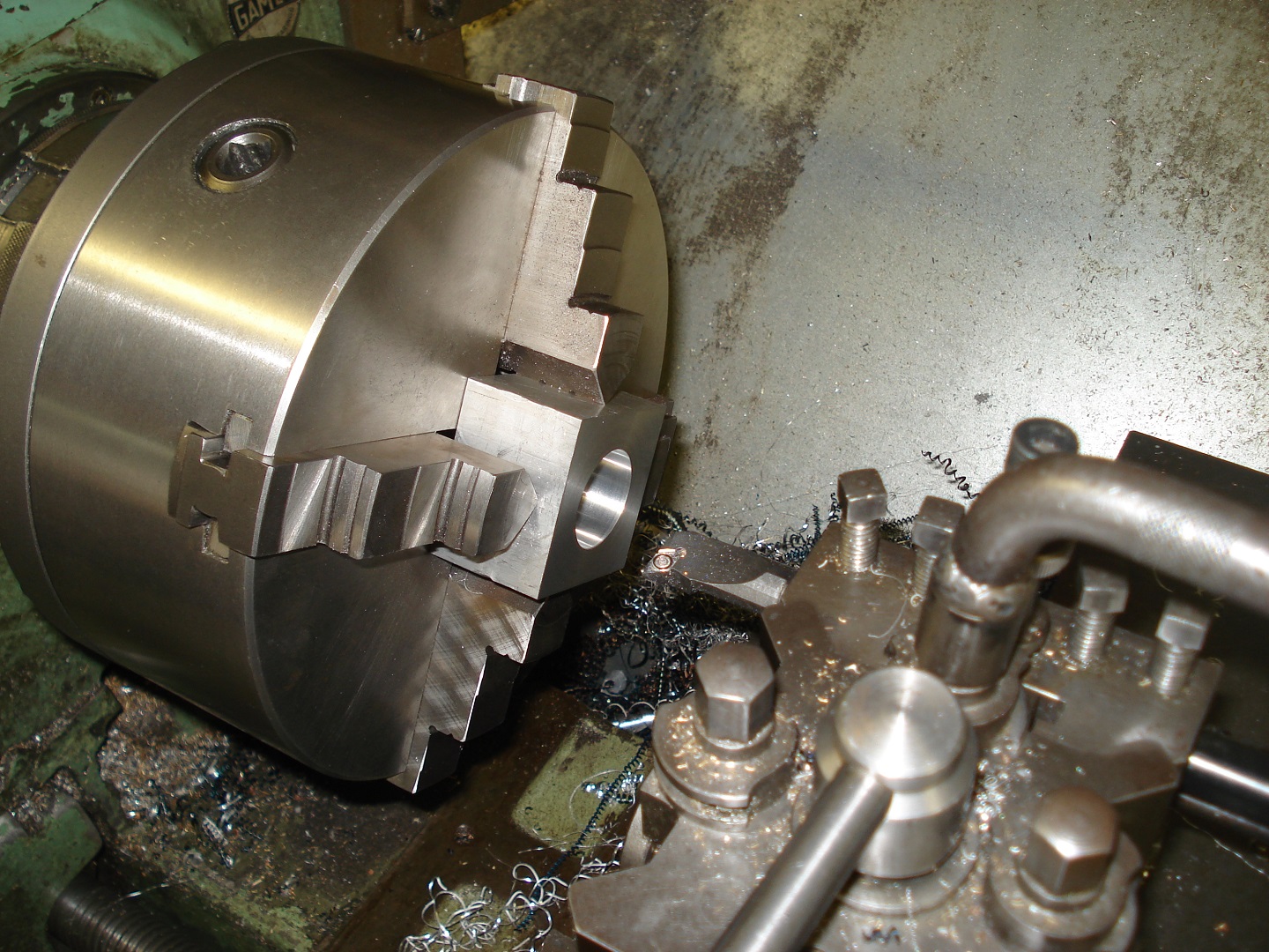

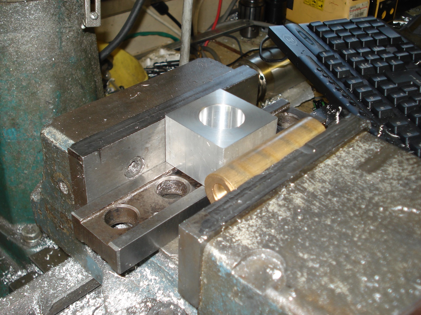

    Made a ballnut mount for Z:
ID:	12633Click image for larger version.
ID:	12632Click image for larger version.

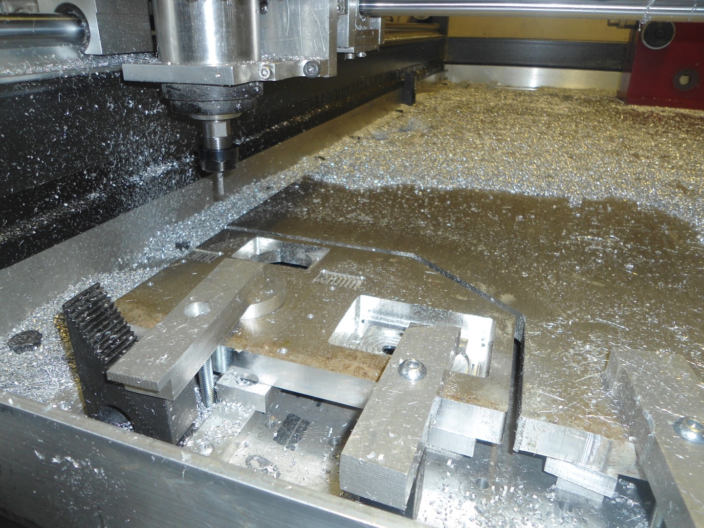

    Remembered the cutout for the ballnut mount in the Z-plate. Clamped directly to mill bed to ensure parallelism.
ID:	12637Click image for larger version.

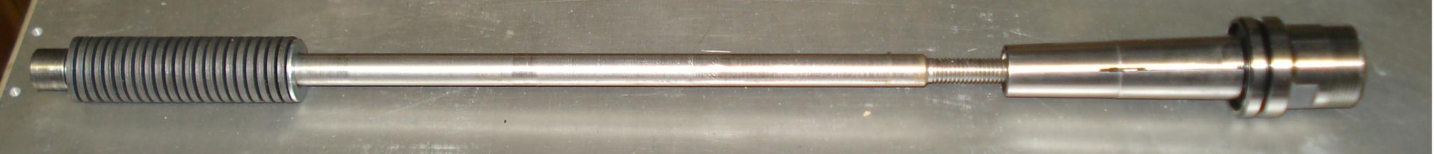

    Here's a picture of the drawbar I made earlier for the ATC:
    That may not be the final number of disc springs - but there will be quite a lot to ensure they're not operated outside the recommended region to get long life.

  7. #6
    EDIT: Just a quick question, how come you went with ali for the column back plate rather than steel?
    1) I can mount the motor drivers in the column - the aluminum plate can be used as a heatsink, so saves buying that.
    2) Aluminium is easier for me to machine.
    3) I had a 1.50x0.74x0.02m sheet of aluminium 'lying around' and I'm not sure where to buy steel plate for a reasonable price.

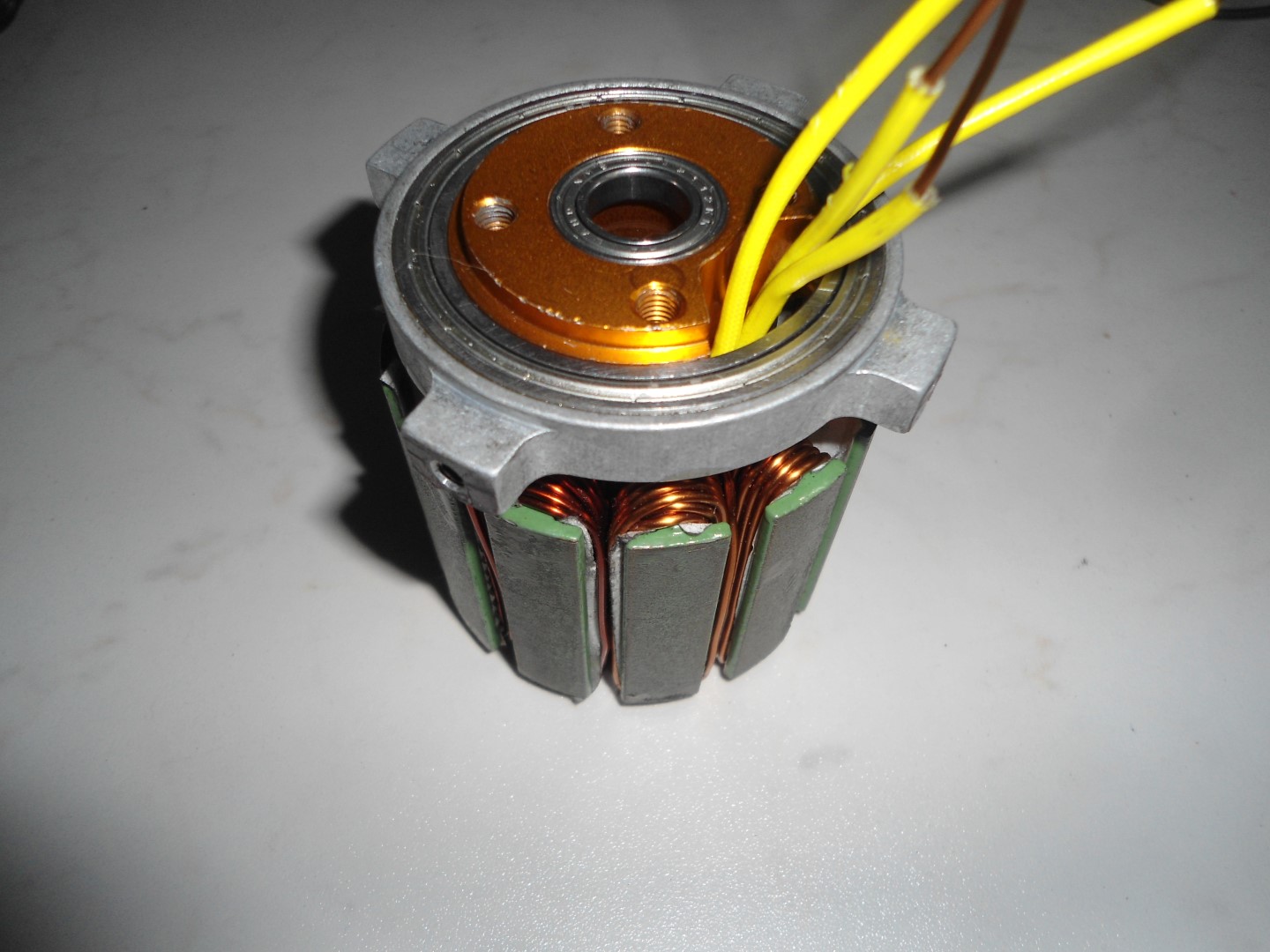

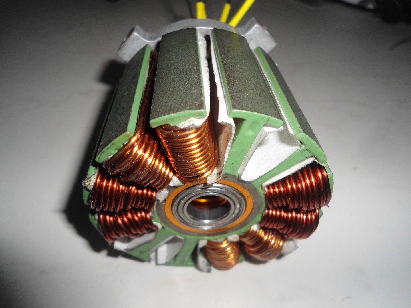

    What sort of motor are you using for the spindle?
    And how on earth does it achieve such a high power density?
  10. #9
    Quote Originally Posted by embraced View Post
    It's the same type of motor as I used here - permanent magnet synchronous motor (PMSM), with an outer rotor. The high power density partly stems from the magnets, which replace the rotor magnetising current in, for example, an induction motor, resulting in lower losses. There is more to it than that though - e.g. differences in cooling.
    This is how far I've got with rewinding the motor - two phases done, but I do have a low resistance from one phase to the stator, so I'll probably have to re-do that one and be more careful.

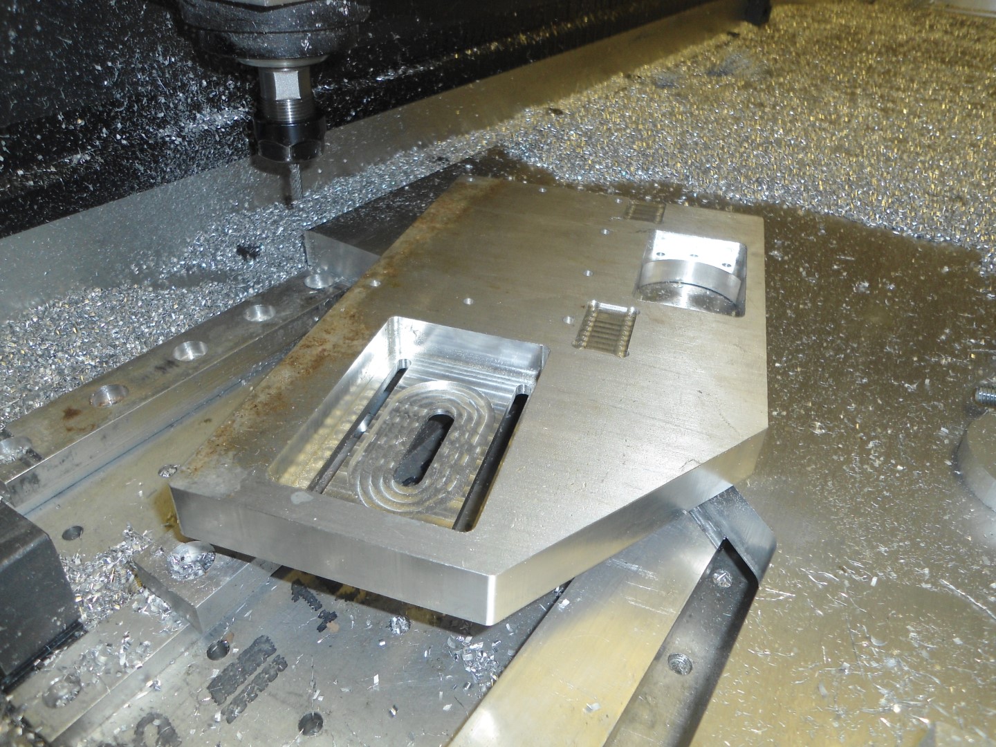

    Cut out the motor mount for Z from 20mm thick aluminium yesterday:
ID:	12669Click image for larger version.
ID:	12670Click image for larger version.
ID:	12659Click image for larger version.

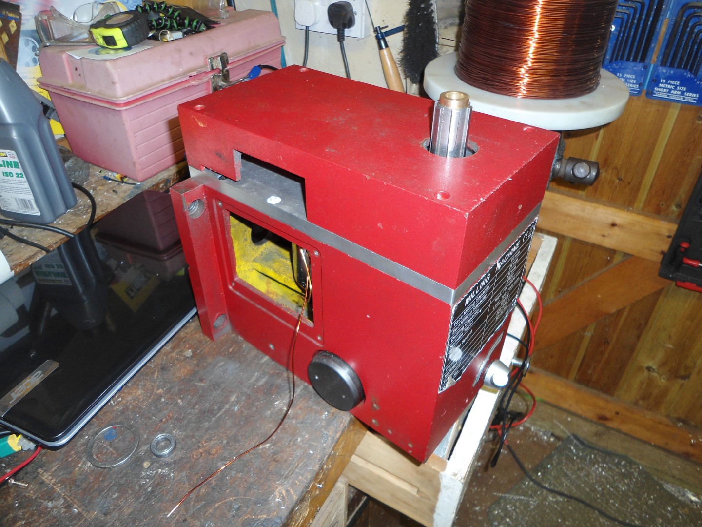

    This morning I cut the motor mounting plate for the spindle motor:
ID:	12657Click image for larger version.

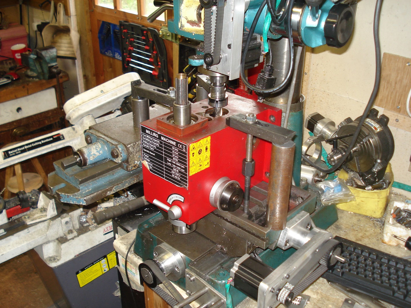

    This is where it fits:

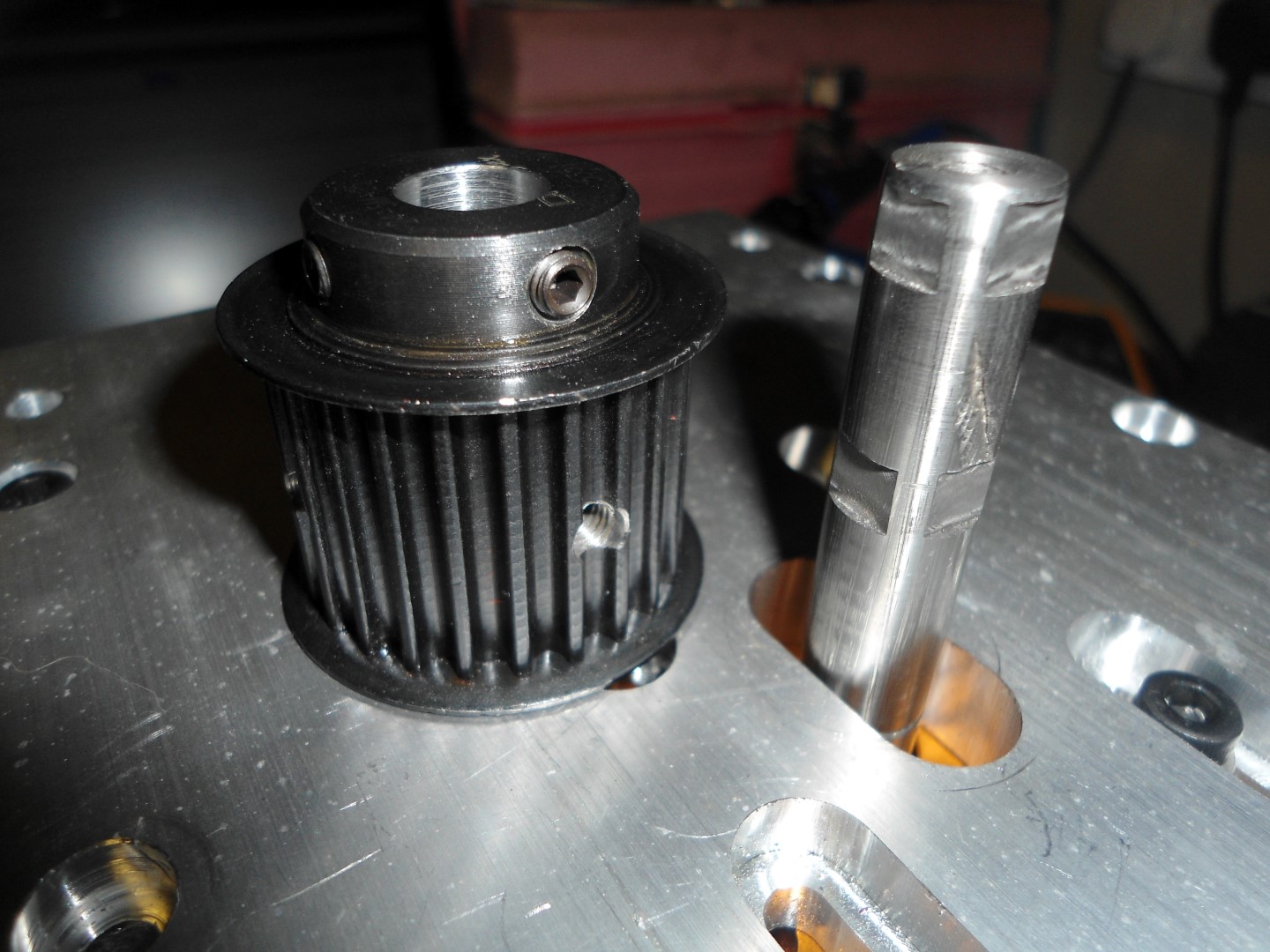

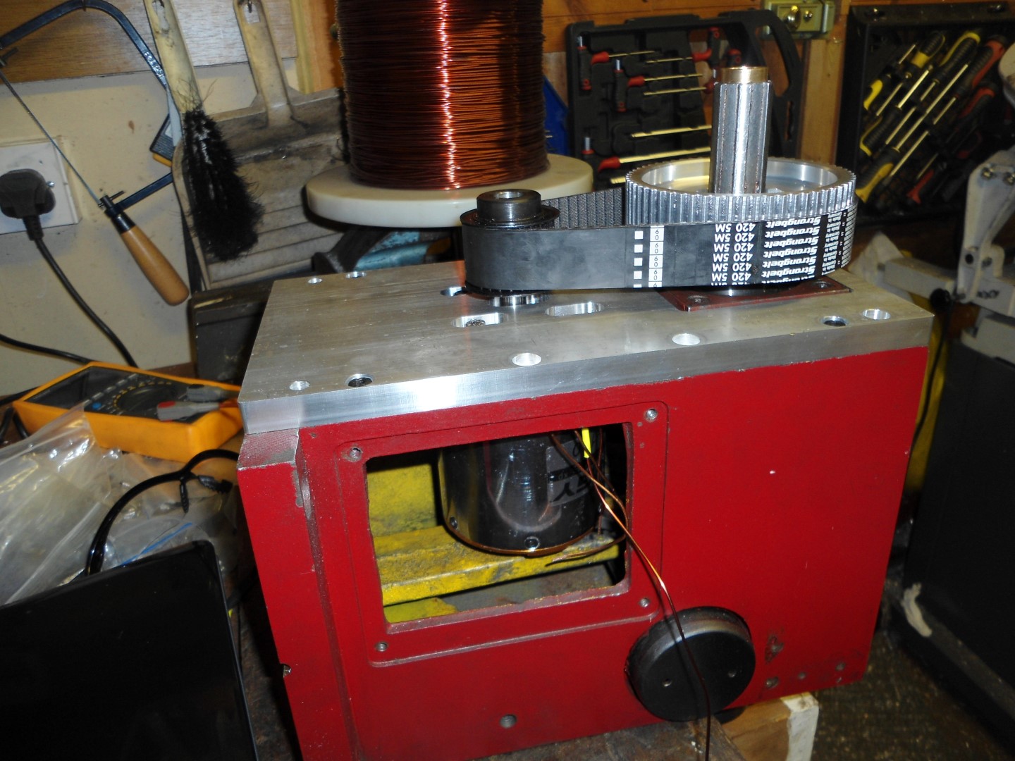

    The large pulley (60T) isn't all the way on the spindle shaft, but this shows the general idea. The spindle pulley is keyed and the motor pulley fixed using four grubscrews, which should be sufficient...more on that later.
ID:	12664Click image for larger version.
    The spindle pulley is much bigger than the original gear, so I had to mill a bit off the top cover to clear the pulley and belt:
ID:	12663Click image for larger version.
