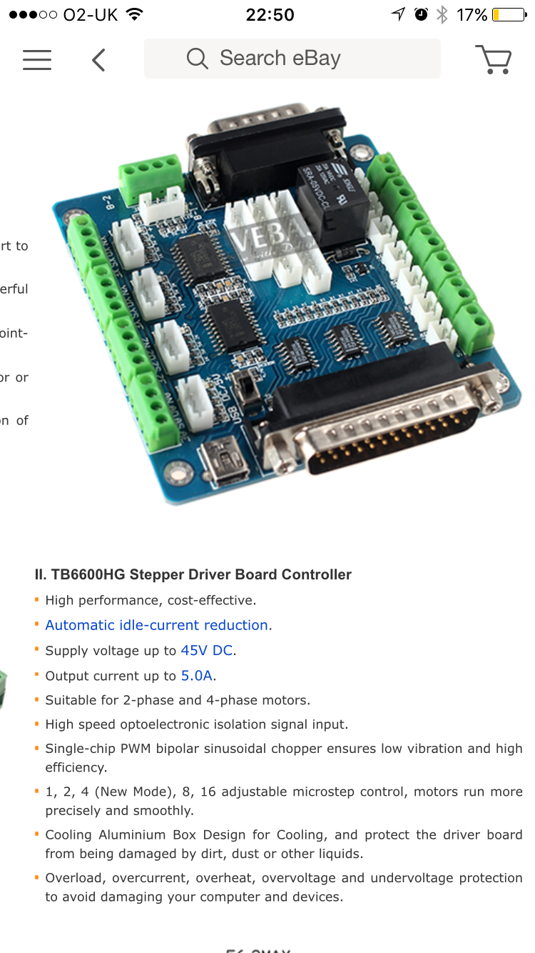

    I don't have any limit switches or home switches on yet just setting up at the minute. Kernal speed is at 25k velocity is 600 and acceleration is 200. Step pulse 5 and dir pulse 5. I have A slaved with Y in Mach also A is set to linear in general configuration. Picture below is of the Bob which I am using.

    I still don't understand what you are actually asking. Post some pictures up of the machine. If you are trying to slave you will need homing switches and setting up in Mach3 correctly.

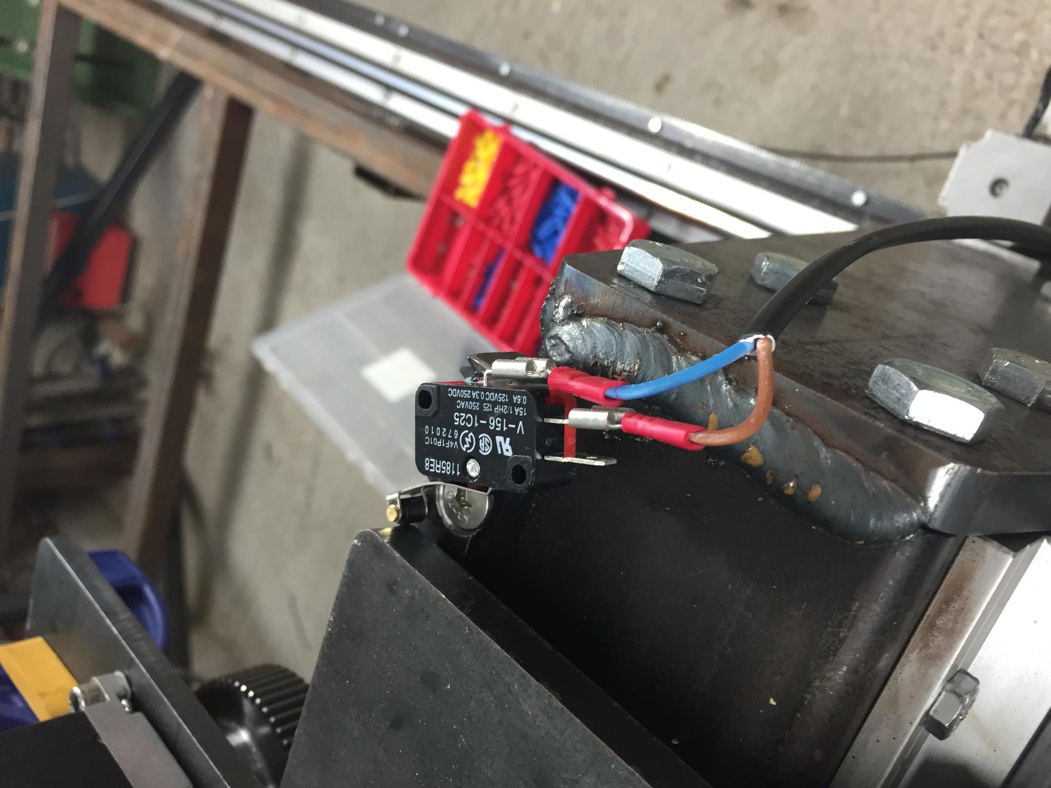

    Sorry about delay Clive.
    Pics of gantry motors and limit switches.
    Going to wire these on at the weekend, and see what happens from there

ID:	17334Got my home switches all on today but still no joy with my slave axis. Is there something other todo than choose it to be slaved with y in Mach ??

    How have you wired them ie have you used two different input pins on the bob and how have you set the slaved axis in Mach3 Also have you set the slaved axis say A or B to linear in Mach. Post a pic of your setup screen in Mach
